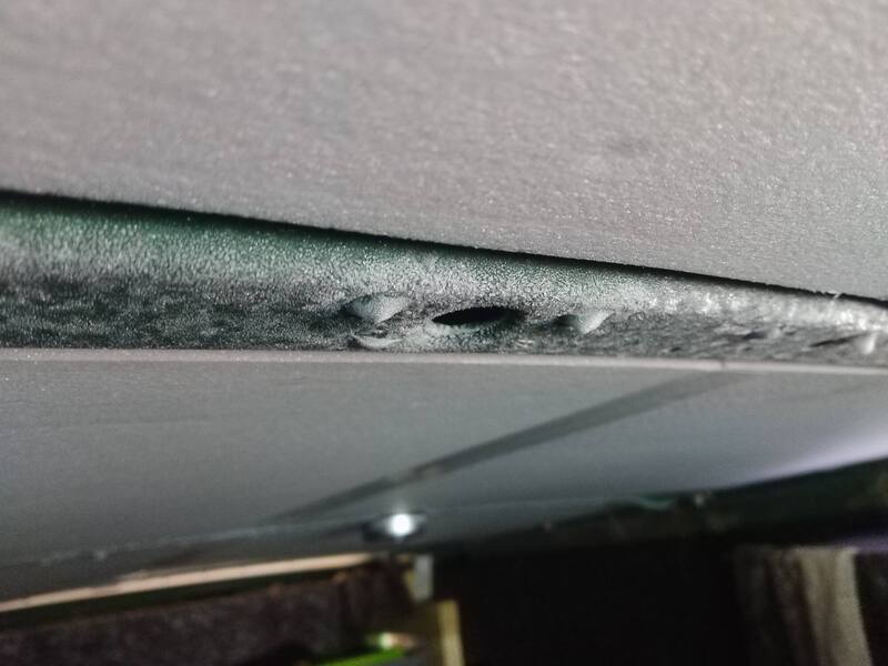

This was the ceiling of my home yesterday morning.
3 minutes ago, Bucketeer said:
That has sparked much jealousy.
Ouch! I've had my share of nights in the van where the water in the sink froze solid, it's not a lot of fun.

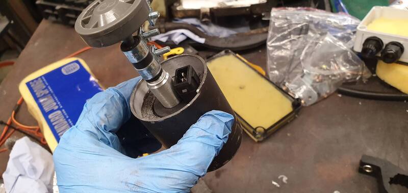

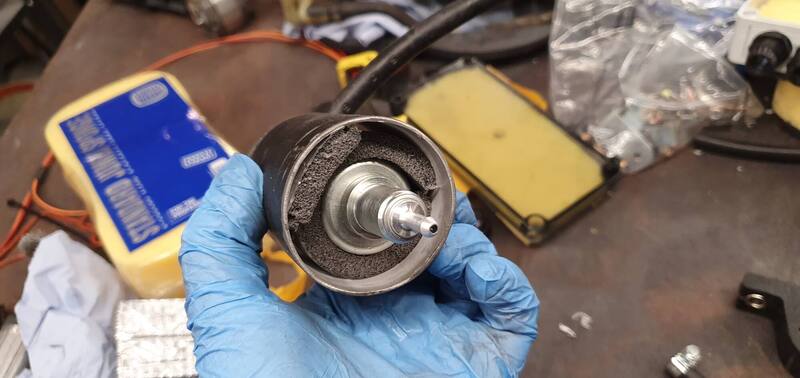

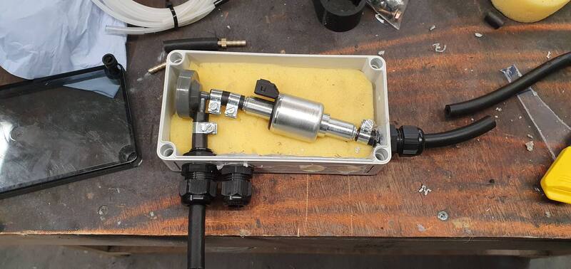

I spent most of the morning making this contraption to dampen the pump noise. When I started I realised the box was too small, but instead of knocking the job on its head, I continued and made compromise after compromise until it was useless. In my head I had a nice couple of loops of supple 4mm tube off  each end of the pump to isolate the pump from the casing entirely, and the whole pump sat with a good couple of inches of soft sponge in all directions, but this was the best I could do with what I had to hand. Miles off!
It looked fairly neat, but it was about 10x louder than before!
I will order a nice big cast aly box and do it again one day, properly!
For now, I decided to go another route - Sit the pump in some closed cell foam, in a steel tube, then wrap that tube in more foam - the steel tube would act as another damper before the vibrations got to the chassis.
I'm pleased to say that this worked fairly well, it's a fair bit better than with the original mount, but there is still an audible tick noise outside the van. It's something I'll have another go at in the future, but it's good enough for now. I can barely hear it inside and don't mind the noise at all, and generally I don't camp in places where I'm very near anyone, but I am very keen not to bother people, especially if its really cold and I want to leave it running overnight.

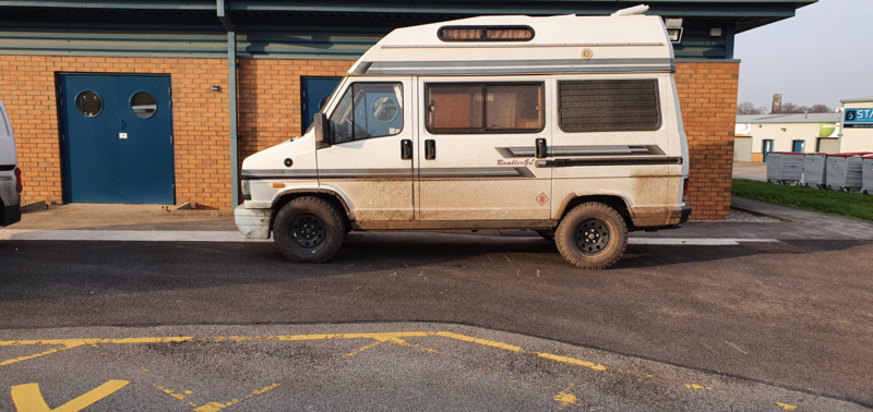

I also fitted new tyres. I took the 215/65/16 Insa-Turbo Dakars off for a few reasons: They were soft and wearing quickly. While they were load rated for the actual weight of the van (2300kg) they had max 33psi written on the side, which wasn't really sufficient, but mainly because of the mega flipping drag they caused.
So I put some 235/60/16 Insa-Turbo Rangers on, these are a less aggressive tyre, fit the wheels better, are load rated properly and will take more pressure.
Now they're on and I've done a tank of fuel on them -  They look more "proper" on the wheels and there's less noise, but I reckon the extra width has cost me about the same rolling resistance as the tread pattern has gained me - It still feels like I've left the handbrake on a click. They weren't expensive and I should get a decent portion of the purchase price back from the sale of the old tyres. They do the job on muddy tracks and wet grass fine - I'm hardly mega offroading but the weakest link is the open diff and tiny amount of front suspension travel.

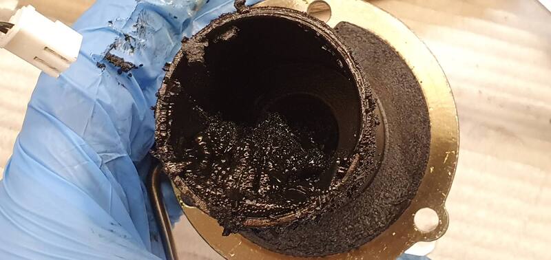

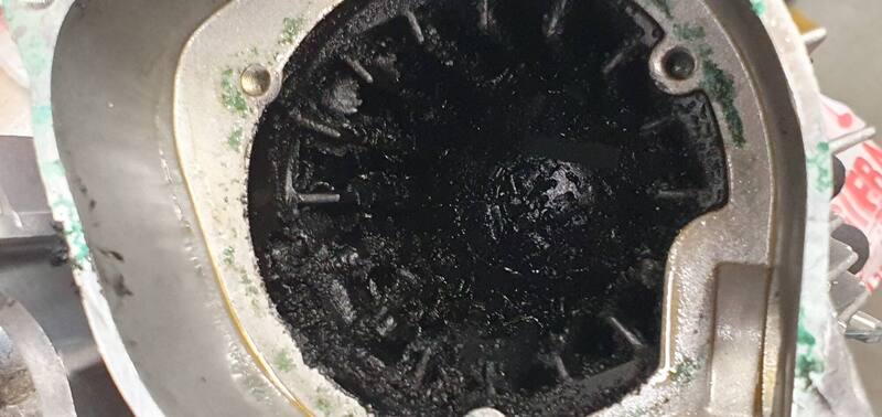

Eventually I bit the bullet and took the heater out of the van. I don't know why I was so reluctant to do it, it was out in 5 minutes.
Stripped it down on the bench and it's absolutely sludged and carboned up to high hell:
Absolutely disgusting! that's only after about 35 litres of fuel.
I cleaned it all up, put it back together and it's working properly again - It smoked the carpark out bigtime when it first fired up, burning off all the residual stuff in the exhaust. If it's sooting up like that, it's definitely running rich. My air piping is short and straight, so I reckon that I've probably just got the wrong pump.

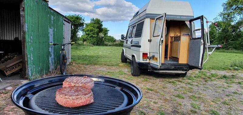

I was going mad without the van! I went on a mega 25 mile bikeride today - it set off from work because it's nearer to "nice places" and bumped into this on my travels, and it gave me an idea,
All the campsites are shut, so just camp wherever.
Mine is much less glamorous both in surroundings, and vehicle:

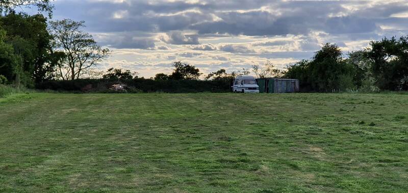

Stuck between a "camp in the carpark" again or pack my rucksack and walk to find somewhere out of the way, I was reminded that my best mate's wife rents a few fields to put horses on. They're not particularly glamorous, but they'll do for me! That's my weekend sorted!
430282010_2020-05-1618_21_36.thumb.jpg.7e656647983878dde7d6e0e079c89164.jpg647714547_2020-05-1618_18_35.thumb.jpg.7e40616bb88b09d1be925fc6b40c14b9.jpg
It's not the peak district, but I'll take what I can get. Great to get the van out - I had a bit of a run out on the mountain bike, couple of burgers and now I'm into a few beers.  Absolutely great stuff.

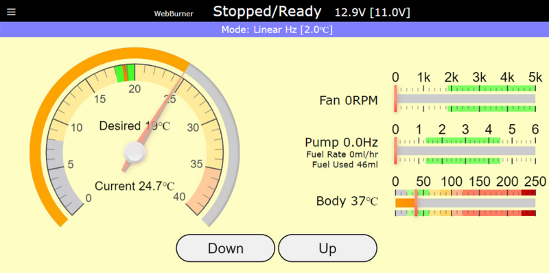

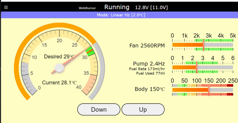

I received my Afterburner controller for the chinese diesel heater the other day. I don't really need a heater at the moment, but by the time I can get back to my regular thrice monthly peak district camping routine, I'm pretty sure I will.
This afterburner thing is an open source replacement for the wank flashy controllers that come with these heaters. I could have got the PCBs made and built the whole thing myself, but while I have the equipment, I really don't have the time, so I paid about £80 for one ready made, posted from Australia. I could have saved about £40 doing it myself, but I'd have had a wank 3D printed case, and every time I use the 3D printer there's about a 25% chance of me getting  in a right mood and smashing it into small pieces with whatever blunt instrument was immediately nearby. A tip for anyone thinking of getting one - don't. They're all absolutely toss, it doesn't matter whether you spend £100 or £10000 on one.
Anyway, back to the afterburner thing. They replace these cheese flashy chinese controllers
With this,
Which looks quite a bit more discreet and adds all kinds of proper control to the heater. Proper linear temperature control rather than the shite all or nothing control they come with. Reliable timers, bluetooth with a decent app, frost mode, and loads of config tweaking stuff. The main thing I've noticed is that they also have WIFI .
So I'm sat here at home, and I can turn the heater on in the van which is parked 10 miles away at work.
flippin technology eh! You can even see how much fuel it's used so you know when to fill up.
I've got it set on a frost timer to kick in at 1c to stop all my pipes freezing, I can't see me needing that for a while.
