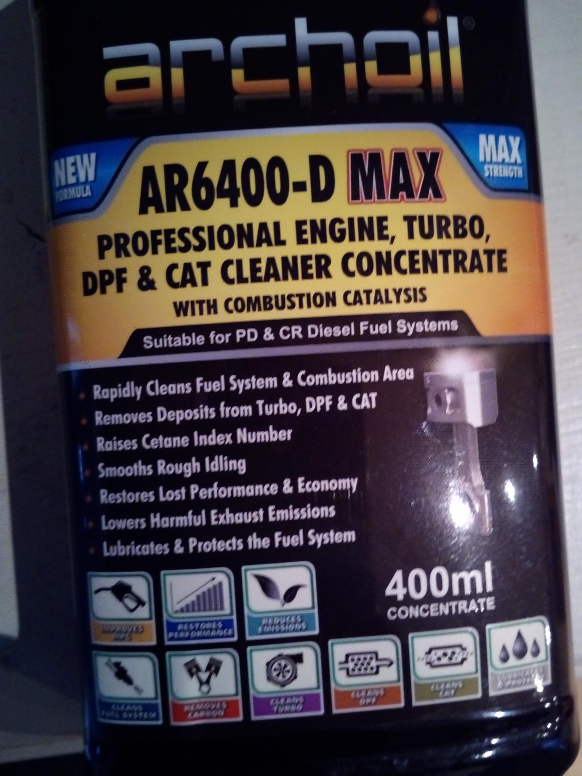

Like I mentioned before I've only had limp mode once recently but I'd already bought this stuff so I'll run it through. Out of all the additives/cleaners this one seems to get the best reviews. Worth noting for anyone else with modern shite with a variable nozzle turbo. It's not cheap but if it does half of what it says on the bottle then money well spent.
Any update on the snake oil?
It's in the tank now. Can't tell any difference but in fairness I've not had limp mode for about a month now. It's meant to be good stuff. I'm going to use it every oil change to keep on top of things.
I will give it a go I think.
Although the use mine gets, a tank lasts 3 months.
Does the claims list on the bottle include
1. Makes your dogs hair glossier and nose wetter
2. Stops chimney leaks on brick built houses
3. Prevents moss build up on patios / decking
Yes it does all those things and also makes you more attractive to the opposite sex. I've not had a moments peace since I bought it.
Are you sure it isn't the VW Sharan that has made you the ladies magnet? ;)
