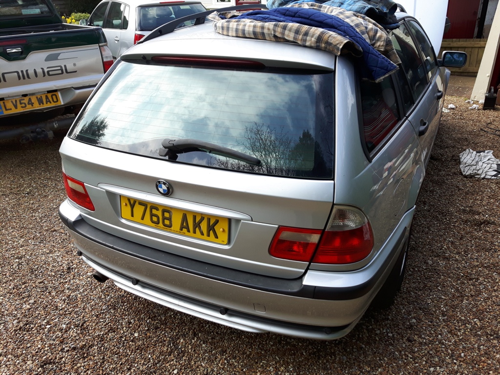

Mate thestag's son has an E46 318i Touring that he has run for the last 20 months. he crashed it into the back of another motorist who, by his own admission was driving erratically. Damage is minimal but the two outer edges of the bonnet do not line up with the wings and the kidney grill bits is loose. The car has all the toys and they all work except the starter which "sounds odd" it stopped working last week.
Laddo meboy found himself a Scab 9-3 vertible which he secured for a sum that would have embarrassed me (like I would have felt like a thief) buying it.
Mate thestag was going to offfload the hapless bimmer to cartakeback for a ton. Was delighted that I showed interest.

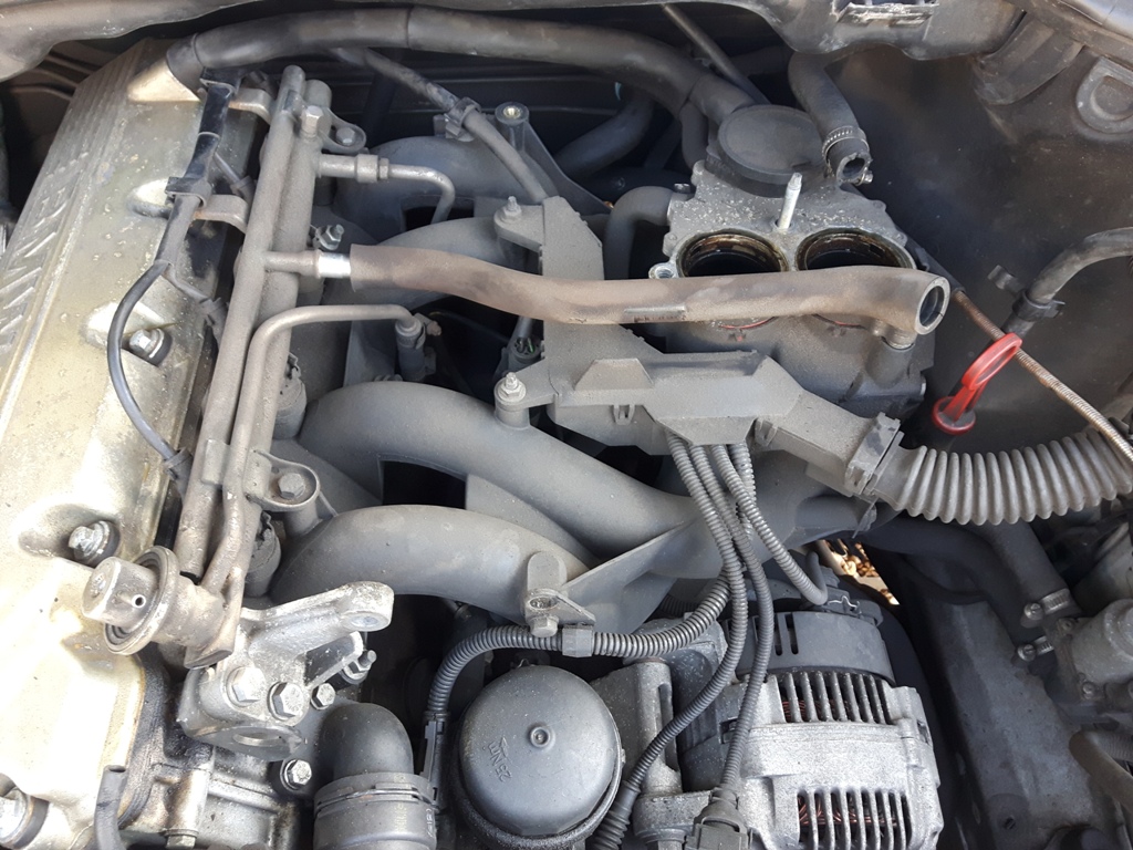

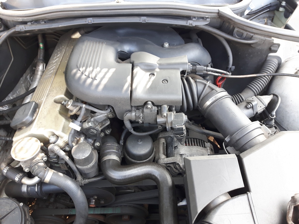

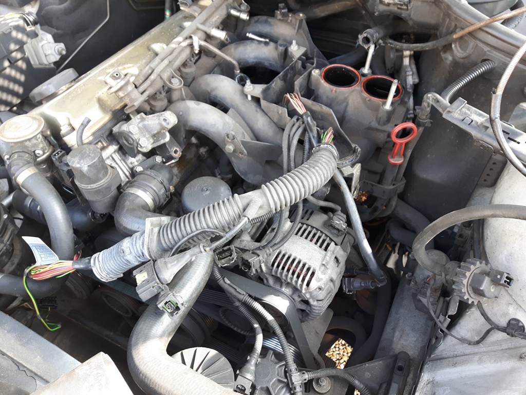

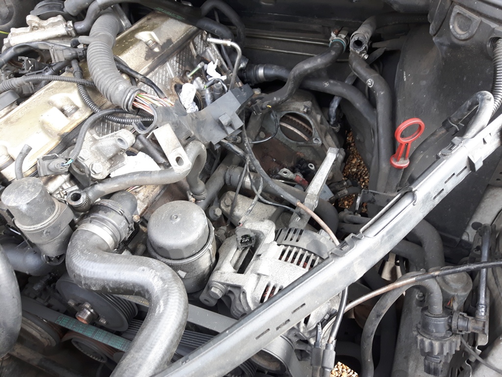

You might laugh but the web is rife with this question. Clue it is under the inlet manifold !
Redneck Youtube vids suggested 3h stripdown, took my 1 h 25m maybe NOT voting for Trump helped? go figure :D

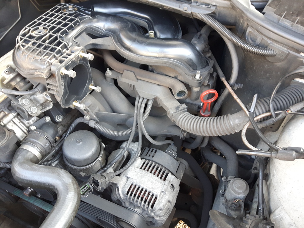

Getting this far I find the starter as if by surprise. Only it dont look proper fitted

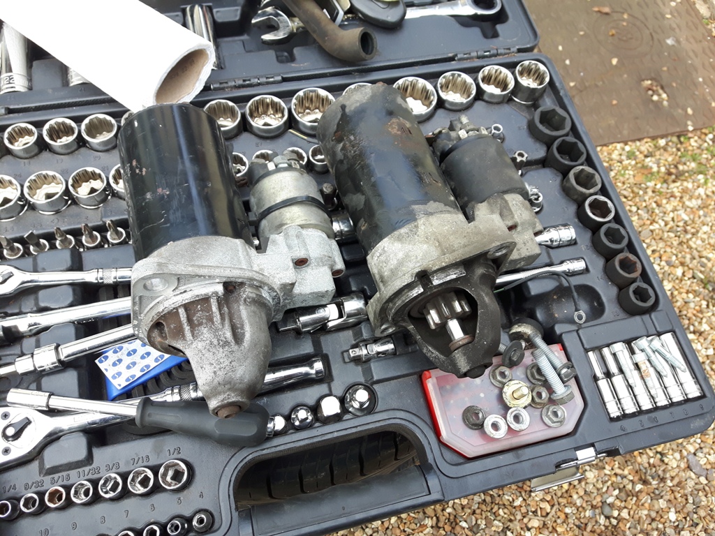

Removing it found that it is different from the 2001 unit bort arghhhhh
Tested old starter and solenoid on the bench and found to be fine. drilled out the dowel hole on the top and refitted

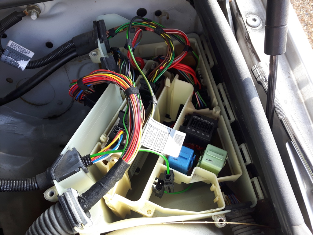

All went well but does he start? does he fuck! no click, no whir, no anything except light on the dash. next stop is the starter switch. No starter motor relay on these and no startey threads and questions are like a rash on da t'intaweb, Maybe lack of relay fucks the starter switch.
Ran out of time so rolled it to one side and revisit next week with multimeter and new second hand starter switch

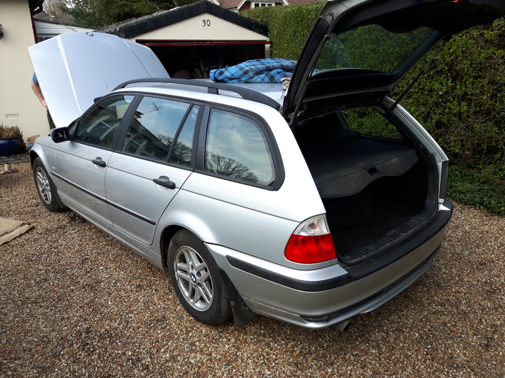

but just look at it!

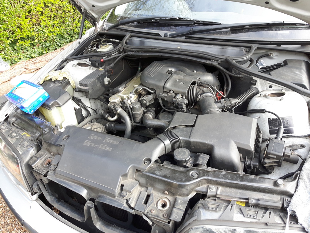

£100 and 3h work to deduce that the ignition switch is fubar* probably* I hope else I am out fo options

there is a second fusebox behind the glovebox hidden away,that contains 2 fuses related to the starter circuit,have you tried just dropping a live to the solenoid just to check it turns over on the car?also check the oil level switch on the sump,if thats faulty it wont turn over,you can simply unplug it then try to start.if it turns the switch is borked
Now that sounds promising. Loads of nice sensors all over the place when removing it.
I figure that I can get access to the starter terminals by removing the alternator. Long screwdriver wrapped in ductape and jump lead from the +ive terminal up by the brake master should see that discounted very quickly.
The car will sometimes start which might suggest an intermittent fault with switch or sensor. Oh the joy :D
