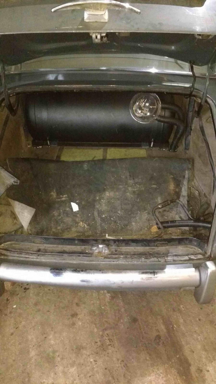

It's a saloon car, and there's always that bit between the wheels (right at the back of the boot) which isn't used much - so would rather than a canister I think than a donut for MOAR distance.  That said, I'm used to going to the petrol station twice a week.
