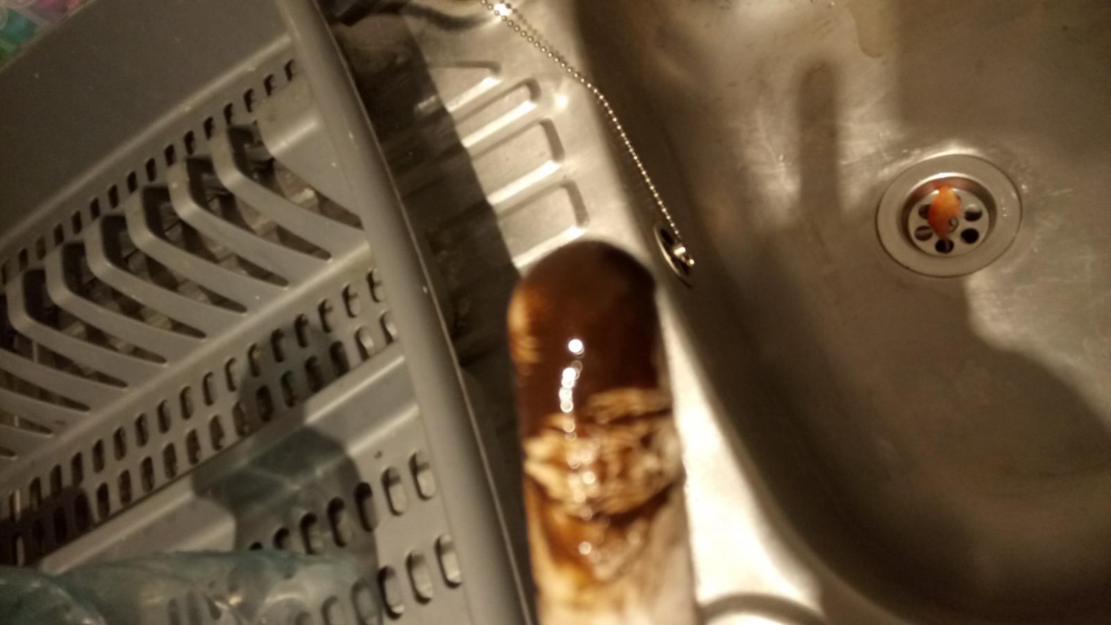

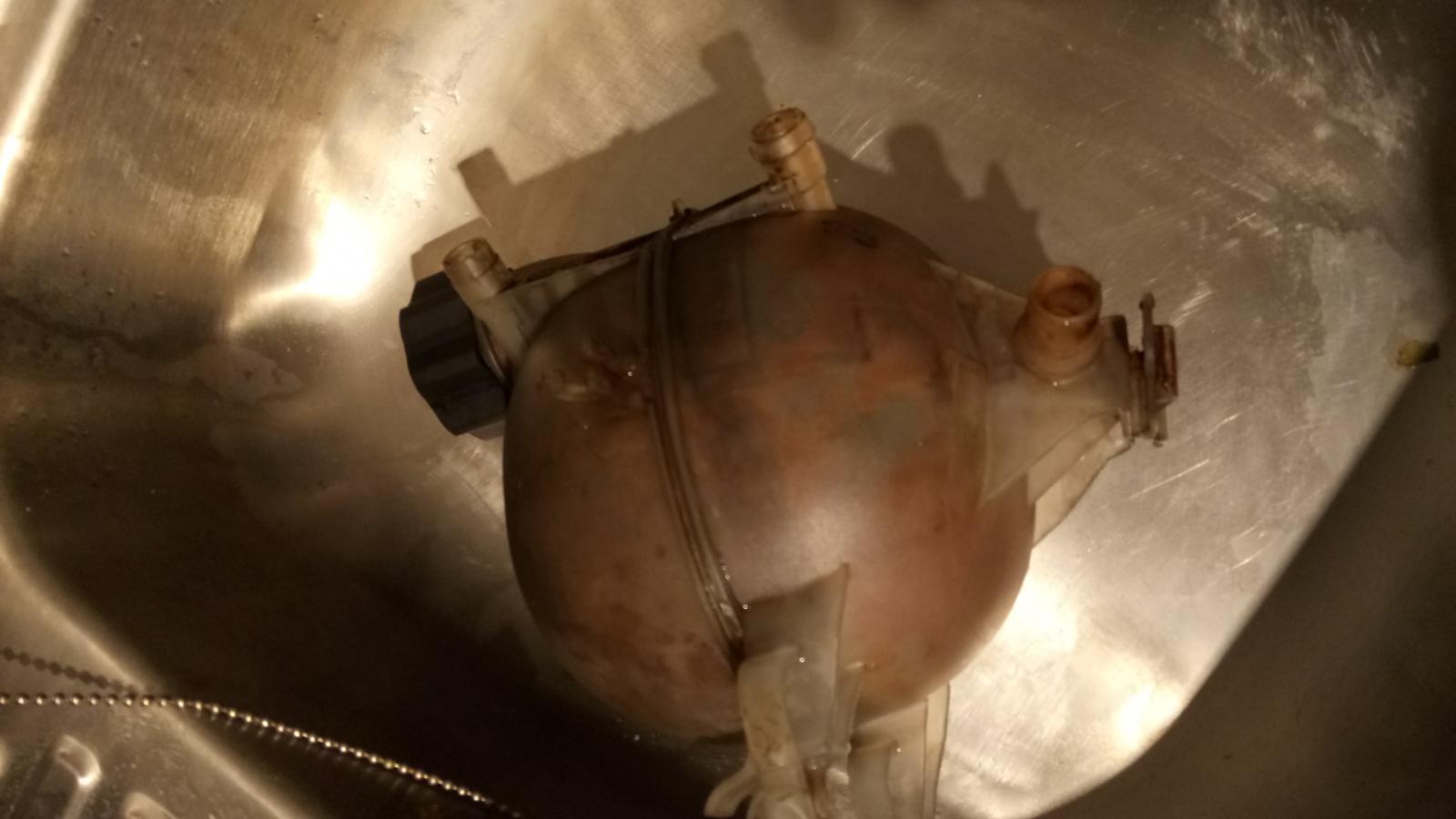

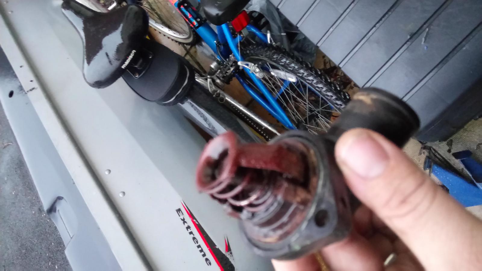

Right then. Today I have flushed coolant out, pipes and block. It had what looked like watery copperslip in it and some dark brown gunk in the pipes. Cleaned and flushed and fitted new stat. Bled it out and ran it up to to temperature. Sat at 1 bar. Took it a run round the block and it ended up at half way on gauge and settled. Heaters feel warmer and no overheating. I doubt it is hgf or I'd have thought it would be showing either more on gauge or some other symptoms. Coolant is warm now too

Coolant that looks like dark brown gunge and watery coppaslip?  Someone's chucked K-Seal in that, the cheeky feckers.

A few pics of the old stat, some gunk out the pipes, interior of coolant bottle before it was cleaned. No steam or smoke more than should be for a cold evening.
I think a borked thermostat may have led top the false thought of OMGHG - hence K-Seal.
Definitely doesn't look like any hgf I've seen before to be fair. Not creamy coloured nor anything on dipstick. There's more mayo on wife's vectra than on filler cap too
