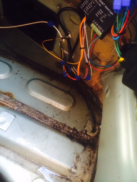

So I decided to have a crack at finding the leak in the boot this morning
I got rid of the soaking boot carpet and put it in the garden to dry (lovely white mould all over the back of it) and set about taking the light clusters off to see if anything was amiss there.
This was the water ingress.
Bingo. This looks like the culprit
The rubber gasket around the light cluster was broken, apparently when they were made, rather than using a one piece gasket, it had a join in it which invariably split over time. This had happened on both sides on my car.

Well bought, that looks class. The mirrors should be an easy fix. Pop the controls (window switches and mirror panel) out of the handle on the door card and disconnect the plug into them. The contol's can be separated, there is little clips to take it apart. I use a rubber to clean the contacts on the underside of the circle mirror adjuster and bingo, all working. I move the mirrors about every few weeks and it has not happened again.
Boot leaks are common. You have replaced the gaskets so good start. Check the chrome trim along the middle has the nut and the foam washer behind it. These are the two rearmost each side of the car behind the carpet trim in the boot. Water can also get in from under the trim and the bottom of the rear screen. I used this to sort that - http://www.tcschandlery.co.uk/capt-tolleys-creeping-crack-cure/p8460?gclid=COLMm_DC6dECFam87QododUE2A
Lastly the seams under the screen that come down towards the rear lights can leak, mine did and this is where most of the water got it. Good luck with finding them, takes a bit of time.

The chrome trim nuts seem to be dry, the leak is coming from higher up on the car, as when it chucked it down yesterday afternoon I stuck my head in the boot and there is a constant drip from just above the passenger side light cluster, it seems to be tracking down from the bottom left of the rear screen. I'll probably try and get the chrome screen trim off and reseat it with some sealant. Is it an easy job to get off?
I would'nt take the trim off at the bottom of the screen. If (and they will) the clips break i believe you refit them the screen has to come out. Seems your leaks where mine did. If you carefully lift the rubber part that the boot sits on, clean out all the muck then use the stuff i put a link for around the clips that should work. Mine leaks a bit bit its miles better than it was, and the boot liner catches the wee bits. I would also check the sealer on top edge of where the hinges are. Mine had a small hole at the top and again at the rear light cluster. My paintshop pal used some sealer on it and once it was dry i painted it so it looked better.
