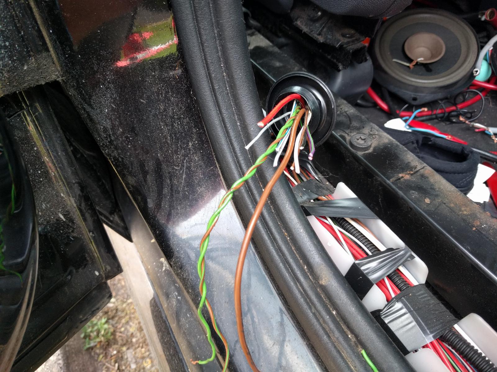

Hi mate, I work for vauxhall, this sound like you have have a broken wire in the wiring between the B post and the door. If you open front door you can get in and release the wiring plug from the rear door, pull the rubber back and you will see the wires snapped or exposed and touching.

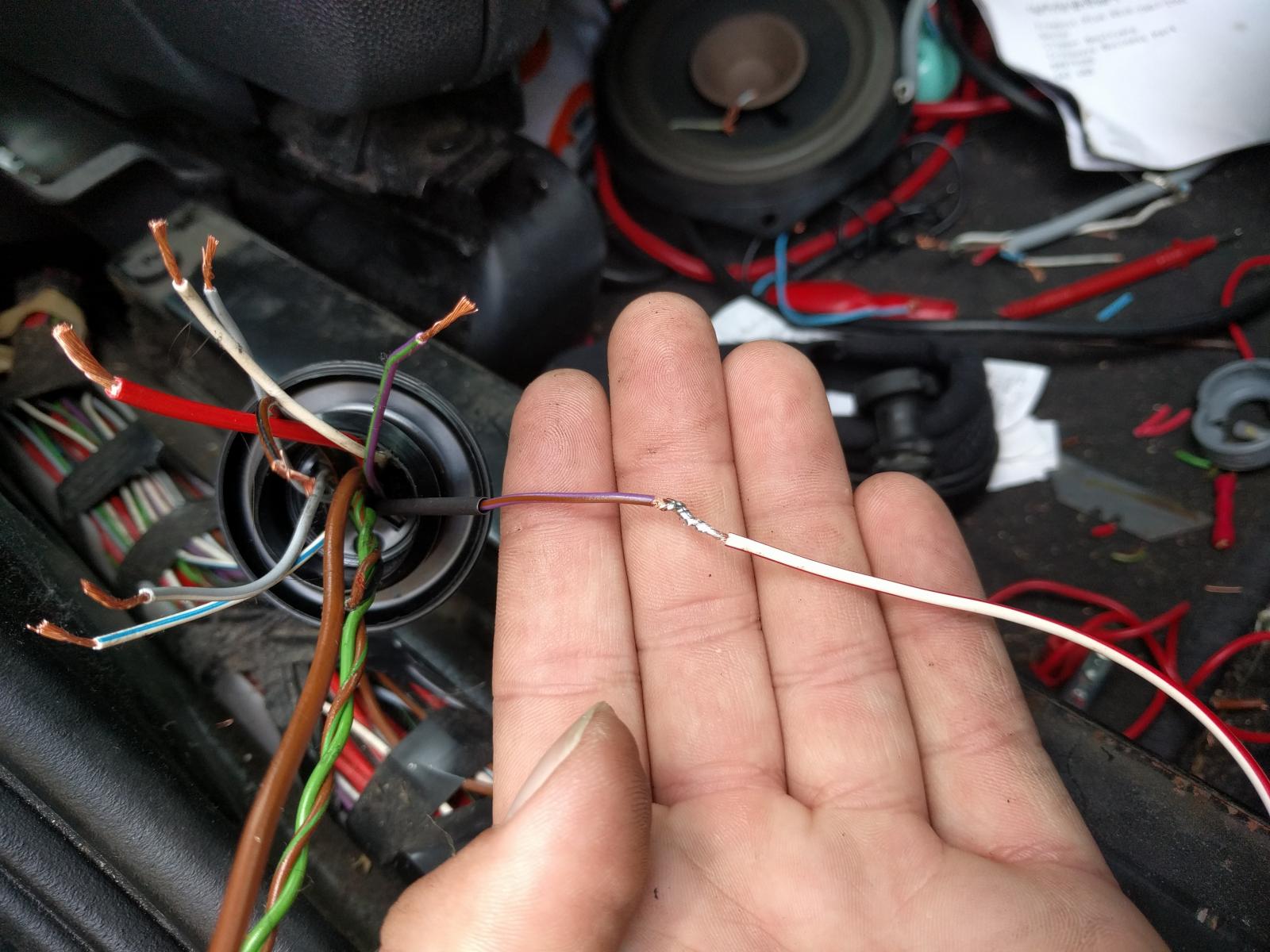

Yep, 4 were fully snapped. About to go into town for heat shrink as I've run out and it's all getting nailed back together

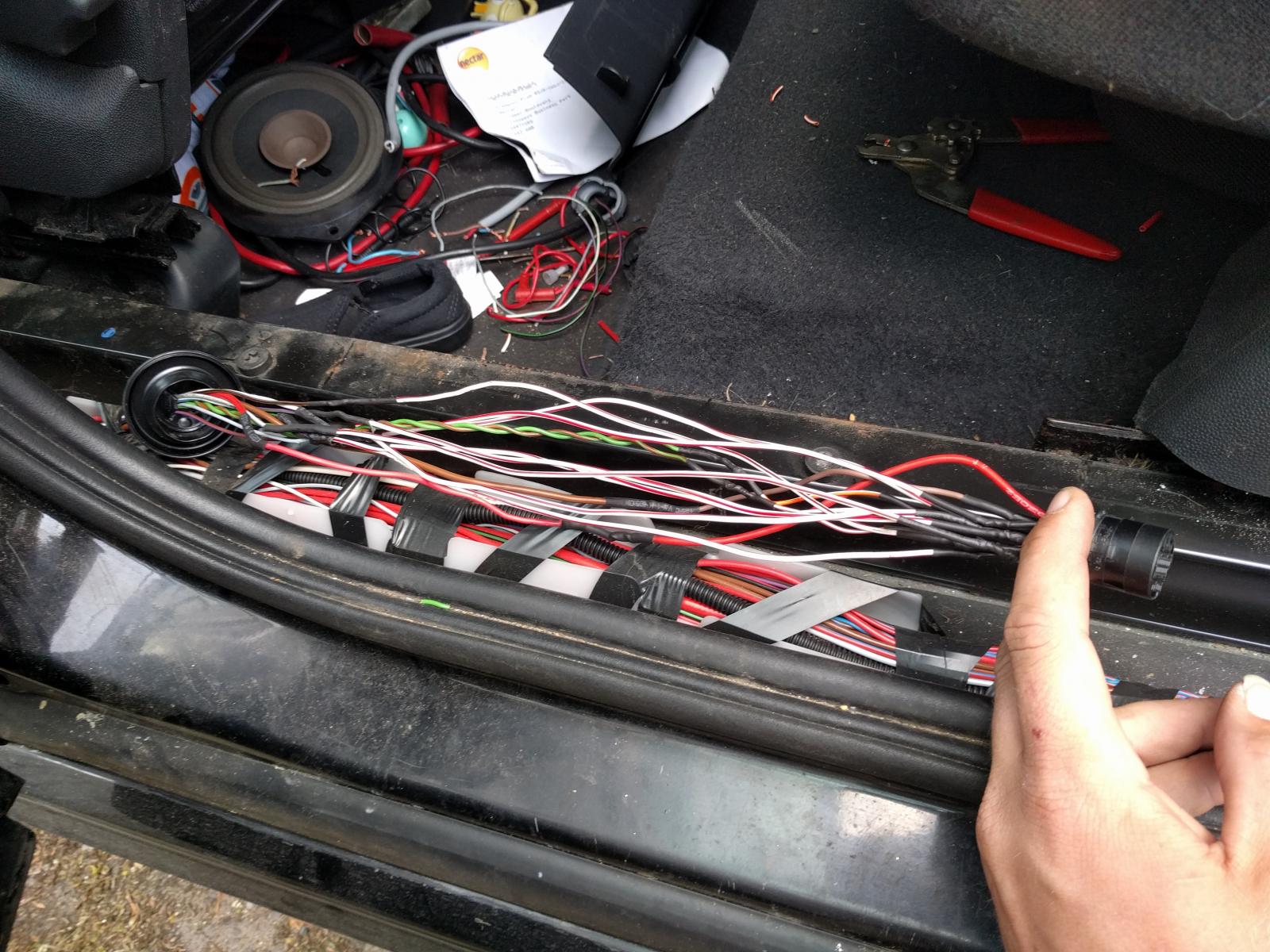

This was my 'get it working' repair

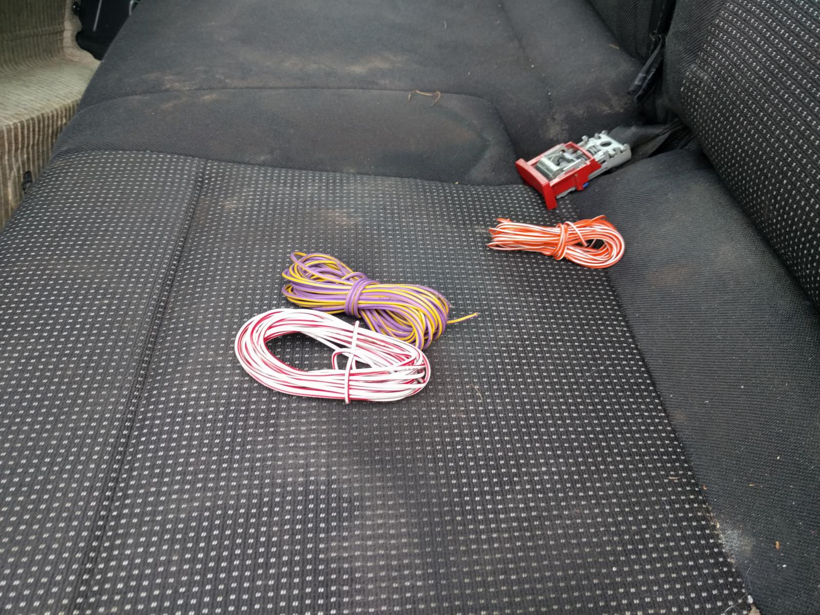

Some suitable wire was procured
And I chopped nearly all the wires back to inside the car bar the thick brown one and the speaker cables.
I spent an hour performing my best soldering
And my best heatshrinking
And before long had the loom rebuilt. Some old cable from a dyson dc25 spinal cord was used for the thick red and brown lead as I figured 240v wire would happily take the full 12v feed, the thinner wires are signal wires I think for various systems

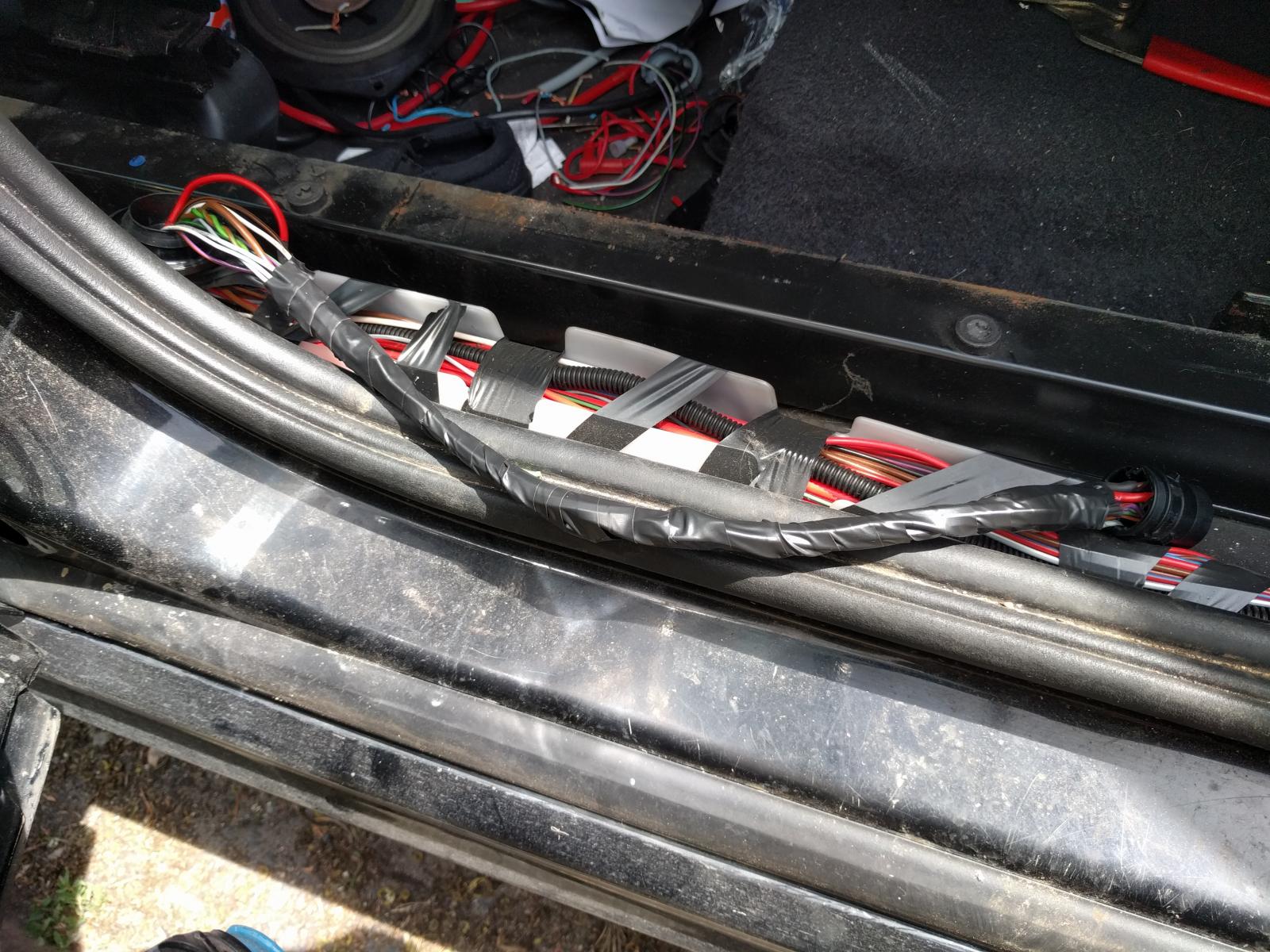

I then wrapped the loom in tape
And fed it back through the car into the door, and taped the rubber cover back on. No idea how long it'll last, should be a fair while but now I know to just pull the whole loom back through the car if it goes again, doing it again shouldn't be the end of the world. Its got to be as good as the official repair part which is just a new plug and lots of wires that need crimping onto the car loom!

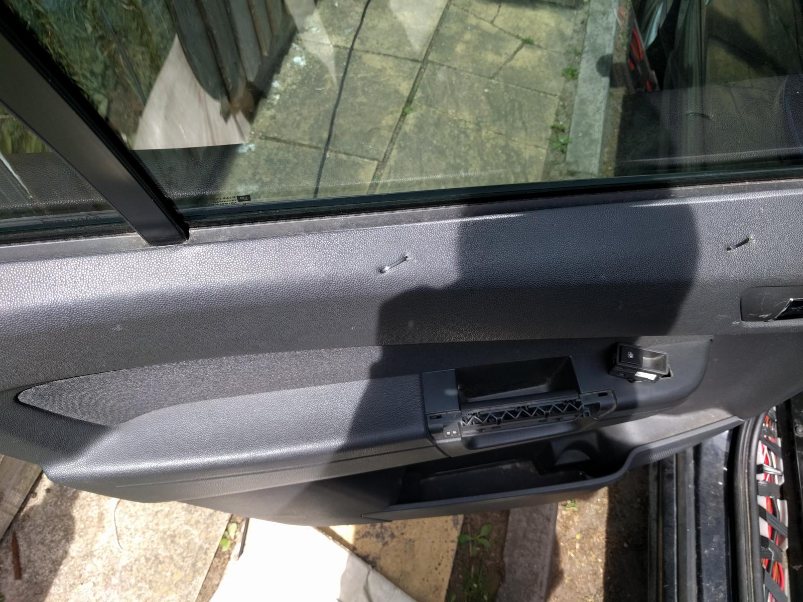

I then took the chance to fix the door card, the glue has failed that sticks the card to the mounting top plate
So I affected a seamless repair
