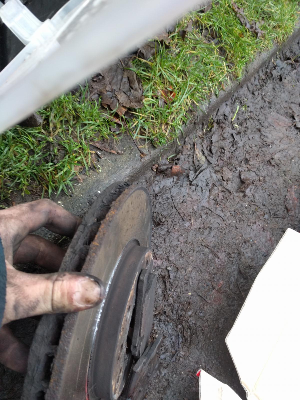

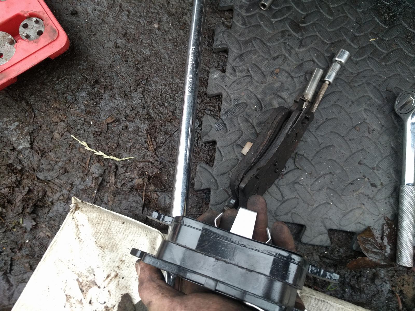

This was one of those jobs that was made 40x harder by the fact that I would not be surprised if they haven't been apart before, or at least not for the time amys sister owned it.  Removing the pad retaining bolts was a faff, good old Vauxhall, leave the end few MM of the bolt in thin air, so it can rust up nicely. Had to use the breaker bar for the ENTIRE length of all 4 bolts... Which cleaned them up nicely and they went back in fine. Then it took 8 different torx bits before I finally found the one that hammered in the best and cracked off the disc retaining bolt
Then the disc tried to laugh at me by not coming off the hub but I gave it a massive smack and told the cunt who was boss as it tried to land on my foot...
New discs on
Again the pads had life left, but not much
Done! Caliper slider bolts cleaned and greased, and both corners bled, so this has all 4 corners bled too
The massive lip on the discs was the main reason for changing them, I'd just been putting it off until it was cheap to do, and £46 all in sounded fair enough to me

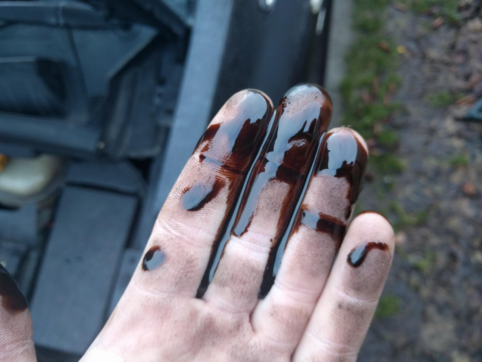

Oil time! Fuck it was cold this morning, the defrosted windows was me turning the car on to warm the oil up a bit
Stuff! Yes blah blah expensive oil... it was cheaper than the triple QX the gooner got in it's grade, so rah
The oil smelt a bit burnt, probably not surprising given the crap we know is sitting on top of the engine quite happily
What wasn't so funny was the sodding oil filter was probably older than Eva, and came away when removing, so I had to spend 10 minutes carefully smashing the top piece off without fucking the filter housing
Much better

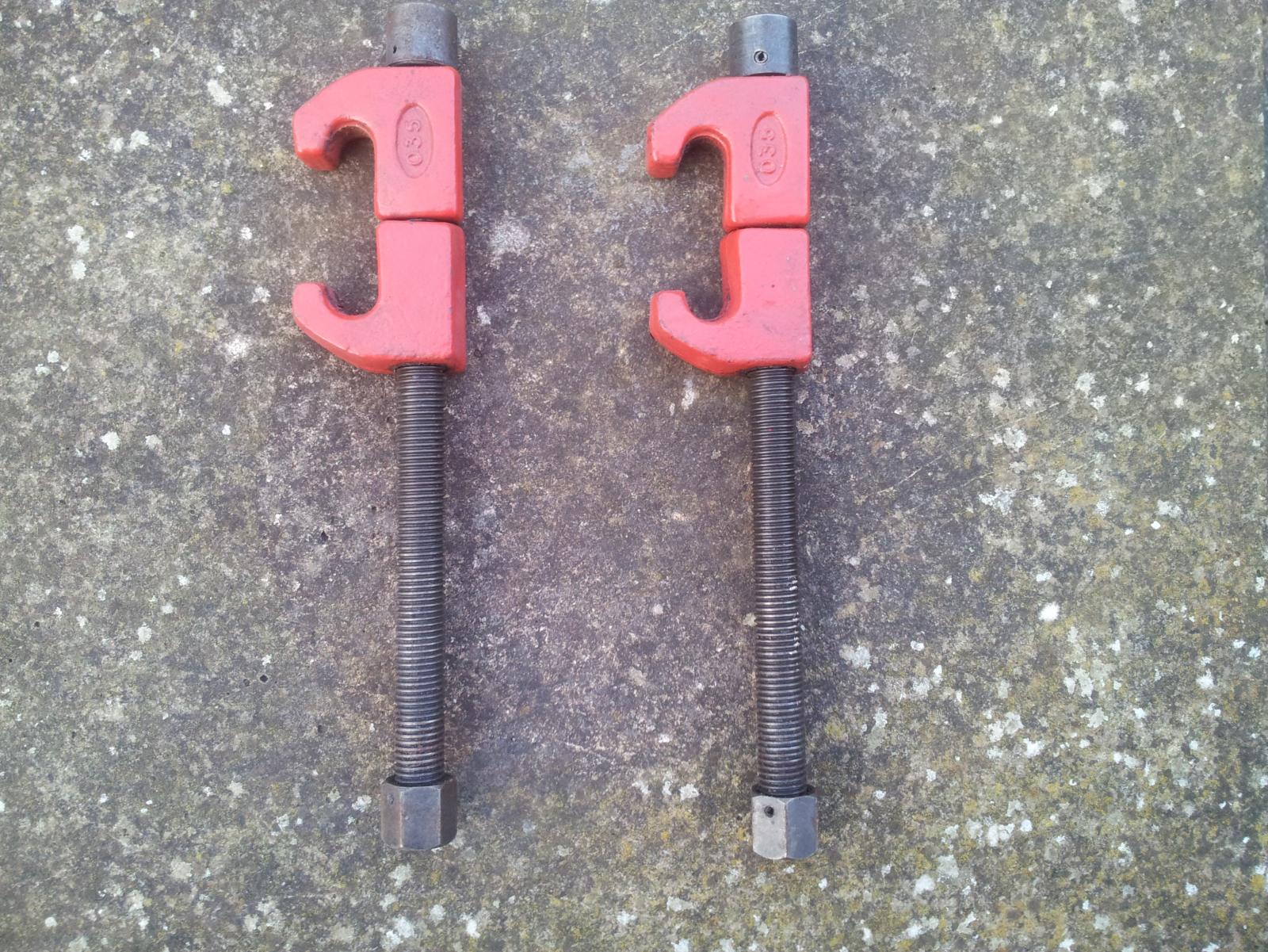

Yes there's a set for a tenner on ebay, if I keep it pointing away from my head I'll risk it. Was half hoping someone right local to me had a pair I could pop and borrow!

I can post out for free from work if that helps?
Wouldn't say no! Seems a bit of a waste buying a set and potentially never using them again... How quickly would you want them back though? Aiming to do it next weekend

and I'll need a set of spring compressors, unless anyone here would be willing to lend me a set if I pay postage both ways? I've read the stories on here about how fun* they are, so that's something to look forward to.
I have a pair you are welcome to borrow.
Cheap and nasty but have worked well for me in the past.
Heavy = expensive to post but since you're only a tame oxen you appear to be not far away from the silver's gaff (in Buckingham, not far from Six-Cylinder's Field of Dreams). Maybe if you are up this way some time you could pick them up.
Let me know if this would be useful and I will PM you the address.
You could also have a sneak preview of the remains of Bob the Renault 6 while you are here.
This could work, I'm off to Peterborough this weekend, and although tomorrow might be tricky as we won't leave until late, I could divert Sunday on the way back? Might be tea time though? I'll be coming through mk, it's not far from there is it?
Then I'll drop them back at some time another weekend, when I can stay and give Bob a lick
