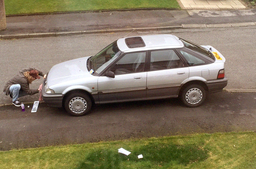

Plates and stickers also arrived today:
No pics yet as I've only got the front plate on, didn't have enough adhesive strips for both. Also, the Lex Service sticker is a little off centre - you can tell because of the window washer jet, so I want to adjust that too.

Plates:
Great job from DMB as ever. I think the rear one might be slightly wonky, and the off centre Lex Service sticker will have to stay as it can't be removed easily. I like how it looks now I've tried to remove and re-apply it though, weirdly, so it's alright. It's mad how much difference they make...
