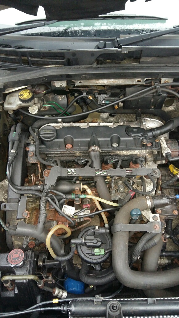

dean36014 Posted January 4, 2017 Author Posted January 4, 2017 Well trouble and worries ahoy. It turns over very slow even with a new battery, and doesn't like cold starting either. Praying its not compression related but its not blue smoking on start up. A quick read on tinternet reveals the hdi using some electronic wizardly so the glow plugs only work under a certain temperature. Going to bang the fault code reader for a start and see whats what. I think the starter has seen better days too, no receipts found for a replacement so think its original. I have a spare starter of the ex Beko ZX and according to ECP theres a 50 50 chance of it being the right one. If it turned over quicker it would probably start easier. In other news the indicator stalk/light switch is typically french and playing up. new one ordered for £20.
SiC Posted January 4, 2017 Posted January 4, 2017 If it has loads of receipts and then none for starter, then it's probably not been replaced? If so, it's probably done a lot of work over the years! Also given that it struggles turning over (and smoothly?), it's an indication that compression should be good? KruJoe 1
Cavcraft Posted January 4, 2017 Posted January 4, 2017 What's the top end noise? Hopefully something minor like a pulley if it doesn't get worse with revs. Braddon81 1
dean36014 Posted January 4, 2017 Author Posted January 4, 2017 It seems to shut up with revs. I'd say hydraulic followers. Got a fault code of p1351 which is surprisingly glow plug related. Might change the relay to start as it's had recent glow plugs.
KruJoe Posted January 4, 2017 Posted January 4, 2017 Before you buy, you can check the glow plug relay with the aid of an assistant and a multimeter (or a bulb on a wire).
KruJoe Posted January 4, 2017 Posted January 4, 2017 ...on a wintery morning if it's only supposed to work when it's cold.
dean36014 Posted January 4, 2017 Author Posted January 4, 2017 I think the route of the problem is the slow starter motor, but it is showing a fault code. Will change starter in the week and go from there. Still love it though. Wonder what the difference is to the 110bhp hdi engine.

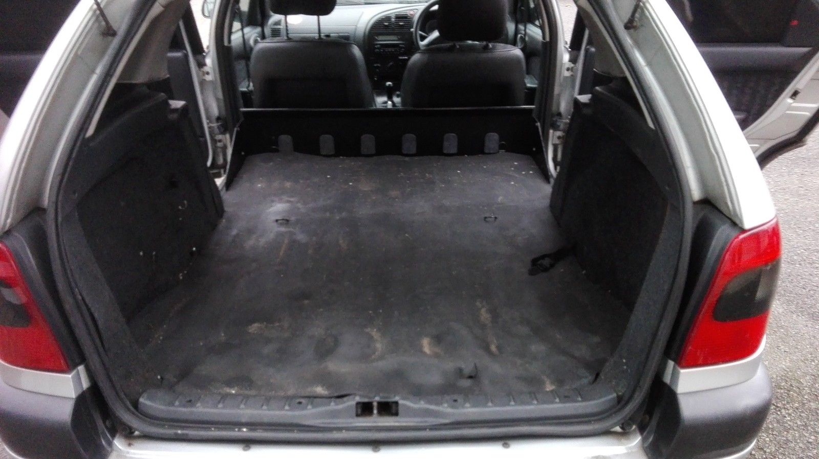

Jifflemon Posted January 4, 2017 Posted January 4, 2017 Kind of unrelated, but have you got pics of the interior - I'm curious how "van like" it is in the back, or weather its just "rear seats binned" BorniteIdentity and beko1987 2
BorniteIdentity Posted January 4, 2017 Posted January 4, 2017 Kind of unrelated, but have you got pics of the interior - I'm curious how "van like" it is in the back, or weather its just "rear seats binned" This. holbeck and beko1987 2

beko1987 Posted January 5, 2017 Posted January 5, 2017 I presume all the mounting holes are under the carpet for rear seats, seatbelts etc? They wouldn't got to all the effort of separate bodies for the van vs car would they? Do the back windows go up and down etc too? stephen01 1

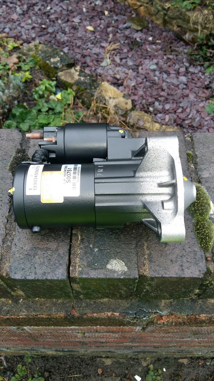

dean36014 Posted January 7, 2017 Author Posted January 7, 2017 Got the starter motor out of this today and typically its nothing like the one I have spare. Debating whether to buy one from the likes of ECP or take it down the reconditioning place on Monday and have it checked and rebuilt. It definitely looks like the original motor. I need to find something like an elasticated cargo net if they make such a thing, anything put in the back slides all over the place. There is little cargo eyes in the back to hook things to. I've replaced the radio display today so i can now see what station I'm tuned into.have a picture of a 271k engine, a few things look very rusty and need a clean down. Going to try and find an engine cover for it again. beko1987 1

dean36014 Posted January 9, 2017 Author Posted January 9, 2017 Well had the starter and checked and yes it was original and knackered!So now have a shiny new starter motor fitted and it starts pretty much instantly now. But I know can't get the bonnet open again, it release ok with the cable but won't release off the secondary catch. I think I must have caught it and bent it somehow. given up for today and will investigate another day. steveo3002, Braddon81, stephen01 and 3 others 6
