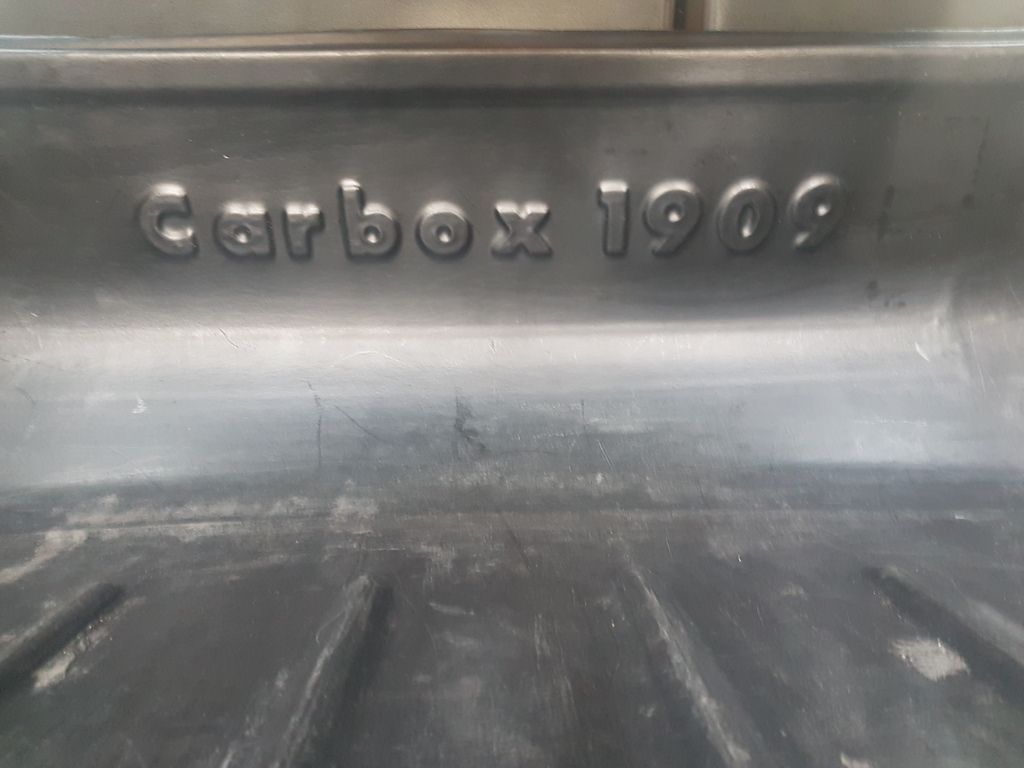

Barely used, still has the stickers and price on the back. 8) Judging by them, this 'carbox' company seems to supply the dealers.

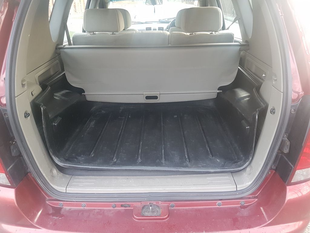

Perfect for wet and sticky dogs and the like.
I like boot liners.
Me too, and rubber mats/ #practical!
They're a pain in the arse when you drop the rear seats though, as you have to remove them if you want to use the full length (missus).

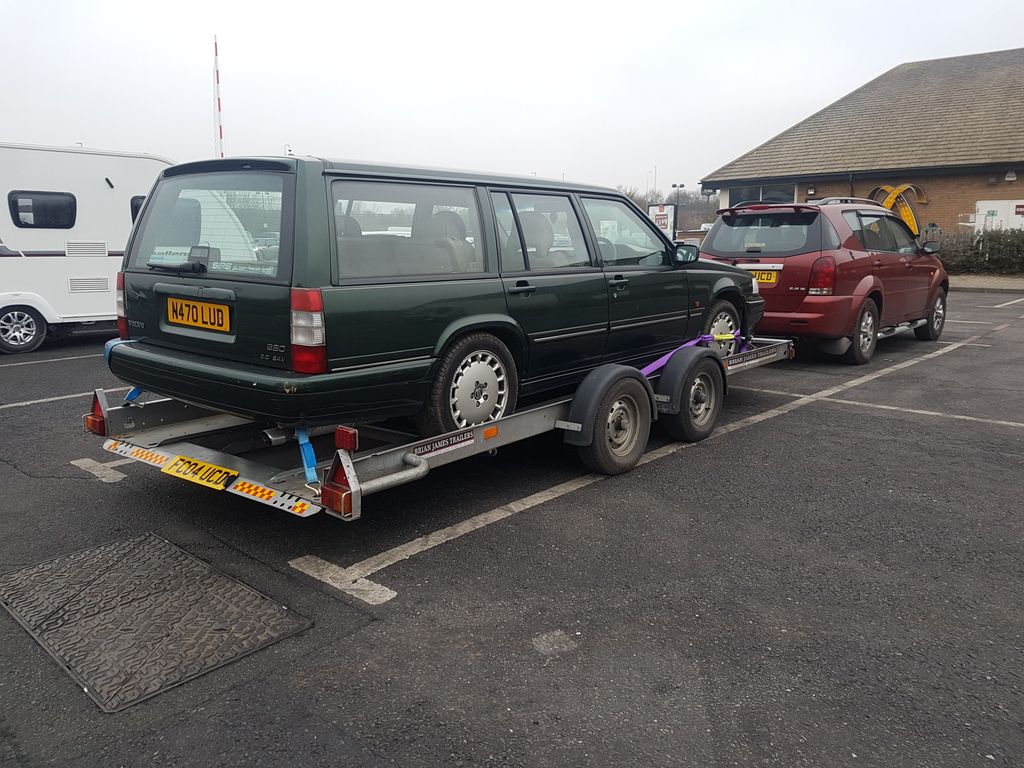

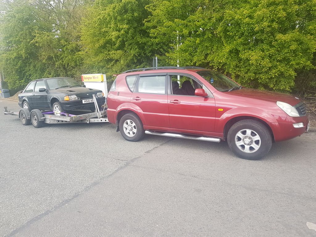

Been doin some load luggin. Truckasaurus Rex took it all in it's stride. :-)

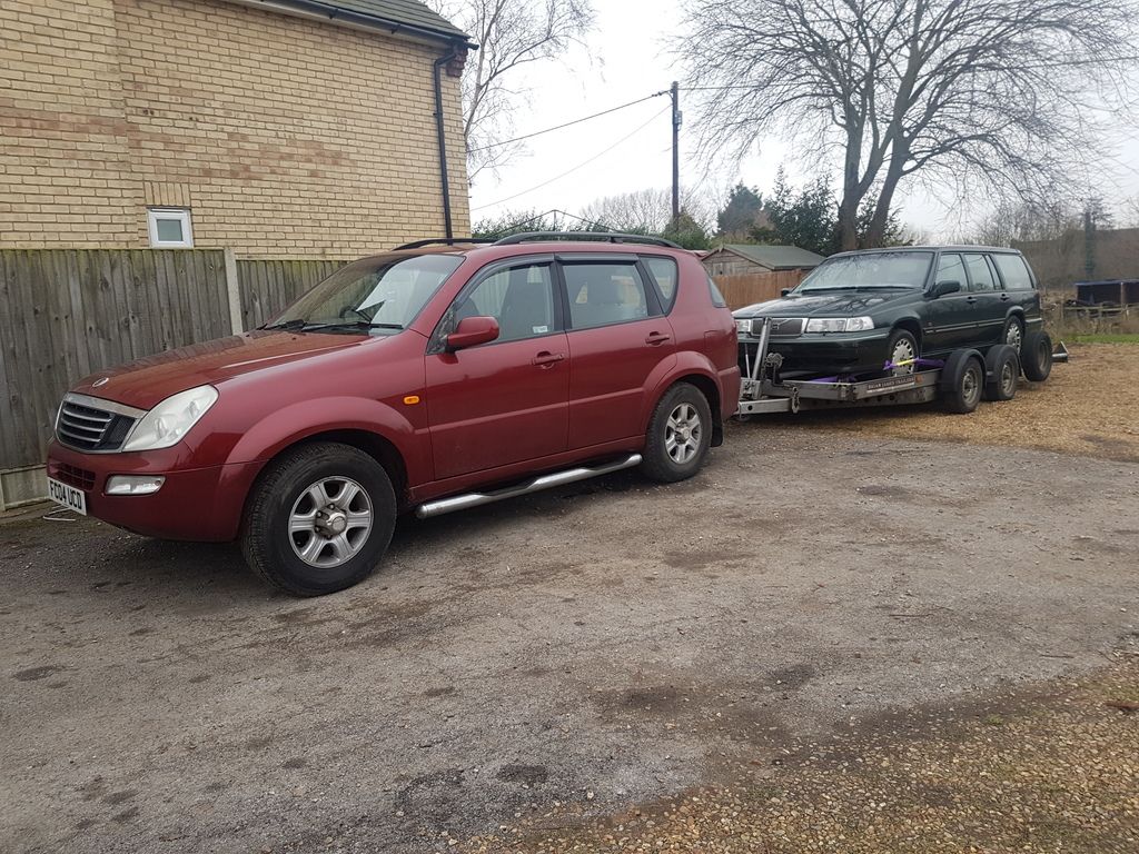

You may recognise the ex-alcyonecorporation and now filthy john 940. Or is it a 960?
Collected from Captain Slow_Towers, earlier today.
It was great to meet you and your eclectic collection, mate and your land.
All of the land.
Shame that alcygong wasn't around, maybe next time!

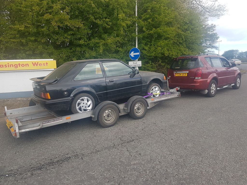

(This trailer sorely needs hole sawing to provide further tie down points for the wheel straps, but we managed.)

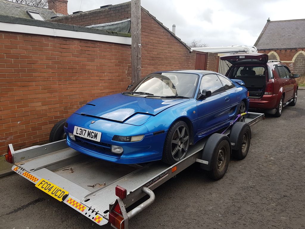

Did some shuffling about on Monday. (Only two wheel straps as I wasn't traveling more than 4 miles. Car is a bit far back, too...)
Where I am standing is the exact spot that the gearbox on my black turbo gave up the ghost, after the CV smashed a hole in it last July. The stain is still there!
This thing is so nice. It will be off to a new home once I have some time for it (and it is resprayed).

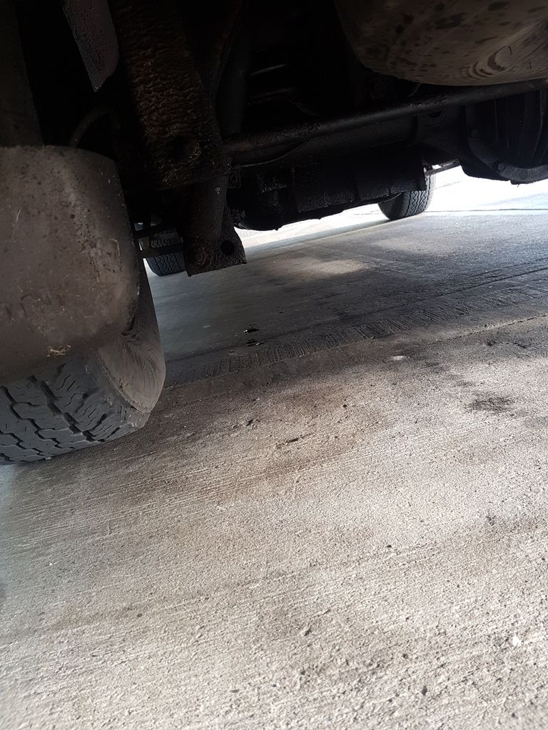

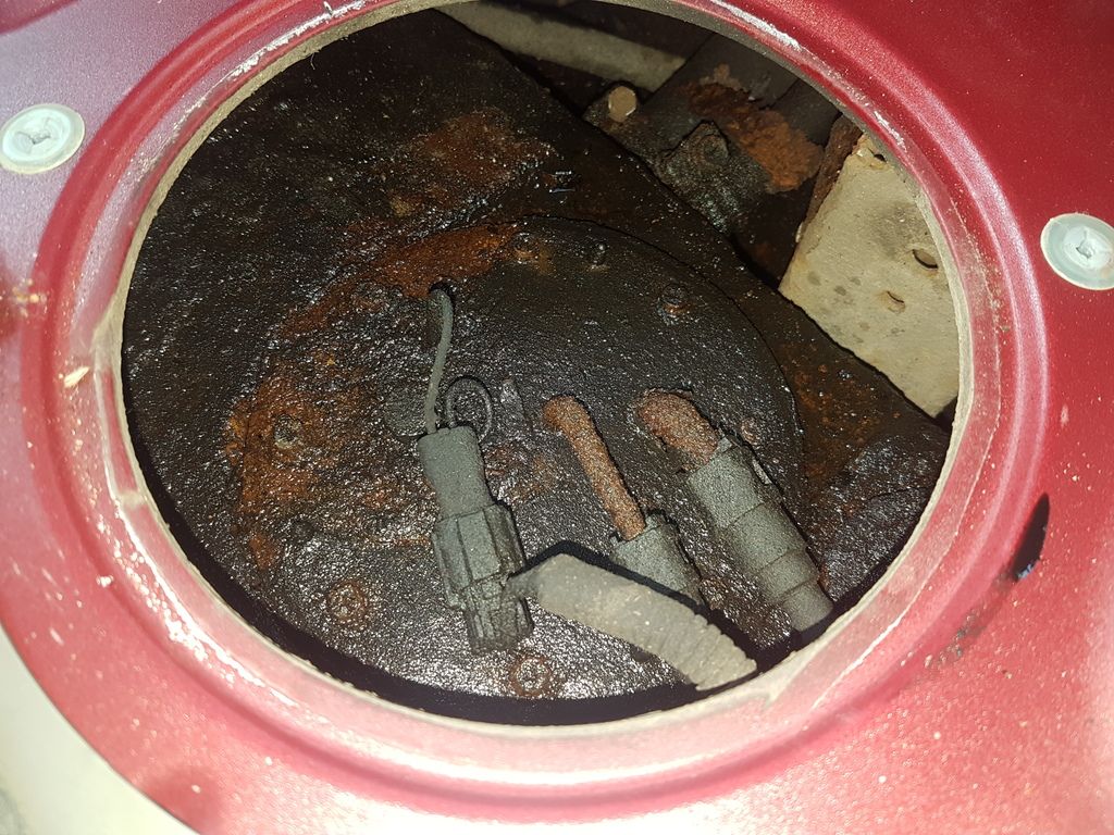

Zoom in for the drops on the ground. Sexy Rexy appears to have a leaking fuel tank!
Before buying it I noticed the tank was a little damp on the underside, but matey claimed ignorance to this, his driveway wasn't stained, nor the road outside, and it has never leaked in our ownership. Not until maybe a fortnight ago. I noticed a patch on the ground in the parking bay it is kept in, but forgot about it.
It's a fair bit bigger, now!
I'll smash it over my uncle's pit tomorrow, and see the state of play. Hoping for perished fuel hoses not liking veg, but not too optimistic.
Tanks are a fortune. Like £400. I have been looking at the kit that Frost sell, for liquid lining the inside of tanks and filling pin holes etc.

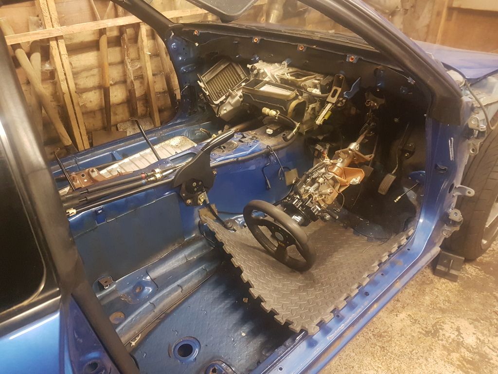

Pleased with my progress. Hope to have it gutted of everything useful and a few more things within the week, then the shell can go off and become a fridge in Hong Kong or something.

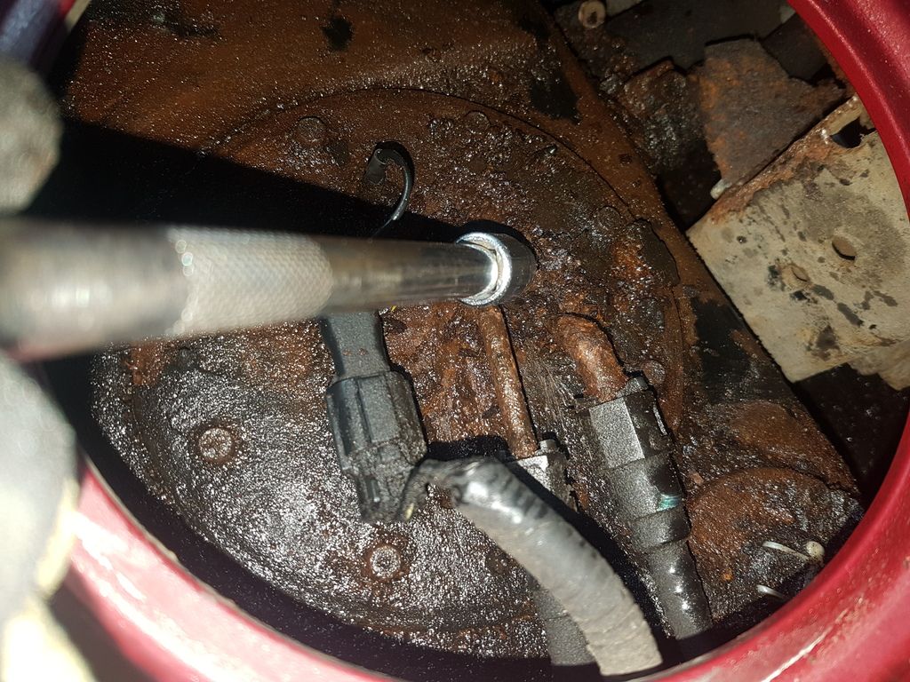

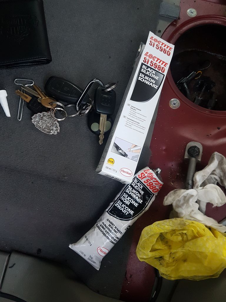

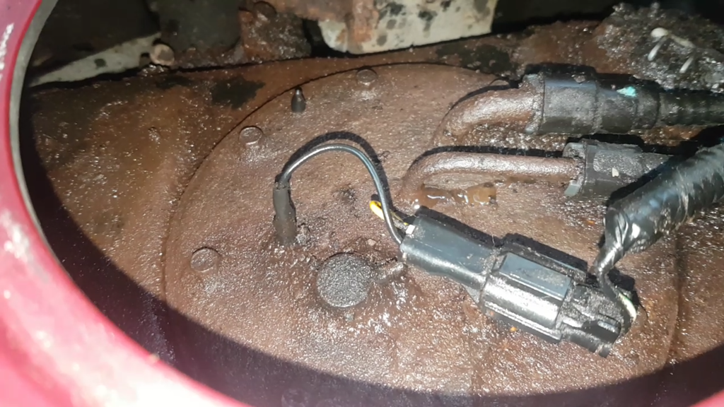

Once over the pit and with my heed up in the chassis, it became apparent where the leak originates. The fuel sender.
So it wasn't really leaking when not running, just dripping down from the bowl of liquid it had formed on top of the plate.
A bit crispy, as expected!

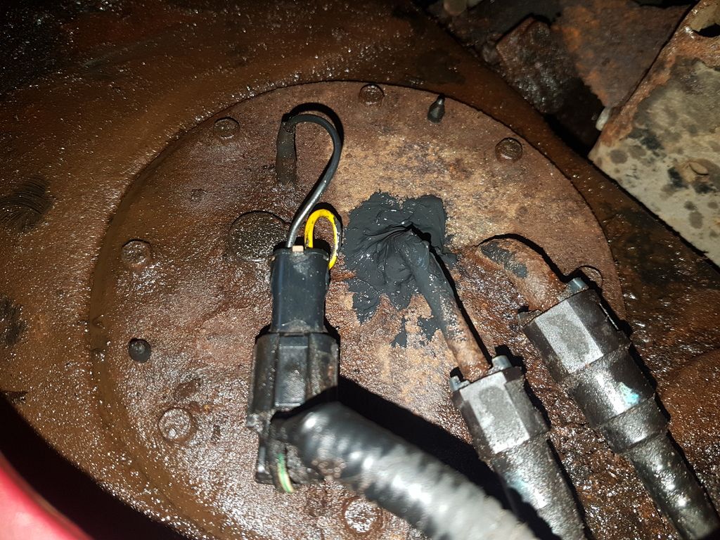

Scraped the shite off with a socket set as it was in the boot. Cleaned the area with brake cleaner. It's never gonna be mint lol.
Screenshot_20170223-144834_zps3l6jhzrt.p
Yep, there's your problem. Showed itself immediately after starting the engine. This must have been pissing out.
I hope this holds, senders are basically NLA. I would have preferred to use chemical metal, but I am not keen on rubbing back the affected areas, for fear of further perforation or worse.
It is leak free, 24 hours later. I'll keep an eye on it and my fingers crossed!
The tank doesn't look too bad to drop if need be, and I reckon I could mod the sender unit if it comes to it.
If it comes to it, I'm sure you could make a new sender out of bits of scrap metal, it looks quite primitive.
Yeah, something can be done. You know how it is though, it would be better if I don't have to!

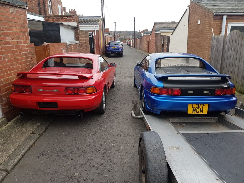

Dragged me S2 RST home today, to cut storage down to one space instead of two, and so I can get shot of it. It's all there and it's a good one, but I have no interest in it.
Ignore the ghetto strapping. We were just putting them back on, after inflating the tyres.

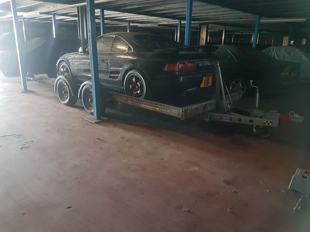

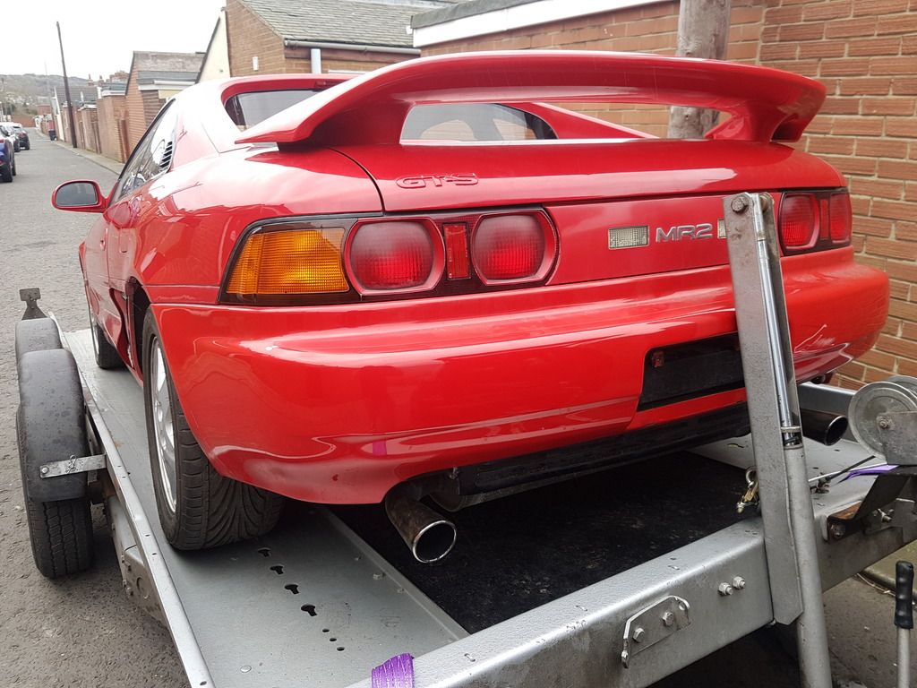

My MR2 turbo currently lives on the trailer, thus reducing my storage to a single space:
Not a problem, I have had two other MR2 turbo's on there, and with the trailer arches hinged down, the door clears the trailer tyre...
Not this one!
I had to squeeze out of the window, with my mate pulling my legs!

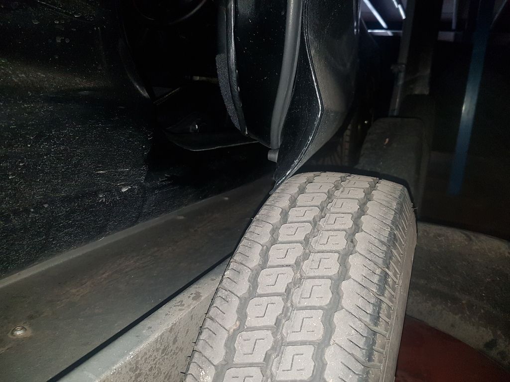

The car is running the standard black Billstein's and has Apexi springs, which as you can see are not silly low.
So this was unexpected.
I'll have a helper stick a jack under the subframe, or winch it on, next time. Lolz.

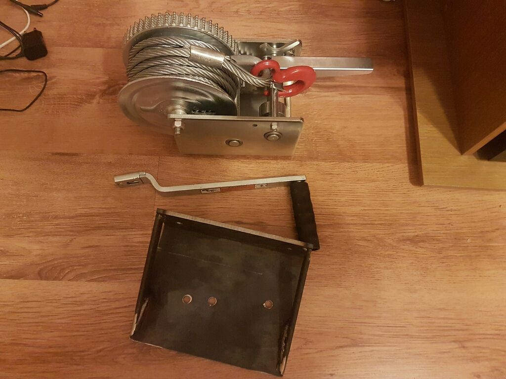

I will fit this beast when I next get time:
20170428_195901_zpsle1hudnd_edit_1493406
It is a 2500lb OE Brian James winch, with 8mm cable on a 6mm bracket. That aintt going nowhere.
I bought it direct from the winch maker (Dutton-Lainson), though.

Oh yeah, forgot to say, the fuel sender bodge works a treat and shows no signs of giving up any time soon. :-D
