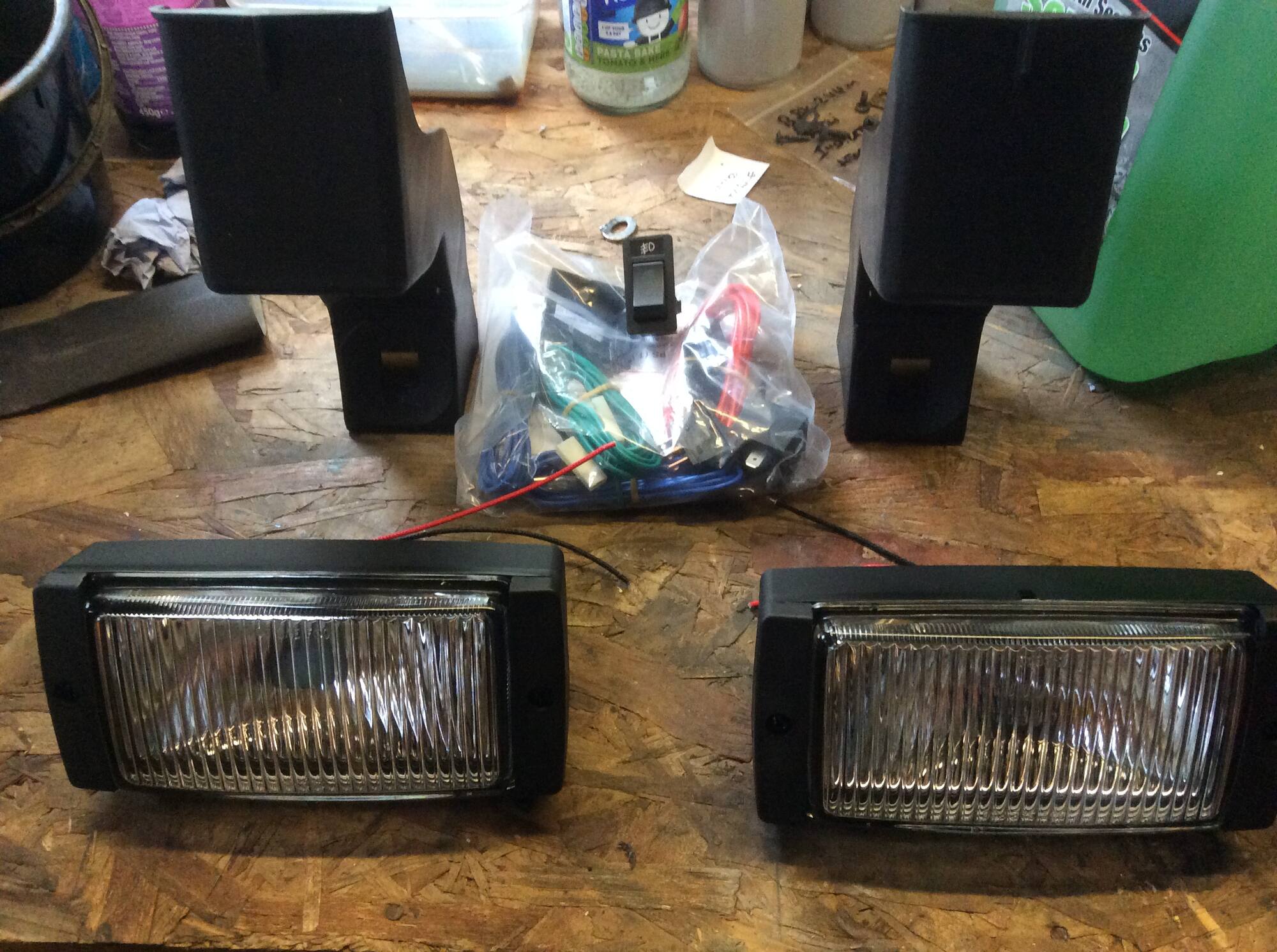

So, Heres the ingredients:

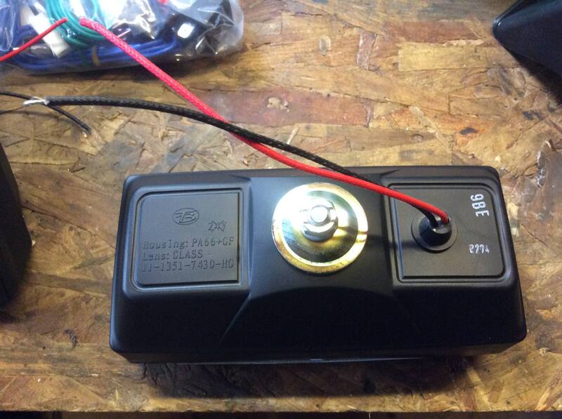

Two brand new fog lights, with the plastic holders and bulbs. These aren’t OE but are very very close. They seem about all that’s available anyway!
Two brand new plastic fog light brackets. These bolt onto the underside of the front bumper and hang down behind the lights themselves. The big bolt and cup washer on the back of the light then attaches the two together.

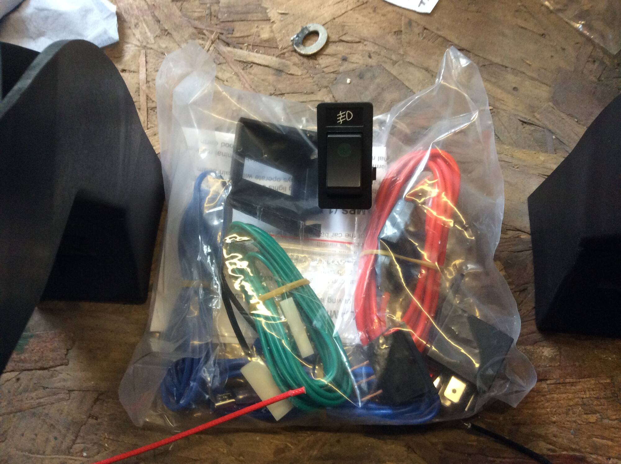

Wiring kit. This is just a generic kit off eBay for fogs, spot lights etc etc. It’s got wiring, in-line fuse holders and the relay needed to completely wire in a pair of lights. It’s also got a switch and holder but I’m not using that here as it won’t look original with that switch!
And finally, an original Volvo front fog switch with the correct logo and green led tell-tale illumination. This will fit in the dash next to the rear fog switch and will look like it was factory installed. At the moment there’s a blank fitted here with a red led for the now disconnected alarm. I’ll simply pop that out, fit my new fog switch in its place and probably tuck that blank and red led away behind the dash somewhere since it doesn’t do anything anymore.

So, time to start fitting up the front fog lights.

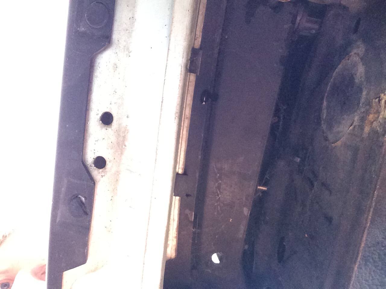

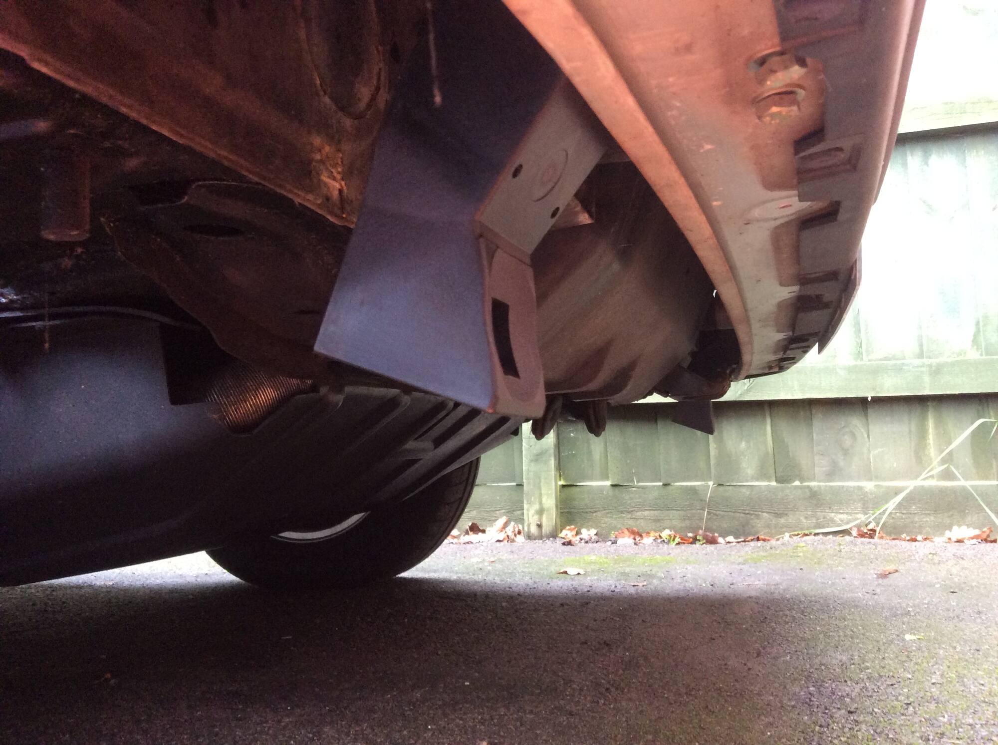

First job was to remove the front bib/spoiler/whatever the hell its called from under the front bumper. This is held on by six 10mm bolts with D shaped washers and bolts directly into the underside of the metal girder that forms the front bumper. At this point I’d feared the worst as 10mm isn’t very big, and these have likely been sat on the front of the car untouched in over 30 years now and were almost certainly going to be seized solid and probably snap off... They didn’t though! All six undid easily and without hassle, which is always a bonus.
With the front spoiler unit wrangled free of the metal lip on the bumper I could now see exactly how everything was supposed to fit. That’s the good thing about using parts designed to fit this car and not generic aftermarket stuff! Looking up at the underside of the front bumper showed the two (per side) holes already drilled in the bumper to take the fog light mounts.
The bolts, washers and nuts required for this don’t come with the new parts I’d bought unfortunately so I had to scrounge some suitable ones from my toolbox ‘odds & sods’ draw! Never throw anything away!
Heres the bolts, washers and nuts with the light brackets.
Then they just bolt on so they hang down ready to take the lights themselves. They’re actually very awkward to get a spanner onto the backs to hold the nuts as there’s not much space and it’s an awkward place to bend your arm to hold it. The bolt heads will be hidden by the lip on the bumper and spoiler afterwards. There’s also a lot of adjustment in these with elongated bolt holes so you can align them properly after it’s all fitted.

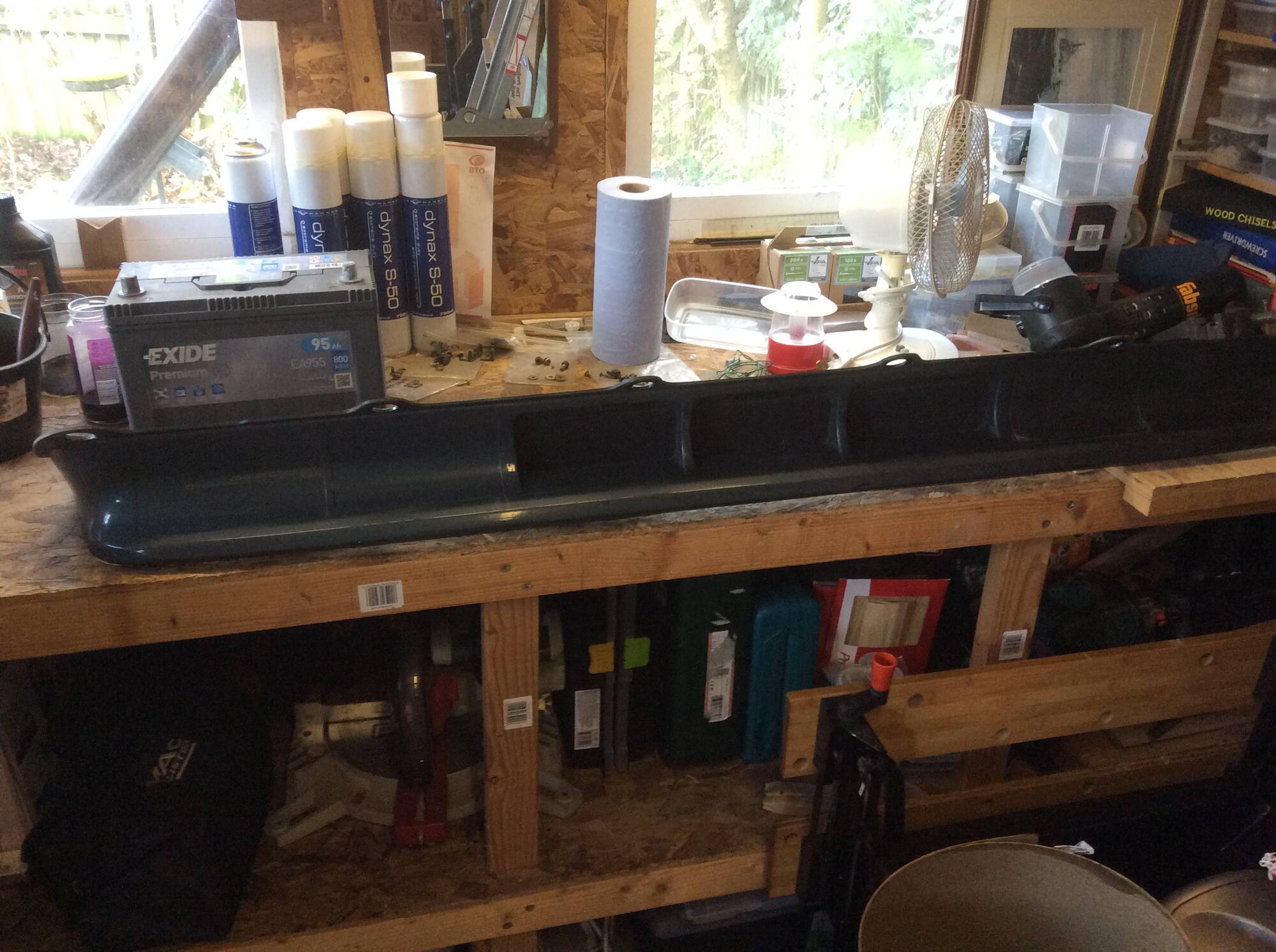

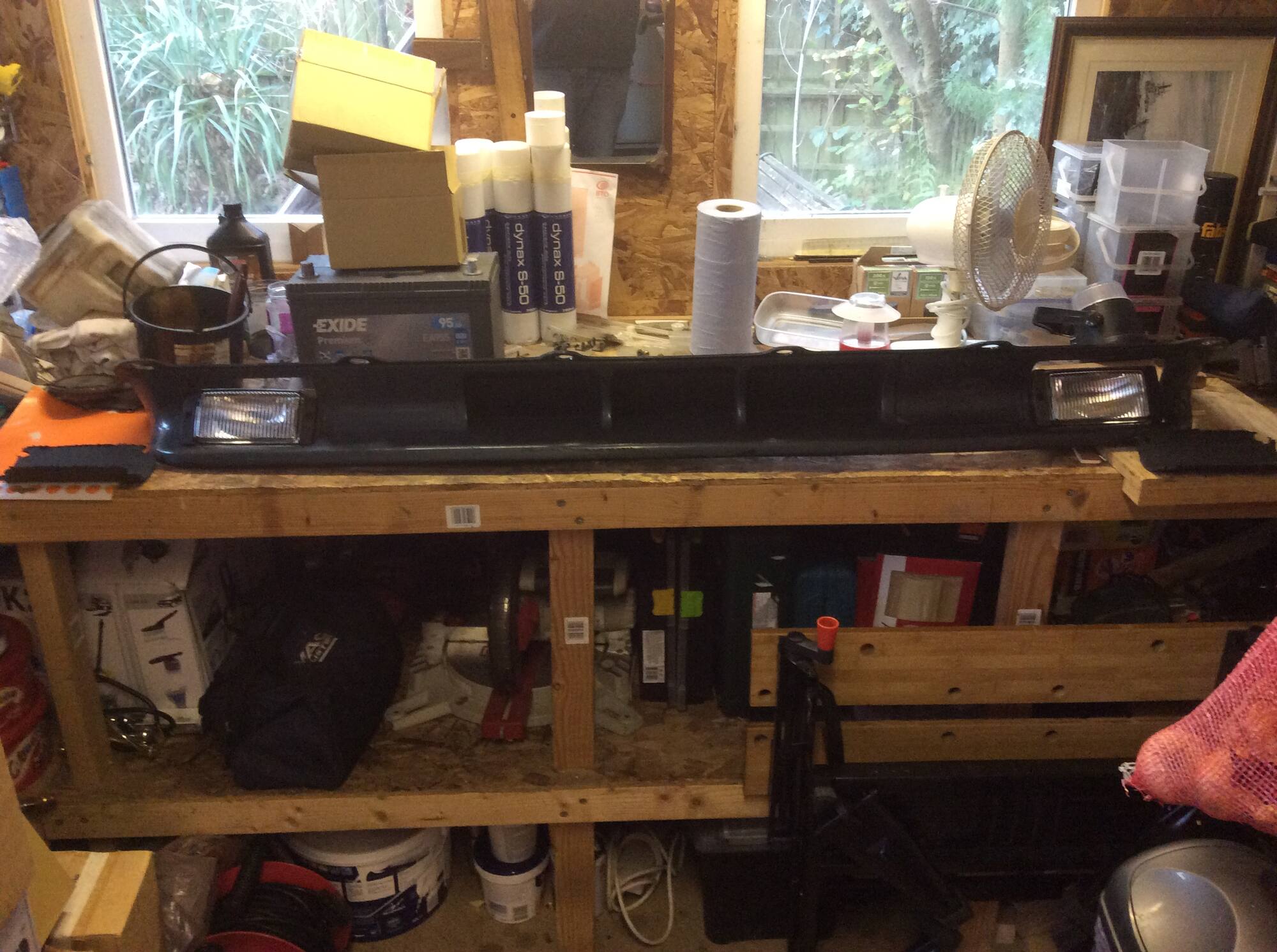

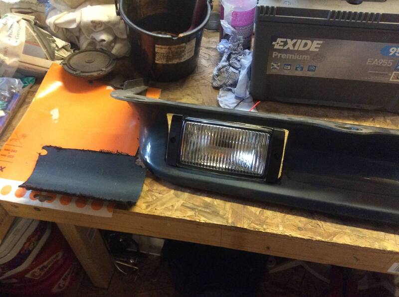

With the brackets both fitted it’s time to modify the front spoiler.

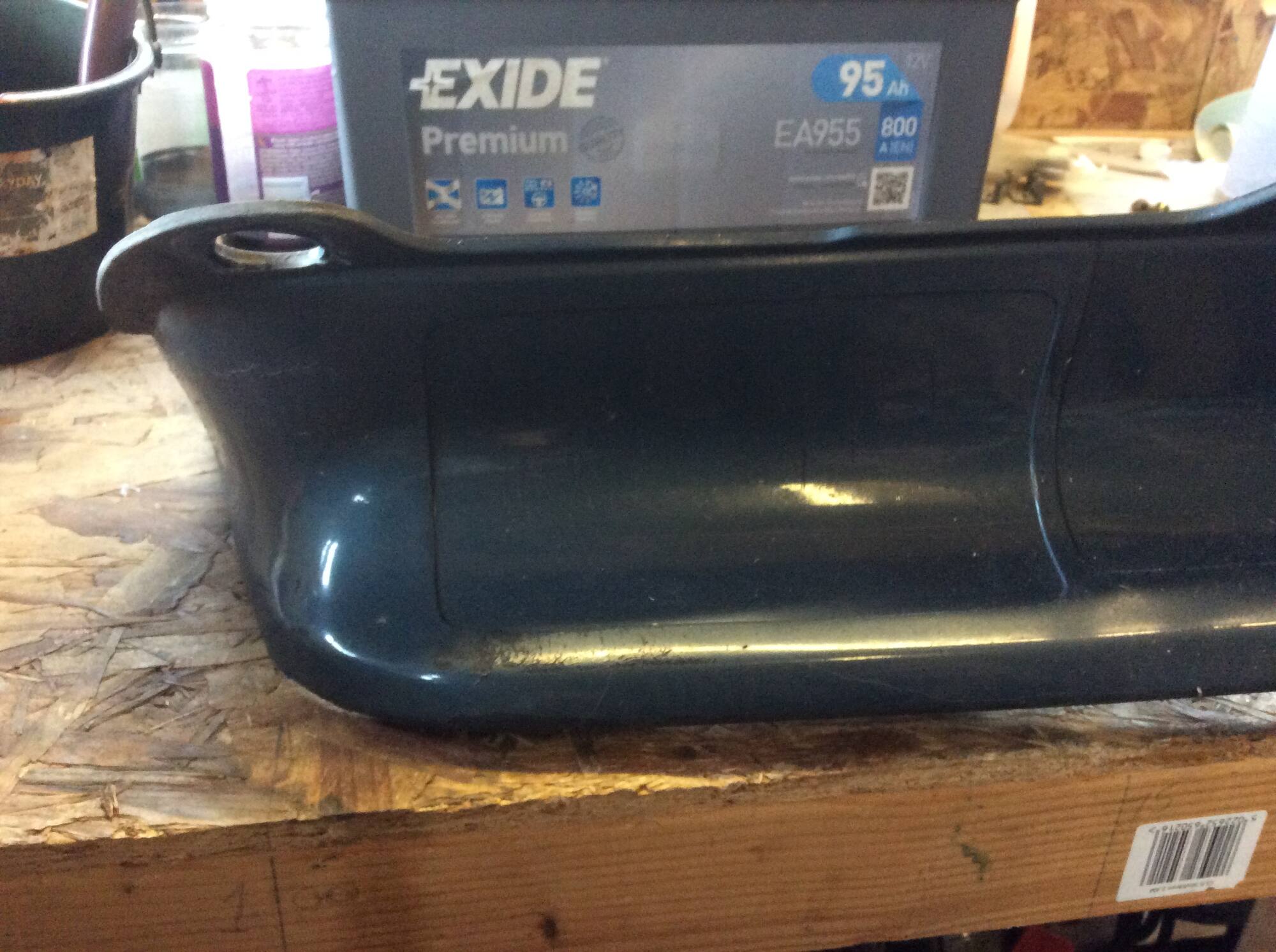

You can see the moulded marks in the part where the fogs would usually fit but, bizarrely, they didn’t make them simple pop out panels like they have for the front tow eyelet hole and additional centre holes (which presumably are for turbo models additional cooling?) So, being moulded in, that means they need to be cut out.
Luckily, on the back of the spoiler there’s some moulded edges for this that can be used as a guide to help cut them out.

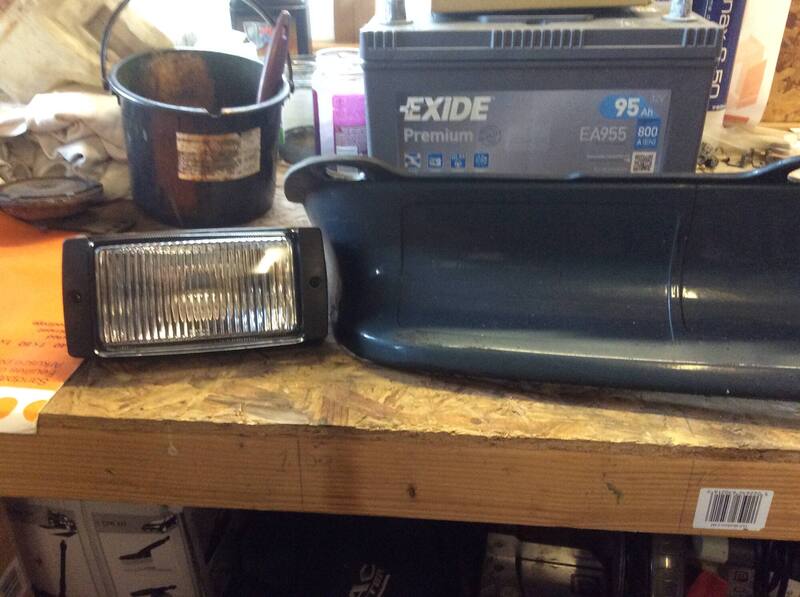

Here’s a light unit and the spoiler to show the sizing.
Cutting them turned out to be a bit of a pig! The panel is curved so a jigsaw etc won’t really work. I did try using the dremmel with a thin cutting disc but that just started melting the plastic and shattering the discs so in the end I had to use a big drill to go through each corner then use a fine hacksaw blade to cut out the bulk of the material, using the moulded edges on the back of the panel as a guide for size and shape. Once the bulk of it was cut out I used a Stanley knife with a new sharp blade to tidy up the edges and finally a file to finish up. A round file did the rounded corners.
It’s actually not something I like doing, cutting big holes in old hard to get parts like this! I googled lots of pictures of cars with the lights already fitted and offered the lights up several times, just to be absolutely sure it was right then just had to go for it!
The spoiler is a bit scuffed and scratched tbh, and it really does need rubbing down and painting fully. It’s not really the weather for that now though, too cold and damp really, so I’ll do this next year one it warms and dries up a bit.

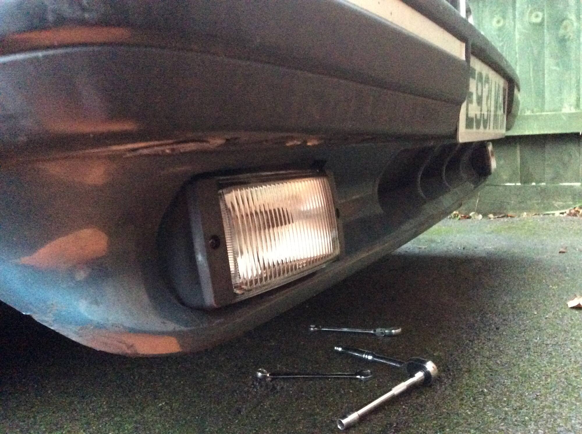

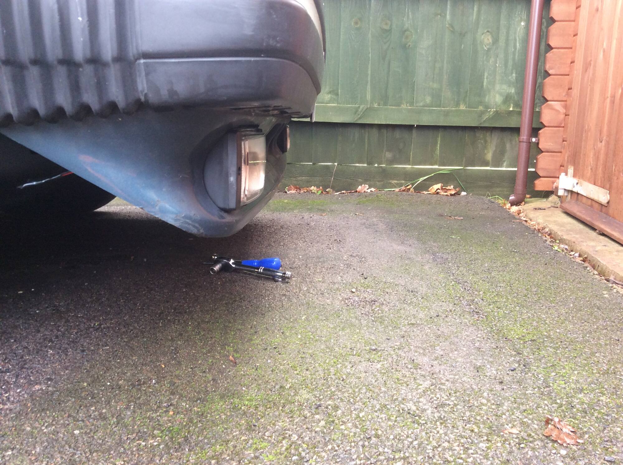

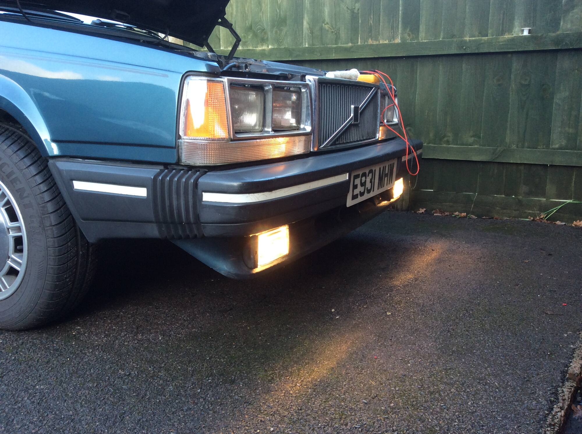

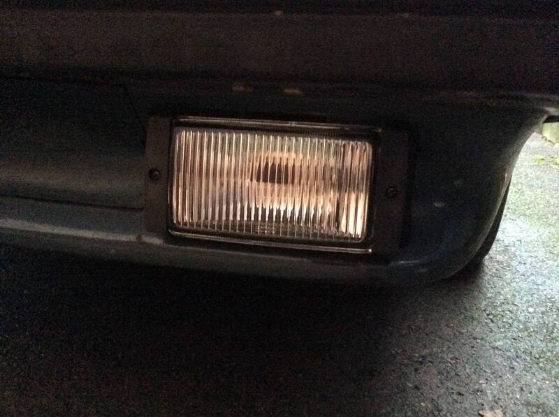

Next job is to fit it all back onto the car. First thing to fit was the light units to the brackets while there was more room. Annoyingly, the new lights came with mounting bolts a fraction too short to fit through my plastic brackets! They’d go but I couldn’t get the nut and spring washer both on together. So I had to take it all apart and fit some replacement longer bolts instead. Once they were on, the spoiler could be slotted back in place over the lights and bolted back on. I’ve taken the time here to grease the bolts threads to prevent future seizing. I’ll also do the same to all the mounting bolt threads for the lights and brackets once everything is finished.

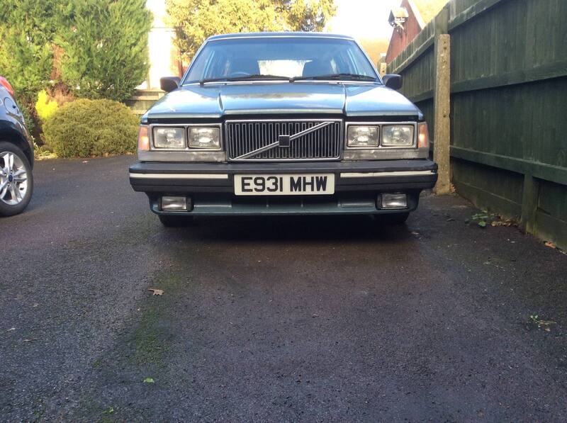

Which leaves the car looking like this.
Overall, they’re a very good fit but they both need adjusting! Both of the lights are way too far forward and poke through the spoiler way too much so I’ll slacken the brackets and slide them back. Also, both lights are pointing upwards, one much more so than the other, so I’ll slacken the bolt for that and just slide the lights around a bit to point straight! Should be easy enough.
Thats as far as I got today as I started running out of light and dry weather in the end. But, now the lights are actually fitted to the car all I now need to do is wire them up, fit the relay and switch and of course adjust the position of the lights. Hopefully that should be easy.
  • Like 9
Well, it was pretty decent outside up to now so I’ve been out and adjusted the position of the lights. They’ve slid backwards a bit more and now seem to be pointing forwards instead of upwards!
A face only a mother could love!!

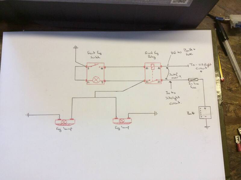

Next task was figure out how to wire in the lights, which is pretty easy, but complicated by my insistence on using an OE dash switch instead of the generic one that came in the wiring kit. The big difference between them being the generic ugly switch has 3 terminals but the OE one has 4. It took me a while to work out how best to wire this into the car but after a bit of thinking and trial & error I think I’ve got it sussed.
So, I drew a pretty little diagram to make it clear(er) and tested it by rigging up all the components along with some off cuts of wire and an old indicator to act as the fog light on the car.
As you can see from my writing on the drawing I got it wrong the first time! It worked the first way but the illumination tell tale LED on the switch wouldn’t work. A bit of head scratching and swapping two terminals over on the relay had it working perfectly. You’ll have to take my word for it as I couldn’t hold all the wires onto the battery, operate the switch and take a photo at the same time!
I might use two in line fuses on both the battery live wire and the sidelight circuit live wire. Just for a bit of extra protection.

Bloody hell..................................a 740 with Yank stylee twin headlights!!!...they look the bollocks too, nice one.

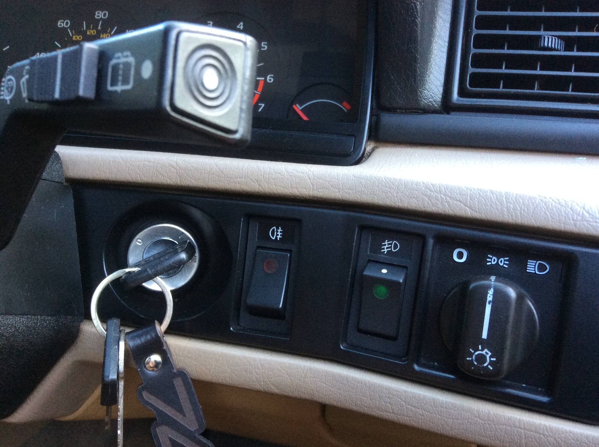

Here’s inside the cabin where the wiring comes through for the light switches.
This actually took a bit of thinking about as the fog light kit uses a three terminal switch. My OE Volvo one is a four terminal switch. Got it in the end though! I’ve wired it in so the front fog switch takes its live supply from the sidelight wire in the back of the headlight switch. This is ideal as it means the fog switch will only ever become live when the sidelights are switched on. Being fog lights you only want them on if your other lights are also on. I couldn’t find any terminals to tap into on this short sidelight wire so I just stripped a chunk of the insulation off then soldered my new power feed wire onto it, then taped everything up nicely.
And here it is with the switch and light switch holder back in as it’s supposed to be. This is exactly what I wanted! Looking at everything you’d think it was all factory installed! No ugly aftermarket switches here.
And proof the lights actually work.
Success!!

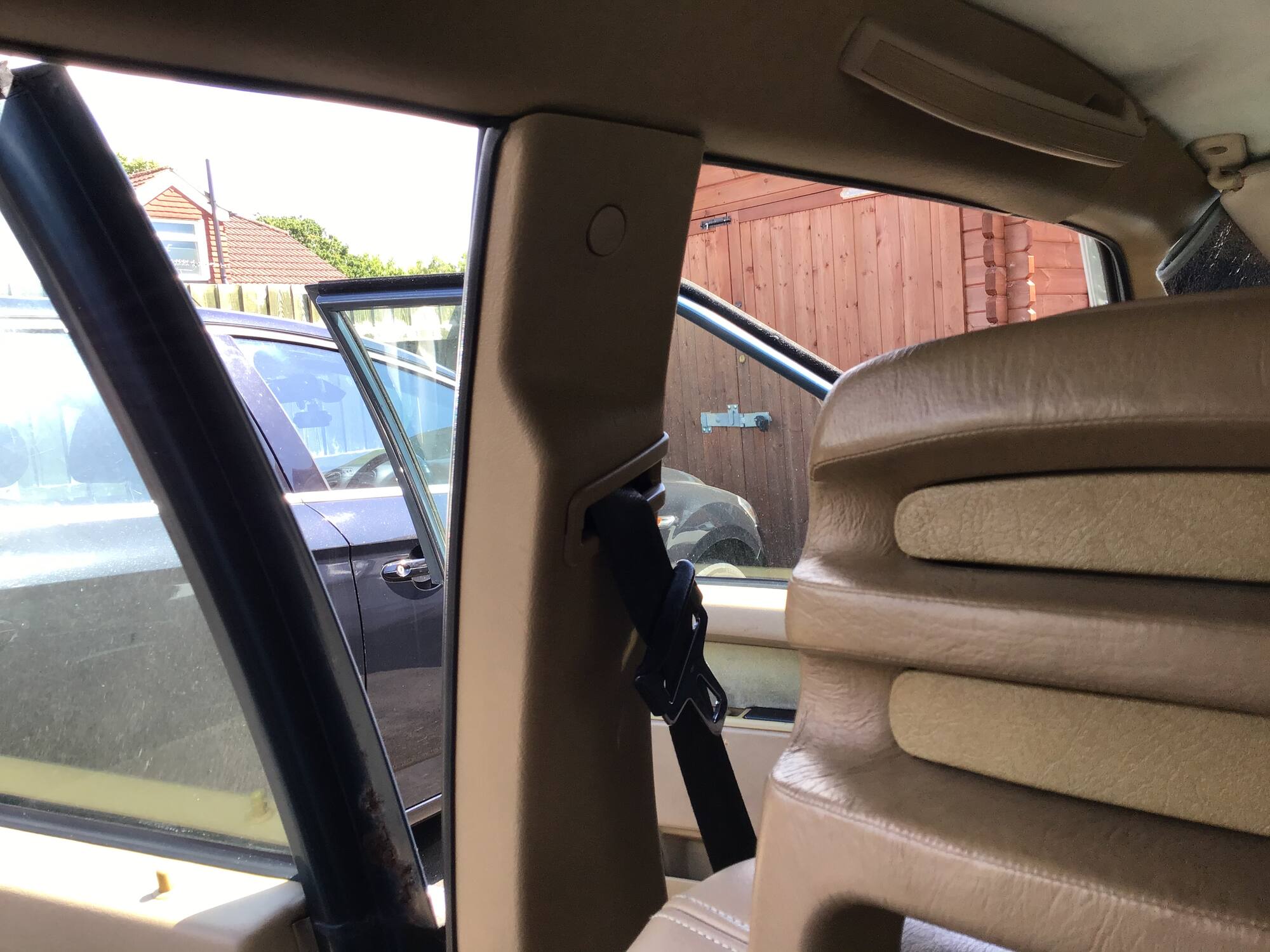

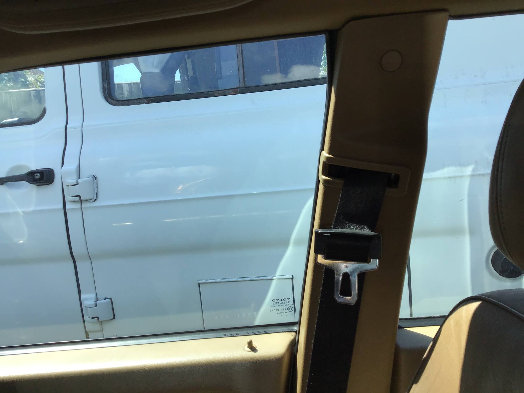

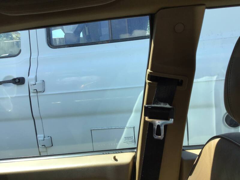

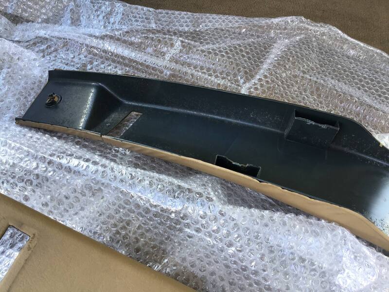

First one was to replace the fucked B pillar trim on the passenger side. The original one was missing the trim around the seatbelt opening but the colour coating was peeling off on the edges, and some of the fixings were broken too so it was a loose fit and vibrated when driving. I managed to get a good used pair of these in the right tan colour off a breaker on eBay for not much. Changing them is pretty easy, just two screws and a few clips to pull it out. New one back in and it fits well, tightens into place properly and now has the trim for the seatbelt too.
These replacement trims were obviously from a smokers car too, they absolutely stink of fags!

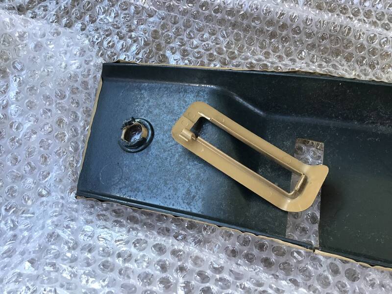

Since I had the pair, I salvaged the drivers side seatbelt trim from that as mine had broken clips and it kept falling off! So now that’s sorted too. Tidies the interior up a bit more.
Sorry about the pics, the sun made them come out a bit dark!
Here’s the old one showing the broken bits on the back, and the broken seatbelt trim.

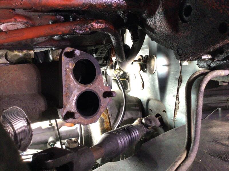

The reason I was a little concerned was because I’d noticed a slight (but obvious!) blow on the exhaust. A quick listen and it was clearly coming from the manifold/front pipe area. The tester noticed this little issue too, but fortunately it was only an advisory this time. Still, I’m not going to leave it so I’ll make repairing it a priority.
This afternoon I had a quick look underneath at the offending item and then wished I hadn’t! I knew some bits of the cars exhaust were a bit shitty, but the front pipe is absolutely wankerd! It’s extremely rusty all over and I wouldn’t honestly be surprised if it’s the cars original part tbh. This means the bolts at either end of it are rusty as hell too. Looking down the rest of the system, the centre two boxes, pipes and rear box are all pretty good still and are easily good enough to keep. The tail pipe is also essentially made from lots of rust particles all holding hands to keep the shape about right so that wants replacing too.
Heres a crap pic in poor light from the top to show the less than ideal access to the front pipe to manifold bit.
Light was too bad this evening for a photo of it underneath but it is pretty shit.

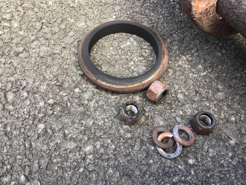

I still can’t be 100% sure but I’m reasonably confident the blow is from the rotten front pipe, probably from the gasket area or beneath the heat shield.
So I’ve just ordered a new front pipe, front pipe gaskets, tail pipe, and a couple of other bits too. Hopefully they’ll turn up soon as I’ve got a week off work soon and it’d be good time to get them fitted.
I did the front pipe on my previous 740 and it wasn’t exactly a pleasurable experience, I don’t expect that’s going to be much different on this car either tbh! My plan here is to wire brush the nuts and studs to get them as clean as possible, then over a few days until the parts arrive I’ll keep spraying it all with Plus Gas or similar in the hope it might help the fixings undo without snapping off. I’ve got a really good little blow torch on my work van too which should come in handy for this.
The tail pipe shouldn’t be too hard, access is good and it looks like it might fall off on its own soon anyway.

Well, apart from the inevitable rusty seized snapped studs, rounded nuts, and rust flakes in the eyes...
Im sure I’ll sort it out!😬

Well this took a bloody age to actually get round to! Since the last update when the new bits arrived ive either been working or it’s been pissing with rain. Although the fixings on the exhaust have been receiving daily squirts of Plus Gas since then so it would be fair to assume if it was ever going to help, it will have by now! So today was both dry and I wasn’t working, good a time as any...
Got the car jacked up high and decided to start at the front pipe. Get the biggest potential problem sorted first.
I started on the 3 manifold - front pipe nuts after having pulled the warm air ducting off the heat shield to create space. These were going to be the biggest headache with this job as they’ve been on there 32 years now! With some room and light the view from underneath actually showed them to look pretty good. Good sign! Tried the first, easy to get at nut which was tight as fuck but after cracking it off it undid fully and easily! Nut number two cracked off with extreme effort applied but quickly became a problem. Tried working it back and forward with some Plus Gas sprayed on but no dice. Time for mans best friend... FIRE! I’ve got a really good little blow torch on my work van, which gets incredibly hot very quickly so I used it to heat the nut until it was bright red. After 4 attempts doing so it finally relented and undid without damage. Nut number three was also tight to crack but once it did it came off easy! Thank god!
Next were the three 13mm nuts holding the middle box and front pipe together. I was almost positive these were just going to snap straight off tbh (not the end of the world) however all three came off with a bit of heat applied!
Finally, just the two 13mm bolts holding the front pipe to the body, which came straight out easily. Then with a thump to the pipe it dropped free of the car. I’m pretty sure the Shite gods were helping me today!! Not a single nut/bolt or stud damaged!
Old and new side by side.
Amazingly, the old pipe itself, though very rusty with bits flaking off, wasn’t actually leaking gas! The problem was the manifold - front pipe gasket had failed along one edge which was giving that irritating ‘ticking’ noise at the front of the car which my MOT man mentioned. Still, can’t really grumble given its age!
here’s the remains of the gasket. Absolutely fucked!
And the bottom of the manifold showing the tell tale soot marks of the leak.
I’ve used a bit of emery cloth to clean off the faces for a good seal.
Heres the old fixings from the other end. Yes, someone had used nyloc nuts to hold the front to the replacement middle box! The nylon bit has, predictably, melted away in the heat from the exhaust!
