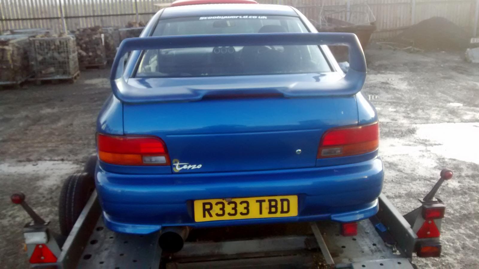

The wheels are clean the seats are clean and tidy, bodywork has a couple of minor car park dints paint work is pretty good, the engine sounds sweet and has 94k miles it is a bit of a shit to start though, turn key until it fires then promptly cuts out half a dozen or so times untill it splutters into life with a bit of missing and farting, a few blips of throttle untill it settles down to a more smooth tickover, it's been sat for over a year so hopefully a service will sort that.

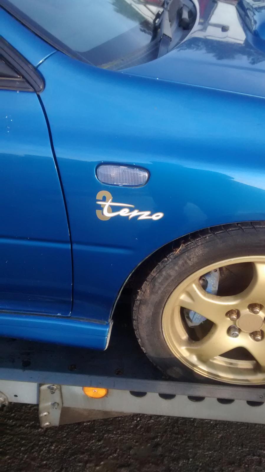

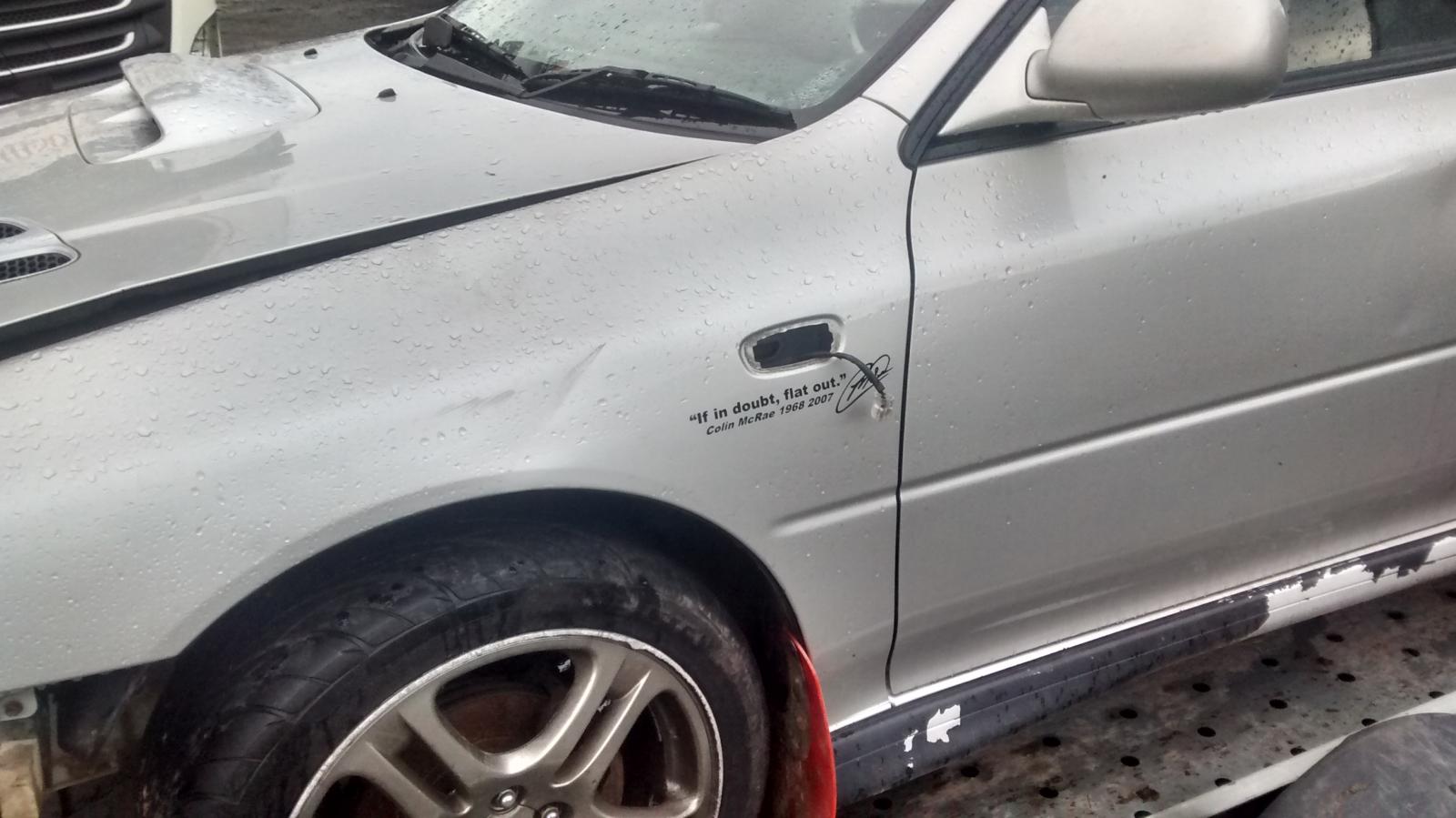

Still wears it's stickers one on each wing
And one on boot, note drain pipe no sewer pipe exhaust.

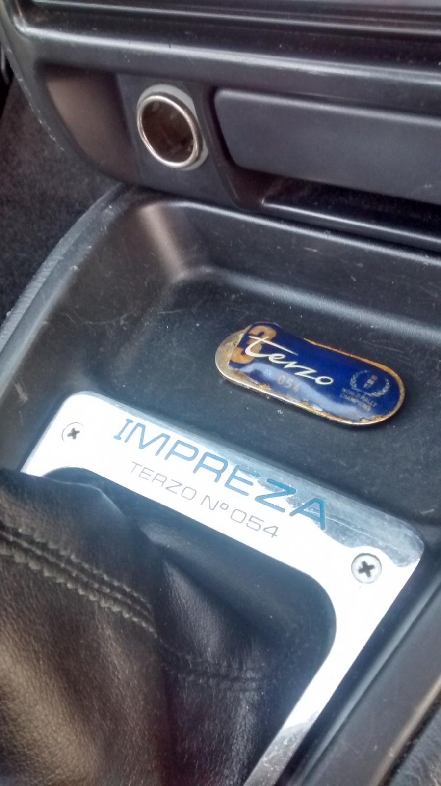

Inside has the limited edition badges which I had never heard of untill now.

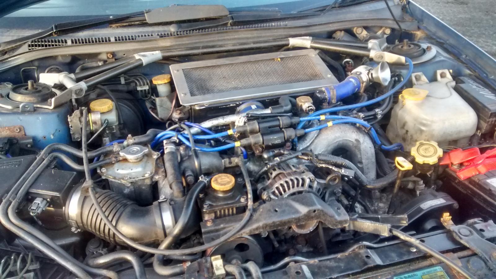

Apart from the stupid trumpet dump valve the engine looks pretty standard,
English wasp snuck across the border avoiding immigration.

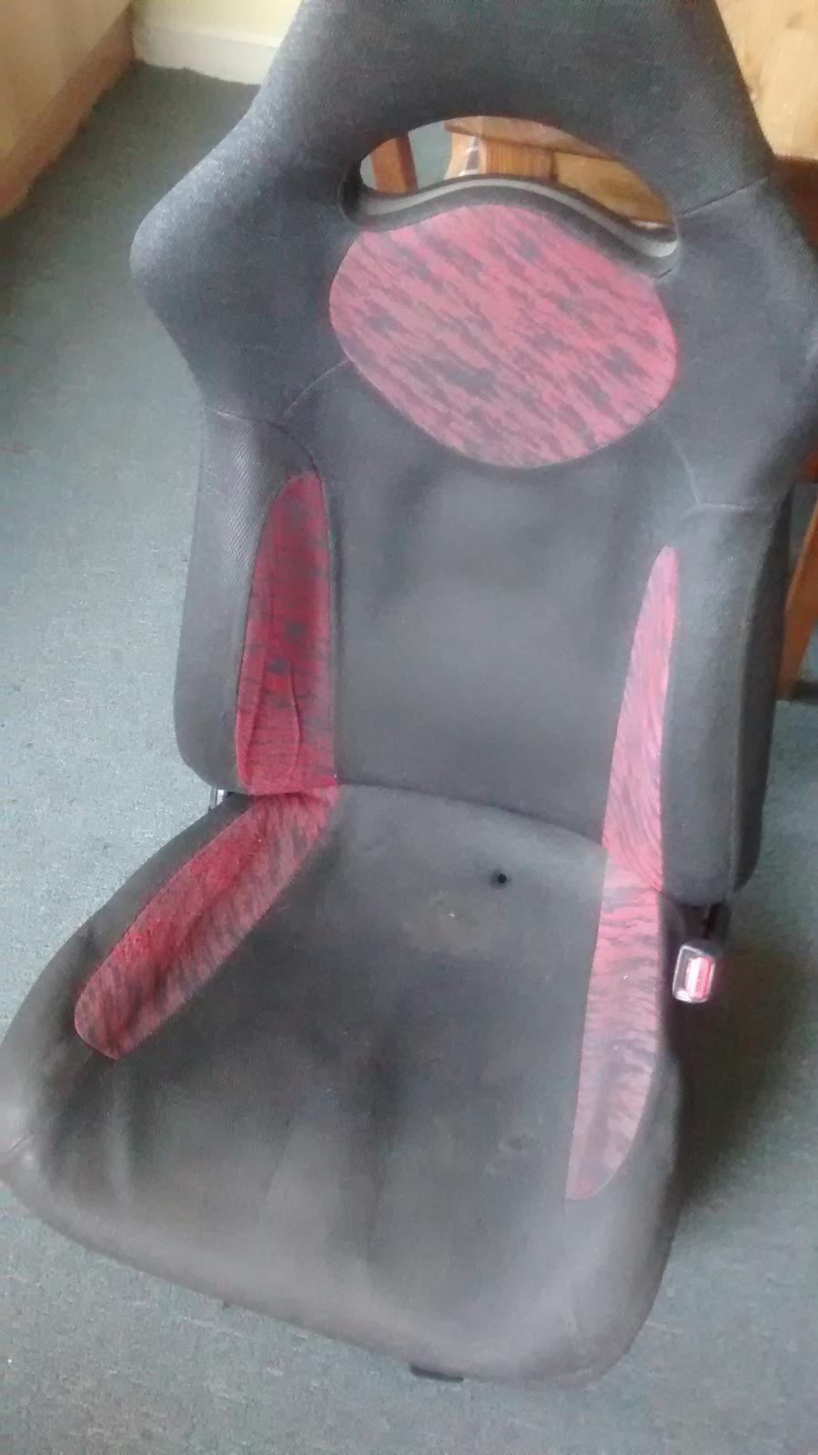

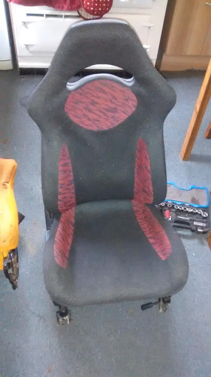

I don't appear to have any pics of the seats but they are black with light pinky red infill patches, will snap a couple when back over at the yard.

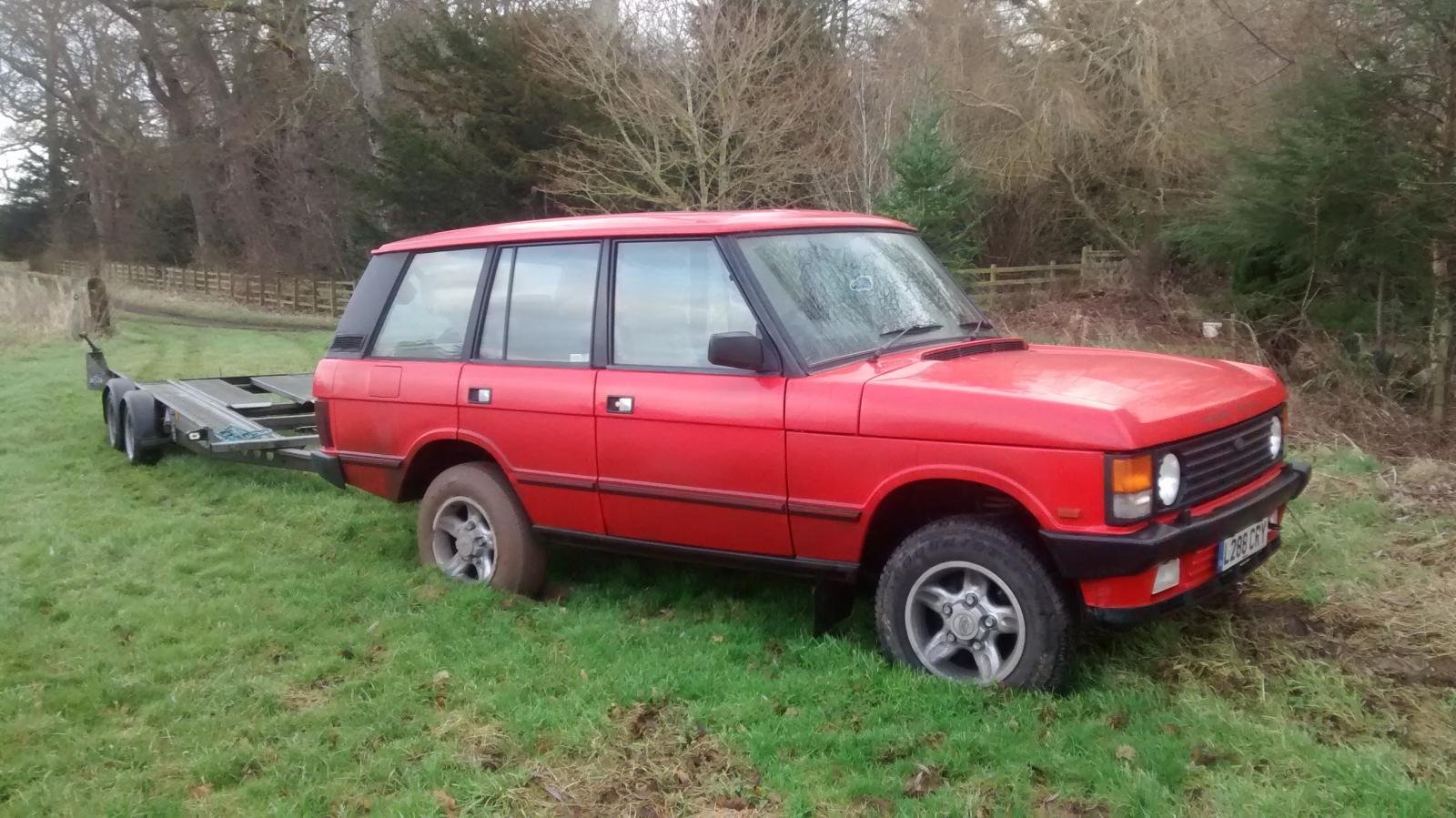

Today's collection see's the auld pumkin pushed back into service,
I popped over and collected the trailer then promptly got the whole rig stuck in the field in front of our house,
After an hour and a helpful mate with his patrol of much huuugeness we where off,

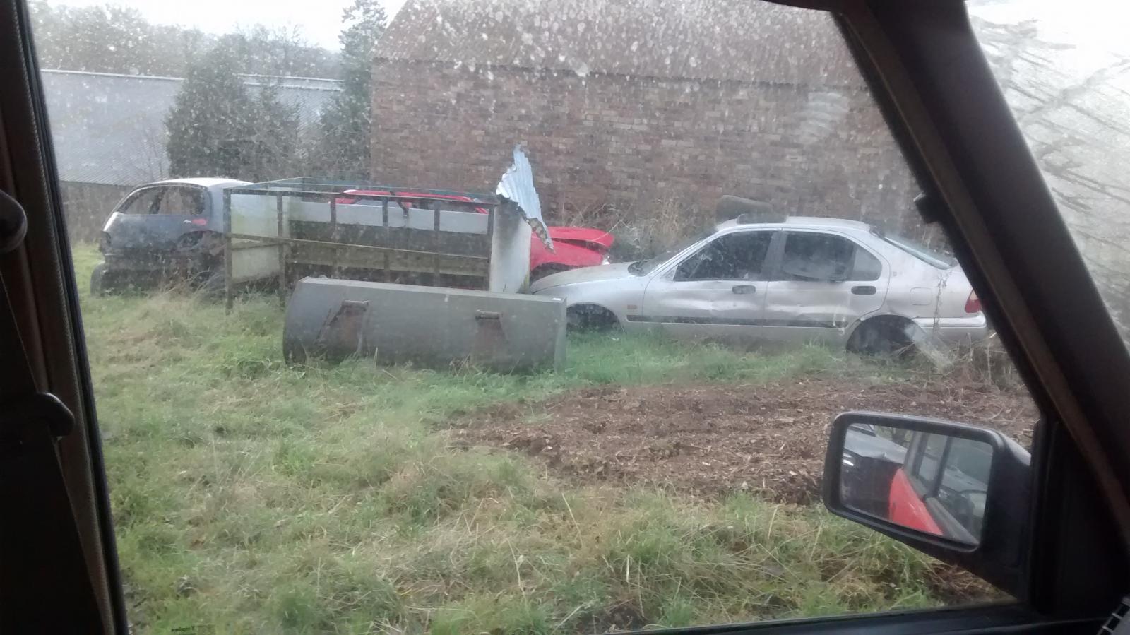

We ended up in deliverence country where the first sight was this.
After a quick look and much chinwag a deal was done and we loaded up my haul and set of back home.

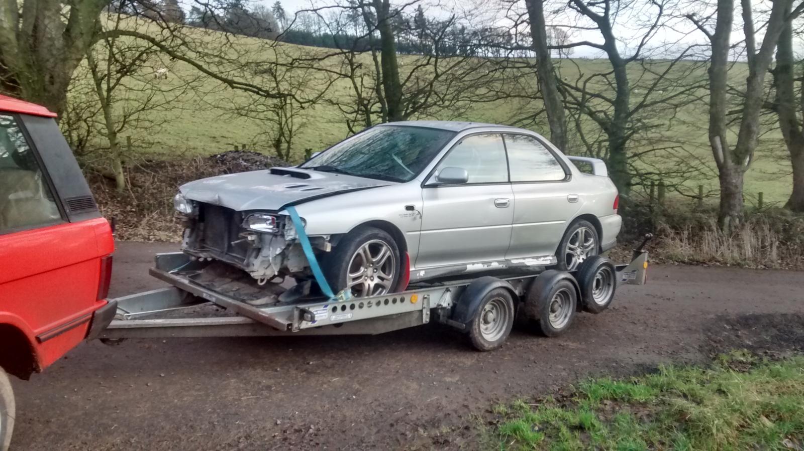

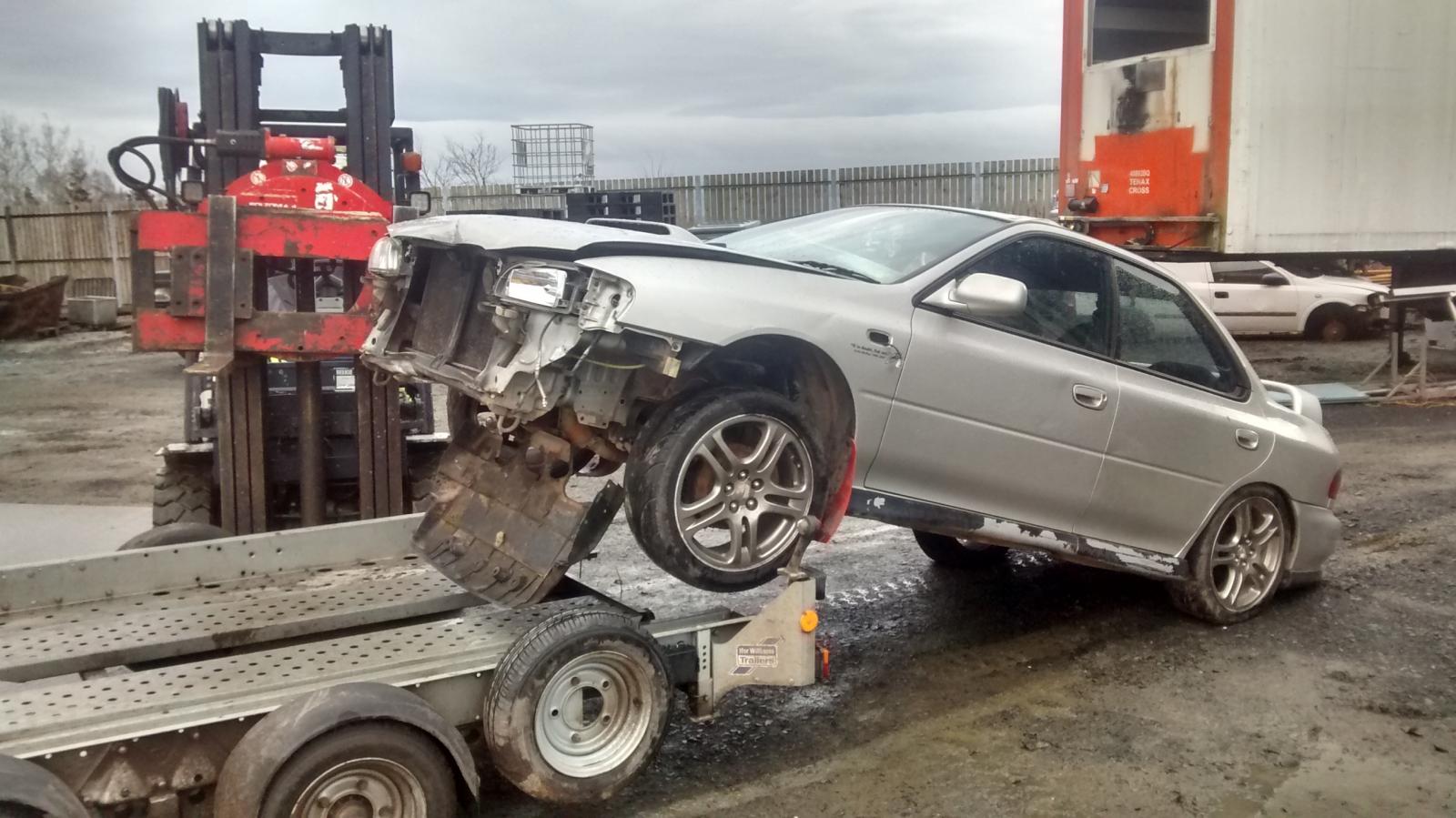

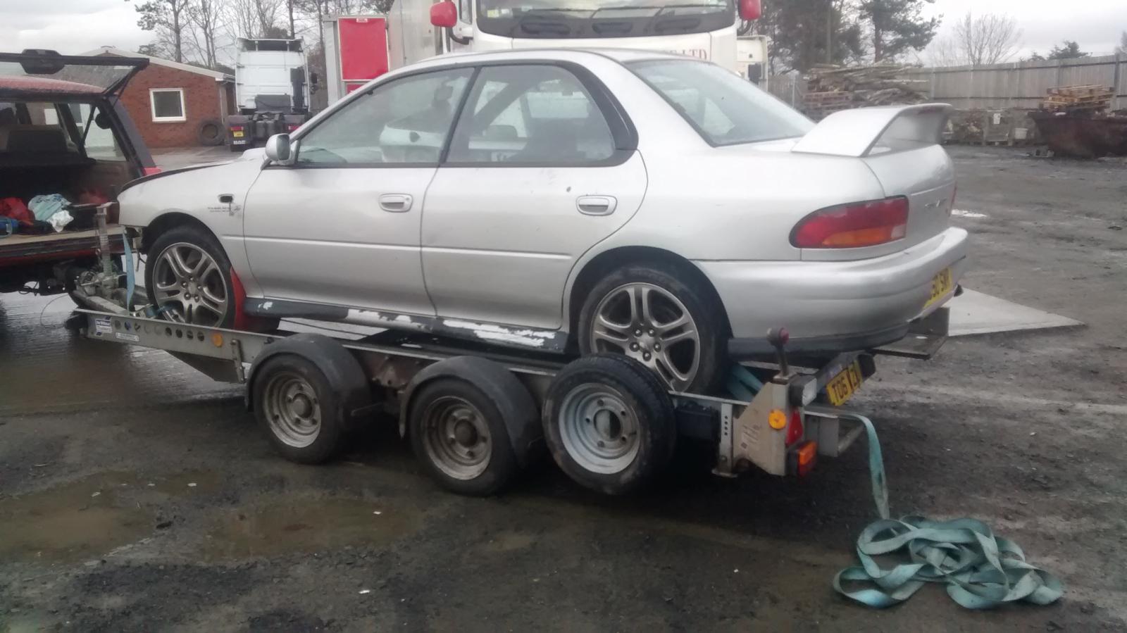

Decided to strip some bits of the old donner so untied it as it's sat on the trailer since I brought it back.
I couldn't be arsed faffing about with the ramps so enlisted the four wheel lift to yark it in the air then just drive out.
Omg no wonder he crashed it,

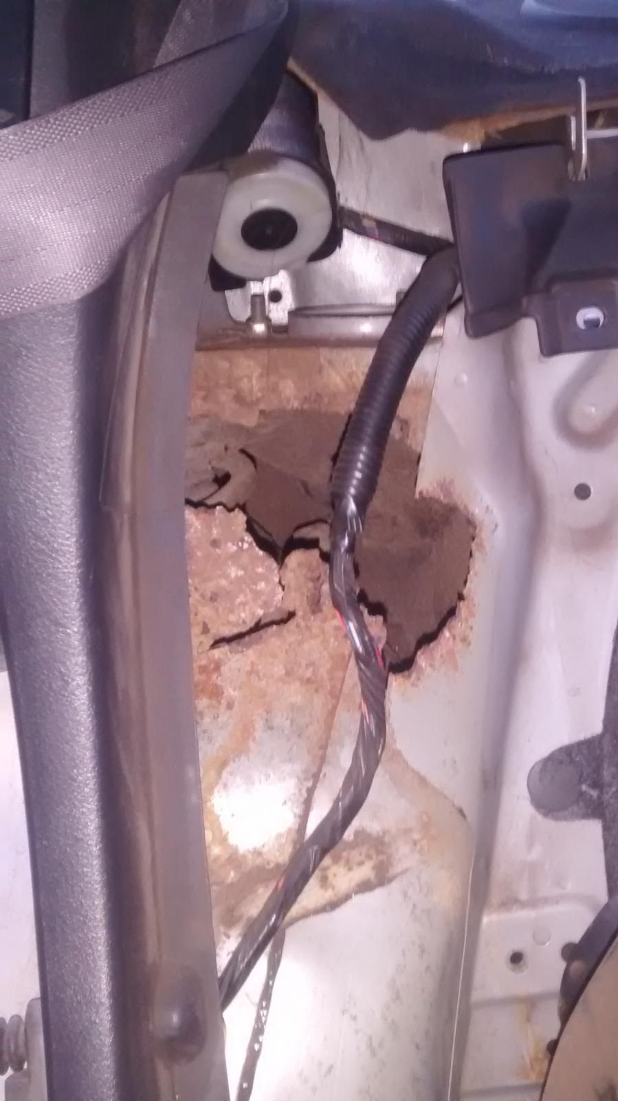

While lifting the silver one to remove the wheels the back driverside one went all to cock,
I pulled the back seat out to see this which was probably the reason he crashed it.
Not what I was expecting to see on a 99 car but both sides are exactly the same, the strut top has rusted as the three bolts are still holding the top to the shell and the bottom is flapping about.

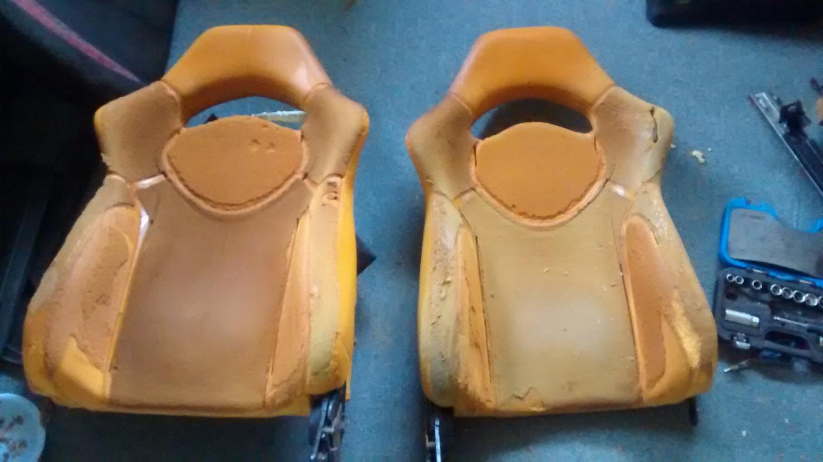

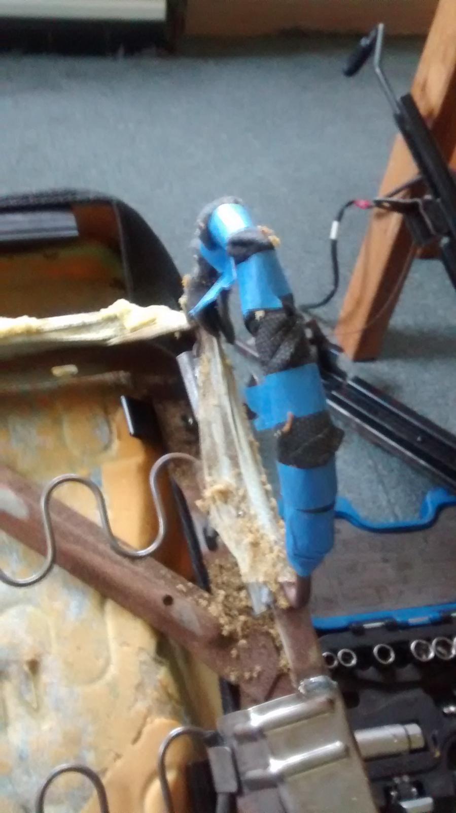

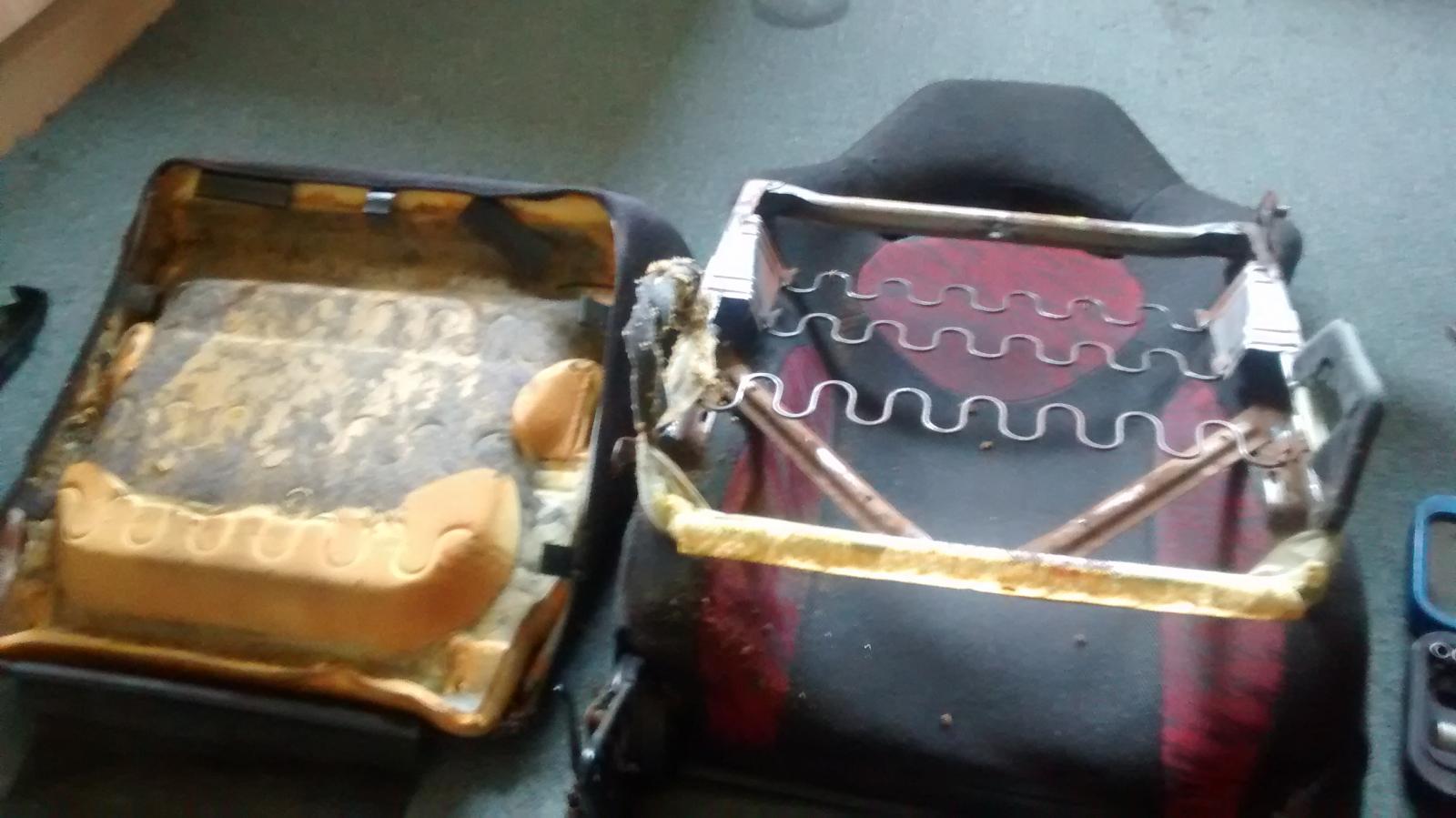

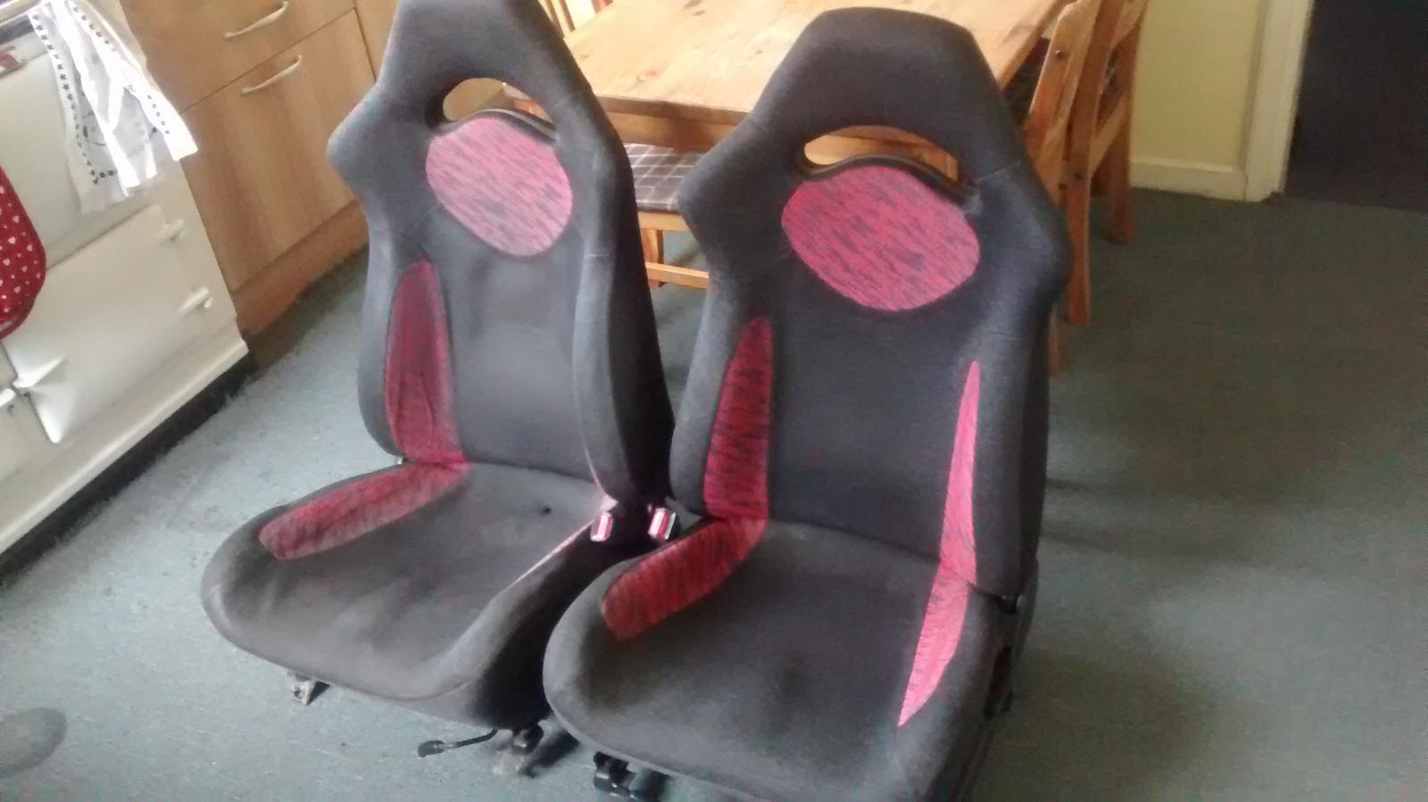

Two seats to make one good one,
The one in the left is from the car and the other one is the passenger seat from the silver car.

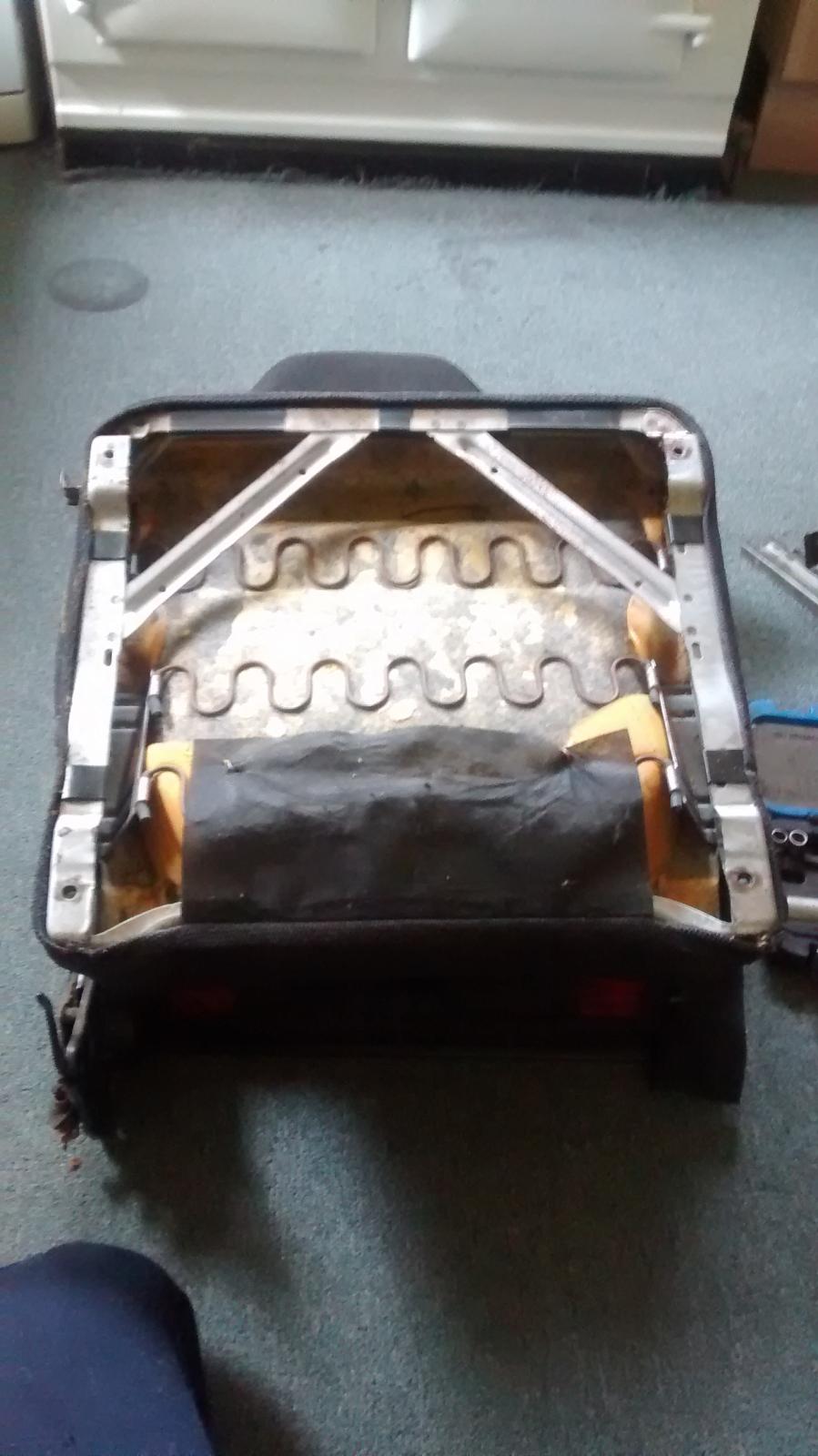

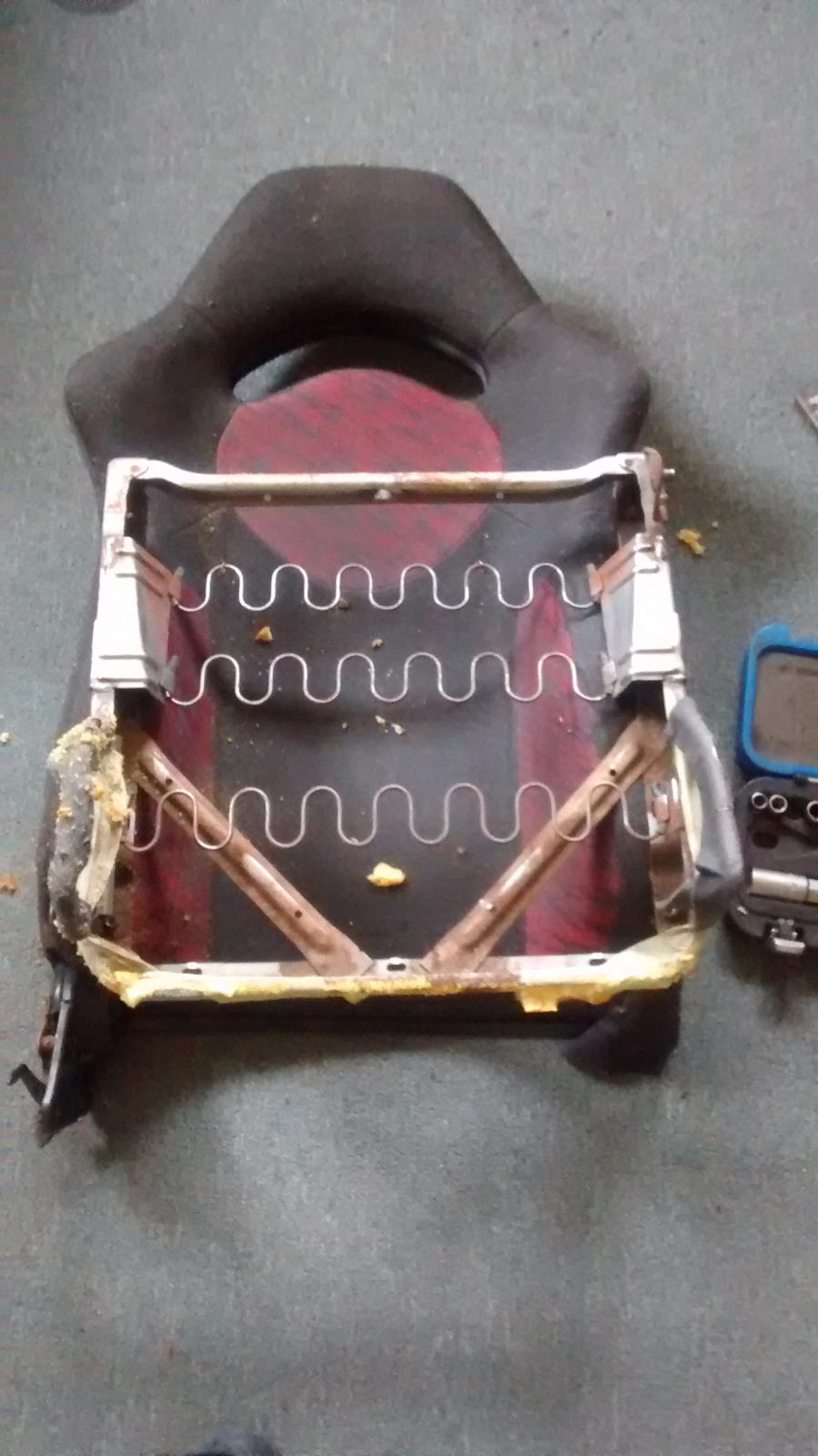

Four bolts to remove the runners then two bolts hold the adjuster side and one screw holds the inside then I had two bases and two backs lying on the floor,
To remove the bottom cover the material is clipped by the eight black plastic clips around the the steel frame, three along the top two down each side and one long one along the bottom.
Once unclipped the foam pad pulled of to reveal the frame.
I added a bit more foam to the frame work that holds the sides of your legs firm as a precautionary measure.
I slipped the passenger seat base foam back onto the drivers frame and clipped it back into place and the base was finished.

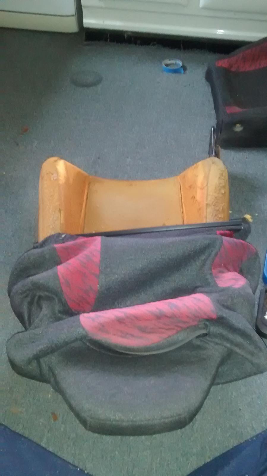

The back was a bit harder to do first the top hole has to be unzipped then it has to be pealed like a banana,
Then I had to do it all again to the other back.
The passenger seat cover could then be refitted like a huge condom and clipped back down, after this then it was a simple rebolt the base to the seat back and rebolt the runners and jobs a goodun,
Before worn and well soiled,
After like new.
Nice work with the seats. The rear strut-top rusting out sounds like an old 80s Sunny (N13 and B12 for the Nissan lickers)!
Thanks,
When I saw the state of the silver one I removed the back seats of the terzo and thank fook it's nowt like that with only some slight surface rust showing on the seem,
