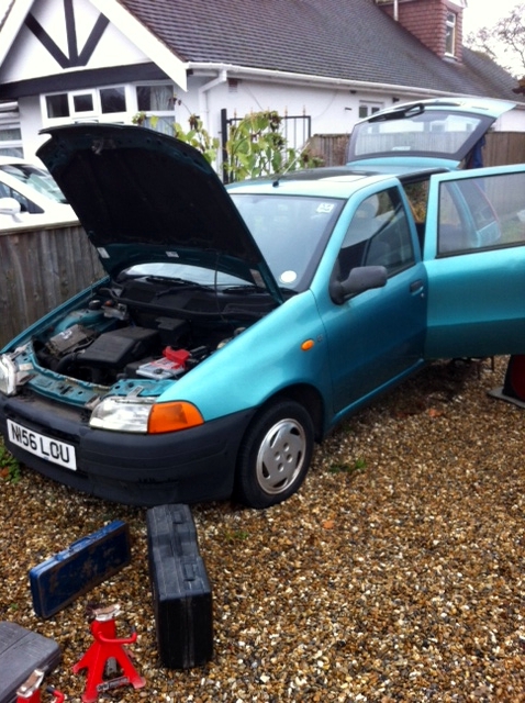

As I mentioned in the N24 thread last week, this morning I helped my uncle start up my aunt's old Punto 55.  The car's been sat since the MOT expired in July 2015 - probably before that actually, as my aunt bought a 500 that May.  The rear part of the exhaust needed replacing (from the cat back it appears to be one piece), and the replacement part my uncle bought didn't have a long enough prong to meet the rubber.
So - as you do - he just left it up on ramps, until my aunt asked me if I wanted the car.  I need another car like a hole in the head, so we compromised and I said I'd try and sort it out.  Apologies for the lack of pics.

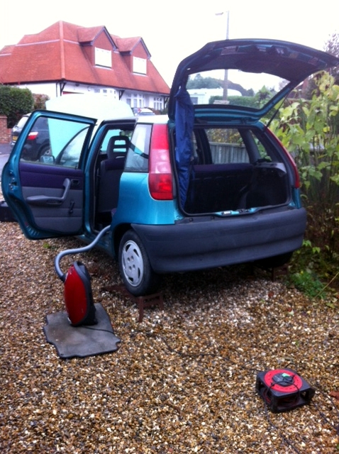

The sight that greeted me on arrival.  You can't really see the moss and gunk on every external surface here, but it's actually very tidy with very little in the way of dents and scratches.  The only real damage is a very shallow dent on the n/s rear door and a £2-sized bit of lacquer peel in front of the sunroof.
My first job was to lift the boot carpet.  The first positive was the boot floor was still there.  I then grubbed around underneath and was pleased to find it didn't appear to be too bad.  Bit of surface rust but nothing I could put my hand through.  The exhaust rubber was a Ford one, oddly, and the prong from the centre pipe was indeed too short, so we found some metal pipe of a slightly larger diameter, cut a length of about 5cm and Araldited it in place.  We then Araldited a bolt in the end to stop the rubber from sliding off the end.  So far so good.
Next job was to try and start it.  Supposedly my uncle had been charging the battery for 4 days, but it wouldn't turn over, so we used his Fiesta to jump it.  It fired up first turn, settling down to a steady (if slightly lumpy) idle.  The fuel in it is old (there's about a quarter of a tank) - would that account for a residual level of very mild white smoke from the exhaust?  Certainly the coolant level is fine and there's no mayo anywhere.  The car has done 69,990 miles.
There is, however, very little oil in it, because most of it is down the front of the engine block, which provided a bit of smoke as it burnt off the manifold.  Is the FIRE engine known for lunching rocker cover gaskets in the same way (say) the GM Family Two is?

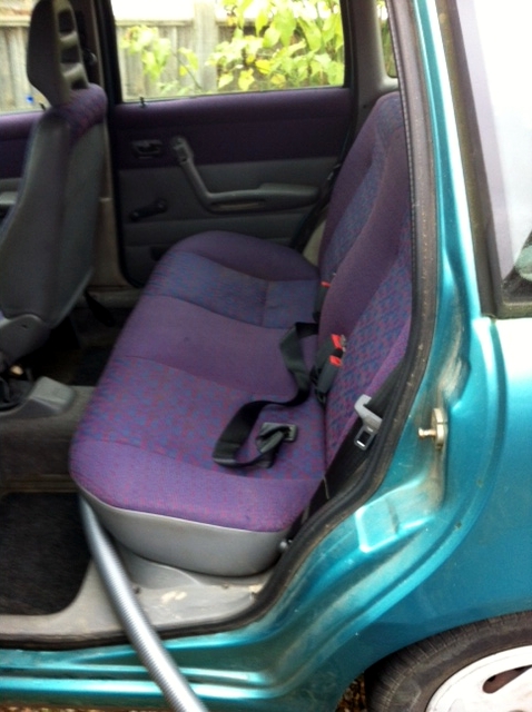

Not sure why I took this photo, other than to highlight the mental upholstery in true mid-90s supermini style.  Oh yes - there's trim missing round the door handle and armrest.  The car was dealer-fitted with central locking on purchase and of course this no longer works.  I haven't had a chance to check fuses.  The offside rear door wouldn't open to start with, but holding up the lock button and operating the handle got it open eventually.  The outer door handle is reticent to spring back to flush with the door when you open it.  I'm hoping some WD40 will cure it.  The door card seems to have warped a bit as I struggled to push it back into the rubber seal at the base of the window (although there's no evidence of water leaks), so I wonder if something's catching somewhere.

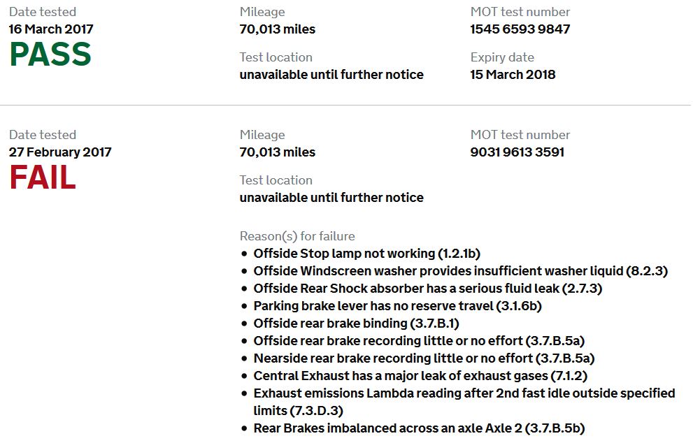

Like a louse I completely forgot to update this, but here's what happened - Punto was put in for an MOT in February at the garage my aunt and uncle have used for years.  My uncle's a lovely bloke but a world-class ditherer and I suspect he forgot my advice to use the brakes a lot to clean them off and get it nice and hot for the emissions test.  So it naturally failed, and the quote to fix it all was fairly high.
Enter some 'friend of a friend former Army mechanic' or somesuch who offered to do the work required (new rear shock absorber and rear wheel cylinder) and get it MOT'd for £200 cash - here's the result:
Suspicious lack of advisories there.  Anyway it's not long until this year's test so we will see.  It's now been serviced and is being used (including my uncle diagnosing and replacing the clutch slave cylinder, impressive).  Next job is the rocker cover gasket to cure the oil leak and I also scored a cheap cambelt kit on eBay which will be fitted if it passes again.  My uncle is making noises about wanting to replace it but as he can't make his mind up about anything I suspect it will be around for a while yet, provided it stays rust-free and keeps passing tests.

That's was result that, especially for an old Italian car. Fingers crossed this years isn't too bad.
