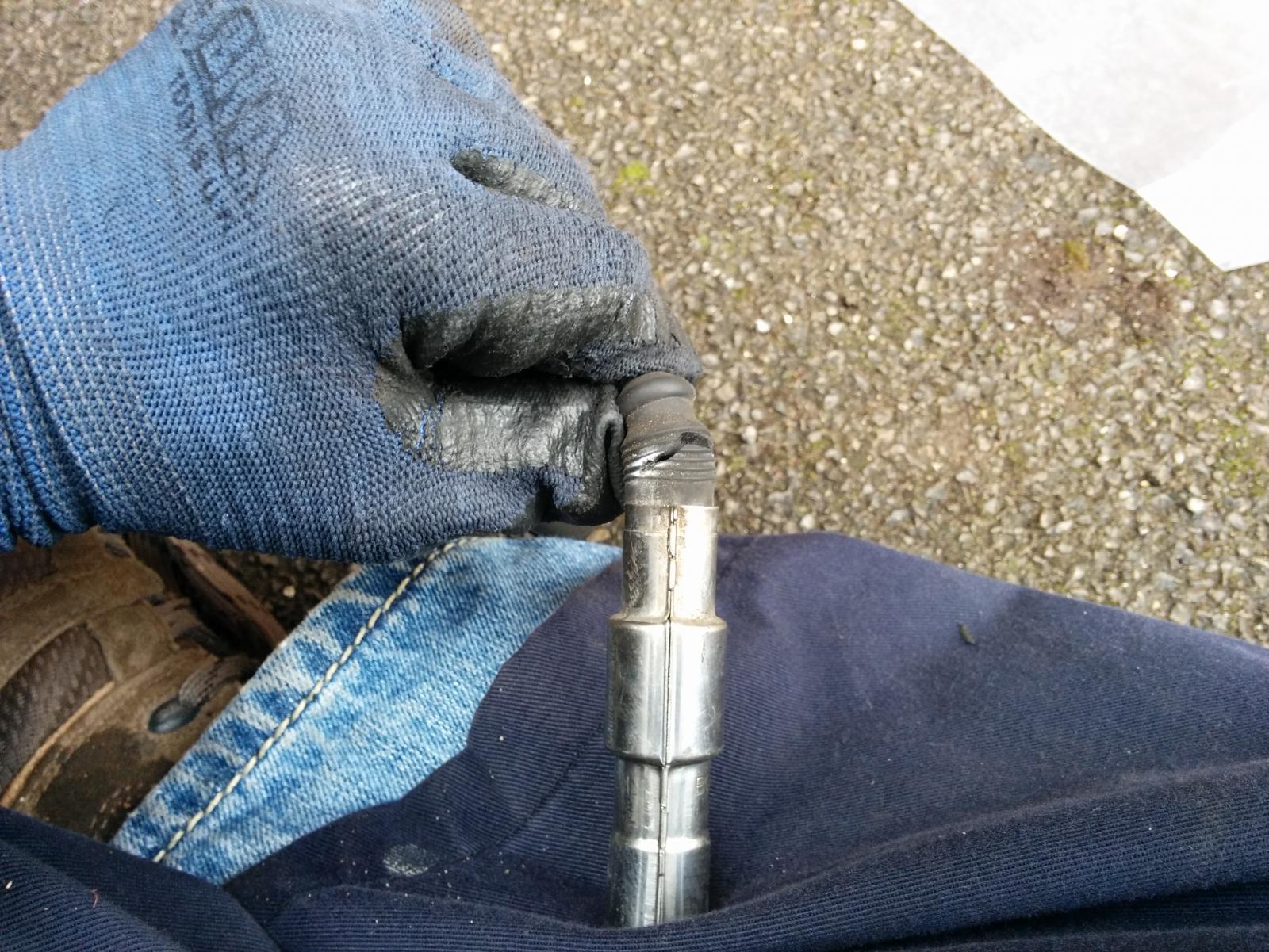

I splashed out and paid £35 for this spark plug lead removal tool. Kind of painful to spend so much on a tool for one job but bloody glad I did.
Cheaper tools apparently bend and struggle to grip the base of the lead. Pliers bugger up the leads and can end up leaving bits stuck on that are a nightmare to remove.

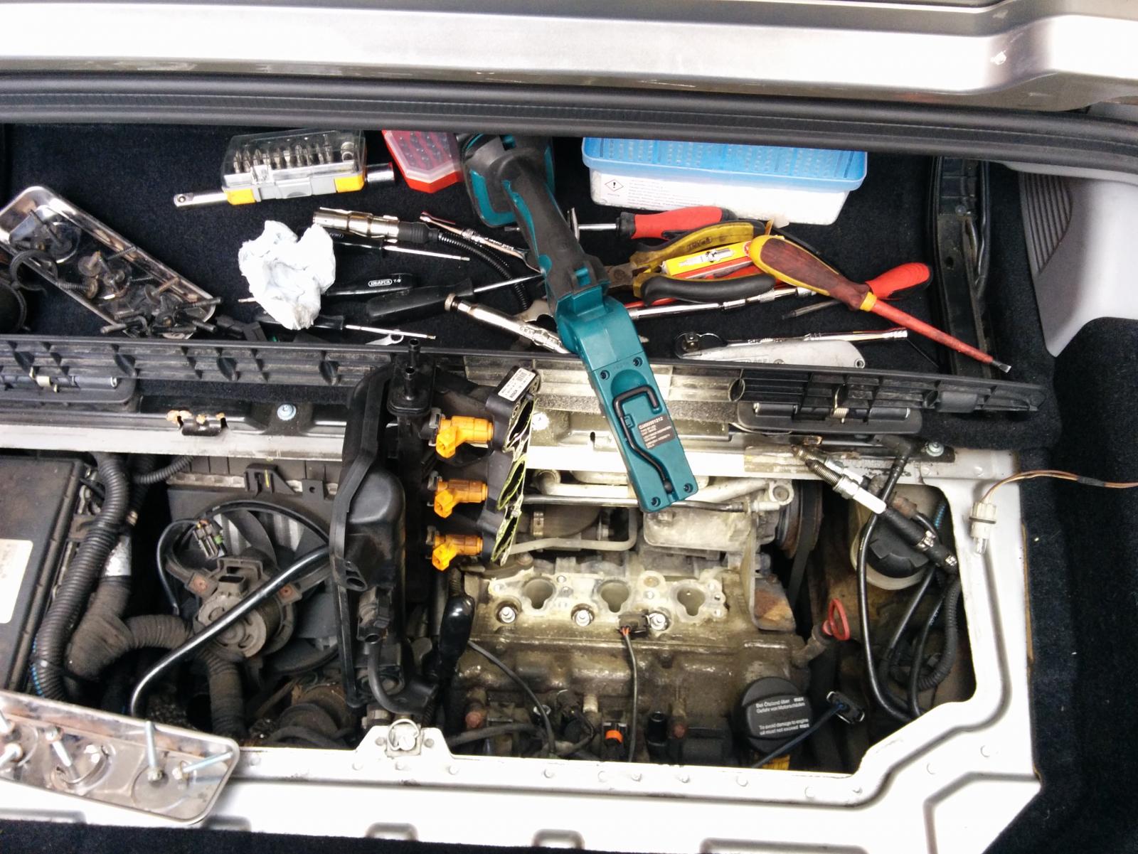

Plug removal on the Smart requires the rear bumper removing.
First car I've ever had that has required such a thing.
Bottom plugs weren't too bad. They're in between the crash beam and the main body Access was reasonable and the tool made it a doddle to remove the leads. Leads simple as the bottom of the coil packs was right there. There are 3 coil packs, each drive 2 plugs. 6 plugs in total for 3 cylinders.
Top plugs were easy to get to, however replacing the leads was an absolute nightmare. Ended up having to remove the intake manifold and fuel rail to get decent access. Again I was super happy I splashed out and got a decent tool that didn't bend and flex.
Made this useful tool up to hoover out all the crud down the plug wells. The top ones especially had a large amount of detritus fallen down there. Really didn't want it getting into the combustion chamber, as it's so small!
Glad I changed the leads too. The tops had burn marks around the rubber boots, while the bottom ones had split marks in. I suspect due to previous people using pliers to remove them.

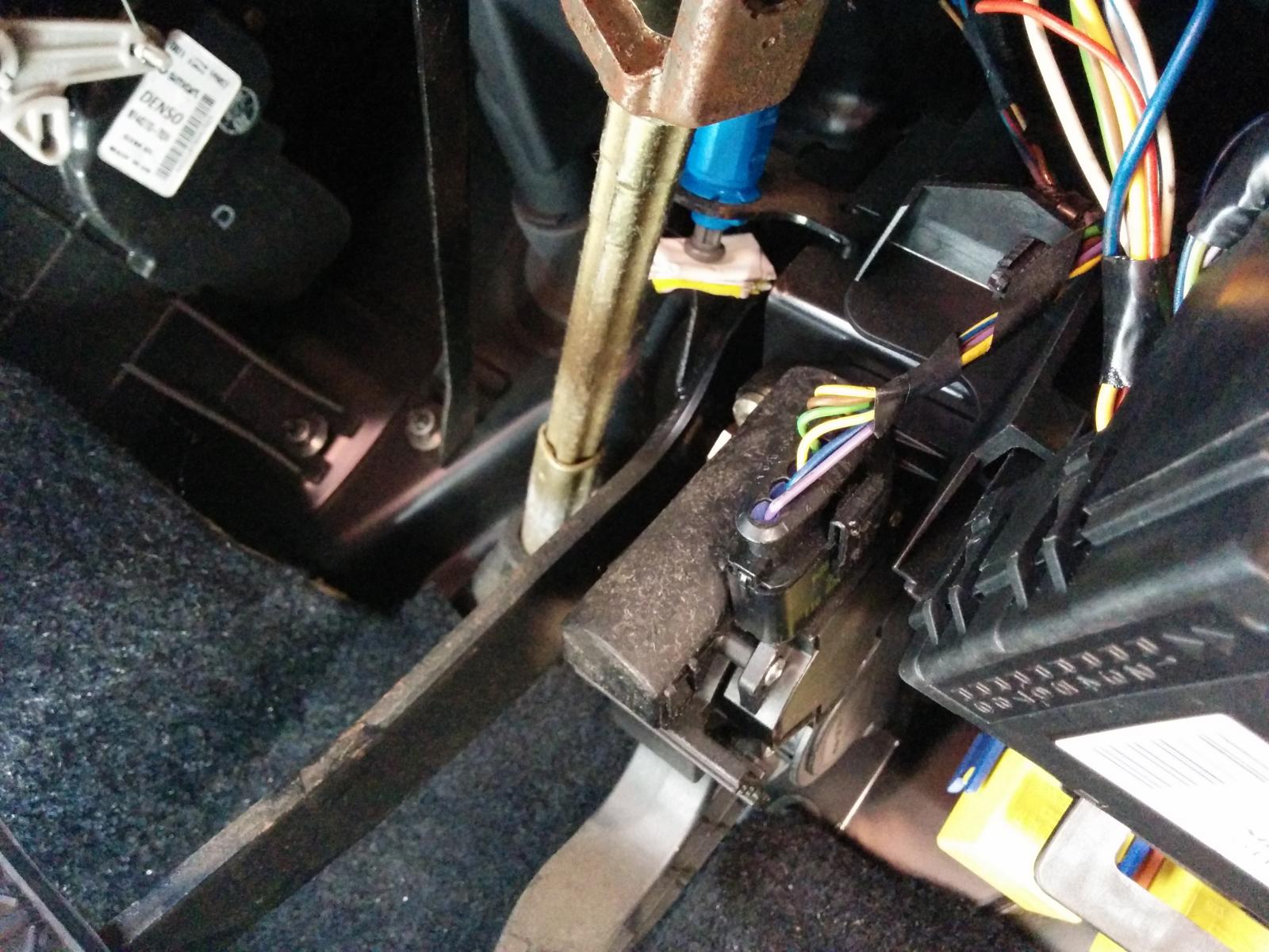

Not had a chance to read the code yet but I'm hoping it's just the brake light switch. Daft thing is, the brake switch has two contacts and if one fails the whole ABS system is deactivated.
Switch isn't available in ECP for the Roadster but Googling online it appears the ForTwo one is nearly identical apart from a waterproof removable rubber bellows on the end. £15 for that one after discount. Looks like one of the ECP branches that is open tomorrow has one in stock. Better check that the code is still showing for it though.
Replacement basically entails twisting the switch to release, twisting the new one in place and swapping connectors. Hopefully a nice quick job.
Finally I filled it up again today - worked out as 38.5MPG. Not too shabby considering I've been driving it in stop+start traffic. Same driving lead the the Laguna getting 17-19MPG. Quite a difference!
Went off to ECP today and picked up a new brake switch. As per last post, they don't list one for the Roadster but the ForTwo switch they do and is completely compatible.
White one is off the car:
You need a 3.6mm shim to set the switch into the correct place. There is a ratchet inside the switch that sets up the positioning and actuating point. Handily folding the included instruction leaflet a couple of times made the perfect shim.

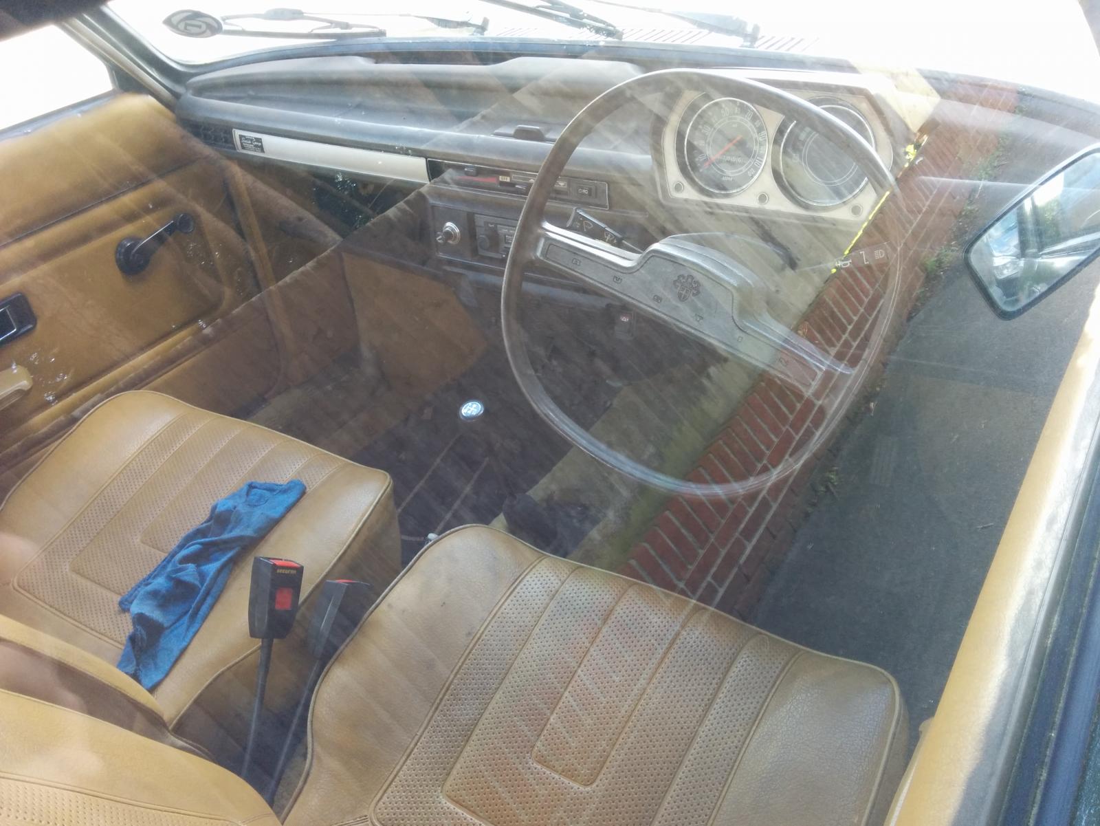

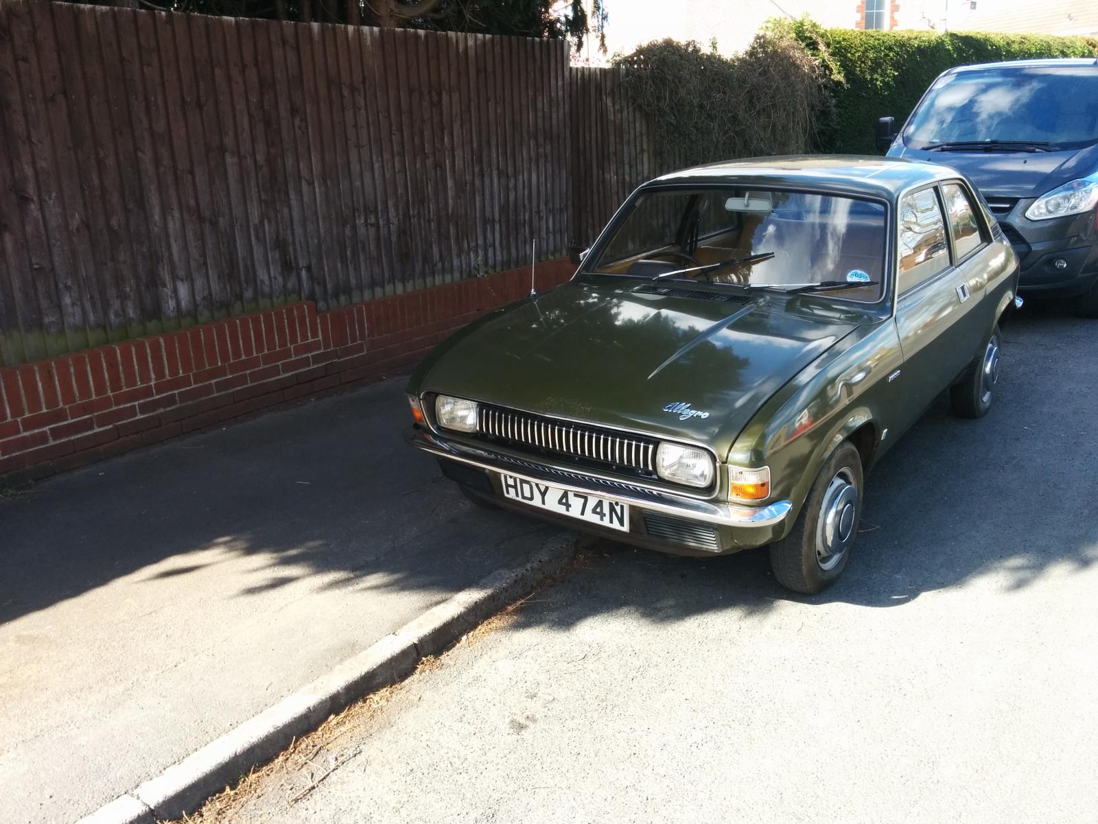

Wife's parents came down today and the Father-in-law wanted a ride in it. I duly obliged.
On the way back we stopped off at the local garage that specialises in classics. We peered in and ogled at the cars inside. Features included e-types, tickford fords, Bentley arnage, Mustangs, loads of MGBs and other stuff. Then had a look around their outside storage area of broken old rotten cars. I'll have to take some pictures sometime.
On the road outside is this little beauty. I can only assume it's a customer car that is going to be fixed. I learnt today that the FiL really wants a Vaden-Pla version. When one comes up on here for-sale next on AS, I'll have to point him here.
FiL advised me that the square steering wheel was from the pre-facelift versions and this one must be a very late one.
Finally, best of all, today an achievement was unlocked:
I'm pretty sure that square wheeled allegro used to belong to Louise on here

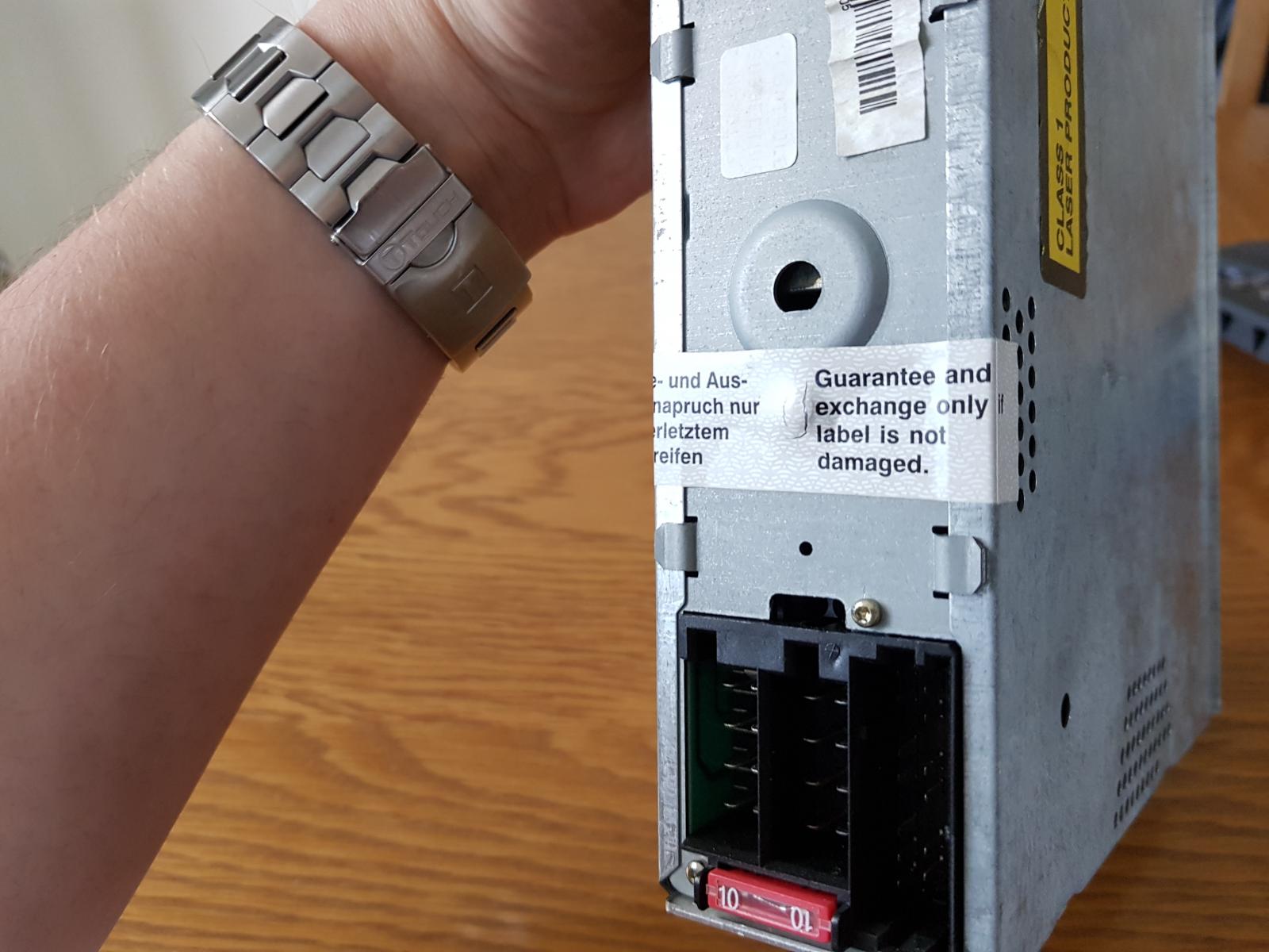

Started off by fixing the radio. Security Code was missing, so I grabbed my EEPROM programmer...
Broke this seal on the radio...
Pulled apart the stereo...
And then forgot to take a picture of it all connected. Anyway I read the EEPROM off and used some code generator from a dodgy Hungarian site to input the data into it and out popped a code. The code it returned was 0001. Hmm. Not sure if I believe that. Entered it and lo-behold it worked.  8)

  • Heater fan switch not working on position 4 (clean contacts) - Need to remove switch and clean up
  • Retrofit cruise control (check for wiring first) - No wiring there, so bigger job than first thought. Also need to find someone with a Mercedes STAR diagnostic system to enable.
