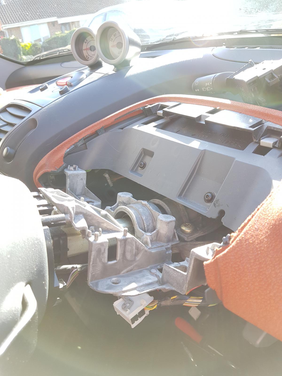

Since I've had this, the interior fan has never been able to run on fan speed 4. This is commonly caused by the switch contacts being dirty. The official way to get to the switch is to pull the dash completely out. However the very useful evilution guide says that its possible to get to by taking the instruments out.
So after attacking bits of trim with a torx T10...
You can just see the white fan switch connector in the middle of this picture behind the steering column.
After scraping my hands to bits I managed to free the switch.
Unfortantly the reason the fan didn't work on speed 4 became clear.
Bugger. :(
The remains of the burnt connector were stuck down in the switch housing. I did try to scrap the contacts clean on the connector and also gave the fan switch contacts a rub down in the hope it might make some difference. Its usually these contacts that cause the problem when they oxides up.
As the connector burning is a fairly common problem, it is possible to get replacement looms from Mercedes/Smart. Handily there is a dealer up in Newcastle who sells all this stuff direct on eBay. So after relieving £18 from my wallet, I ordered this - http://www.ebay.co.uk/itm/131672836837
It seems a lot for a connector and some wire, but I guess its not too bad considering 1) its German, 2) its a genuine part and 3) its available in stock.
Looks like some more hand scraping action will be needed to try and extract the dud connector, so I can splice on a replacement loom and terminals...

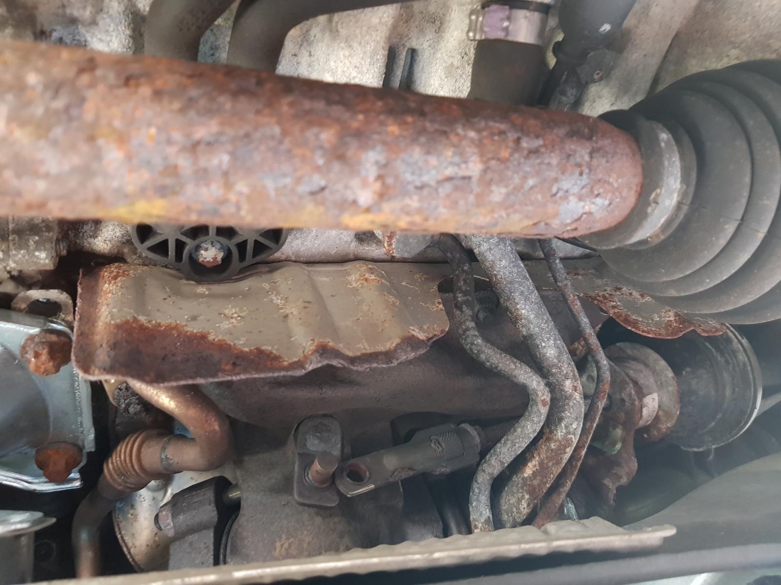

Taken it into garage this afternoon to get the wheel alignment done. A rather nice P6 V8 is sitting outside too.
Irritatingly the smart has rewarded me on the drive to the garage by not boosting at all. Boosted fine on the way in. Suspecting boost control valve may have heatsoaked and died. Ffs :(
Had to come back again as it was way out the wrong way. Oh dear. They did tell me they had £35k of hunter gear. Which is good but you need to know how to use it...!
For those that tune into this thread, here is a little treat of a pic of that rover
Well that'll explain the lack of boost. Nice easy one this time.

Finally got the 4th fan speed working. Interesting reason on this. Turns out that the wiring becomes burnt/damaged over time from dirty connections. Official fix is a replacement section to the wiring loom. It's £20 for an official part from a Mercedes dealer which is quite reasonable as these things go.
After a bit of wrangling of the connector, I managed to get it down to the drivers footwell area. Usually I'd solder these type of things, but as the loom and working area was pretty tight I decided to crimp. To be honest, crimping actually makes a better contact - especially for high current and automotive joints. Most important thing is using a decent crimp tool that puts enough pressure on the contact to crush it properly but not too much that it damages the metal. NASA actually specify in their ground and flight equipment to crimp connections rather than solder. Wires at the solder joints can work harden and snap through vibration.
Wasn't a too difficult job, just very tight working area. Satisfying that it now works on all the speeds.
