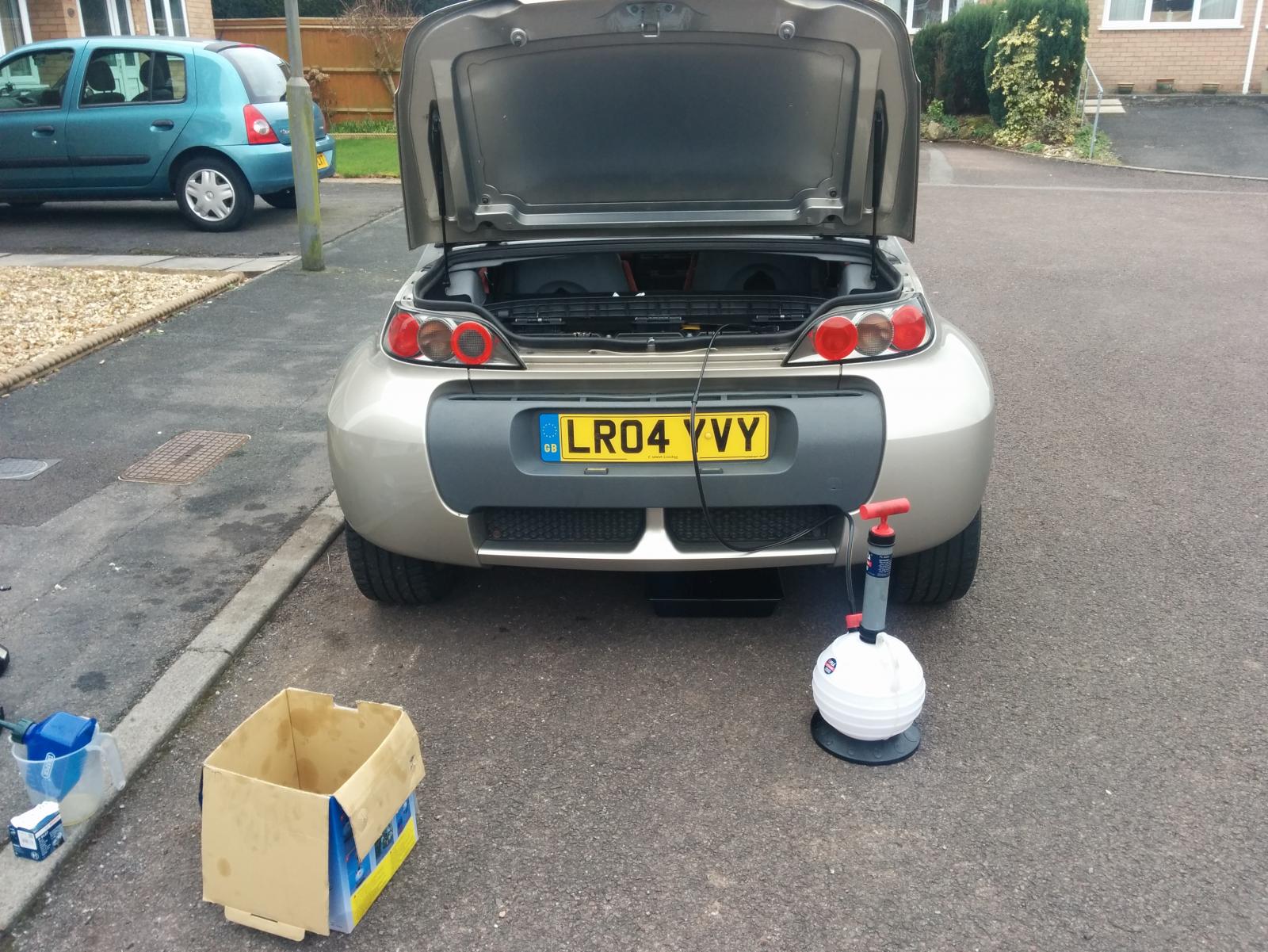

SiC Posted February 23, 2017 Posted February 23, 2017 It's the only way possible to change the oil on a Smart car engine. ...Unless someone has installed a non OEM sump with drain plug on. Just remember to have the oil warm before you do it, otherwise it takes forever (30-45minutes) to drain. I bought it originally to do ATF change on the Laguna. Also used it for the same purpose on the Saab I had. Works great for that sort of job. M'coli 1
