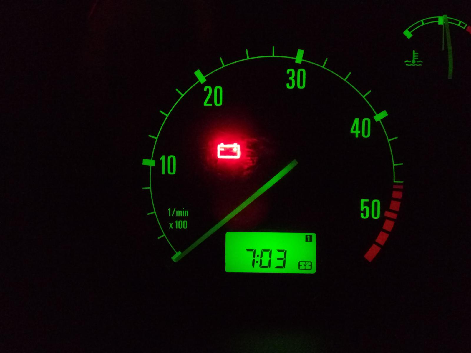

320touring Posted November 12, 2016 Author Posted November 12, 2016 Okay_ been out for the first proper run in this.. Applying actual air to the tyres has improved ride comfort and handling it runs 185/60/14s .. PROPER COMFY Look at the arseheatery! Also discovered that the fuel gauge reads in reverse..Pic one is before and pic two is after 15 sheets worth of derv. Seller had told me about it-apparently another pump was swapped in whilst trying to eliminate the fault, and the sender feed runs the other way. I have the original to swap in when I CBA Coprolalia, Shep Shepherd and SiC 3
SiC Posted November 12, 2016 Posted November 12, 2016 I wonder if a VAG-COM lead can program it to run the other way?
320touring Posted November 12, 2016 Author Posted November 12, 2016 I wonder if a VAG-COM lead can program it to run the other way?The thought did cross my mind. I have managed to connect successfully to it via vagcom.. Tbh its likely still easier to see if I can swap the power plug round..

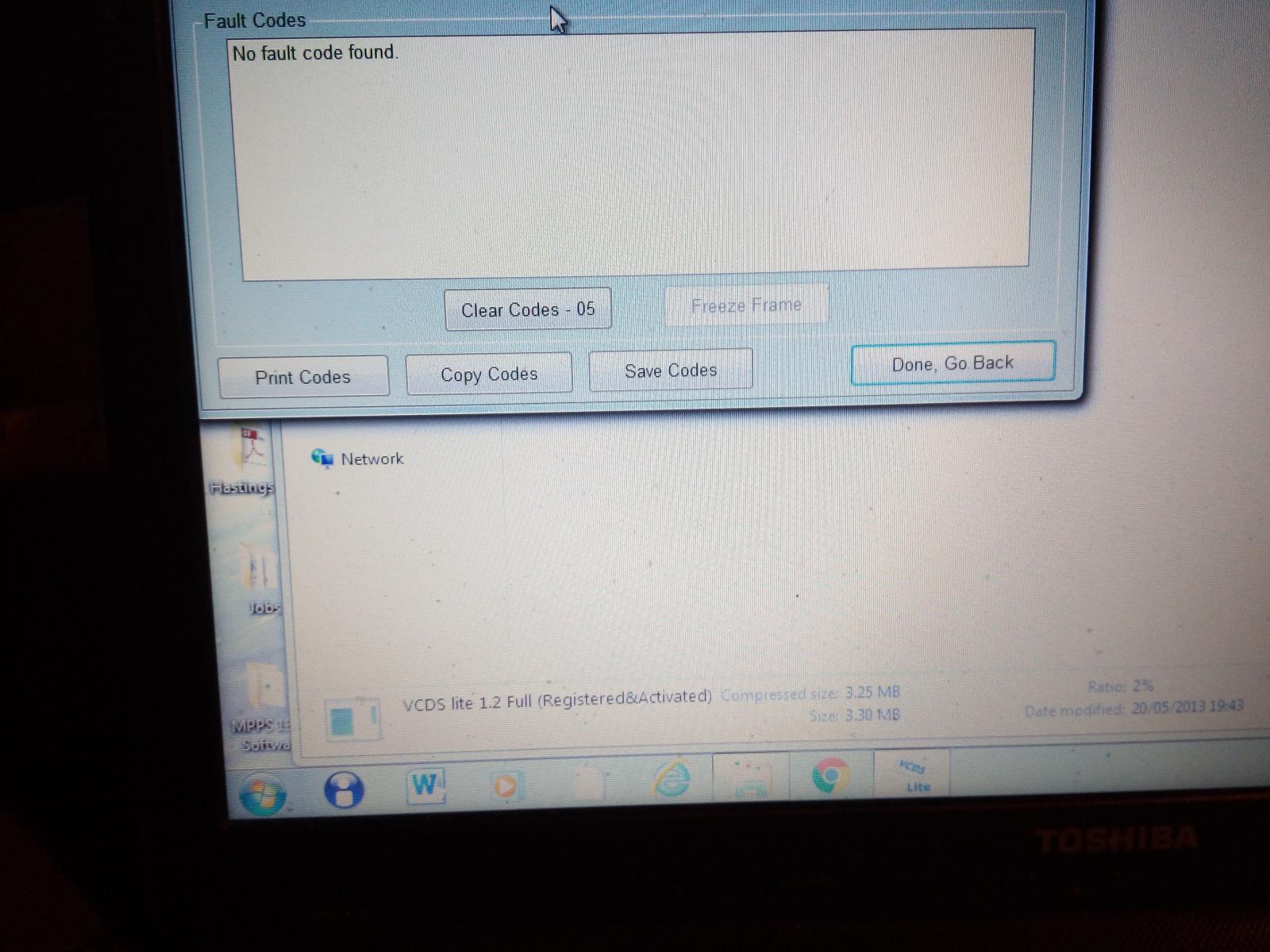

320touring Posted November 12, 2016 Author Posted November 12, 2016 Have you had your laptop on it yet?I have successfully read the codes with vagcom,the stock map read OK too. I'm not going to do anything to it until I have the can sensor fault rectified. Then it'll be a case of seeing what the insurance want for it to be tuned

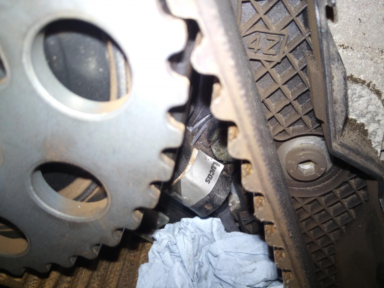

twosmoke300 Posted November 13, 2016 Posted November 13, 2016 Cam sensors don't usually cause a car to cut out . You can usually disconnect once they are running . Cam sensor faults usually show in poor hot starting first . What codes did vag com read ?
320touring Posted November 13, 2016 Author Posted November 13, 2016 Cam sensors don't usually cause a car to cut out . You can usually disconnect once they are running . Cam sensor faults usually show in poor hot starting first . What codes did vag com read ?Can sensor no signal intermittent Was what the code said -can't remember what number was. I'll get some miles on it and see if I get it to do it. I cleared all codes yesterday so will drive it for a bit and see what pops up. Cheers for the help on this:)

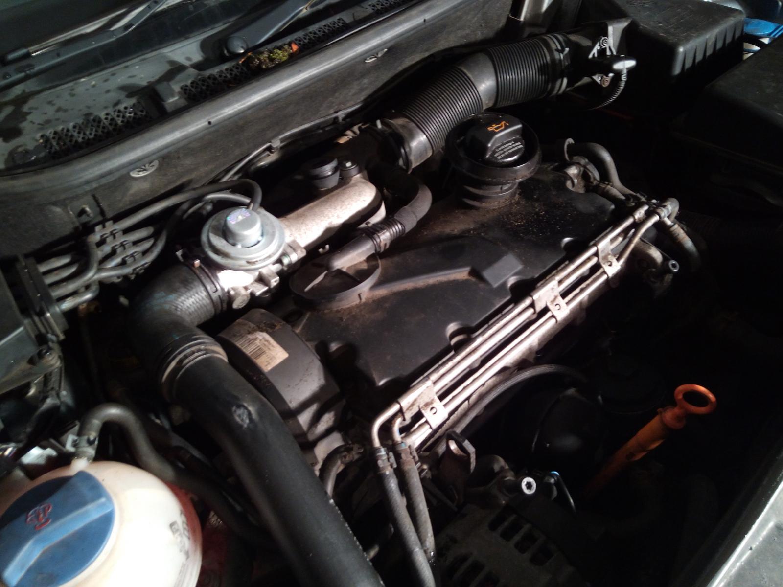

twosmoke300 Posted November 13, 2016 Posted November 13, 2016 Connector for it is round the front of the engine and you can change it without taking the cambelt off but it is snug
320touring Posted November 13, 2016 Author Posted November 13, 2016 Connector for it is round the front of the engine and you can change it without taking the cambelt off but it is snugYep-looks like a simple job for a competent chap..that's me fucked then.. Tickman and Dave_Q 2

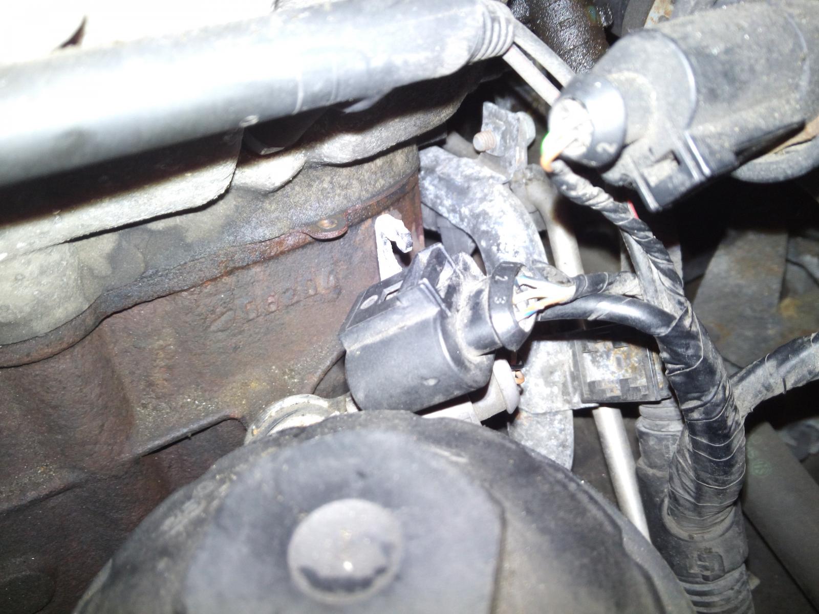

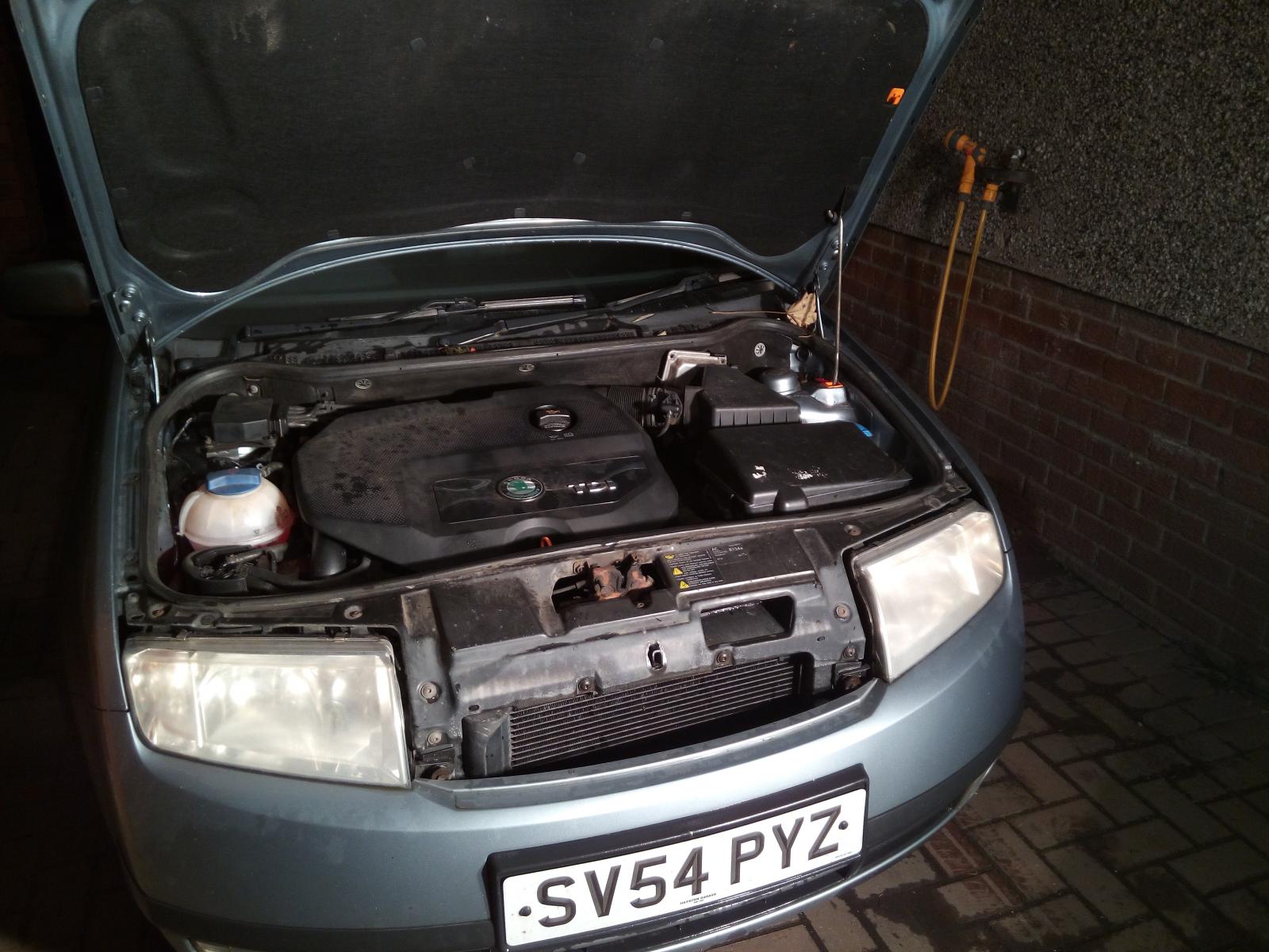

320touring Posted November 16, 2016 Author Posted November 16, 2016 Tonight this went to Dome's Fabia Fiddling emporium for some camshaft sensor shenanigry. First we scanned the car for fault codes as I'd cleared them all 200 miles ago. It flagged a 'camshaft sensor intermittent' as expected. Next up we stripped it down to have a look. First the engine cover was polled off, then the pipe onto the (very new looking)egr was removed. This provided access to the 2 spring clips that hold the top cam cover on. With that removed, we could see the sensor. Judicious use of a 1/4 drive ratchet and 10mm socket saw it unbolted. We then disconnected it from the loom end and examined it for damage. None was found. The loom end, however, showed a nick in the brown wire just down from the connector. This was temporarily taped up and everything refitted. A short test drive suggested it was running OK, so I did the 50mile trip home (via my bro's) I ran a quick scan when I got home- no codes! Think I'll get a loom end off a scrap car and patch it in - possibly with a bit more play on it as current one seems quite tight. Cheers to Dome, and to Bigfella2 for the spare sensor- not needed currently but good to have! Coprolalia, Lacquer Peel, Tickman and 6 others 9
Dave_Q Posted November 17, 2016 Posted November 17, 2016 Good effort. I would consider making up that bit of loom with new wire. Its hot where it runs and a replacement of a scrapper is likely to be a bit brittle and possibly not much improvement. 320touring 1
320touring Posted November 17, 2016 Author Posted November 17, 2016 Good effort. I would consider making up that bit of loom with new wire. Its hot where it runs and a replacement of a scrapper is likely to be a bit brittle and possibly not much improvement.The issue is that the bare wire is right near the plug end. Having a spare I can pull to bits and fiddle/rewire is the plan- car stays mobile in the meantime..
twosmoke300 Posted November 17, 2016 Posted November 17, 2016 I can see the problem - Lucas sensor - absolute crap . Would also be worth giving the steel teeth on the back of the camshaft pulley a good check for damage . The sensor reads off these and any bending can cause strange issues Dave_Q and Isaac Hunt 2
Dave_Q Posted November 17, 2016 Posted November 17, 2016 If you're robbing connnectors off scrappers get the connector for the electric mirror switch as it's the same as the one you need to fit cruise control. it looks like this.
320touring Posted November 17, 2016 Author Posted November 17, 2016 I can see the problem - Lucas sensor - absolute crap . Would also be worth giving the steel teeth on the back of the camshaft pulley a good check for damage . The sensor reads off these and any bending can cause strange issuesThanks:) got 2 other sensors in store- will check pully teeth when doing the loom replacement. Dave cheers for the info re the cc switch req
