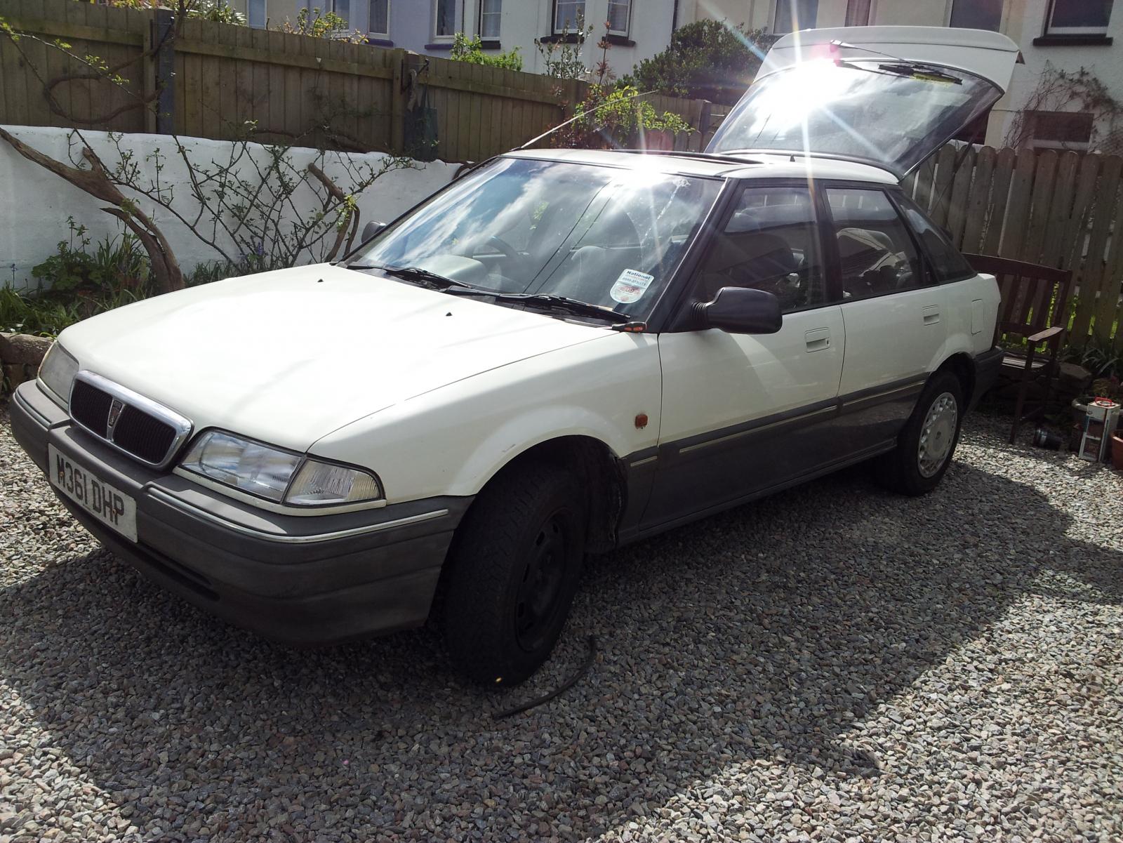

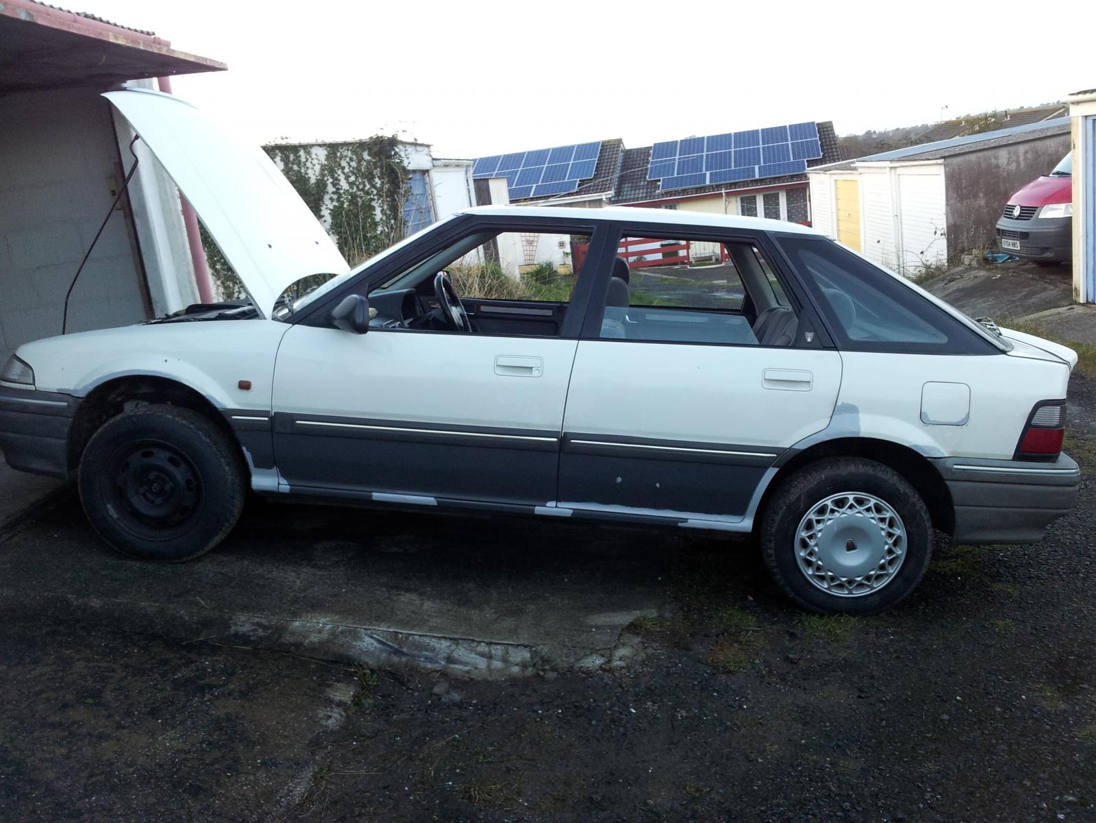

phil_lihp Posted November 12, 2016 Posted November 12, 2016 Have some before-and-after pictures of my attempts to tidy up the rusty bits, probably about 2 years ago. Probably about the worst and best it's ever looked when I've known it, although the white turned out to be a poor match. It went to Pride of Longbridge looking like it did in the first picture, only dirtier. I was quite proud to have one the worst-looking car in the show, until a shiter pointed out a Princess that had actual holes in the bodywork. There's something about this car I can't quite put my finger on but it does get under your skin, it's quite the most comfortable car I think I've ever had. I bought it off Mastervan in 2013 intending to use it for 6 weeks until the MOT ran out and then bin it, seeing as the screen was cracked, the windscreen frame was rotten and the waterpump was incontinent. Instead, I used it the following weekend to tow a trailer full of kayaks up a number of very steep hills whilst full of gear and a full complement of passengers and it didn't complain much at all. I spent far too much money on it in the next 6 months, waterpump, radiator, windscreen, welding, paint...worth it! My thread on it is here: http://autoshite.com/topic/14775-220sli-roverdue-maintenance/?hl=220sli I had the same MOT crisis and the Autoshite hive mind were no help at all in persuading me to give it a dignified end, it ended up being much less expensive than first anticipated which helped a lot. vulgalour 1
