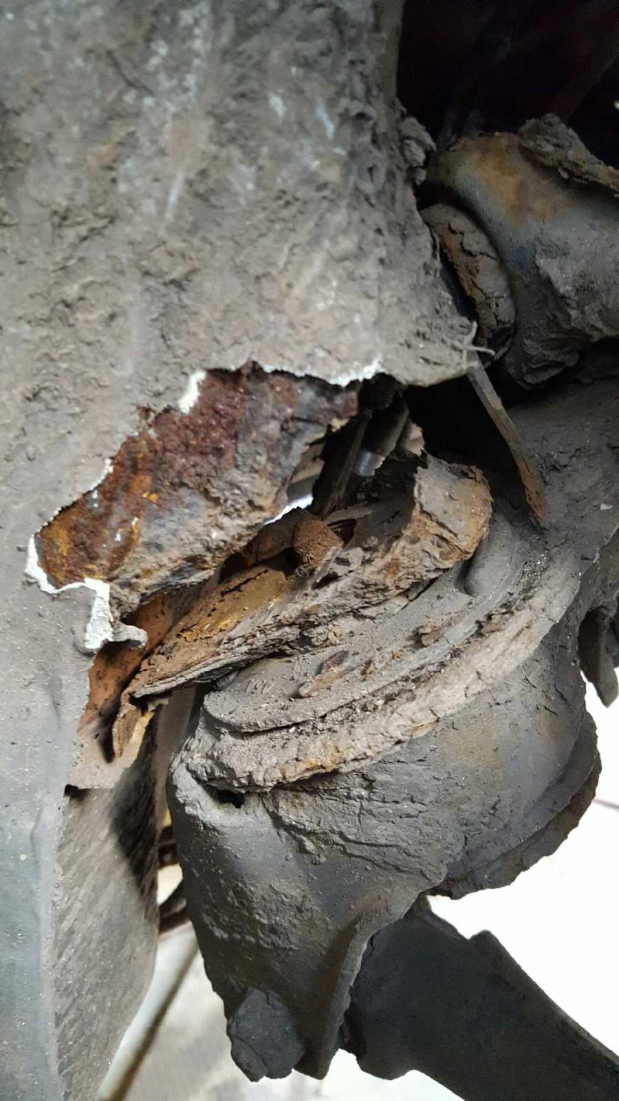

post-18106-0-65591100-1477116320_thumb.jpg Pics !!!Rot is on the rear subframe mount, front passenger side. Anti roll bar clamp is buggered as well !

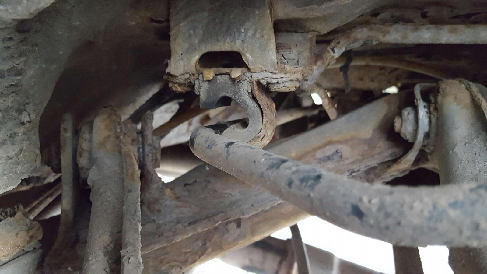

Another pic, showing antiroll bar rustiness.
That subframe rot looks pretty bad. I'm not sure I'd tackle that unless I could chop the corresponding bit out of another car. I can see why they wanted 500 quid now!
If the strength or position of the repair isn't bob on then the subframe might not sit right. The subframe will need to come out the car to repair it properly unless it's a lash up, which probably won't be safe.
The ARB bracket I'm guess you can buy, if not it should be easy enough to make one up.

The subframe looks okay there I think it's the bit it attaches to on the body that's the issue. My 5 series rotted out all it's rear subframe mounts. I only found this after spending a fortune getting the chassis rails welded and was having new rear subframe bushes fitted when I had that ominous call from the garage when they say "you'd better come and look at this".
The was harder to fix than this though. I ended up up selling it as is and taking a crushing loss.
As cort16 said, subframe is scabby but not rotten. Its the mount that's welded to the chassis that is gone. Just had the carpets out and the inside of the sill/chassis looks brand new with a lovely skin of waxoyl type stuff sprayed in there. Shoved a screwdriver in the general area and all appears sound from inside. Repair part is £66.00+vat from MB. Other side has underseal peeling but seems solid could be fairly straightforward. !
Subframes aint a bother for me, it's the mounts on the monocoque bit that's the prob. If you do all the prep, then the weld might not be too expensive.
