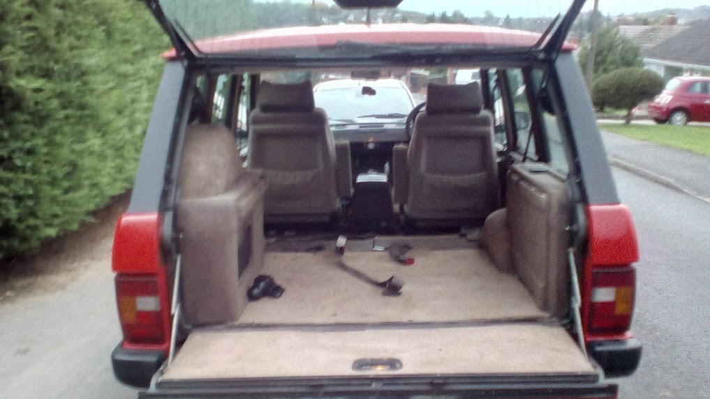

Hardly Rusty red-ish Range Rover (See below)
Sorry for random blurriness. Will take proper ones tomorrow on a good camera.

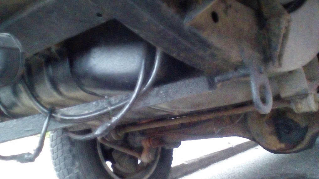

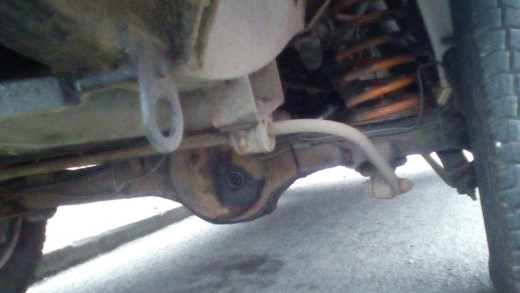

Fairly certain it's actually the rear diff/bearings. Seems a lot of movement before drive taken up (in diff).
Clunk is more lesser now avec new oil/proper idle speed.
Whine is whiny.

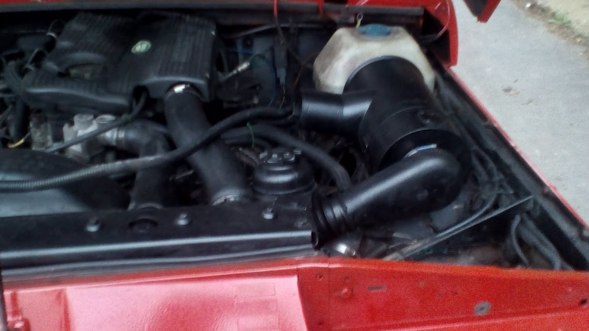

New lift pump does, as opposed to old one , which did sometimes.  :-)
