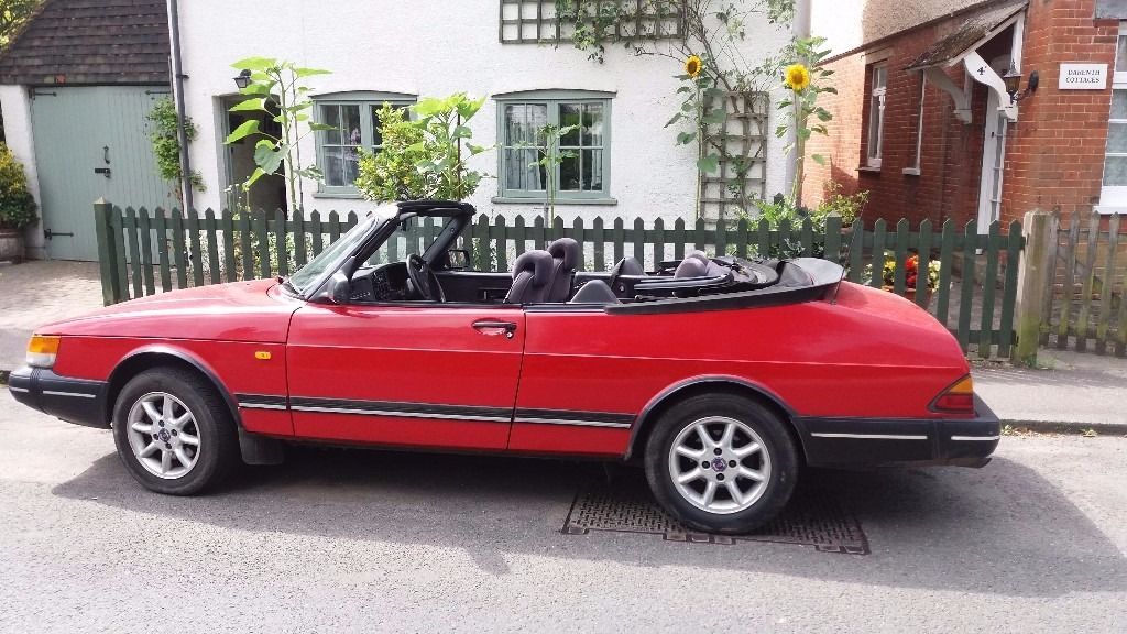

https://www.gumtree.com/p/saab/saab-classic-convertible-1991-non-turbo-2-owners./1191952395
That is:
very close to me :)
not much more than my budget :)
very red :)
a car that would need a thorough inspection by an expert  :?
too late, the deal has been done on the SE turbo :(
