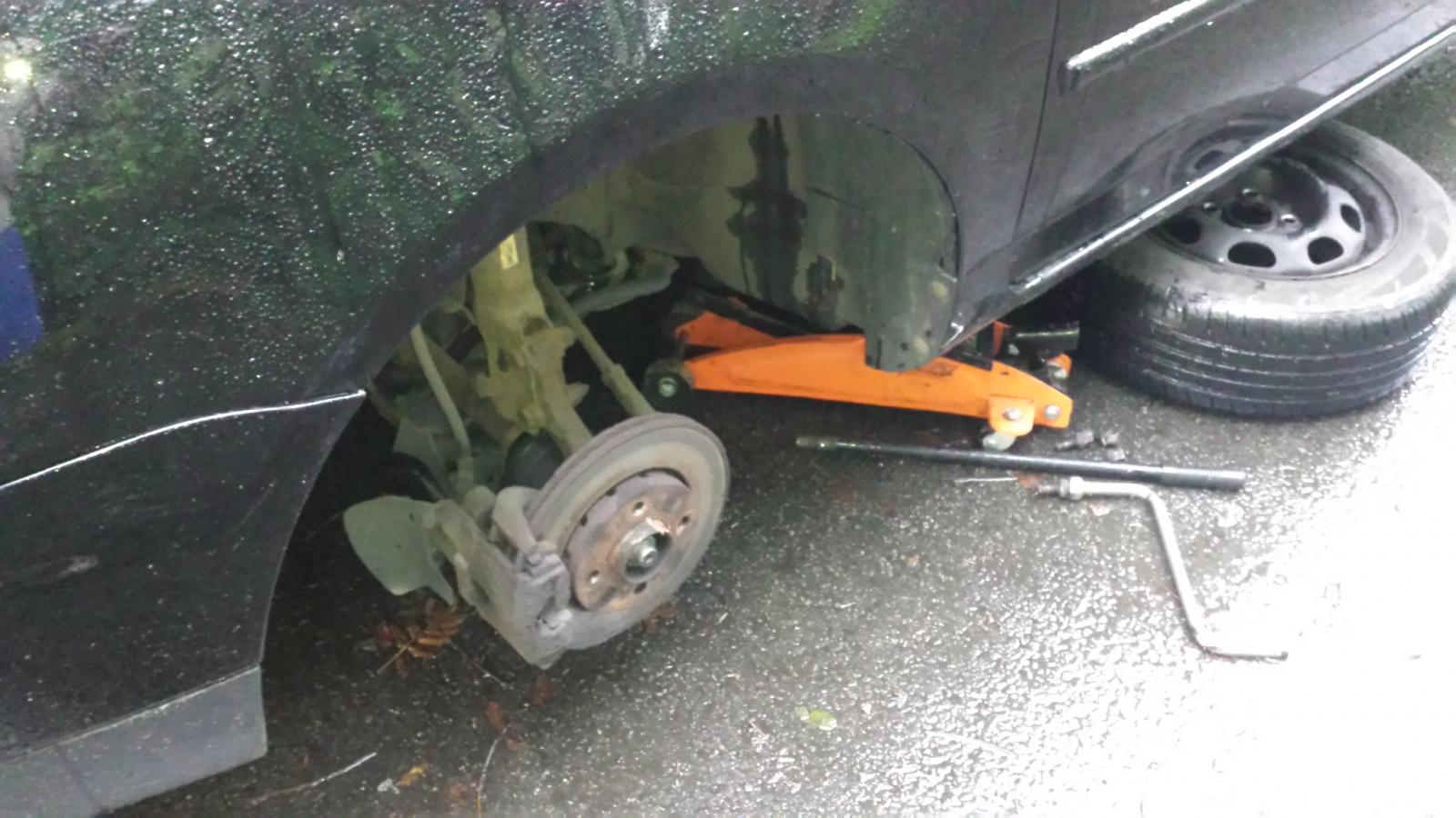

I might be telling you something you already know but jack up and support both sides of the car, otherwise the anti-roll bar acts on the side that is in the air and makes it extra hard to get the arm out.
If it has an anti-roll bar.

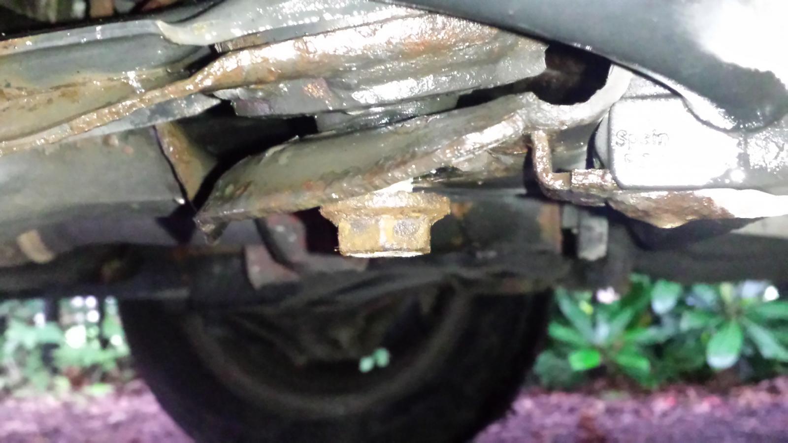

I got her jacked up and attempted to loosten all the bolts in both front arms.

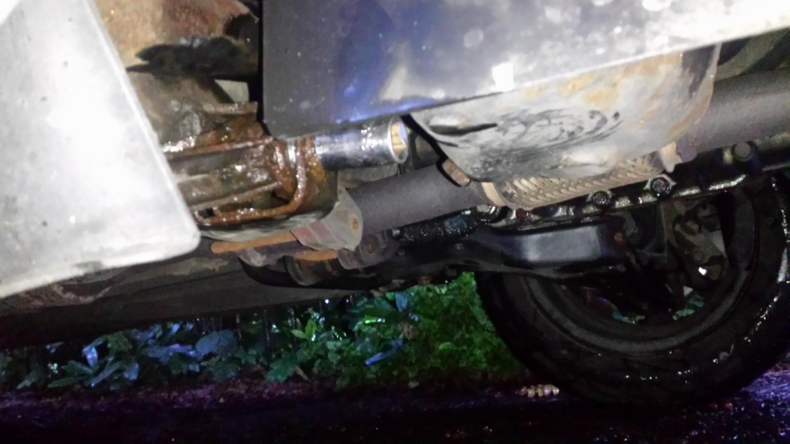

on both sides the rear bolts, subframe bolts and arb droplink nuts came undone no bother. The subframe bolt on the drives side needs to be undone with a spanner as a scoket will not fit due to the sump.

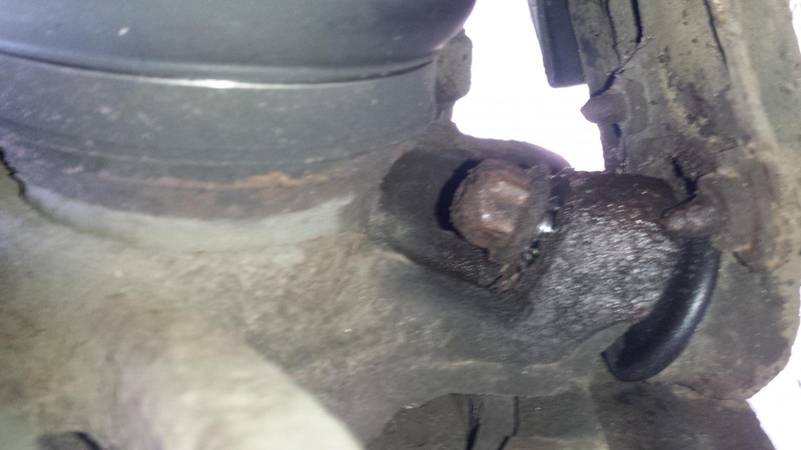

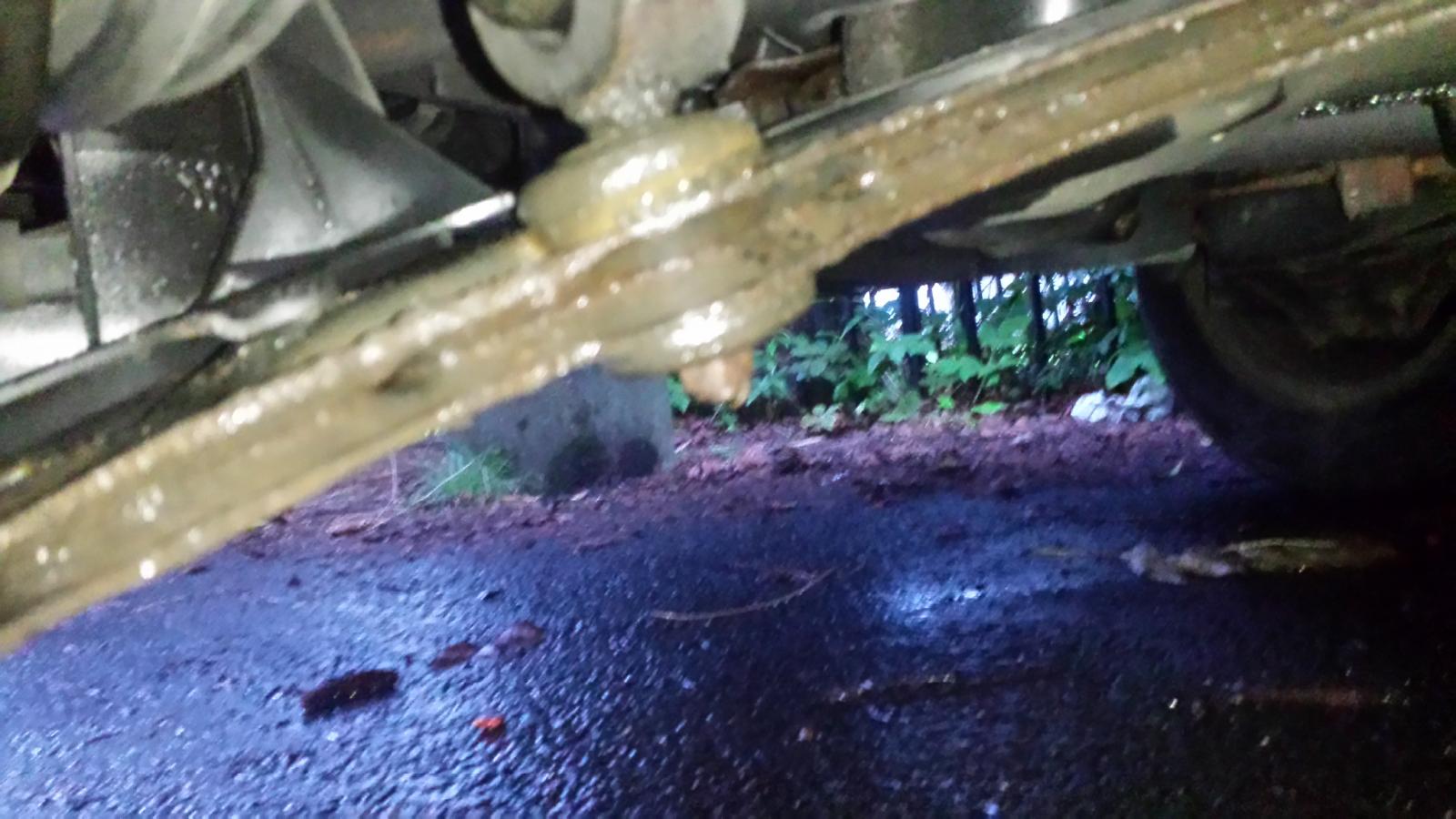

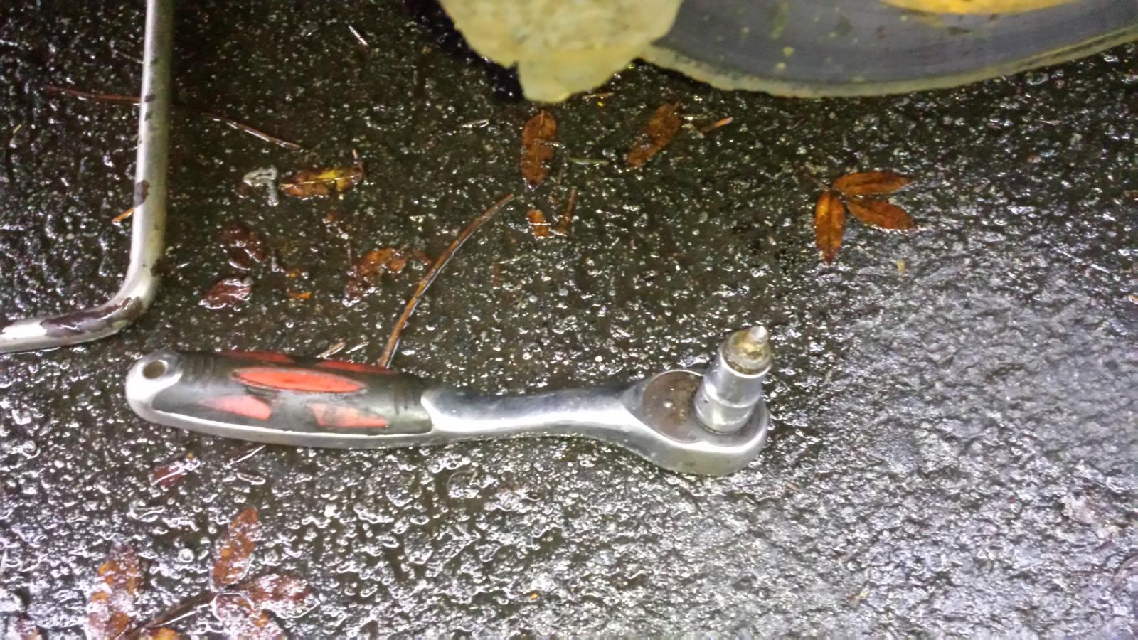

On the passenger side, I had the first 13mm balljoint bolt I tried snap.
I decided not to attempt undoing anymore at the moment. I'll call a local garage and see what they'd charge- I know I can get the arms for 60 quid inc balljoints. As long as I can get the 13mm bolts out then the arms should be swappable without doing the balljoints.
If you want to make access to the offside subframe bolt easier, take the engine mount off and use a scissor jack to slightly raise the engine out of your way.

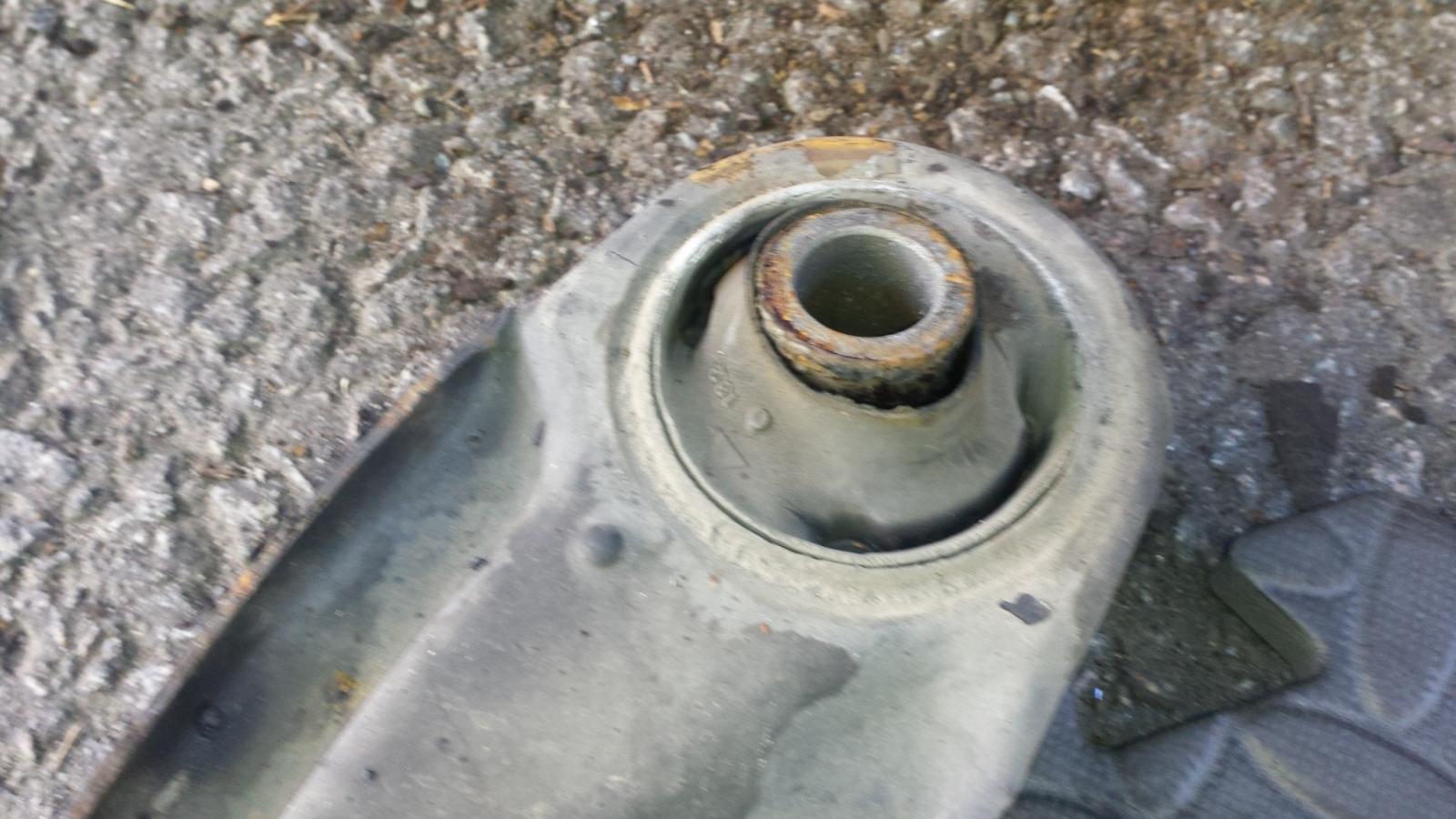

In my view, if the arms have enough miles in them to bugger the bushes, the balljoints will probably be near the end of their service life. So don't bother with the balljoint bolts, just undo the taper nut and use a fork splitter to separate the balljoint from the upright.
Then replace the whole lot ! You'll be amazed at how much better the car will drive !
Yep, this very muchly. You don't need to worry about the ball joint bolts if you're replacing the wishbones and balljoints.

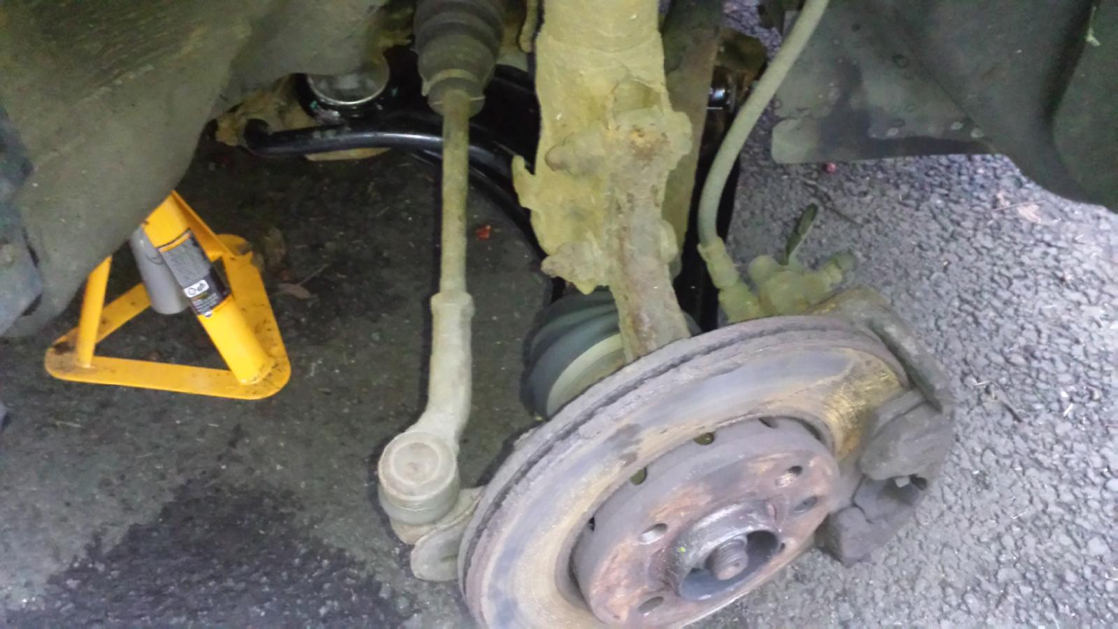

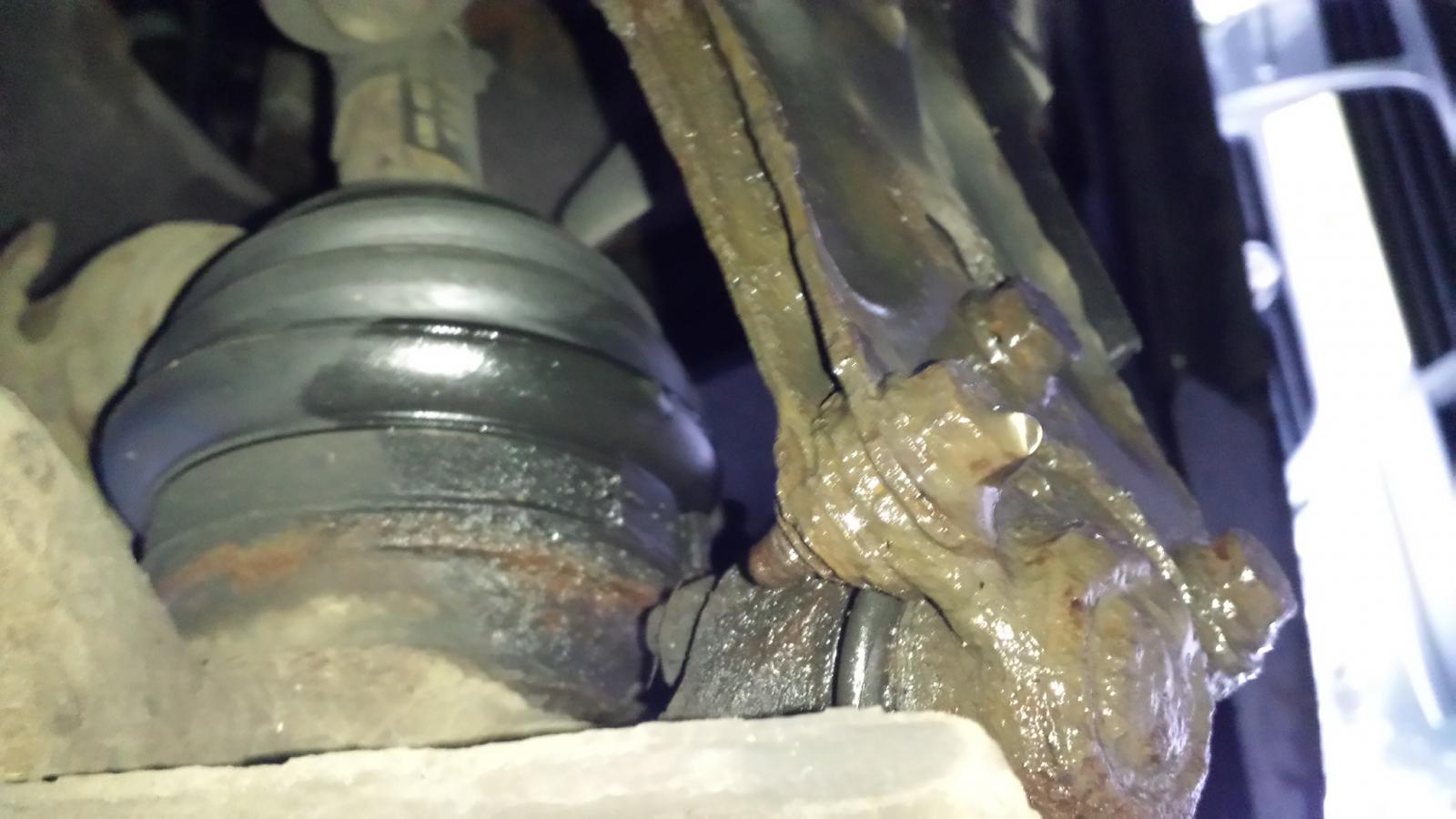

The balljoints look like a pain in the hoop to get to as the driveshaft is directly above..

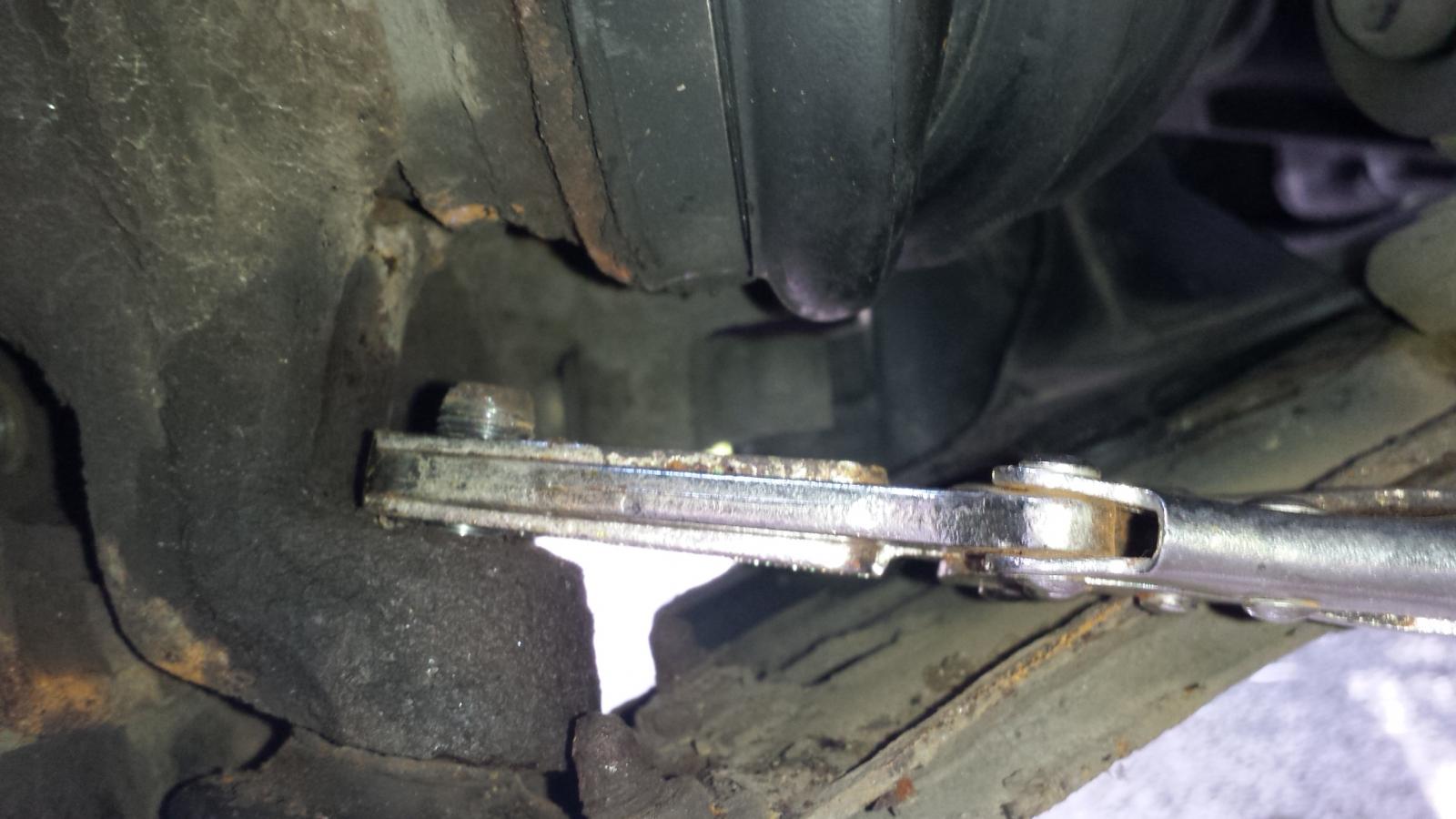

I bought something like this to get the nut off the balljoint on my Uno, which was similarily placed in relation to the driveshaft:
https://www.cromwell.co.uk/shop/hand-tools/pipe-wrenches/8%22-12%22-speed-wrench-set/p/SEN5889010K?utm_campaign=pla+-+&utm_source=google&utm_medium=shopping-pla&utm_keyword=SEN5889010K&istCompanyId=6aa6787b-063e-4414-802d-129f235df603&istItemId=aqrxaxiqi&istBid=tztx
If I can get the nut off a balljoint in darkness and split it at the roadside (University Avenue!) to get the driveshaft back in, I'm sure you'll be fine!

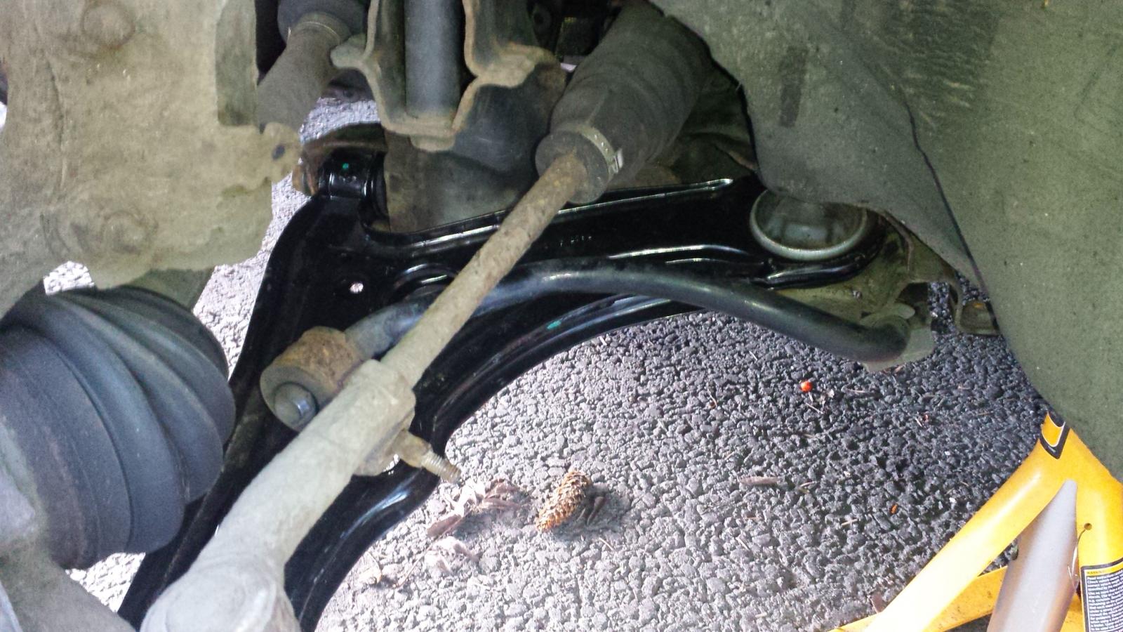

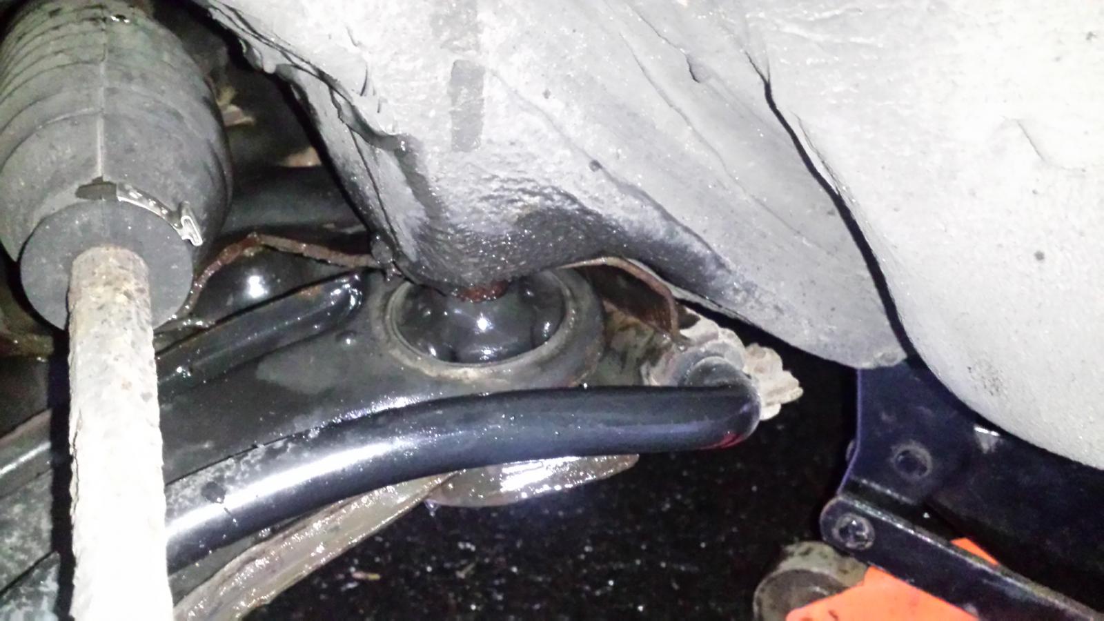

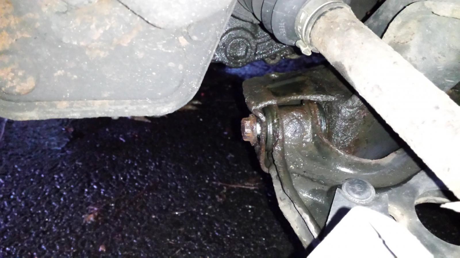

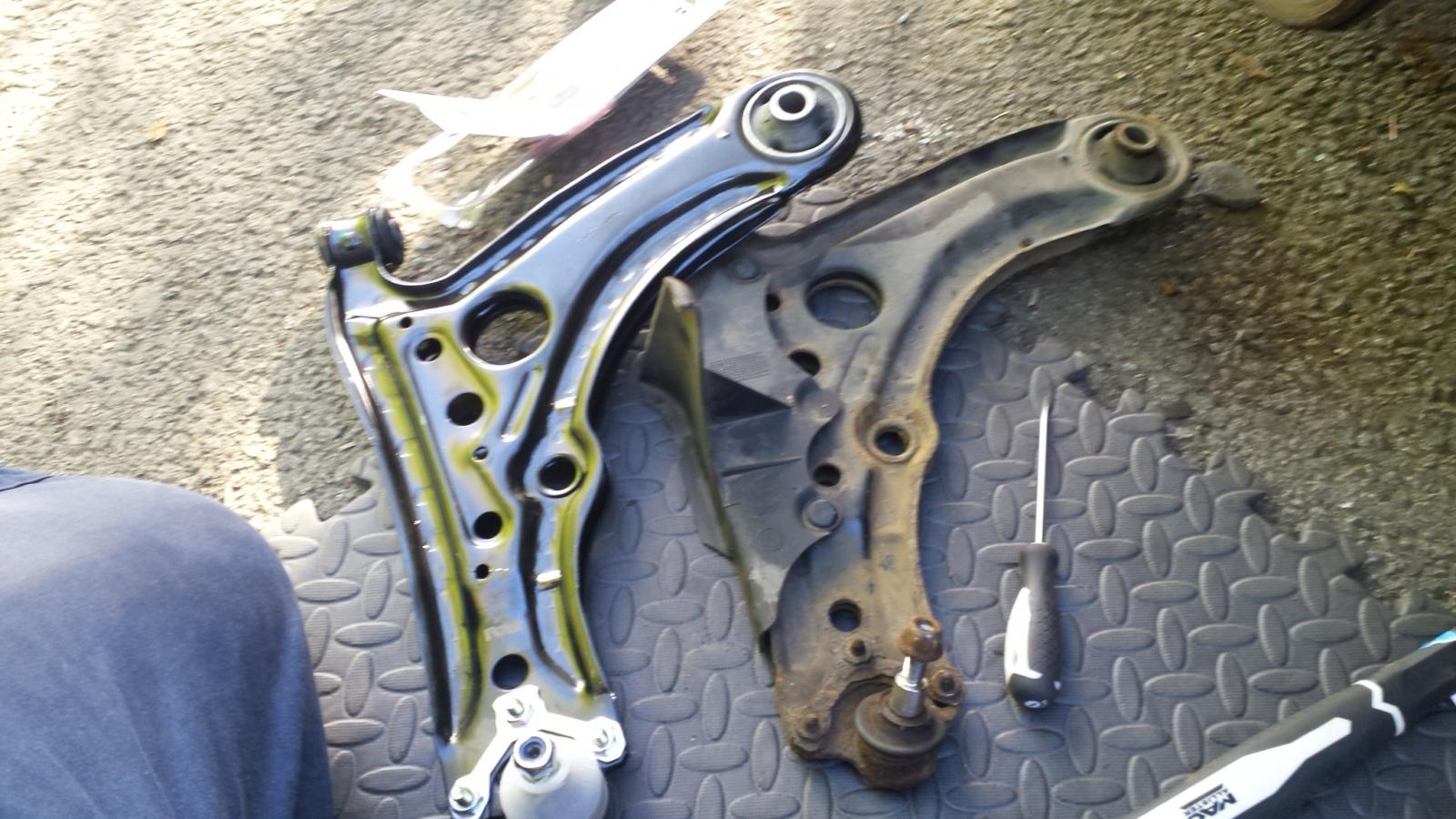

Despite some mild beverage consumption on saturday, I saw fit to sort the 2 front arms on this today.
Passenger side was a doddle but by the time I got to the drivers side I was due a bit of grumpages.
I couldn't get the rear bush to slot in properly.additionally, I had to jack the engine up to get clearance to take the front 16mm bolt out the subframe. Despite several attempts, I had to admit defeat and gave my brother a shout. he turned up, looked at tit, and turned the steering to thr other lock.
boom job done.
Thats the 2 failure issues sorted so I'll get her in for an MOT this week:)
