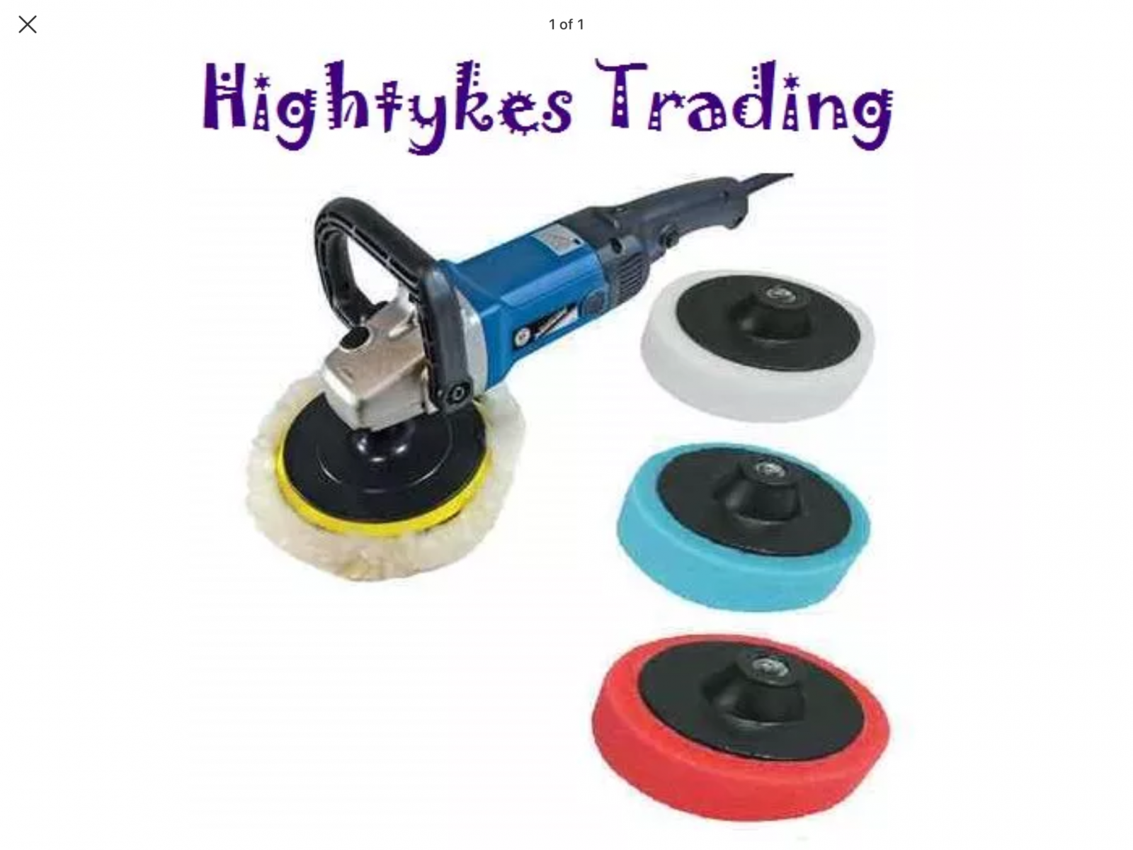

Is the polisher in the original photo an adjustable speed one? If not, it'll be useless. I've got a Silverline one like this
https://www.ebay.co.uk/itm/231296268021
Fifty notes so it's cheap compared to a professional one, it's nice and light to use, adjustable speed and a decent 'keeper' tool. I bought mine a few years back and only use it occasionally, but it does the job perfectly. Completely coincidently, I used mine this afternoon to polish my back bumper as it's covered in scratches, and I'm trying to sell the car. Polisher along with cutting paste did a pretty damn good job, and way easier than a hand job (fnar).

So as long as you are careful, the rotary ones aren't that scary?

Careful is key. Low speed at first, use figure of eight motion and keep it moving. Press very, very lightly until you're used to it. Quite satisfying tbh!

Well for the sake of an extra couple of quid that's what I'll go for then, cheers

Id spend the extra cash on a DA over a rotary to be honest, they are a lot less agressive and easier to use, the big rotaries can be hard work after a while.

i would spend the extra on a d/a or that little tykes thingy pictured above
