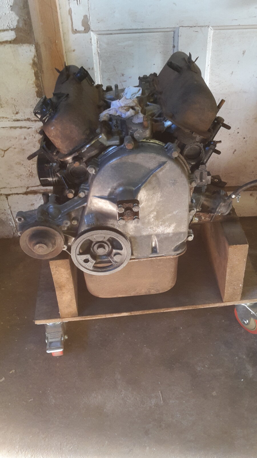

Bit more done today, I gave the block a good dousing with Jizer followed by a scrub with some turps and later on a coat of some ancient motorcycle high temp engine paint, rather pleased with my patent engine trolley! Next job will be to remove the rocker covers and sump for painting and get to work on the manifolds.

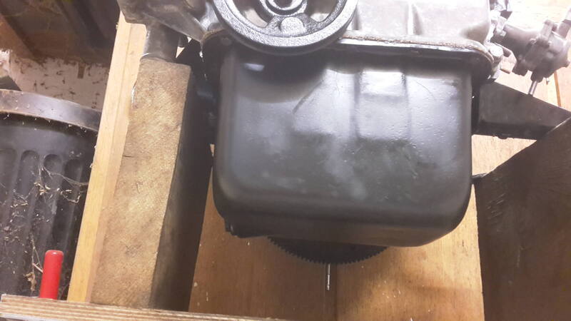

Wee bit more done today; another front spring back in and took the sump off for a cleanup, inside and out.  The oil pump will be replaced.
There was a fair bit of the black ooze in there...
That's a nice swarm. Looked pretty docile too!

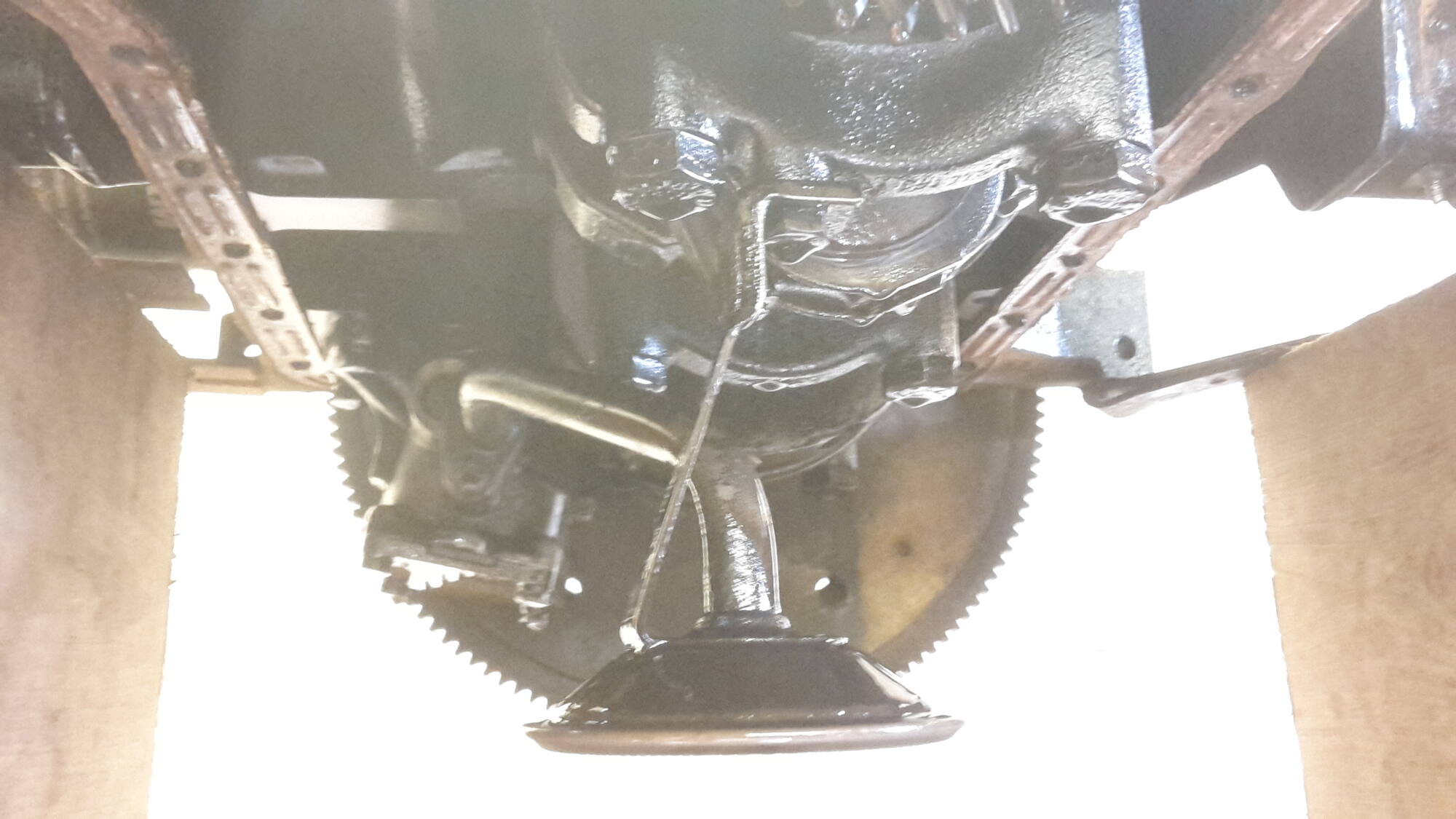

Bit more done today,  whipped the sump off, gave it a bloody good seeing to with an angle grinder and wire brushes, rust stabiliser and some stove paint.
Then pulled the old oil pump and pick up and replaced with a new one. Replacing a sump gasket upside-down is actually easy enough, the gasket sealant sticks like the proverbial shit to a blanket.
What puzzled me was that the jack shaft from the oil pump connected to nowhere in particular inside the block. Turning the crank over yielded no motion so I began to think I had lost a part from the block end of the shaft....arse cheese....
Then in a moment of clarity I realised that the distributor lies directly above the oil pump and is the type driven by a pinion from the camshaft. On further inspection the business end of the distributor revealed a hex shaped hole for the oil pump shaft to run in.
The distributor on inspection has a bit of play in the shaft so I may need to go to electronic ignition to get really accurate timing.
Next up will be some work on opening the exhaust ports to match the new exhaust, replacing the inlet manifold and removing and painting the rocker covers.

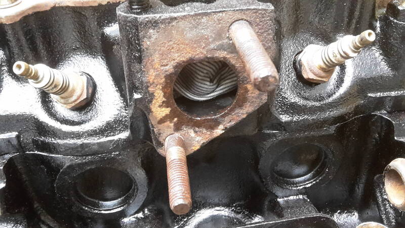

Well, I took a look at the exhaust downpipes and the manifold today. First minor issue was that the mounting brackets are thinner on the new exhaust.
I didn't want to use the old brackets as that would involve cutting and welding one as one is captive and the old ones are, I think, cast. Best to extend the threads a bit, 10mm so no dies to purchase.
Just about had enough time to profile the exhaust ports; I didn't take that much off. Extended them from 32mm to 35mm and rounded some of the hard edges off inside.
Cast iron so very easy to grind away.
Even so, that's about 15% bigger. There isn't any point in going further than that, as the ports are no bigger further in and you'd certainly need to take the heads off for that and a flexible shaft grinder head would be needed.

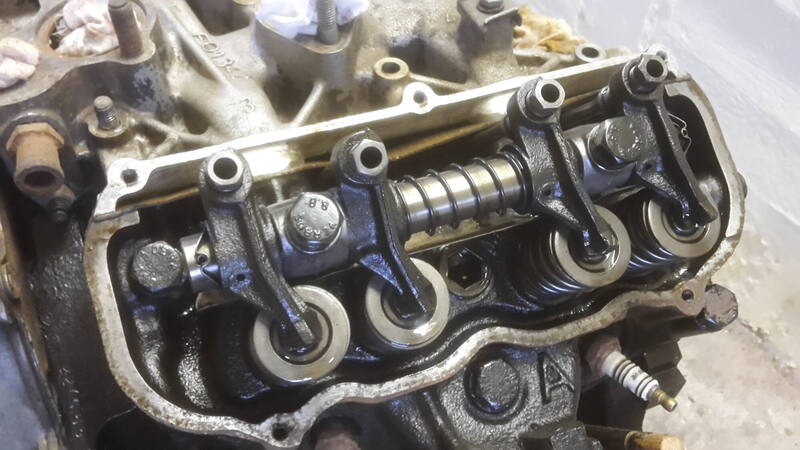

Removing the rocker covers revealed a surprisingly clean pair of rockers and valve gear, which suggests that the 41k mls on the odometer may be correct.

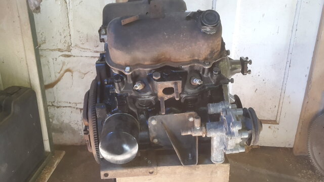

A new water pump has also been fitted so all that remains to do before the block is refitted into the bay is to set the valve clearances and replace the rocker covers.

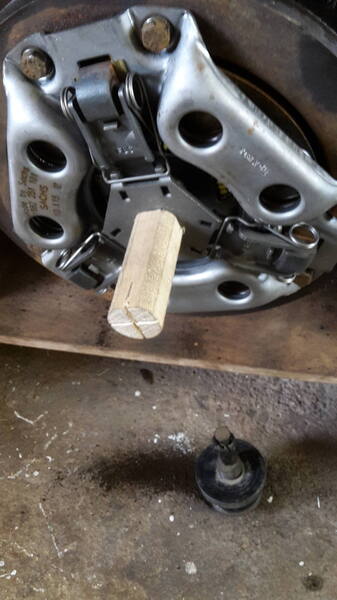

Replaced the clutch as well, clutch alignment tool I had was fucking useless so in true shitter fashion a bit of timber was turned up to the right dimensions.

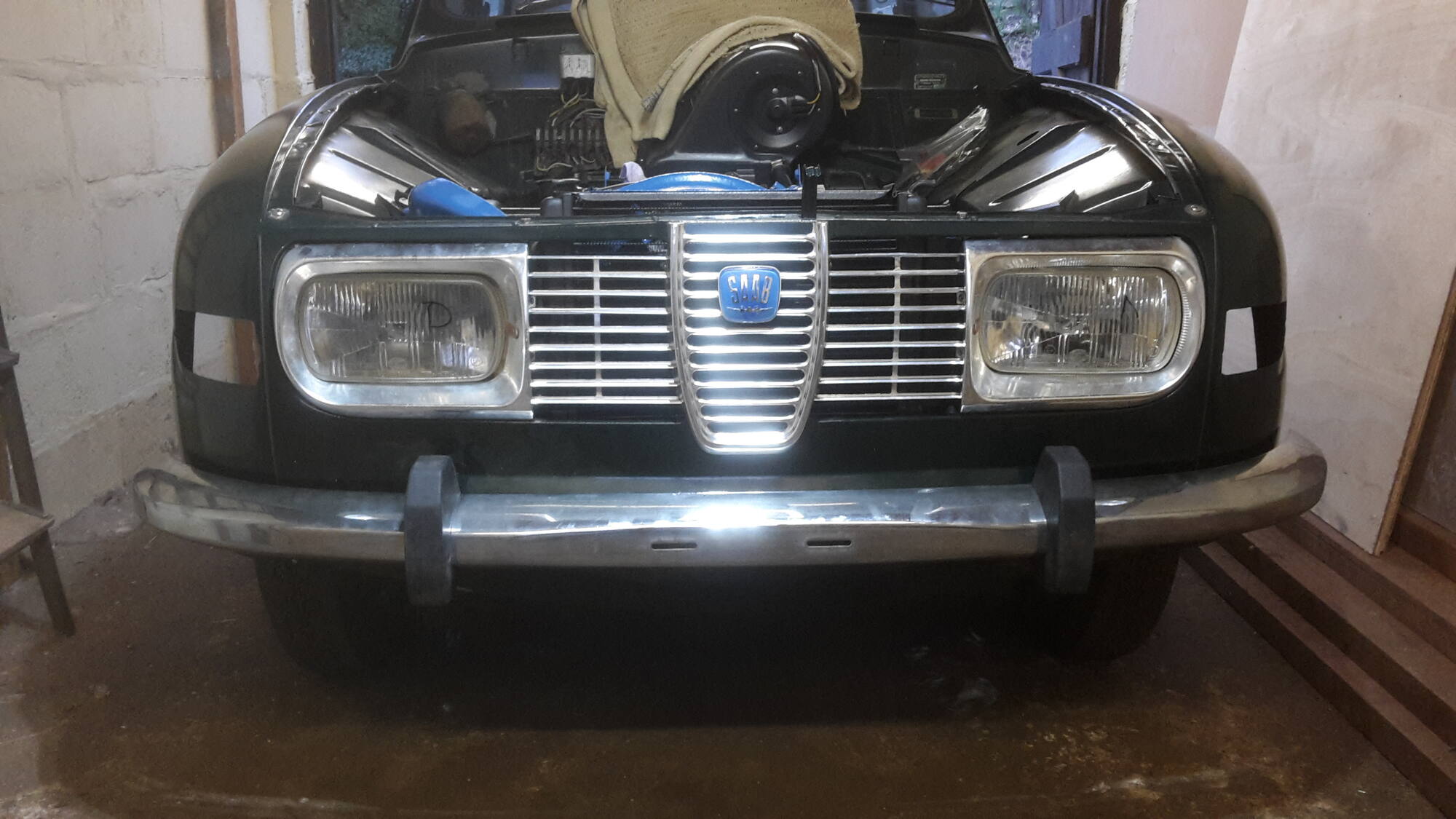

Done a bit on the green un over Christmas,  including panel work and painting the front wings and replacing them. Today I replaced the front bumper, considering it was parts scavenged from four bumpers it fitted really well. The captive nuts that I'd welded into the front valance were spot on.  Next up is replacing the alternator and a few other electrical bits; then on to fitting the distributor, carburettor and hoping she's jetted about right.

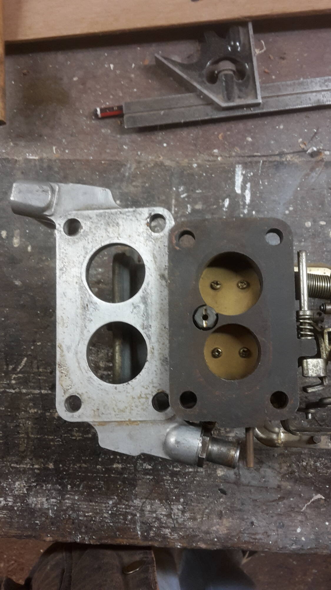

In the meantime I have found that virtually every aspect of the 5 Nikki carbs I have is wrong....The hole spacing on the bases, the fact that the 96 has a pusher rod operating the old carb, rather than something to pull on the Nikki linkages or pull a cable on the one I have which is set up for that...
However with my near genius level of bodgery these obstacles will be overcome.
