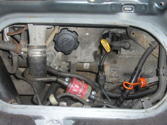

Neil, do you use those clear plastic disposable inline filters as well as the big one?
I fit one before the main filter to catch any big lumps (big one lasts longer then), also you can keep an eye on what's coming through from the tank.
That's my P_Wagon, here's the Xant:
I'm going to run it on derv for a tank to make sure its not still drawing air..
It sits where the red filter did now on the xant, cable tied somewhere.
