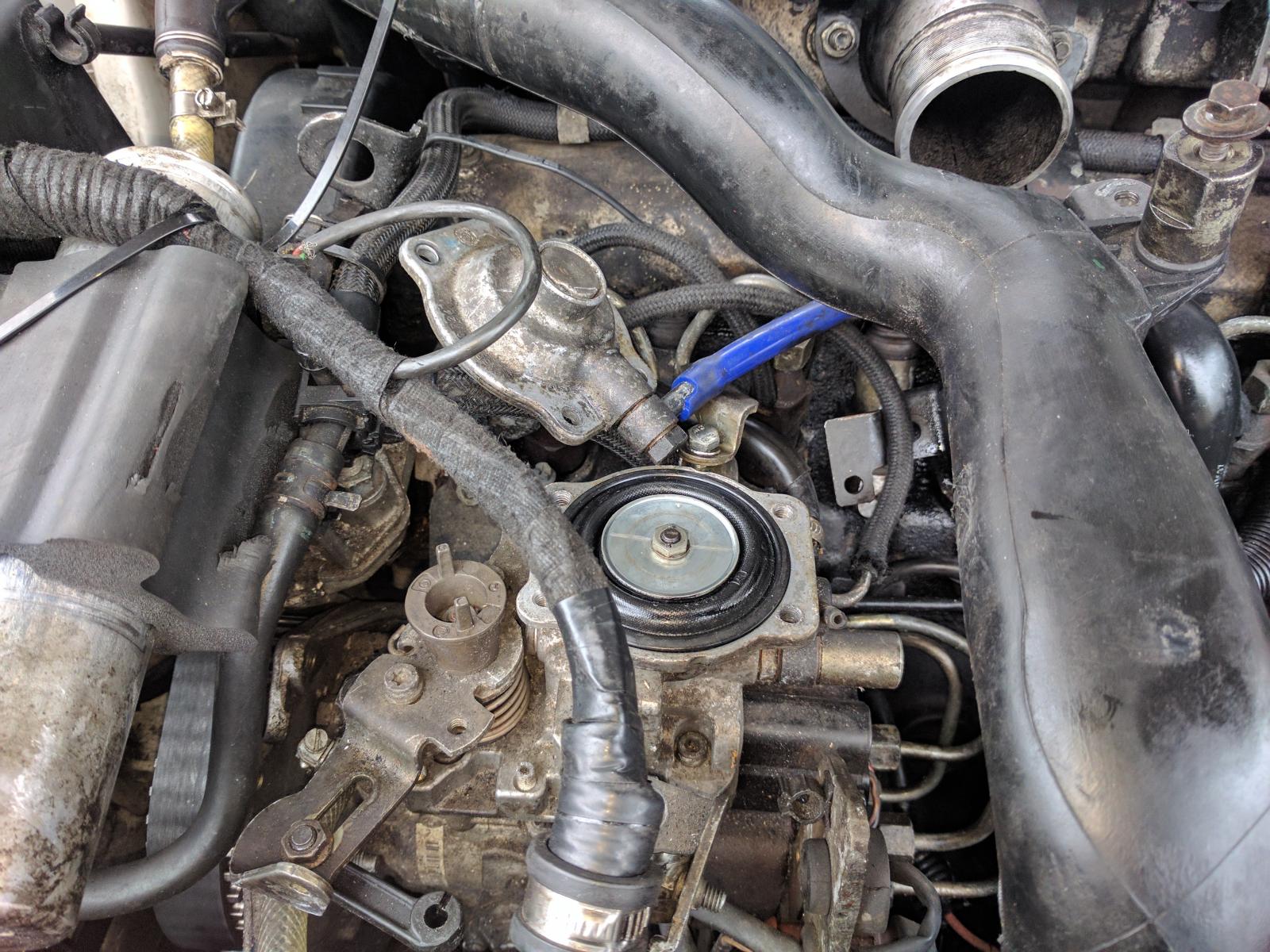

I'd go another turn on the max fuel and turn the LDA round to "GLF" setting.
Another turn from what it is now or another turn after 2/3?

Just 1 turn, turn and a half max, it doesn't need to blow coal.
Check the stop solenoid connector on the injector pump, not too unlikely it's loose after all the work you've done in that area.
ETA. Is sub 800 rpm the correct idle speed?
It might be that the anti-stall lever needs a slight adjustment after all the work the pump has suffered; I'm sure Haynes details tweaking it.

The power clouds are back! But only because I managed to turn the fuel screw in a turn and a half by accident, tightening the lock nut moved it the extra half turn, so need to tweak that back at some point. Lda has been flipped, and I tightened the throttle cable back up too after making it floppy for the mot. Possibly a bit too tight as there's no slack at all, could do with moving back a section or 2,or ill get used to it.
Went up the road quickly just to check it would at least get me home though and it's much better! Idles gone up a few hundred revs too, so it no longer needs gas to idle nicely on tick over, so the bypass should be more bearable.
