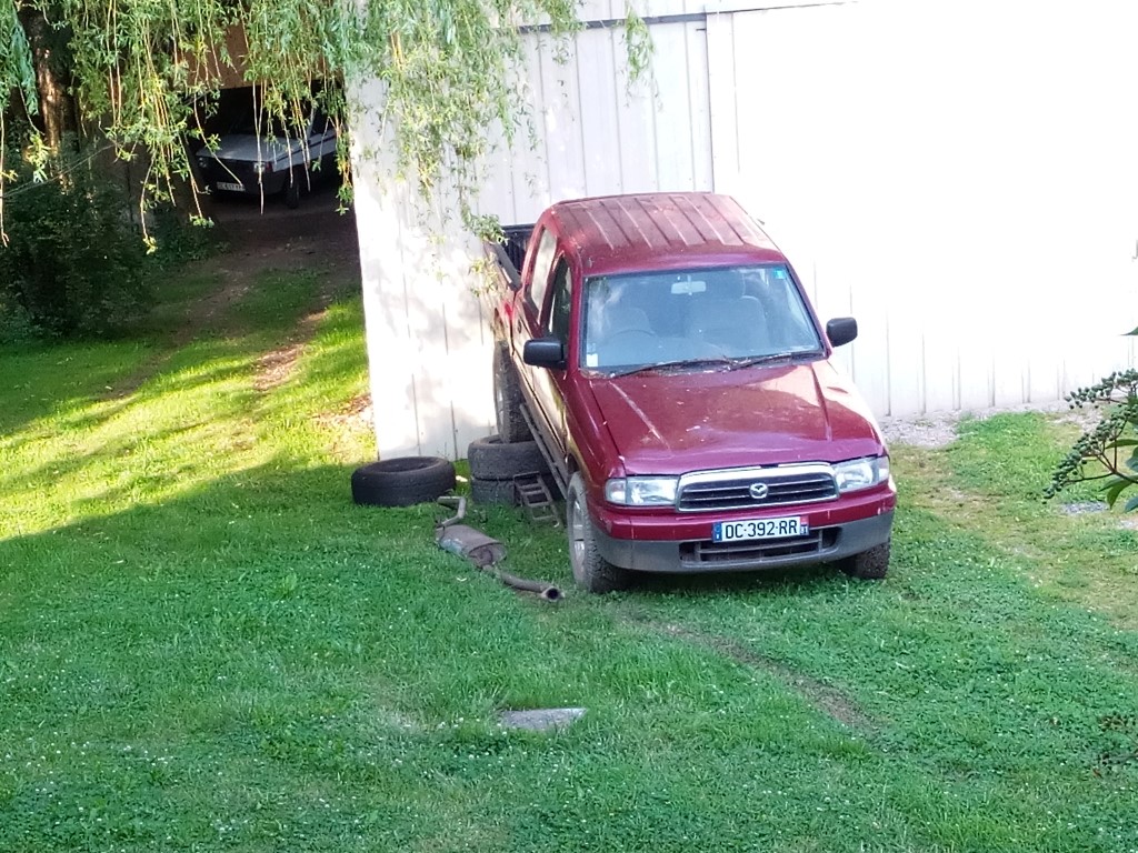

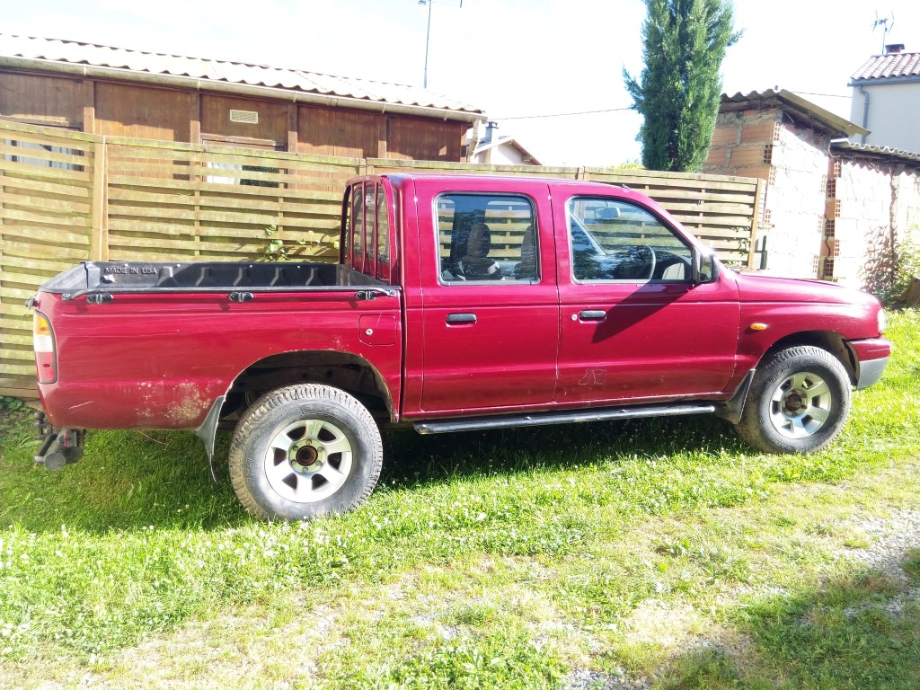

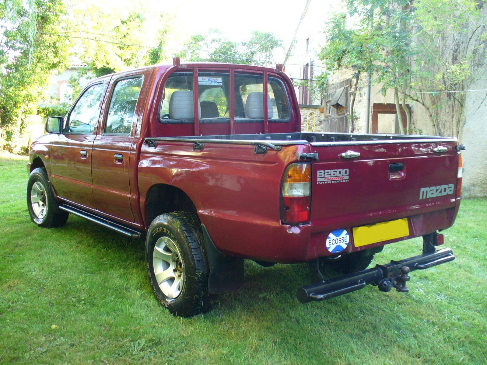

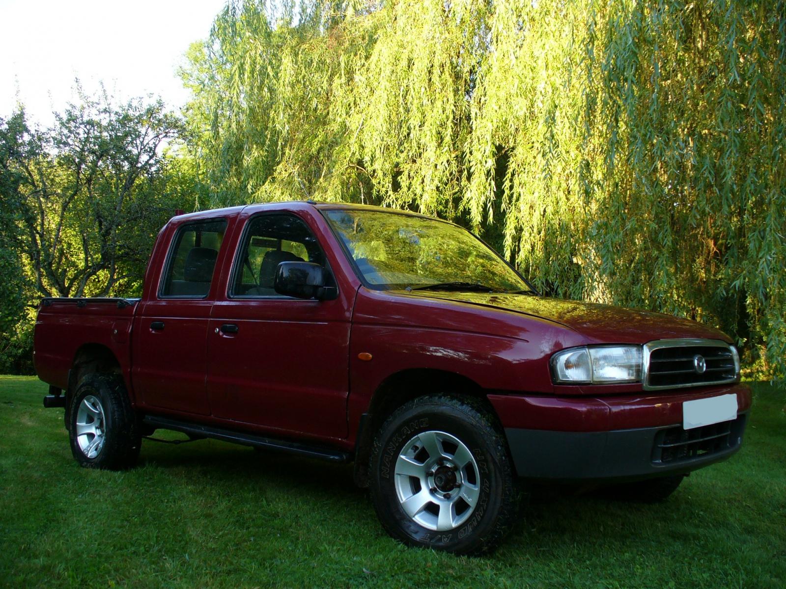

So as a stopgap I have dragged the old Mazda B2500 out of the bottom of the garden.
It has proved impossible to sell every time I have tried to get rid, attracting the worst of humanity every time, with people expecting a new truck with full history and a years guarantee (granted it does look good in photos) for a grand so I invariably get the hump, tell everyone to fuck right off and withdraw the advert. Just as well really as I need the fucker now.
Its one of these twin cab wanker-wagons although its refreshing devoid of overly macho model names like Ultimate Trojan Warrior or whatever Mitsubishi are calling them this month. It does have council estate spec Carlos Fandango wheels though, which I kinda like!
Problems....its missing most of its exhaust and its rotten as fuck. So I should at least do something about that before putting it in for a CT test. I backed it up onto some old tyres and got busy.

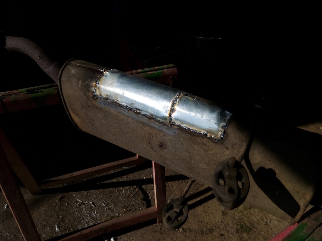

The exhaust was easy enough. I went full pikey and welded a patch on the silencer which was burst open right down its side and I made up the missing rear pipework with some offcuts of old exhaust out the farm scrap pile.

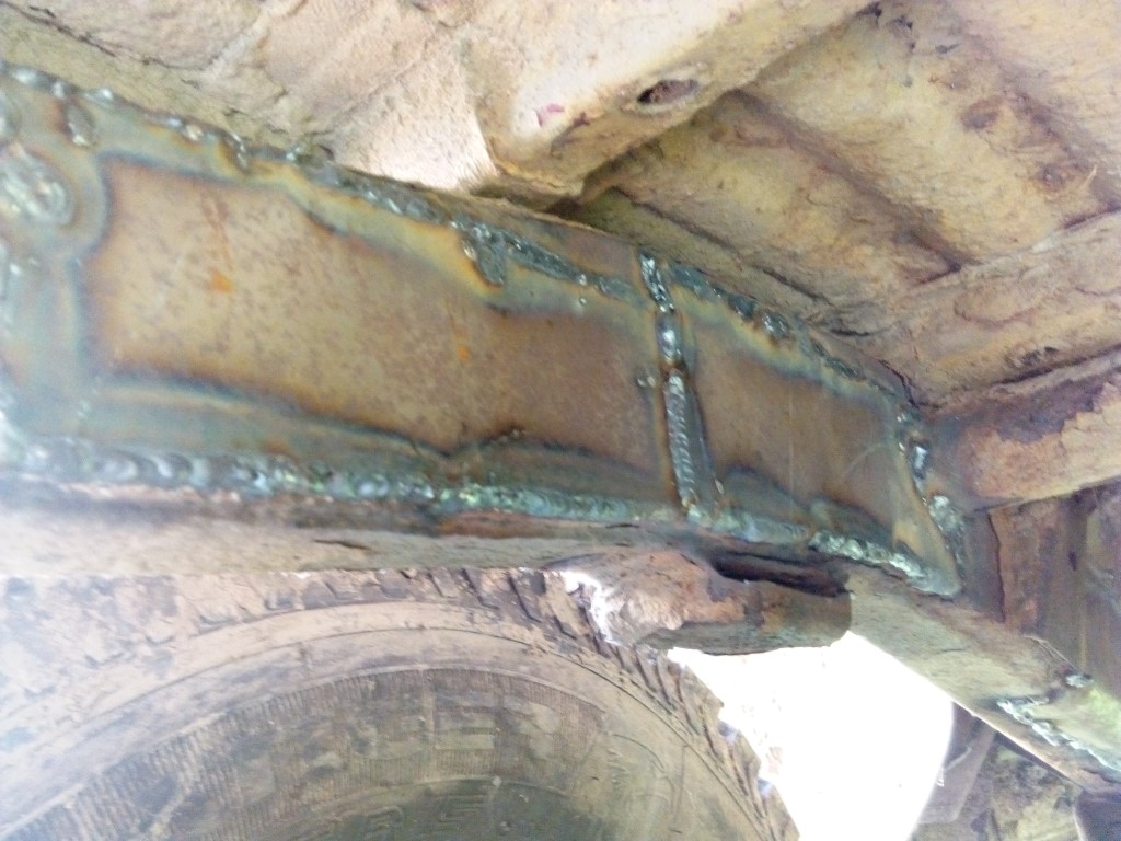

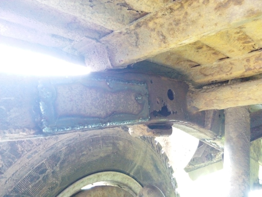

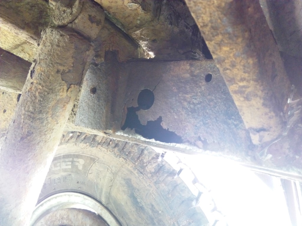

Typical chassis rot....

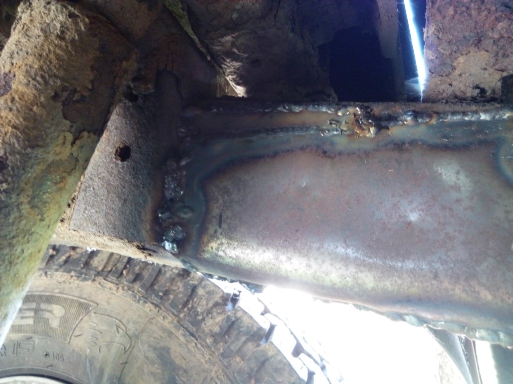

Patches on the patches....
The other side will get done tomorrow and that should be the back end solid enough. The front seems ok-ish. Rot isnt a major problem for the CT here so long as the axle isnt hanging off or something so I reckon this should be ok.

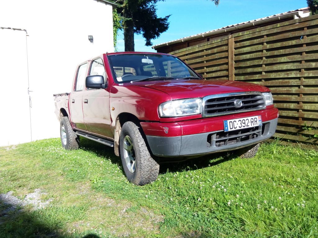

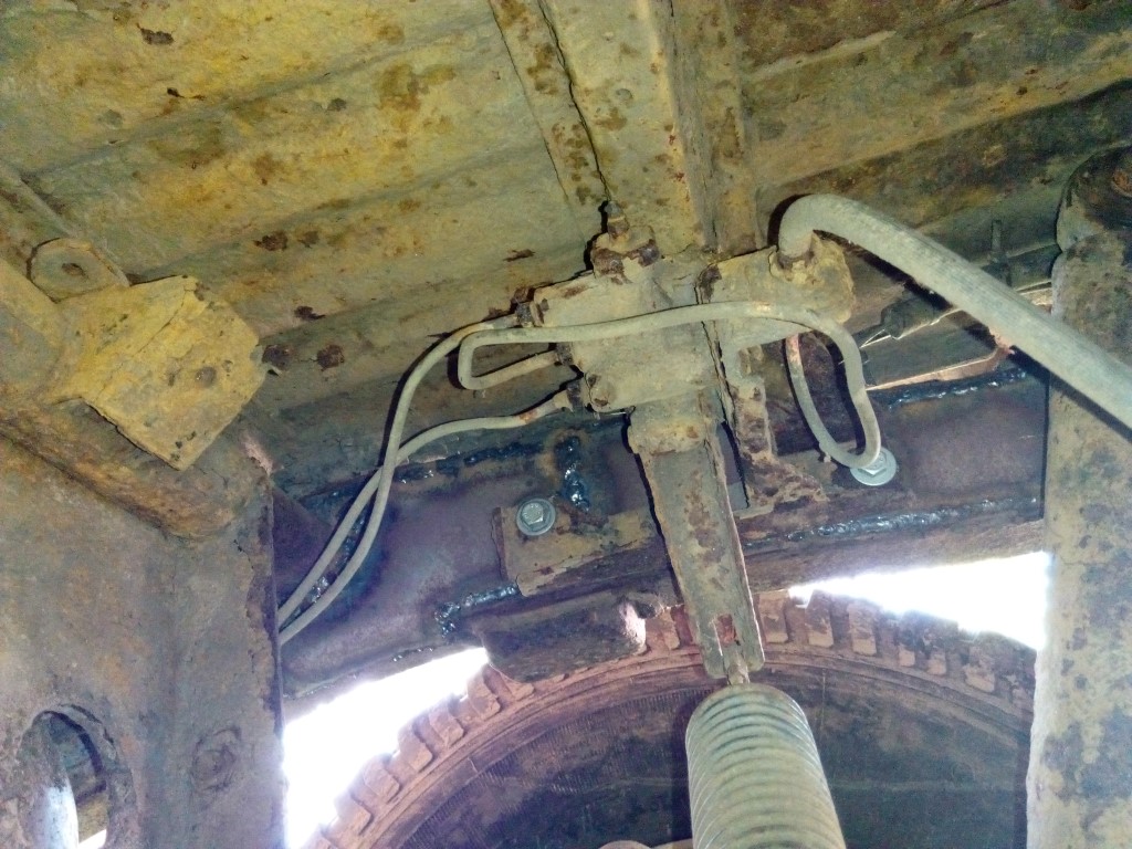

Lovely day today so I finished the welding. Much the same as the other side, but with the brake compensator valve in the way. With it off and dangling by its pipes I welded in two long patches, then drilled holes, sunk in and welded a couple of M8 nuts to take new bolts to refix the valve.
The valve is seized solid in the unladen position...not sure if thats a fail or not here. I thought about trying to free it off but the bleed nipples look fucked so I decided to leave it as is or I will never be able to bleed the rear end afterwards.
Its battery is dead so I took the second battery from the Freelander and fitted that. It starts up and runs really nicely and sounds a fair bit quieter now that it has a functioning exhaust.
Gave it a wash and hoover out and thats it for now. I couldnt be assed spraying oil today so will leave that till later. I will insure it tomorrow morning and give it a run, then CT test later in the week, depending on work commitments.
