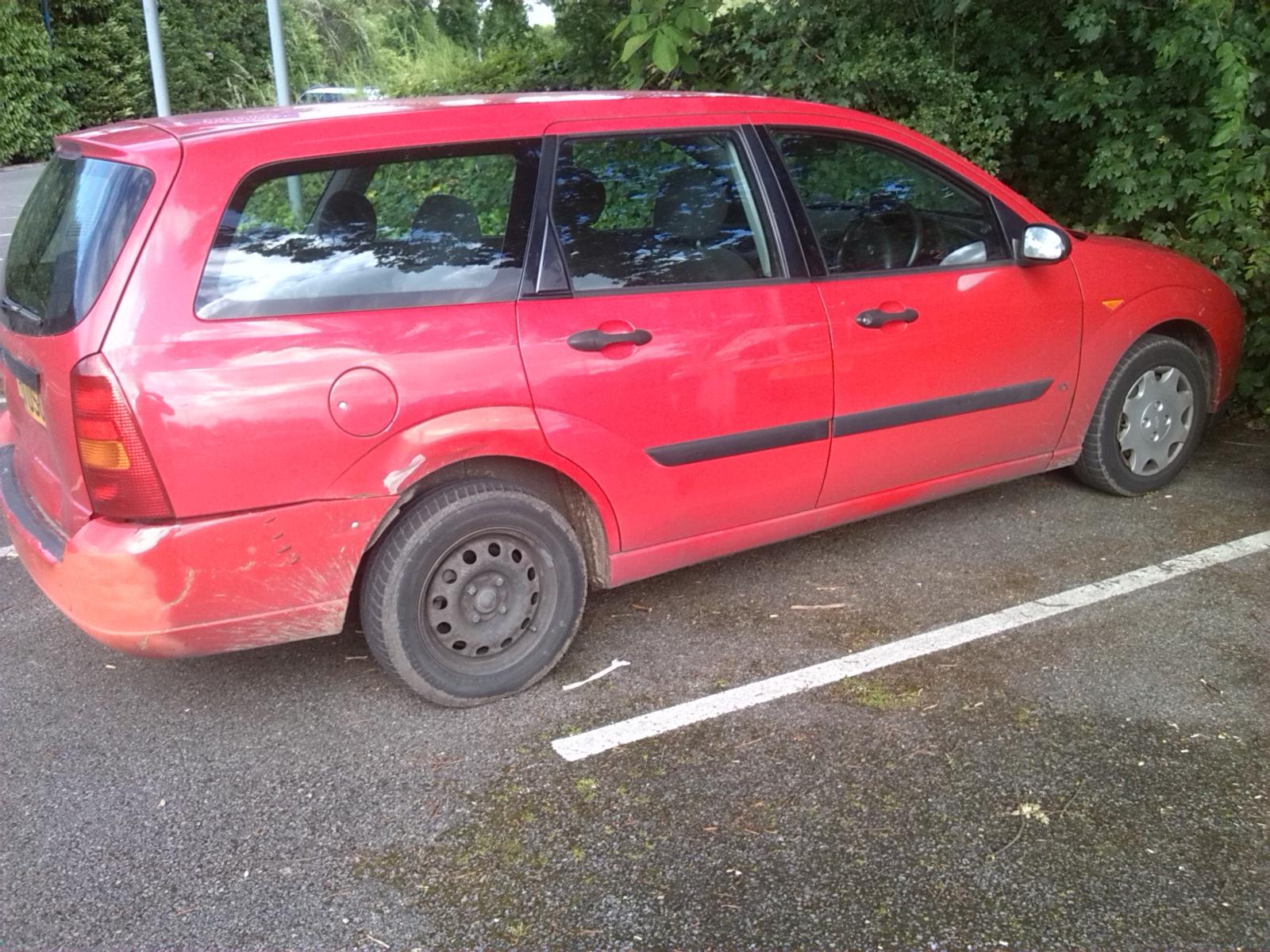

Basically thinking about getting the wife's Focus converted to LPG.
Cars in really good nick so not worried about getting money back.
Anyone got any knowledge re the what system is best and a rough price of install.
Cheers
