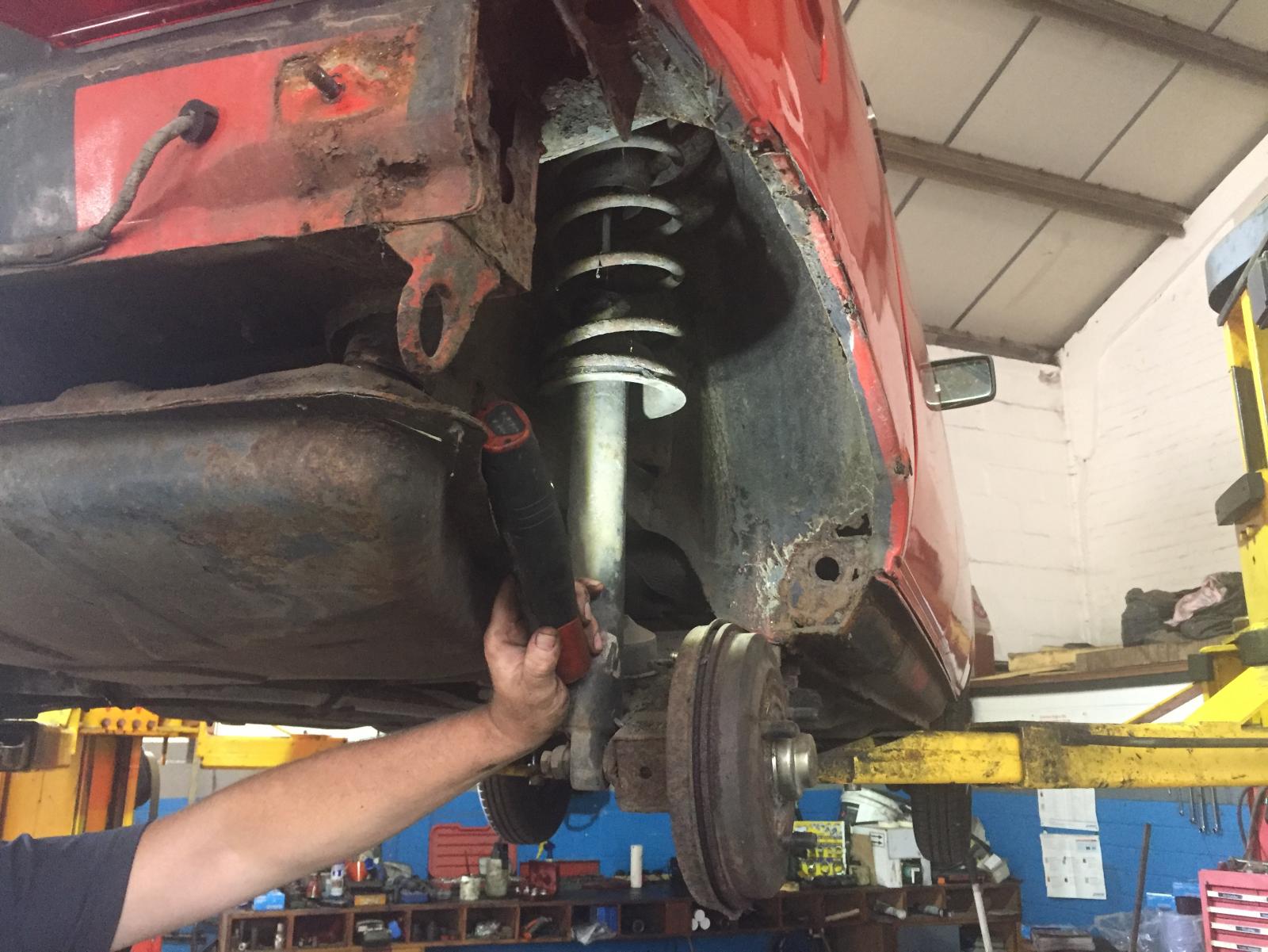

JohnDeere Posted June 21, 2017 Author Posted June 21, 2017 All is not well in Citroen Visa land. MoT man has found rather too much flaky stuff (the first one on the list is the main problem)... Reason(s) for failureOffside Rear Suspension component mounting prescribed area is excessively corroded INNER WHEEL ARCH/SILL (2.4.A.3)Offside Rear rear brake binding (3.7.B.1)Nearside Front Headlamp not working on dipped beam (1.7.5a)Offside Front Front position lamp(s) adversely affected by the operation of another lamp (1.1.A.3f)Advisory notice item(s)Nearside Front Body has slight corrosion FLOOR (6.1.B.2)Nearside Rear Body has slight corrosion BUMPER MOUNT (6.1.B.2)Offside Rear Body has slight corrosion BUMPER MOUNT (6.1.B.2)Nearside Front Body has slight corrosion OUTER SILL (6.1.B.2) It needs the inner and outer sill fixing, along with re-fabbing most of both rear arches. That's on top of needing a replacement clutch, speedo sorting, and rusted brackets not holding on the rear bumper. Much as I love this car, I'm thinking about the options... (1) pay for a decent repair. Likely to be £500-1k. No point in bodging just for the MoT, and it's completely beyond my skills.(2) find a loving new owner who has the time and skills to do the work(3) hide it away somewhere and come back to it another day So tentatively I'm open to any interest here (and I'll try another couple of forums). Barrett has first refusal (I sent him a PM). Any other options/ideas/volunteers to do the work welcome too!
Six-cylinder Posted June 21, 2017 Posted June 21, 2017 That is sad to see, my Visa GT has the same sort of problems and while I thought I thought I had found a welder we are not moving forward at the moment or I might have been interested. JohnDeere 1
JohnDeere Posted June 21, 2017 Author Posted June 21, 2017 When I pick it up tomorrow, I'm going to take it to a place in Wisbech that someone (owner of an MG BGT from new!) recommended for bodywork and restos. We'll see what they say... I don't want to part with it if I can fix it, but don't want to leave it festering if I can't get it sorted for sensible-ish money.
