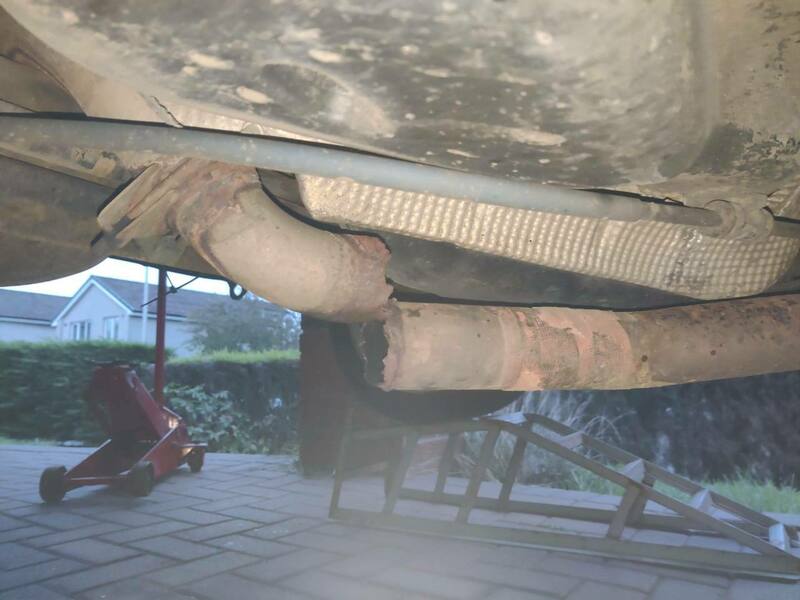

On my way up to cycling on Tuesday night I heard a blow from the Kangoo exhaust-not the first time as i made the exhaust from a bog standard Clio 172 exhaust with some extra bits added to make it work on the Kangoo(the tailpipe exits on the opposite sit on the Kangoo to the Clio)
I stuck my head underneath, noted the location of the leak and thought "Nae bother, I'll pop in to Halfords on my way back from work and grab a bandage for that."
However, on the way to work yesterday the blow seemed louder. As the weather was shite I ignored it and headed straight to Halfords and then popped my head underneath.
We're going to need a bigger bandage...
And the Land Rover connection? This section was added to the new 172 exhaust I bought in order to get the tailpipe to the correct side. It came from the Freelander which started this very thread! As you can see the pipe has had repairs in the past but this time it failed completely at a welded (from the factory) section.
Anyway, temporary* fix applied.
And she's quiet(er) again.

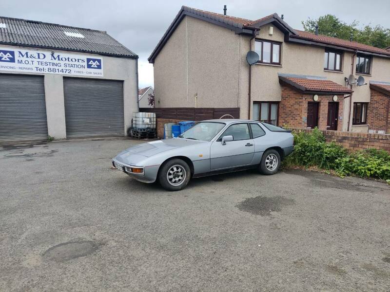

So, the 924 is off to it's new home with a shiter last week. I'll let them introduce themselves in due course.
The space on the drive was needed for a company van for a new job I start tomorrow, so naturally last night I picked up another car.
The poor lad had advertised it for scrap money and wasn't prepared for the sheer fuckwittery of Gumtree users.
Luckily i was on hand to be his knight in shining armour who could string a sentence together, arrive at the arranged time and put a deposit down while he waited for his new car to arrive.  Fast forward to last night and I picked it up.
It seems solid underneath from a prod and the back axle looks intact. The exhaust flexi is fucked so I've ordered one of those up and will stick it in for an MOT when I get a chance-the Rangey and MR2 are both due soon too. Ideal just as the clocks go back...

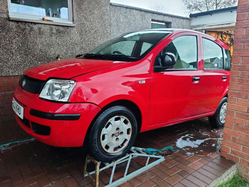

Ok, time for an update.
I got a look at the Panda for the first time in daylight last weekend so set about repairing the exhaust flexi and seeing if I could get the manifold bolts to come out so I could replace the porous sump.
Manifold heat shield off with only one sheared bolt.
Knowing that would come off but not having actually ordered a sump I left that and set about fitting the new flexi I'd bought.
Old one off, not in the best of health.

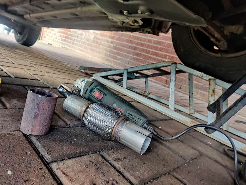

"Guaranteed to fit the oe exhaust " it said in the listing. Guess I don't have the or exhaust then. It wasn't going to fit without some careful craftsmanship*
Spare bit of exhaust chopped up to make a sleeve
And together.
It's assembled dry for now as it'll need to come back off when I do the sump, I also need to buy the correct clamp for it as it was scraping on the speed bumps cos I'd used one far too big🙈

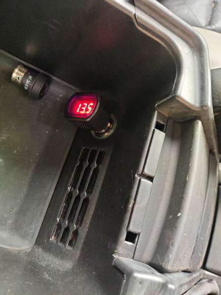

The Rangey was clearly feeling left out-after 100 miles last Saturday I went to take the dog out for a walk somewhere away from the local fireworks only to be greeted with every single warning light illuminated on the dash. Joy.
I limped it home and took the Kangoo instead.
Once the mutt was exercised i had a look at it. The battery light was also on so I started by plugging in my little cigarette socket voltmeter. Fired it up and the volts sat at 12-14 as you'd expect. However, a gentle rev would see them climb to 18v and connect 4 was achieved in the dash. Alternator it is then.
Water cooled too on this thing for maximum lols.

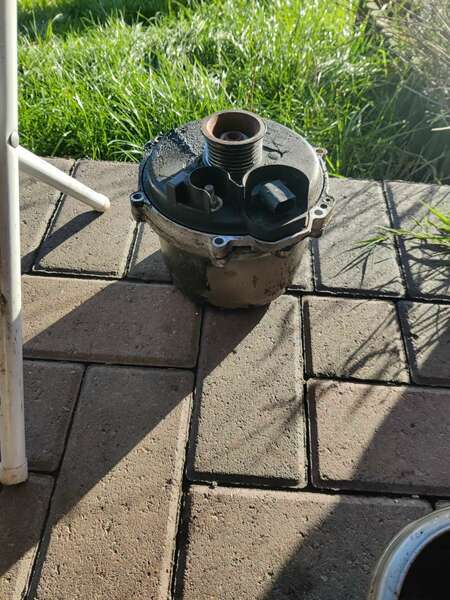

Next morning I had to start the day by jumping the Rangey as the fucked alternator had drained the battery. Panda power to the rescue...IMG_20221106_104944.thumb.jpg.f595873e3cf315d3e4fb4613e7530844.jpg
Viscous fan and coupling off and the target was revealed IMG_20221106_130034.thumb.jpg.c08b2c8622df53b7d823fe4f121b364f.jpg
Once the coolant was drained and the belt and tensioner removed 6 bolts freed the alternator from the block.IMG_20221106_130423.thumb.jpg.1010c3db9c6f58af0098c1e4161a6d57.jpg
Now, this is where I made a booboo. I ordered up a rectifier which appeared pretty quickly. I stripped the old alternator down to fit the new rectifier.
Friday afternoon arrived and an early finish from work meant I could crack on. Alternator back together and fitted back into the car. I decided to fire it up before adding coolant just to be sure.
Good job as it was still overcharging 😭
So, what I learned on Friday was that the rectifier  converts the AC voltage generated by the alternator to DC. Its the voltage regulator  (highlighted below) that maintains it at the 13-14v needed to run the electrics
And lo, there was swearing.

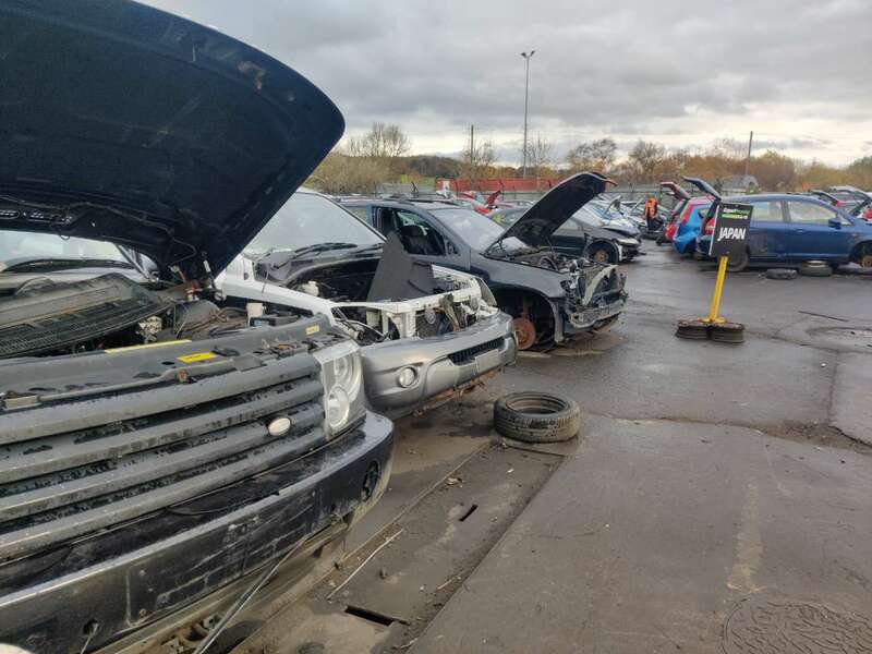

However, not to be defeated I set off for the local scrappy on Saturday morning and found a 4.4 Rangey and X5, both of which liberated regulators.
Back out, stripped down and back together and, finally, the correct voltage.
Thank fuck for that!
Oh, and inb4 the OmGaLlLaNdRoVeRsBrEaK brigade, its a BMW part!

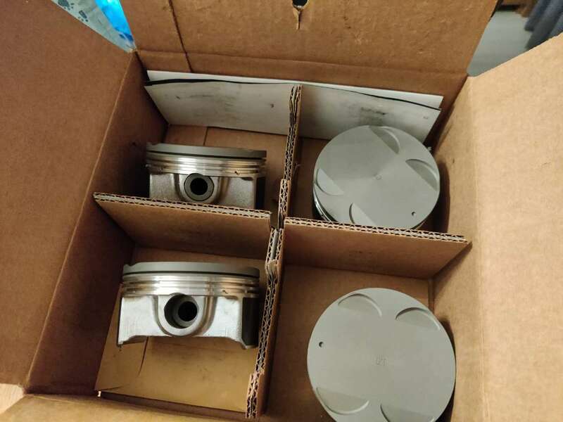

This should give the Manta 200bhp at the wheels which with it weighing around a tonne will make it go fast enough for me🙂
  • dome changed the title to Domes shonky auto-Panda Problems

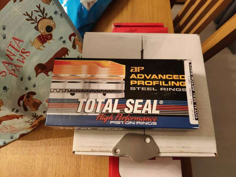

Shiny Manta things have arrived!
I get to learn the art of piston ring filing. Bet that's fun😳

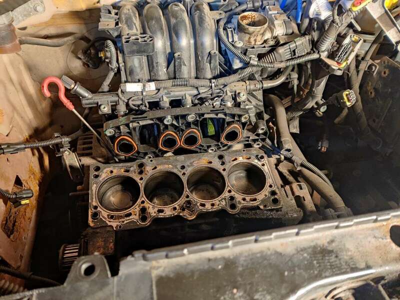

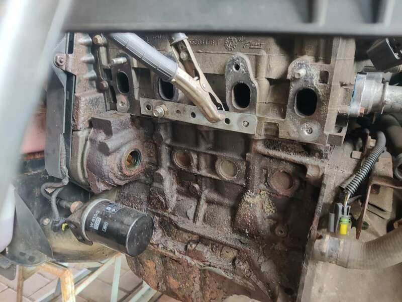

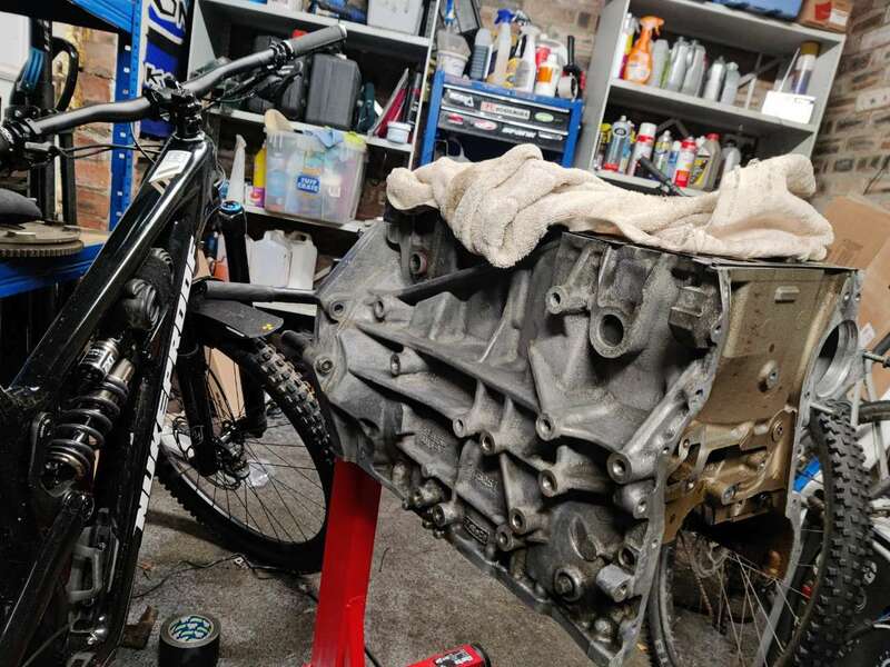

Pulled the head off it tonight. Bit of an arse of a job but not as bad as a Clio 172.
Don't you love it when the tools are worth more than the car?
Heed aff
Heed on (bench)
I've got a head set with valve stem oil seals, figured I might as well change them on this as practice for the Mantas head.
Manta Duratec block cleaned up and sprayed with hight temp aluminium paint-should last longer than trying to polish up the block.
I'll give it another couple of coats and then can move on to the rebuild - I picked up new crank and big end bearings yesterday

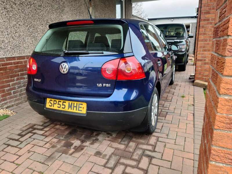

It's a 55 plate VW Golf 1.6 FSI SE. My mate was the second owner having had it for 8 years. I have the original bill of sale for the first owner who was  70 years old when she picked it up. Not often I can say I'm the youngest person that's owned a car...
The drivers front wing is rough as the rear right hand door. Fortunately these bits both bolt on(door skins are removable on these) so I'll keep my eyes out for one breaking in the correct colour.

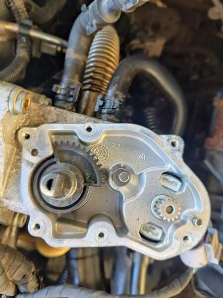

Naturally, being a VAG car it had the usual

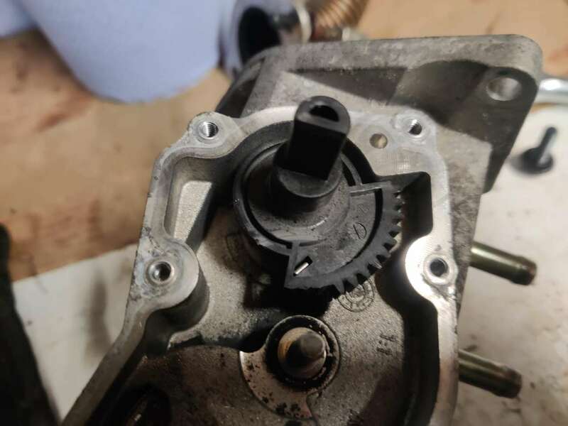

A quick poke with Carista confirmed the code was for the EGR valve. I pulled it off but it was clean so i wasn't sure why it was giving a code until I removed the top plastic cover.
There should be teeth all the way round that big cog-the vale must have been sticking and repeated attempts to open it had stripped the teeth.
Now I'm no fan of EGRs but I'm even less of a fan of persistent EMLs which means I might miss another problem.
A trip to the local scrappies revealed a solution.
That one looks a bit better...

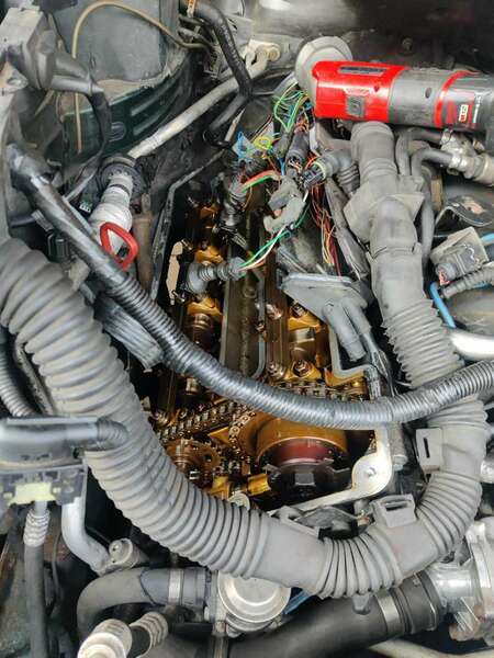

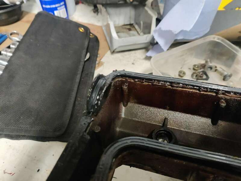

So the Rangey and Kangoo both had burning oil smells around them which was annoying me. When the Panda went I spent some time on these as they'd both been neglected.
I knew the Rangey needed a rocker cover gasket-I'd changed the first one over a year ago but it was such an arse of a job that I'd ignored the other one.
With the rocker cover off you can see the clearance you have
Yeah, that's tight. The design of the gasket means you can't use zip ties to hold it in place so it locates correctly for added fun*
The old one had been there a while and also been professionally fitted. Did I work on this before?
To be fair I worked out the best way to fit the new one was a thin bead of sealant around the rocker cover then put the new gasket on and leave it to dry. This meant it couldn't move as I maneuvered it into place. In theory. So maybe the last person that was in here wasn't that daft. The gasket was old and cracked so had been there a long time. This technique did work so fitting the new gasket was a lot easier than the other side had been
It seemed sorted for the next few hundred miles but the oil smell returned-a feel of the gasket revealed it was leaking again and wasn't seated properly on one corner. I undid the bolts and managed to get it back into place, we'll see how long that lasts...

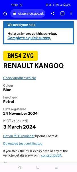

  • dome changed the title to Domes shonky autos-Kangoo Exhaust and MOT, Rangey suspension troubles
The Kangoo exhaust has finally been fixed. I really, really wish I'd done this sooner. My standard 172 exhaust never really sealed properly and knocked off the axle most of the time, although a days drag racing at Crail did actually cure this til the bit of Freelander system I'd used to make it fit gave up completely at the back end of last year..
Shout out to Reaper Exhausts in Kirkcaldy, a fellow Clio botherer. He did a cracking job of fitting the biggest boxes he could under the van and dealt with the super tight clearance between the lowered beam and the floor. Of course I had to keep the standard looking downturned tip for the stealth look.
Not much to see from the back.
But if I reverse over you your last view will be of a very well made exhaust.
Suitably buoyed by this I stuck it in for an MOT yesterday and prepared it by giving it a wash. Be fine, right?

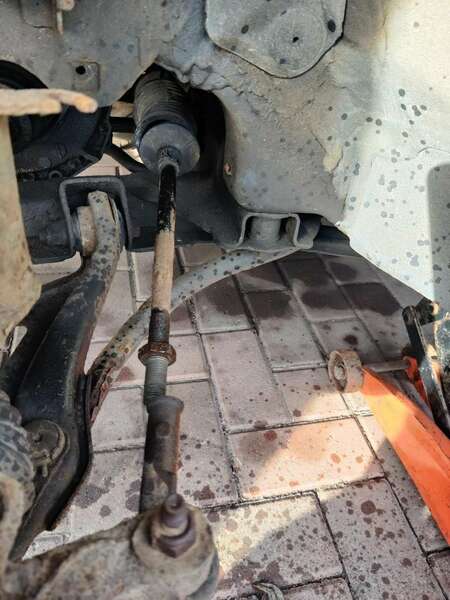

I picked up a gaiter kit and then collected the van.

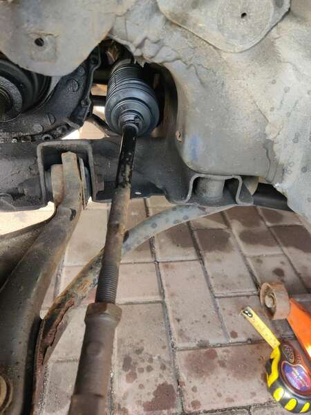

Aye, that's pumped. Should probably have fixed that after it was advised last year
Track rod split, thankfully I'd replaced both inner and outer since I bought this so it came apart easily.
New boot on and back together
And 25 minutes after picking it up it was back round for a retest.
Screenshot_2023-02-17-15-08-36-60_40deb401b9ffe8e1df2f1cc5ba480b12.thumb.jpg.2727e2988b50f57ef718f39d1643f20f.jpg
Sweet!

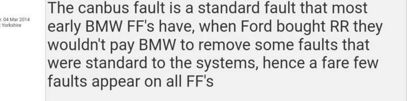

OK, rear height sensors then. But what's this about Canbus error? I googled the shit out of it until I found this interesting post on FFRR.com-a great resource for these things.
Interesting. Lets have a look at the old height sensors then.

I reconnected the battery and fired it up, expecting to have to calibrate the suspension. However it sorted itself out and seemed to respond to requests to change ride height quicker.  Another 10 mile test drive and it behaved perfectly and the time taken to change from normal to motorway and back seems quicker. Result!
