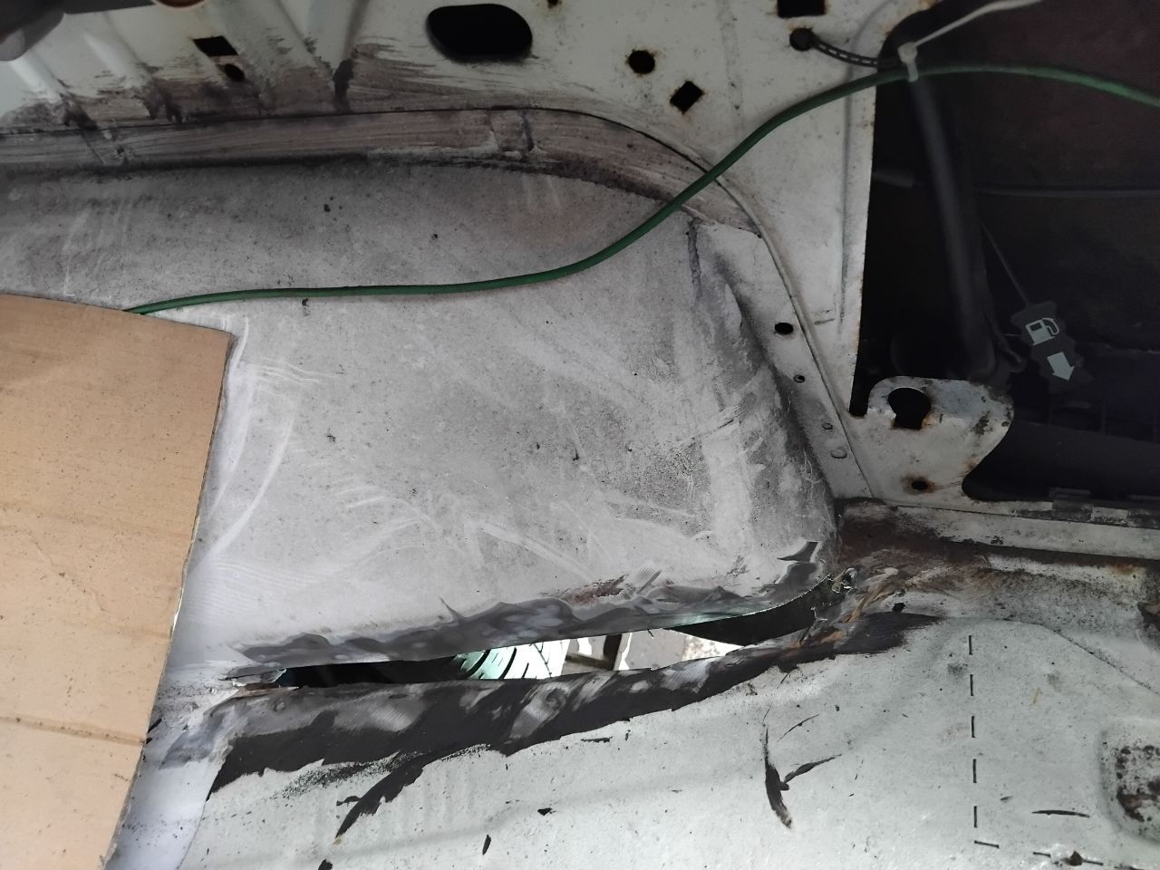

Thought I'd better get on with it. Passenger side done. Funny rust on transmission tunnel-thought a hole would appear-but its double skinned and the outer skin has gone. Drivers side about third of the passenger side to weld.

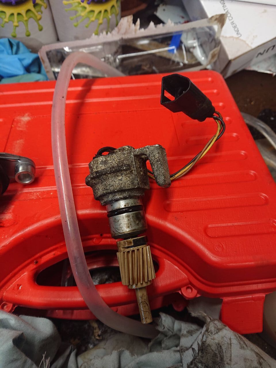

Sierra has been fine over the last few years until this week.  Top gear is failing to engage on the auto box.
Some suggest a wiring problem, speed sensor or vacuum leak.  Ive checked the wiring-a bit iffy but difficult to change. Have a new speed sensor so will try changing this first.

Speed sensor wenr on our granada.
Trip computer went on the fritz and no fourth gear. Back in the day I had to get one from Ford stealer.

Thanks Bren
No trip computer- but will have a go changing the speed sensor.

Update. Took the speed sensor out and it would only turn with a bit of resistance one way-other way was totally free. Took it apart and theres a 2mm square serrated shaft that joins the splined end to the gubbins inside.  Pulled it out and pushed it back in a bit harder. Put it back in and it now works. Thought I'd get another but they are as rare as rocking horse poo. If it breaks again I'll put a bit of epoxy on the end.

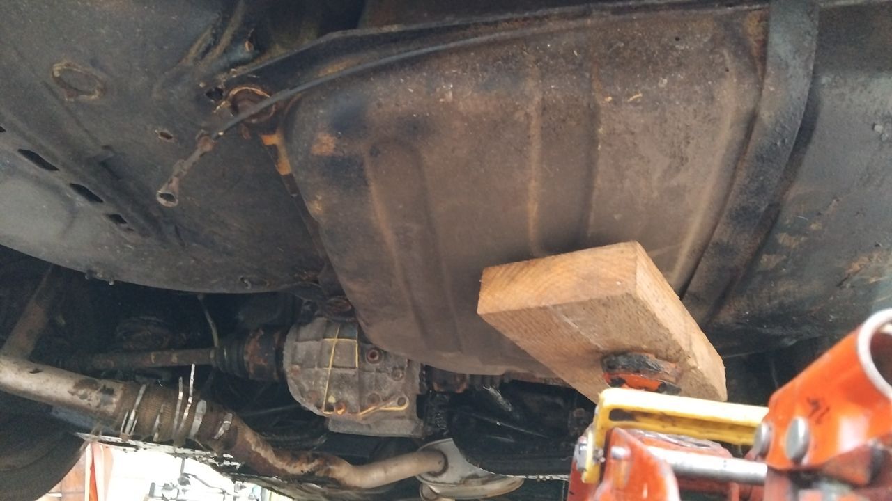

Sierra hasn't been used that much in the last few months. Booked it in for an MOT but cancelled it as I poked a suspiciously rusty part of the fuel tank which resulted in a slight (!) leak!
Have had a good spare for 4 years but never got around to fixing it.
I put some sealer until it gets warmer which seems to have worked.

Did the tank on my dad's Sapphire, think it's fairly straightforward other than getting the filler tube connected back on
MK2 son has swapped his a number of times, his started life as a 1.8 cvh, currently has a carb'd 2.9 V6, he swaps between an injection tank and a standard one, takes him about half an hour now

Decided to change the tank on this. Had to saw two bolts off. The tank was a tad rusty!! No wonder it was leaking!!
I'll put a bit of wax underneath befire I fit the newer one.

Changing the tank revealed a bit more rust. More welding.
