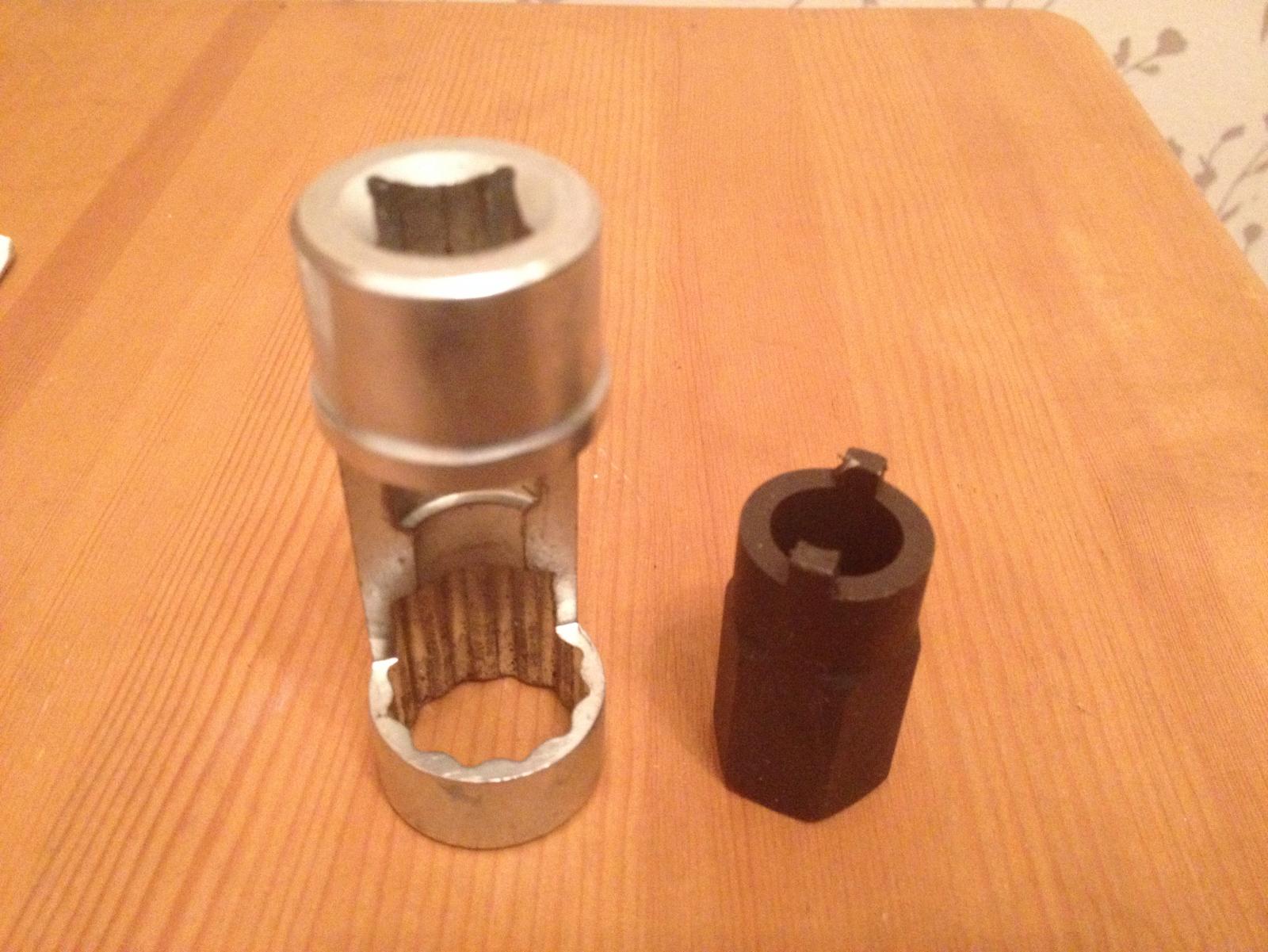

trigger Posted March 29, 2016 Author Posted March 29, 2016 I could actually do with some advice on this, my mates offered me a pair of brand new front shocks for it that he bought for his late 2.6 Coupe before it blew up, a look on Google says the part number is the same but Coupes have gas shocks were as mine are oil standard or gas as a upgrade. Now depending that they do definitely fit can I mix gas front shocks with the oil rear ones or would I have to change them all. Also do i need a special socket to undo the strut top mount nut?. Thanks.
Hiram K Hackenbacker Posted March 29, 2016 Posted March 29, 2016 Have always replaced like with like on mine, but in answer to your third question you need 2 "special tools" VAG3078 - 22mm slotted socketVW524 - slotted nut removal tool. Easily obtainable on ebay. The top nut comes off like this: The slotted nut lives underneath - do not undo until you have your spring compressors on! trigger 1
Bstardchild Posted March 29, 2016 Posted March 29, 2016 I'm to tight to buy one of them (actually I never knew they existed) so my 22mm deep socket has Stilson Jaw marks on it (that way you can put an allen key down the unused rachet drive square billyboy406v6 1
trigger Posted March 29, 2016 Author Posted March 29, 2016 I've just bit the bullet and ordered them both of eBay. I got a 22mm lambda socket instead, thats another £15 the car owes me!
