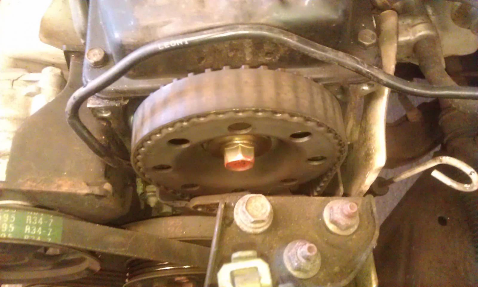

So this is my first peek at the cambelt;
It was so slack it could almost be removed without slackening the tensioner off. Notice also I have removed the engine mount & PAS pump to allow for access, I also had to remove the PAS mounting bracket to get at and replace the leaking water pump.

Important pics for Nyphur; the autodata book isn't very helpful with the timing marks, but the pin sticking out of the crankshaft sprocket here should line up with the arrow cast into the block:
And at the camshaft end, the arrow on the cam sprocket points to the casting on the head (I used a mirror to check this, it doesn't look right unless you look straight at it!)
