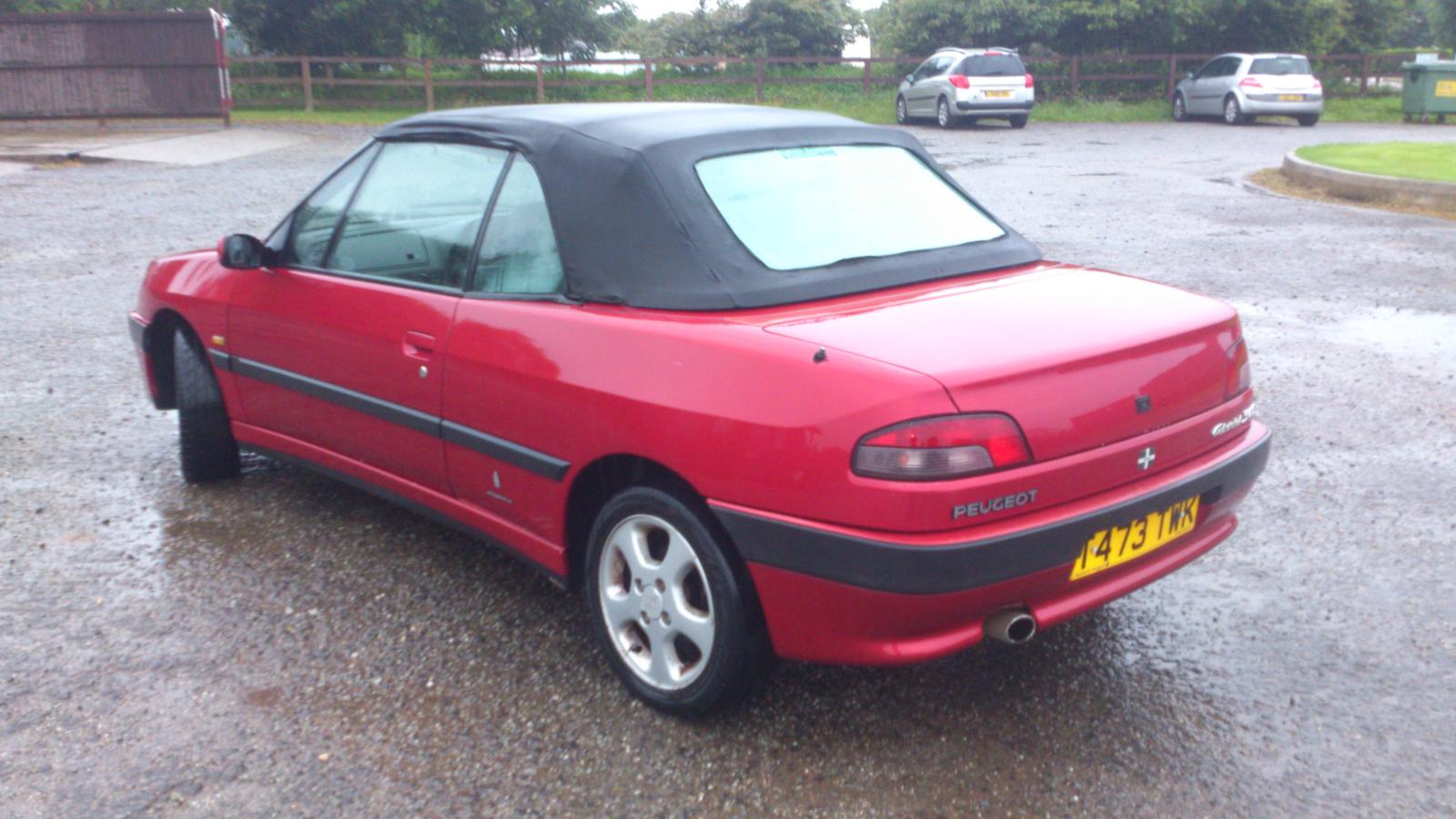

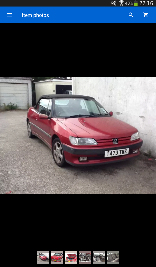

Oh dear, my right index finger just bought this, I'll be having a word with it later...
Cheap, recently expired MOT and not retested. Very clean history.
I don't need it, got enough damn cars! But...
Its a ragtop - and its nearly Summer.
Excellent choice.
Yep, top buyage there, it's like a mini lottery, it could sweep through an MOT without a hint of trouble, or it could make you cry!
Sent from my SM-G903F using Tapatalk
First inspection, needs rear pads, slight exhaust blow sorted and set of tyres.
Electrics are possessed, so roof and windows are DOA.
Other than that, seems Ok, certainly drives willingly with no knocks.
Nice pic oflovely convertible on a rainy day, possessed electrics fail in up position ( clever demons ).
