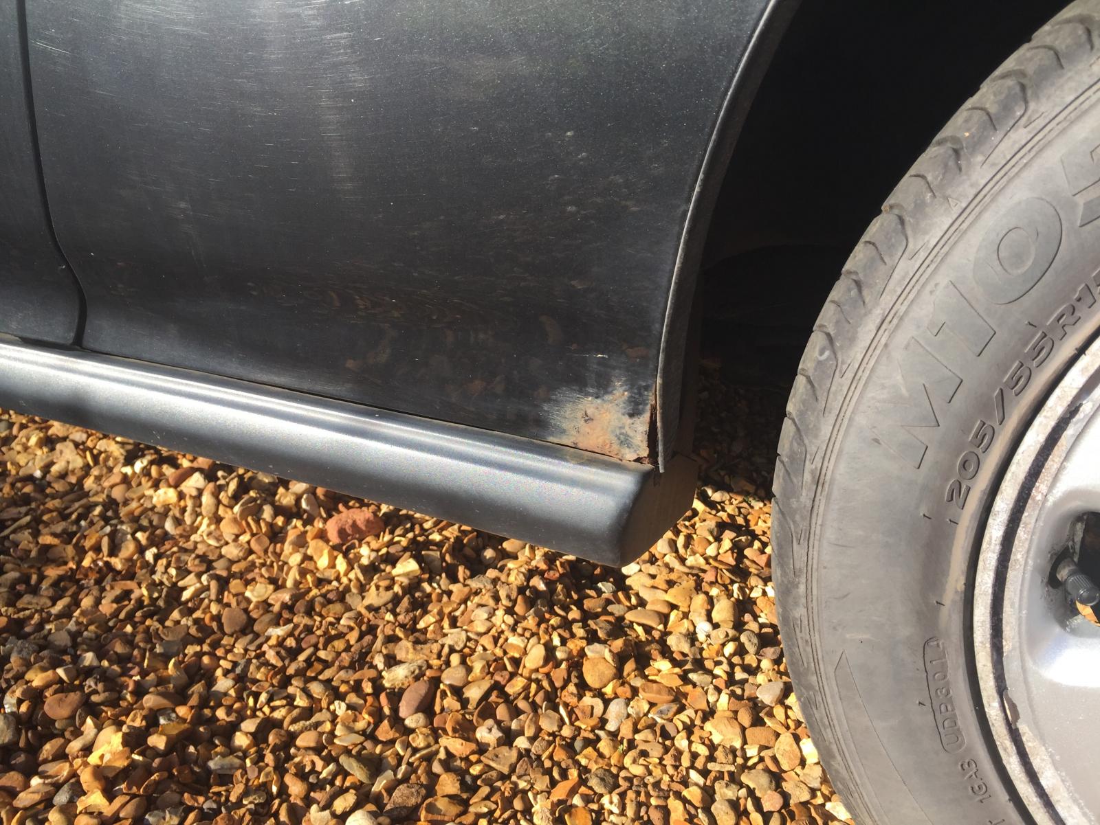

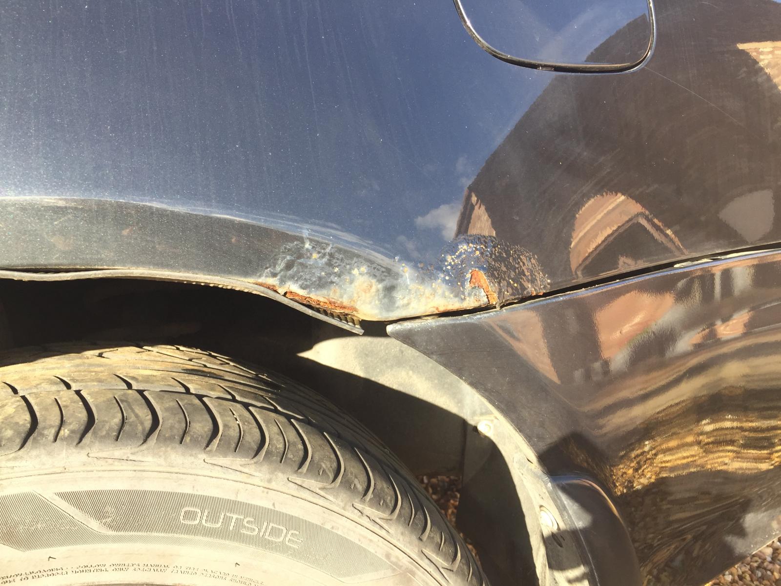

The Prelude was washed for the first time today. I keep trying to ignore the rusty bits, but it's getting harder to pretend that it's not dissolving away. And has got worse in the six months I've had it.
So what's the best way to deal with these (pics show the worst bits)...
( a ) temporarily to stop it getting worse for a bit
( b ) permanently (realising that will need welding and £££ ... but I need a good recommendation of someone with the skills to do it well)
I'd like this to be a keeper because I like it, mechanically it's sweet (well, except for the gearbox), and it's very usable daily.

I used to use a chap called Tony Coles in Somersham for cheap, nicely done repairs. Not that he ever did outer bodywork for me, but he's the sort who can make a patch invisible. If he's still trading. Next door to TRGB.
Even a £300 heap I would weld rather than just fill.
Even a £300 £350 heap I would weld rather than just fill.
8)
TS
Thanks ... will whizz by there and have a look. Completely agree with Bren that a proper welding is much better plan - I'll have another look for replacement sections.   The back window needs to come out too to do the corners of the wings which are going at the bottom corners of the screen.    Or, I go the cheating way ... flapwheel + Hydrate 80 + filler + rattle can + ignore it for another 18 months.
If I find someone good though, they can sort the crusty arches on the Visa too.
Problem with the flapwheel is that it'll probably take a small bubble and turn it into a ruddy great hole. Is tricky to know the best course of action when values are so low. That said, look at earlier Preludes and prices have been rising pretty strongly. You'd struggle to get any of the previous generations in decent nick for under a grand now. Really nice fourth-gens are starting to appreciate, but it's still early days.
That will need cut out and a new arch welded in i would guess. As a cheap fix cover in waxoil to try and slow it down.
Probably just my luck.  Would prefer going for the "proper" option - given the very reasonable £17 purchase price there's plenty of value in the car to make it worthwhile.
That had crossed my mind, though seems like luck of the draw - and the auto/non-VTEC probably won't be top of the list. So main factor is that I like it and it works, so worth spending a few quid on if it buys another few years.
And all a lot easier if I can get repair sections - but tricky because they all go in the same place. Otherwise I need to find someone who's handy with making curvy bits of metal (and hence more £££).  If I CBA doing it right away, I'll definitely shove in some waxoil to keep it going.
Someone of the Prelude forum is knocking out lower-half replacement sections in zinc-protected metal at £250/pair.  PM'd him to see if they have any left.  Makes the whole job a bit steep though - I don't think a rear arch repair is the place for me to learn DIY weld and paint skills from scratch, sadly.
I'd see if the Crown can do it, the bodywork they have done for us has been at a high standard.

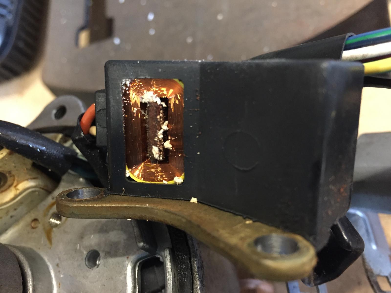

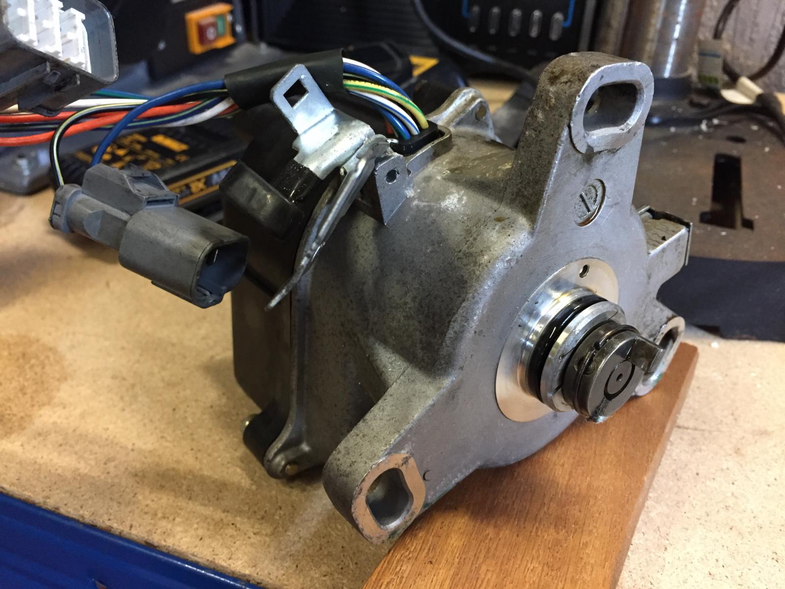

Popped the distributor off this afternoon. Well that's looking borked for a start - wonder which bit of the engine the missing bit is wedged in?

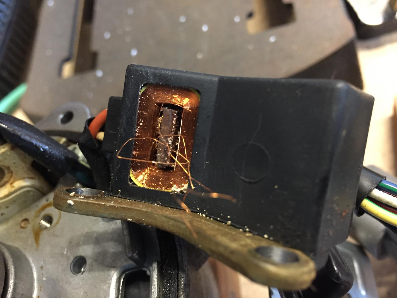

This sensor doesn't look so good either, covered in a mystery white gunge.
Looks even worse now I've tried to clean it - the very fine copper wires in the winding are having a bad hair day. Bugger.
I guess it's new distributor time. I have a choice of (a) random "compatible" made-in-China part from eBay; (b ) various used parts on eBay that look like they've come off a 250,000 mile Accord mini cab, (c ) perfect looking new-old stock and only £45. But from Americaland with lots of delivery and customs charges and general uncertainty that it might arrive.
It's a TD-58U distributor. Or maybe a TD-88U. They seem to be interchangeable and mine has no part number. Fairly common on 2-litre Hondas - Prelude, Accord and Rover 620s. If you happen to know of one in a scappy please let me know :-)
I've just remembered, I'm sure when I first bought this (and when I sold it) there was another dizzy in a box in the boot, so maybe this has happened before.
