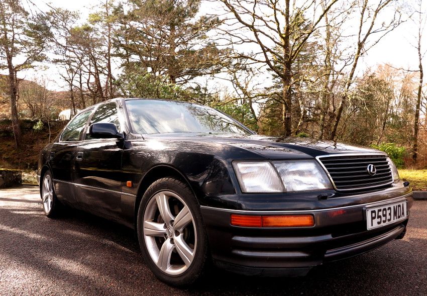

@Fotrabi: That one looks in great condition! Them wheels look to be off a mid 2000's Lexus, and personally think they'd suit mine well! :D
