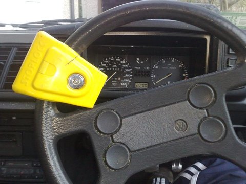

Fuck it's got one of those steering locks on it too  :-D hope that locks not fucked too, I'm going to give the barrel some welly and douse with lube, the probability of having the door key and ignition on separate rings is highly unlikely so i'm thinking barrel is dry/stuck as the car has sat for months since the owners sad demise
check there isn't half a key already in the barrel as they have a tendency to break...if not pointy chisel on the snap off bolts and iirc once barrel is off its just a screwdriver in the slot...
