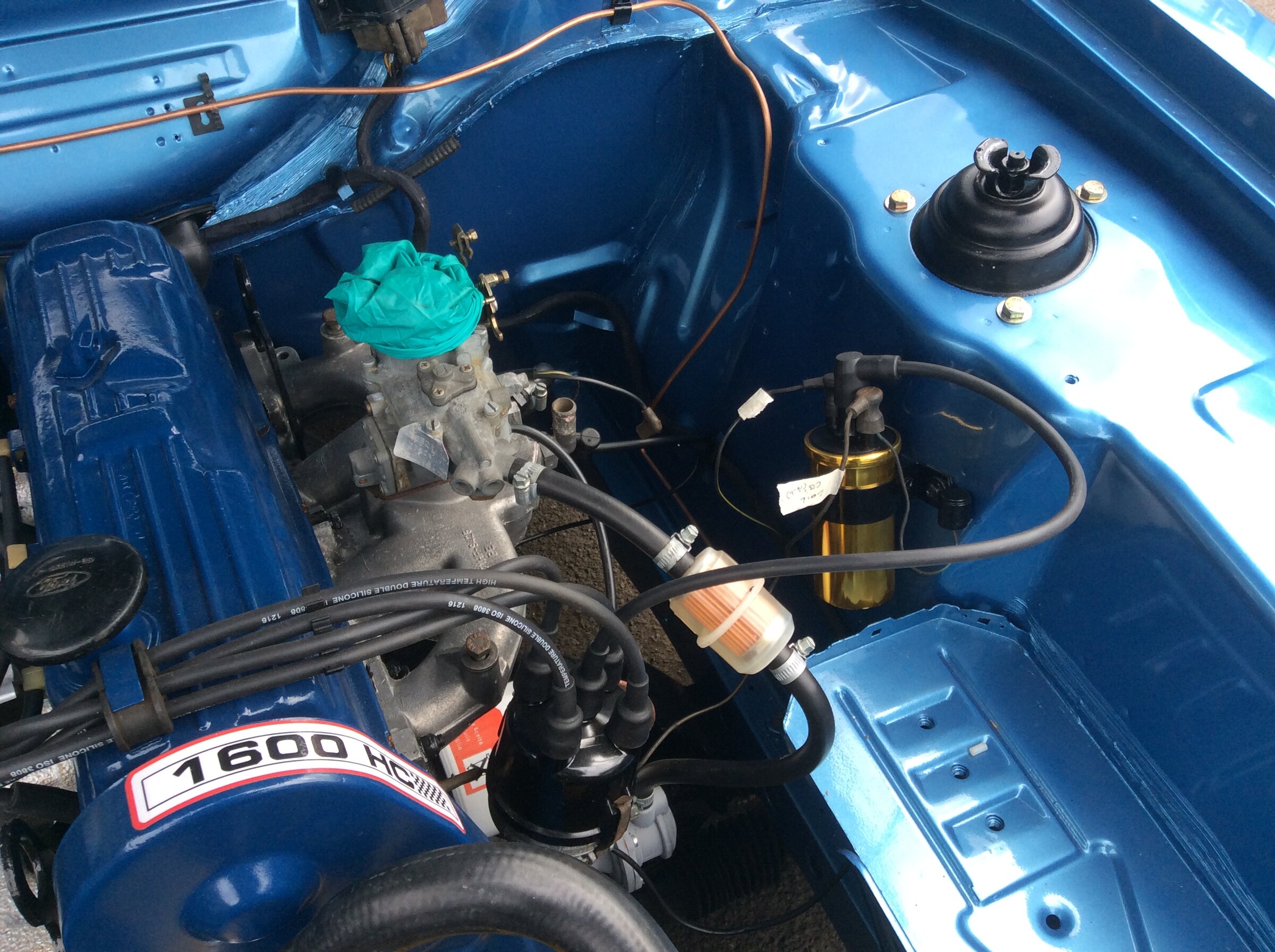

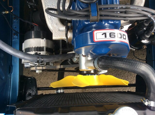

Did a few more little bits and bobs around the engine bay and got about as far as I can with that for now.
Ive fitted the suppressor thing. Had to take the coil bracket off and strip the paint off the back of it then very very carefully ground a small patch of the paint off the inner wing under where the bracket fits to provide a good clean earth point for the suppressor. I’ve given all surfaces here a thin smear of contact grease too just to stop corrosion starting. The suppressor is fitted to the LT wire from the coil to distributor, the little O ring connector just fits over the terminal on the coil then the LT wire pushes on over the top and secures the lot itself.
Next task, get the heater box fitted.
This proved to be a bit of an arse hole to do as it didn’t fit terribly well. Don’t know why as it’s the same one that came out and the surrounding panel work, mountings etc haven’t been altered. It was extremely tight trying to force the motor and it’s housing up through the hole for the air intake and at the same time get the two water outlets through the little oval hole in the bulkhead. Got there in the end though!
The bolts for the box didn’t appear to have any washers or anything so I’ve dug out some suitable washers and added spring washers too just to be sure it stays tight and won’t rattle.
Im not 100% sure putting this in now will be the best idea but my plan was to get it in and finished now while there’s such good access. We’ll soon see however as the next job in here will probably be the cabin wiring loom and I did notice there’s two of the loom retaining tangs under where the heater box sits but I’m fairly sure these ones are not used on this car. Fingers crossed!
The next task was to try to get the heater hoses installed in the engine bay which is where I ran into a slight problem. I’d bought a new seal kit for the heater box which includes a big foam O ring seal for around the air intake/motor, which fits great. It also includes a small oval foam seal for in the engine bay, which fits around the two heater matrix outlet pipe stubs. These are designed for the mk3 so are the wrong shape to fit and not leave a gap around part of the hole! I don’t think you can get early mk1/2 ones so I’ve had to make one from some old foam gasket left over from something else. Once that was done I’ve refitted the metal cover plate that holds the gasket in place and tightened it down. It certainly seems to be a very snug fit around the pipe stubs so it should do the job.
Once that was done I’ve put the hoses on and fitted the little clamp brackets too.

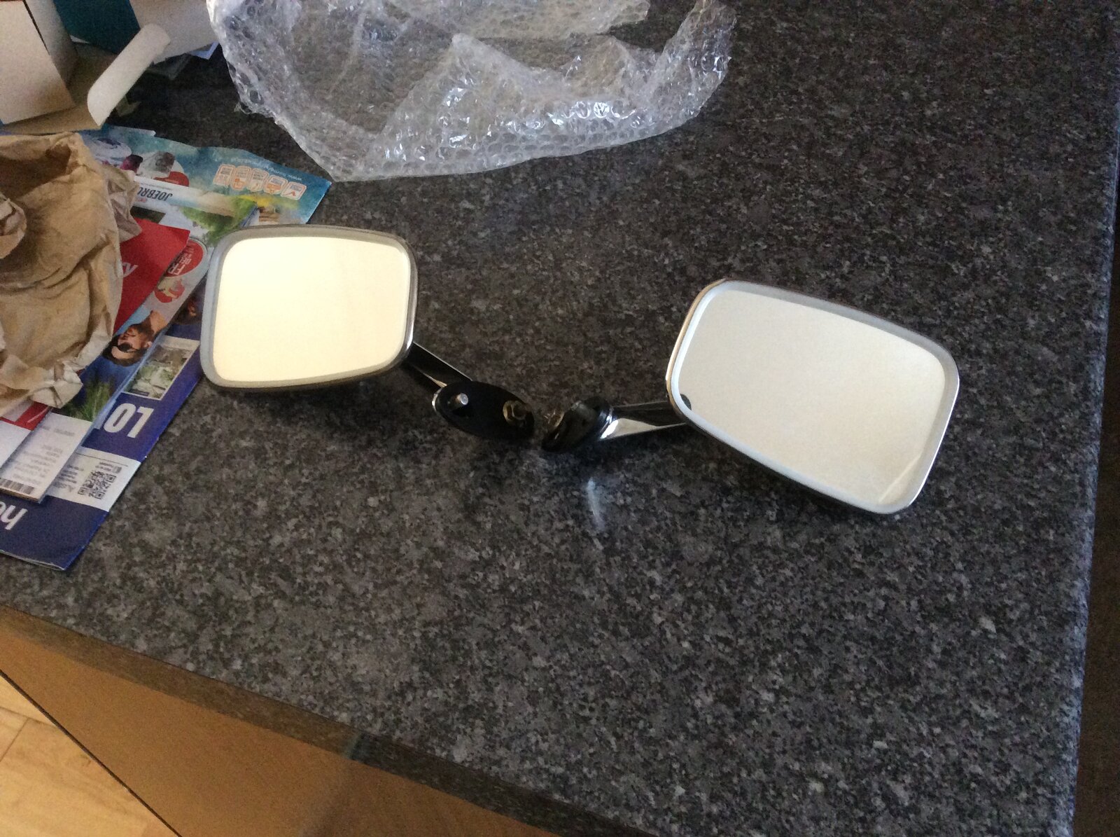

Lastly, I mentioned earlier in the thread about door mirrors.
This car being so early it should have a type of door mirror specific to the mk2’s from January - November 1974. They look similar to those fitted to late mk1’s but are slightly different. As you can imagine they’re not easy to find these days so most (mine included) end up having the later mk2/3 style mirrors fitted. I want the right ones because I’m an awkward fucker!!
Anyway, I thought I’d got this sorted last year but the supplier couldn’t get them anymore which killed that off. Then the other day I was browsing eBay and spotted one! It’s a new old stock part (left hand) and came from Germany.
It’s like new! The chrome is perfect! I think these are absolutely the right way to go for this car, I love these mirrors but getting a pair of these on should be another little period correct item that sets the car apart from others. And I ‘might’ have secured the other side mirror, also new old stock since that one arrived! So all being well I’ll be sorted for the mirrors soon.

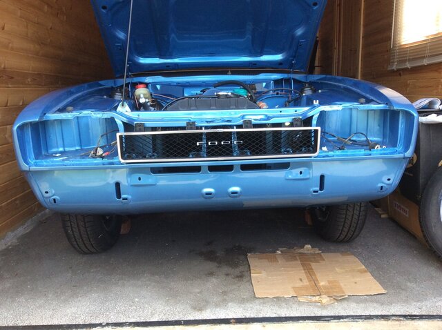

I got the front grill fixings (new) fitted earlier and decided to trial fit the grill. I know stuff like that is one of the things you’re meant to do last but I couldn’t help myself! It’s amazing how you can add something like that and all of a sudden it looks like what it’s supposed to be!
The grill of course is filthy and in desperate need of a thorough clean up but it still looked great.

Next job was definitely not needed yet, but I wanted to do it just to see what it looks like!
The grill!! It’s the one that came off the car but I’ve cleaned it up and put some trim shine on it. All the clips and screws are new.

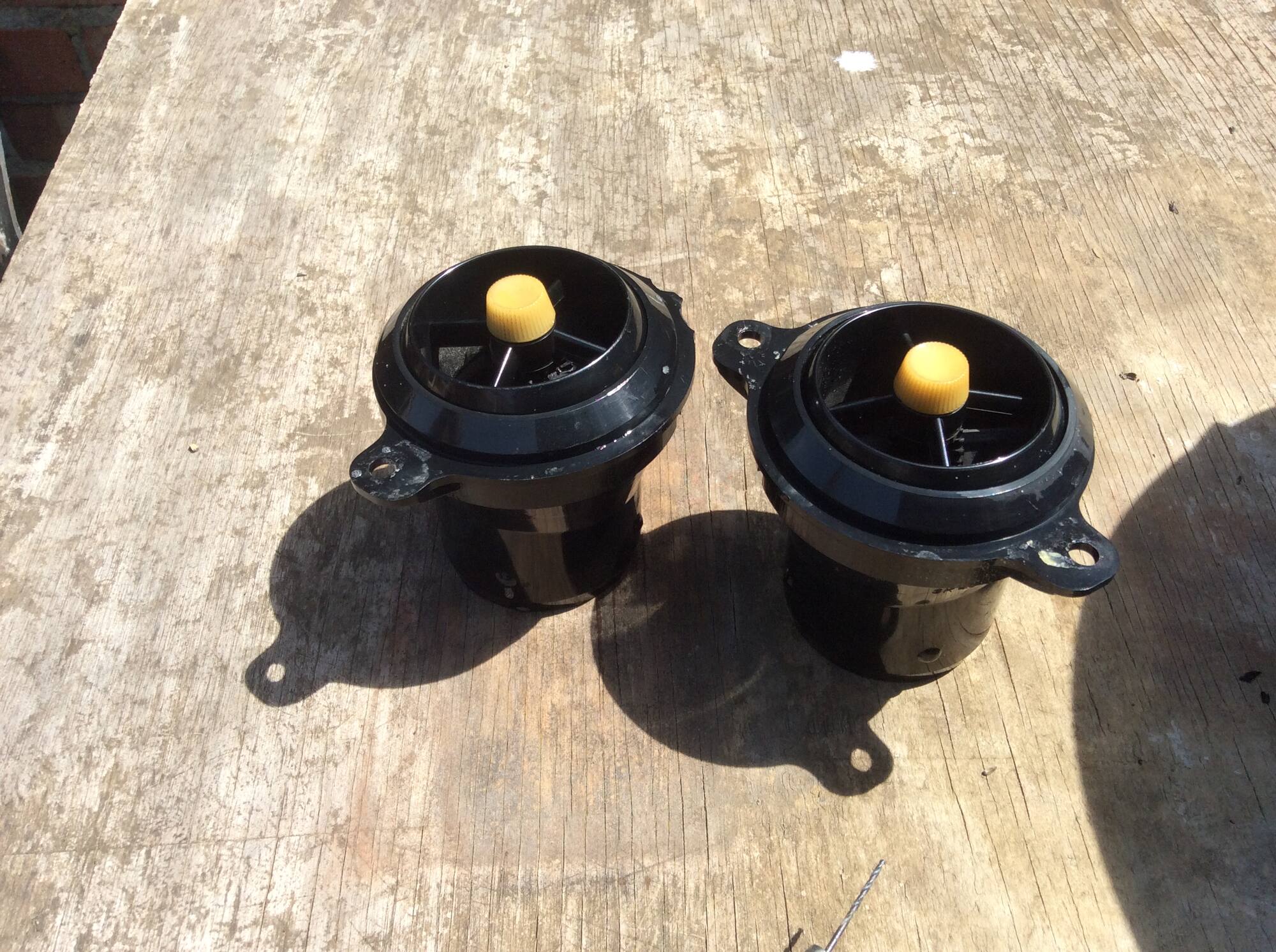

The first thing to do was strip the two fresh air vents out of the old dash. These went straight into a bath of soapy warm water for a scrub as the backs were very dusty.
Heres the two dashboards, some of the clips etc etc also had to be transferred over to the new dash with the air vents.

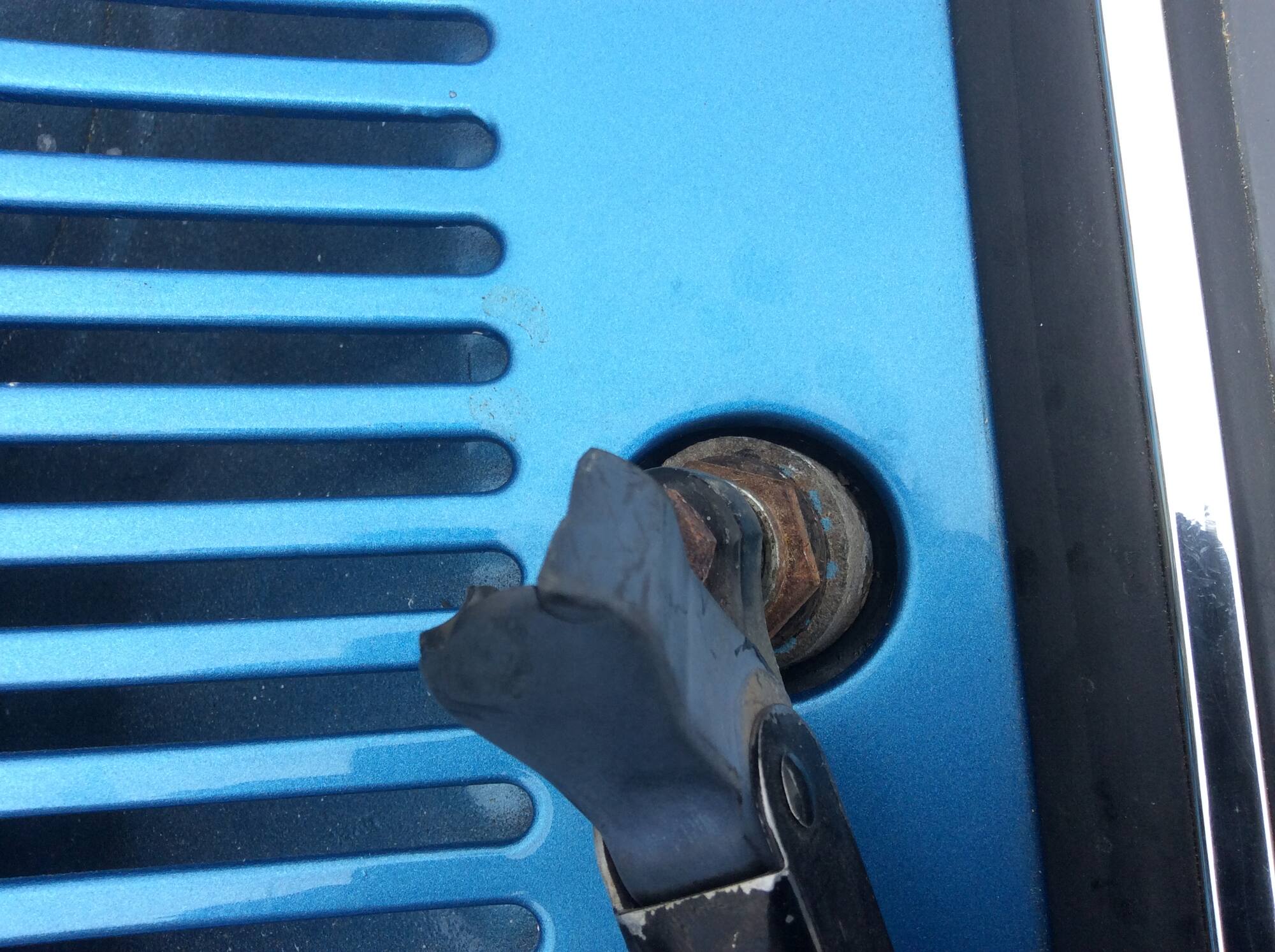

Today I decided before I go too far building everything under the dash back up, I’d double check the wiper mechanism is correctly installed and it’s properly sealed. Access now is as good as its ever going to be.
So I can’t remember exactly how it all fits together given the time it’s all been apart now. Basically, there’s a load of spacers, washers, nuts and a seal. The order of which is the trouble!
I've got the mechanism all in place, the two wiper spindles are pushed up through the scuttle panel from inside the car. There’s a thin rubber seal inside between the mechanism and inside of the scuttle.
Outside the car, the two spindles poke up through the scuttle. Then I’ve slid on the new rubber seal washers (these are approx 2mm thick and about the size of an old penny washer), then there’s a large thick spacer, then a thin washer, then the larger top nut which when tightened down secures the whole lot together and squashes the rubber seal washer to seal the spindles against the scuttle. On top of the larger top nut is a ‘top hat’ plastic cap/cover, then the wiper arm slides on onto the tapered splines on the end of the spindles. Then finally there’s a thin small washer and securing nut to hold the wiper arm on.
It looks about right to me, and everything fits well. I’ve also poured some water over it and there’s no signs of any leaks. It looks good from inside too, like how it’s supposed to fit.
Trouble is, I’m not 100% sure how I’ve done it is right!? Anyone got any ideas? Or better yet, done this job before?
I want it right before I start building up the dash etc and it becomes much more difficult to get access to.

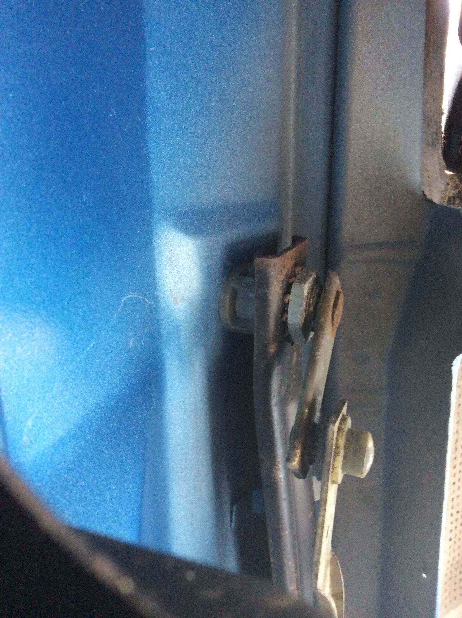

heres a couple of pics. Outside.
The ‘top hat’ plastic cover isn’t on in the pics but it fits on over the rusty bigger lower nut. The big rubber seal is right at the bottom under the grey spacer (the big grey bit with specs of old paint on it).
Inside.
Ive assembled it all temporarily using some old spare nuts/washers/spacer etc for now until I know it’s all in the right order.
The original bits have all been cleaned up, sprayed black and are drying at the moment. I won’t be putting those scabby rusty bits back on!
Anyone see anything wrong or that I’ve missed?
Just had a look at mine and I think you have it right.
Superb! Cheers mate.
ill get the freshly cleaned & painted bits on in that case, then carry on rebuilding the dash.

Cheers for that! It does look the same as what I’ve got if zoomed in a bit.
Theres actually a hell of a lot more bits and pieces inside that wiper mechanism than you think there is. I haven’t stripped mine right down as it all seems to work perfectly fine but the majority of the washers and seals in that diagram are bits inside the spindle mech. On the outside of the car there’s actually not a huge amount.
It would be so easy to put a spacer in the wrong place and then maybe have the whole mechanism trying to run slightly out of alignment. Very annoying and a real PITA to fix once the dash and interior is in place.
