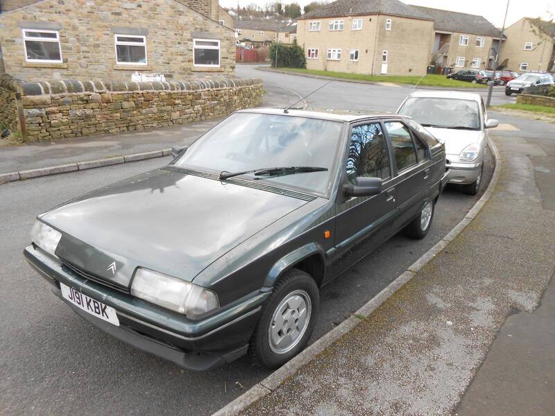

BX ownership turned a bit less glamourous over the weekend. Here it is last night:
Having crossed the Pennines on Saturday to visit the residence of a friend in the lovely* town of Castleford, we ended up broken down and stranded in Tadcaster. Eventually we made it back to Cas Vegas with the help of my friend James and his K11 Micra (he is well versed in the art of chod bothering, his other fleet members consisting of a Plymouth Barracuda stroked out to over 8 litres, a Citroen 2CV and a diesel Mercedes W124 estate, so coming out to rescue a complete madman in a BX late at night must have seemed like a fairly normal thing to do).
With no improvement on Sunday after the fitment of a new battery and a check of the battery leads, I ended up being given a lift home in my mate's Peugeot 306 HDi with the intention of going back Monday evening to get the Citroen started. Which was slightly spoiled by me travelling the 70 miles to Castleford then realising I'd forgotten the keys. With the last train having gone, and no car, I was forced to borrow the 306 for the return journey.
I'm not usually a fan of ridiculous bodykits (a few exceptions including the BX aside), but this one makes the humble 306 look bloody superb. It's brilliant to drive, too. The low rev torque is relentless and allows climbing of near vertical surfaces in 5th without any bother whatsoever, a contrast to the BX which needs poking with a big stick before it gets going. The steering is incredibly feelsome and communicative if a little slowly geared for my liking, and the ride/handling compromise is done superbly (although the rear suspension could do with being a touch less stiff, but that's steel sprung cars for you). The gearchange is a revelation after the BX too, it's still quite PSAish and therefore shit, but at least it doesn't feel like it'd be more suited to something with 53 seats and an 11-litre engine.
The reaction from other motorists when bombing down the outside lane of the motorway at 80 with 'L' plates on is also rather interesting. Unfortunately they wouldn't peel off in one piece.
Digression aside, it looks like my starter motor's borked, and I finally had to relent and buy breakdown cover to get me home, thereby giving me the chance to sample the worst vehicle I've ever experienced. Tomorrow evening I shall hopefully be able to remove the dodgy starter and set to work rebuilding it on Friday. Getting the air cleaner assembly off should also allow for access to the fuel pump bolts which are otherwise hidden, so I can kill two birds with one stone and get that timed up.
All in all, what a pain in the arse these last few days have been.

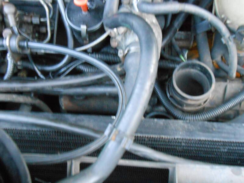

First of all, air intake tubes off. I was most surprised to find them half full of very old, very smelly oil. I wonder how that got in there.

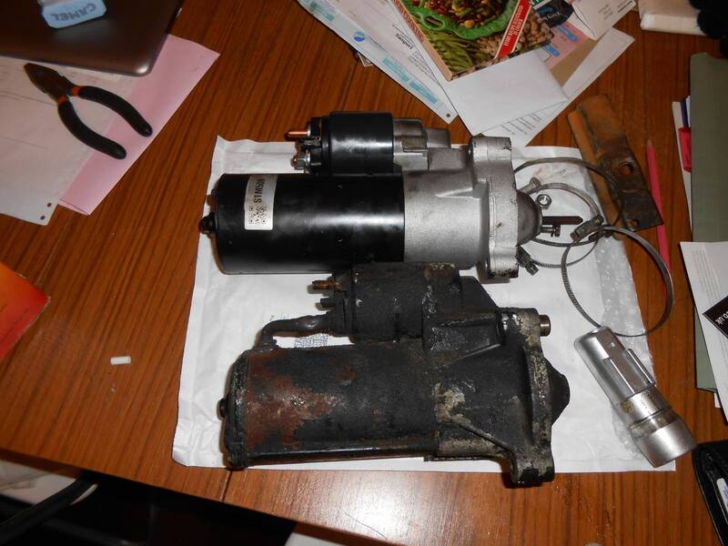

It sounds easy enough: undo one bolt from the front, three from the back and the starter motor should just drop out. However, the aforementioned access issues, plus bolts that have spent 24 years rusting themselves into place, made for a long job. Eventually, however, the starter motor came free to the sounds of much rejoicing.
Can you tell which one's which?
As you can see, the new one is slightly bigger than the old one, which made getting it back in an experience. Sadly all my photos from that night didn't turn out well, and assuming you don't want to see what looks like a couple of beige ghosts standing under what could be construed as a car bonnet, I'll spare you the displeasure.
New starter motor manoeuvred in, everything else fitted, and it was time to see if the BX would chug into life. I'll give you this picture as a clue to how we did:
Raised suspension can only mean one thing. The old Baguette Wagon now starts on the button.
They all do that! Even low mileage ones I've owned have had some oil in there, and the only one I've owned hasn't got noticeably worse over 140k miles. I'm sure there are more important things to worry about!
I think it's just oil being pushed through the breather system.
I was a little surprised and worried at first, but if they all do it I can relax.
