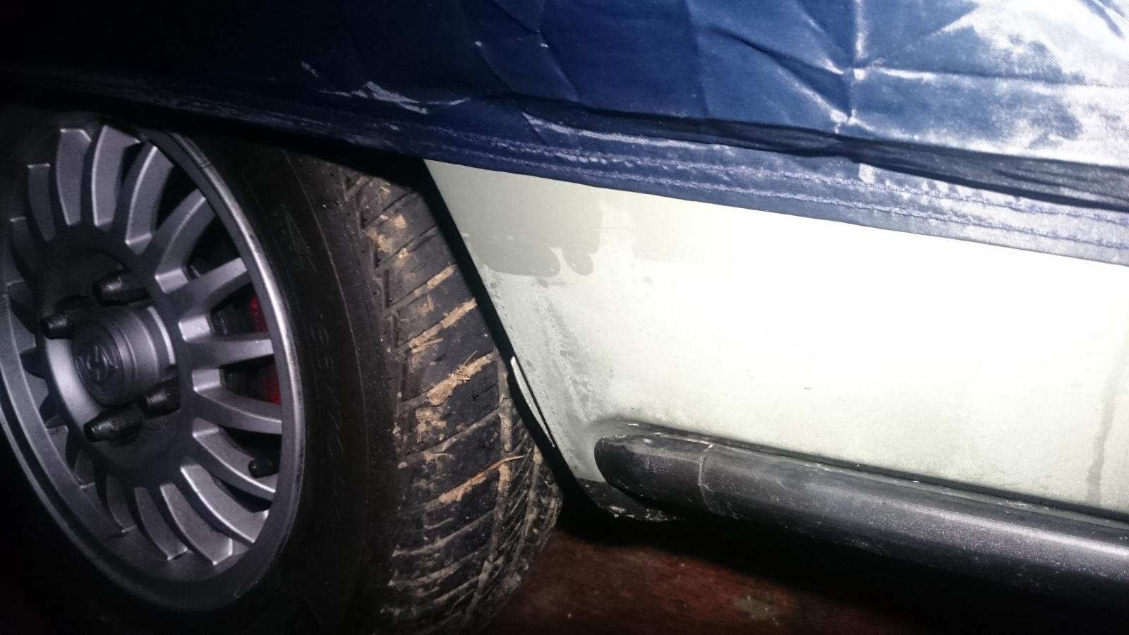

mat_the_cat Posted January 25, 2016 Posted January 25, 2016 And what can I do about it? We've had a pretty wet winter, even by Welsh standards. So even though the Stellar is in a leak-free, well ventilated garage, this is what it looks like a lot of the time: Every metal surface has water droplets on, including all my tools Even the tyres have beading on them! Fortunately, having a (non-waterproof) cover over it has prevented moisture from condensing on most of the bodywork - you can see the line where the cover has been - but not the underside. The concrete floor has a waterproof membrane underneath it so it's not rising from the ground. Is there anything that can be reasonably done??? There's no easy way to seal up the building, so I can't see a dehumidifier helping, even if I could raise the temperature enough for one to be effective!
sierraman Posted January 25, 2016 Posted January 25, 2016 If suggest a draught of some sort. I'd definitely not do as my wife's grandmother does and bring in the car piss wet through and park it in the garage over some carpet.
bigfella2 Posted January 25, 2016 Posted January 25, 2016 You need some air movement in the garage, is there any way to install any vents or air bricks? What kind of garage is it?
mat_the_cat Posted January 25, 2016 Author Posted January 25, 2016 It's a timber (so breathable) garage, with a couple of inches gap under the doors - double at the end and a single on the side. It's well ventilated to the point of being draughty! I never put it away wet for that reason, as it would just never dry out.
OwdChina Posted January 25, 2016 Posted January 25, 2016 Used to have the same problem during the winter months in Massachusetts. The cheapest practical solution I found was to buy two cheap 20 inch fans, the sort that are mounted on four foot poles with base stands and put them in opposite corners of the garage, one facing the back, one facing the front of the garage and leave them on 24/7. Worked for me. mat_the_cat and andrew e 2
25v6turbo Posted January 25, 2016 Posted January 25, 2016 25KG bags of salt,one each side of the garage and one at the very back wall open them up and leave them,watch them change colour,in the winter they get damp and go like brown suger in summer they turn white,it saps the damp out of the air,have them in my garage and so does my dad,work fine. Fat_Pirate, michael1703, fred and 3 others 6
noseypoke Posted January 25, 2016 Posted January 25, 2016 Rob one of those old parafin road work lamps (old people know about these) and place it on a brick (about 4" off the ground) this will keep the air moving,by drawing in fresh air thru all your holey wood Me mum used to hang one of these lamps in the loft next to the water tank during the winter months,never had burst pipes in her house? cos the frost never had time to settle,they only held about 1 pint of parafin but on a small wick they'd last about 5 days.

Skizzer Posted January 25, 2016 Posted January 25, 2016 There's dehumidifiers and dehumidifiers. The compressor types need heating but the desiccant types don't, so are suitable for garages. More info here: http://www.meaco.com/which_dehumidifier_is_best_outdoor.php I've got a Meaco DD8L Junior and it's a flipping astonishingly good bit of kit. Used it in the freezing cold kitchen in our old flat (you could see your breath) and now use it in my big shed, albeit mostly inside cars. Not super cheap at about £160 but really effective. Edit to add: This isn't to say that cat litter and salt aren't also worth a go. I use cat litter in my porous Golf, and it helps a bit - and costs a shitload less than a dehumidifier, obv. SamR380 1
mercrocker Posted January 25, 2016 Posted January 25, 2016 You would be surprised how much kitty litter takes out of the atmosphere. Some big drip trays or similar filled up with it will draw quite a bit and can be oven-dried for reuse...no power needed of course. Certainly worth keeping a couple of troughs inside the car if nothing else. fred 1
forddeliveryboy Posted January 25, 2016 Posted January 25, 2016 When it turns from freezing cold to 14C within a few hours, like it did at the weekend, condensation is going to be a big problem especially when the 14C is wet air and there are large lumps of heavy things like cars. Best thing possible is to move a car out of a garage for a few hours, if it's not raining. Otherwise doors and windows and bonnet and car doors open. solid61, michael1703 and mrcitroen 3
mrcitroen Posted January 26, 2016 Posted January 26, 2016 When it turns from freezing cold to 14C within a few hours, like it did at the weekend, condensation is going to be a big problem especially when the 14C is wet air and there are large lumps of heavy things like cars. Best thing possible is to move a car out of a garage for a few hours, if it's not raining. Otherwise doors and windows and bonnet and car doors open.Exactly. That is the problem I had at the weekend. I went to visit the BX and although it had been fine all winter, it now had a layer of condensation on the lower panels. It went from cold to around 13 deg in a day or so. Could not move it out as it has no battery and it's a downward slope on the way out. Pushing it in will be a bugger. Funnily enough last year I had a lot of condensation issues in that lock up, so I fitted air vents on the tops of both doors. This year I have had none, so they must work to some degree. I may put some at the bottom too.
steveo3002 Posted January 26, 2016 Posted January 26, 2016 you wont fight that unless you have a big ol heater metal things get cold when its cold out and dont warm up as fast as the air does in the daytime , once its settled into a cold or warm spell and the metal warms up it will go away

Danblez Posted January 26, 2016 Posted January 26, 2016 You would be surprised what a difference a dehumidifier makes even in a space that is well ventilated. I have one on my garden shed and it keeps the humidity levels well below outside levels. I would try and seal the doors a bit better and then get a dehumidifier, Christine 1

mat_the_cat Posted January 26, 2016 Author Posted January 26, 2016 When it turns from freezing cold to 14C within a few hours, like it did at the weekend, condensation is going to be a big problem especially when the 14C is wet air and there are large lumps of heavy things like cars. Best thing possible is to move a car out of a garage for a few hours, if it's not raining It's been mild and wet here this weekend, only frost we had was early last week so I don't think it's due to a sudden rise in temperature. or just have the door up and /or roll the car out when its a dry breezy day Hahahahahaha!!! We've had ONE dry day since the 2nd November, and we were at work during daylight hours so missed the chance to dry anything out I think a fan is the best/only practicable option - I've had one on all evening so will pop up later to see if there's any difference.

steveo3002 Posted January 27, 2016 Posted January 27, 2016 might well have a leak i use these things in our cars ,,,they keep em dry and mold free , jsut dry em on a rad every month or so http://www.ebay.co.uk/itm/TWO-Thomar-Windscreen-Dehumidifier-Bags-Condensation-Damp-Car-Windows-Demister-/171189242284?hash=item27dbac89ac:g:L40AAOxy4t1SoFhs can find em cheaper than that oldcars 1

Kiltox Posted January 28, 2016 Posted January 28, 2016 Currently successfully using a compressor type dehumidifier to dry out cars after wet shampooing the interiors - it says on the box it works down to 5c but seems to still be effective a little bit below that £80 Homebase own brand job
