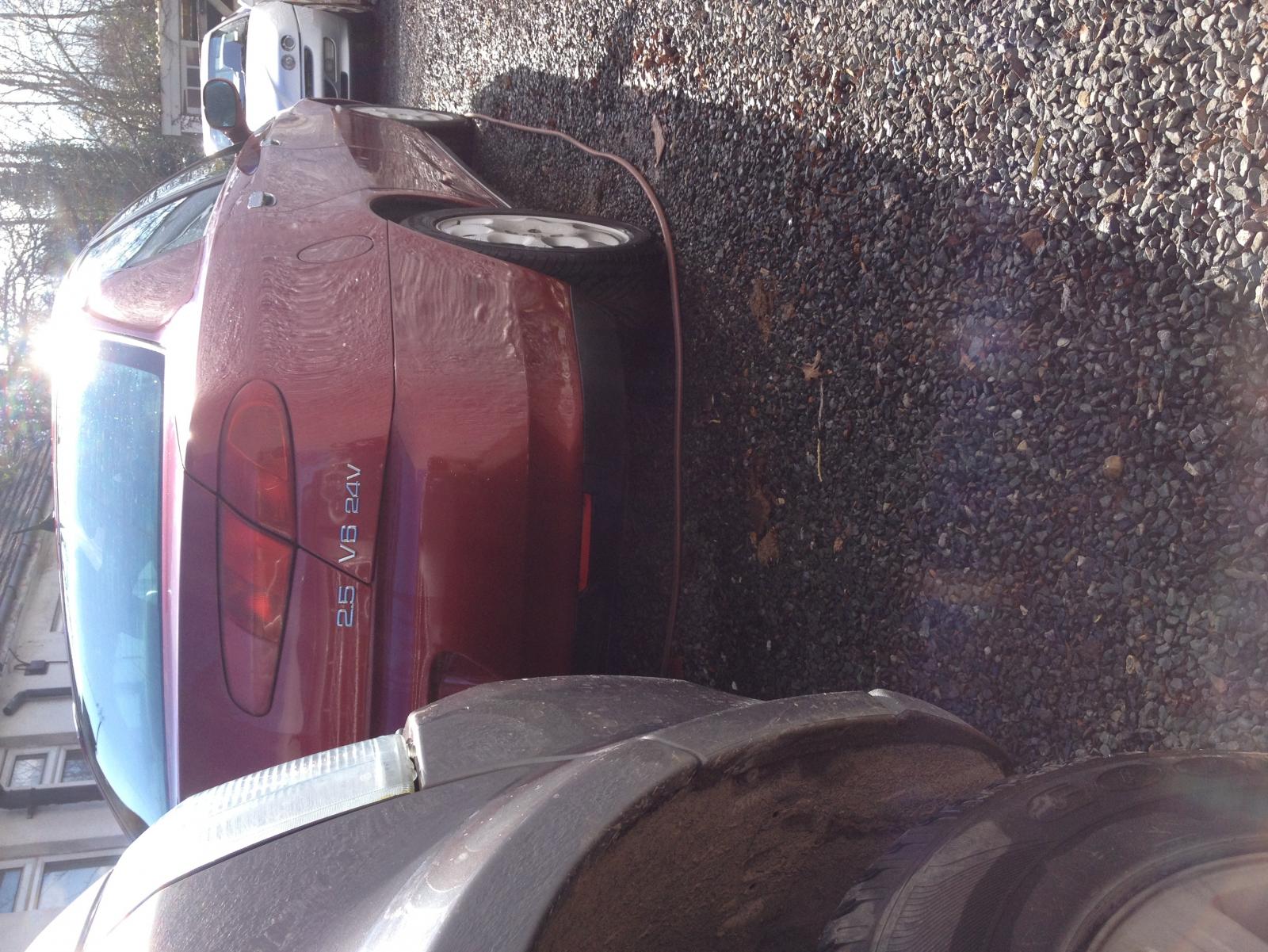

I have a 2001 V6 2.5 Sportwagon and that is a joy to drive the engine is full of character and gives enough performance to make it seem all worth while. I almost forgot, not bad to look at when I clean it up.

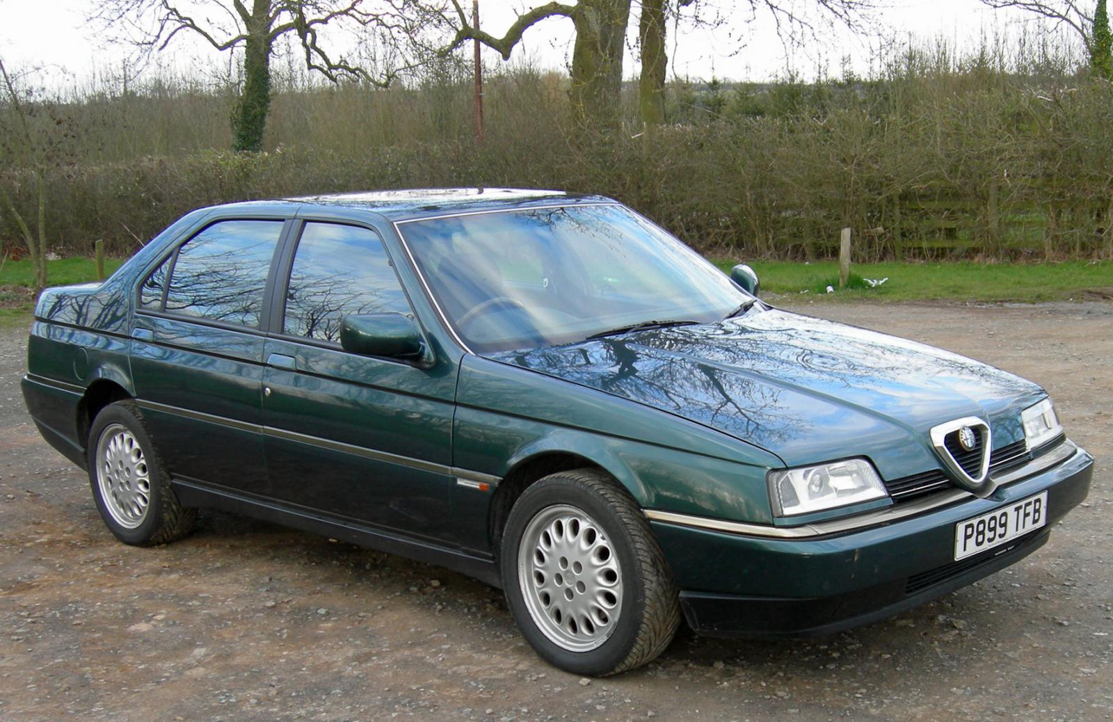

I'd have a 164 v6 in a heartbeat- great cars!

In 1996 when I left the motor trade and gave up my new Xantia I needed a stop gap car and at work we had a 1988 164 V6 12V manual which I took home for a weekend, when I returned it my boss commented my hair on the right side looked like it had been dragged though a hedge backwards, I had to explain that was from having the drivers window open all the way to listen to the engine music!
I was not a great example of a 164 and I was not brave enough to buy it, I drove away in a Saab 900i.

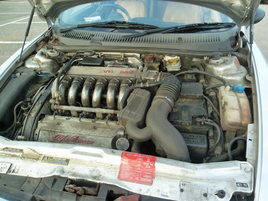

I can thoroughly recommend the V6. I love it's raspy howl at high revs and its still sweet as a nut at 190k with the lump never having been apart. I reallised yesterday I've owned it 6 months and though ive serviced it i haven't washed it yet so made amends yesterday......post-4673-0-09893200-1457260782_thumb.jpg
I can thoroughly recommend the V6. I love it's raspy howl at high revs and its still sweet as a nut at 190k with the lump never having been apart. I reallised yesterday I've owned it 6 months and though ive serviced it i haven't washed it yet so made amends yesterday......attachicon.gifimage.jpg
More pictures please!
