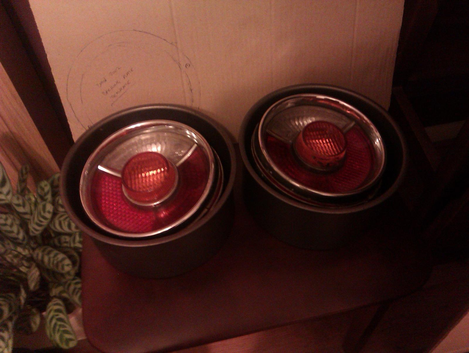

Guess what, cake tins are made of steel and come without silly coatings and are exactly the size I want.  Cake tins.
I just found two in the cupboard that are *useless* for making cakes in but exactly the right size for what I want to do.  I didn't even know I had them.
They even have removable bottoms so I can make good baseplates too.  Happy about that.
