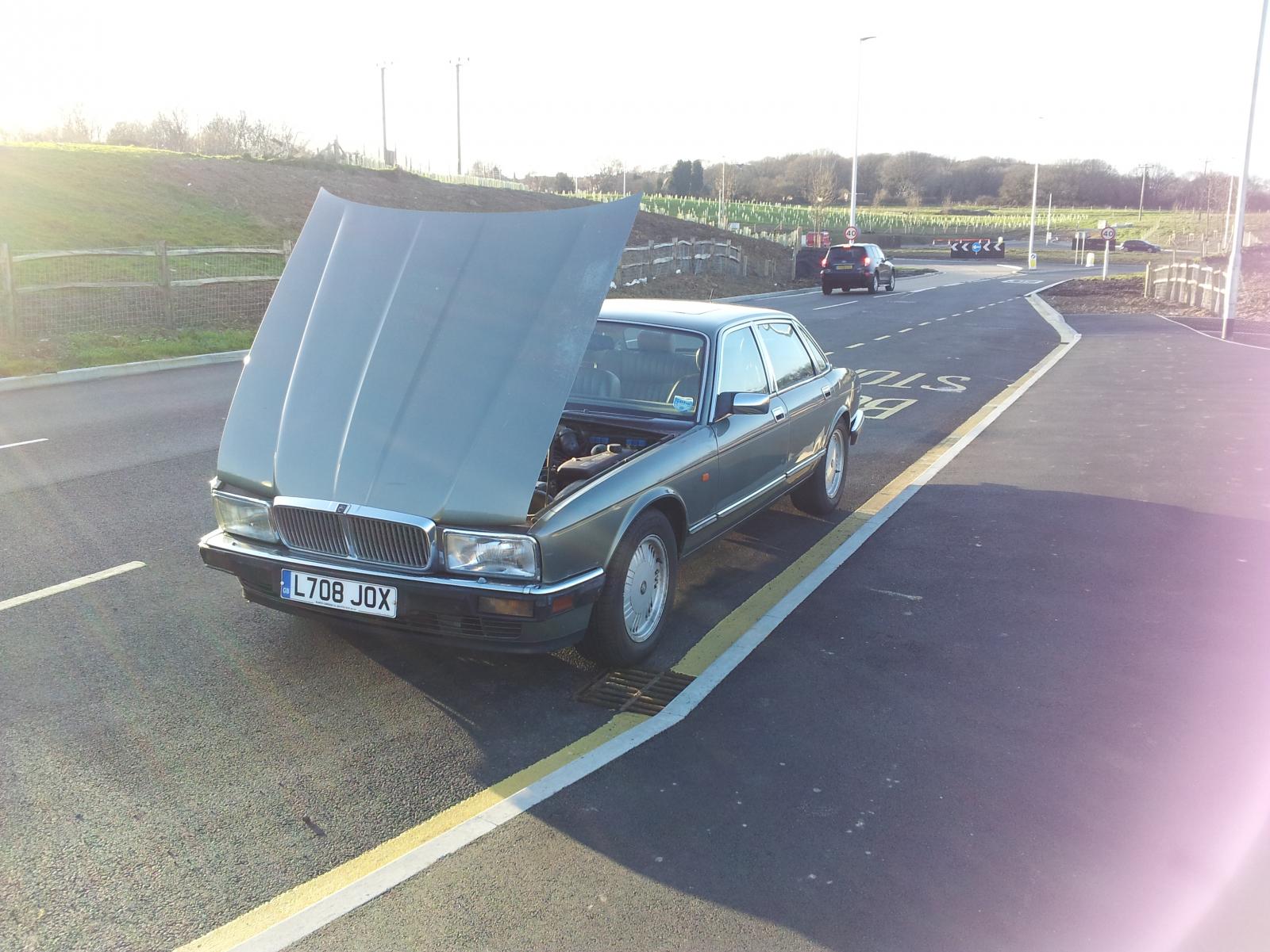

Now it's still great but with less electricity in it. Alternator is my chief suspect, waiting for breakdown service.

Yup, alternator dead. Being recovered back to Devon by the look of it. Could be worse! I can recommend Autoaid, very good service so far.

Well that sucks! But the car still looks great even with the bonnet up.

The alternator is generally reliable on these, so that's annoying. The version you need for this car is the later 120amp Denso alternator, part number DBC6819 and also used on the X300 IIRC
http://www.jaguarclassicparts.com/uk/jaguar-xj6-xj12-parts/battery-starter-motor-alternator/alternator-and-control-unit/alternator-assembly-120-amp
http://www.ebay.co.uk/itm/jaguar-daimler-xj6-xj40-x300-xjs-alternator-denso-/361467493663?hash=item5429243d1f:g:RRkAAOSwLzdWS1Cn
https://www.xj40.com/viewtopic.php?t=3801
Thanks, that's really helpful, not a bad price either.
