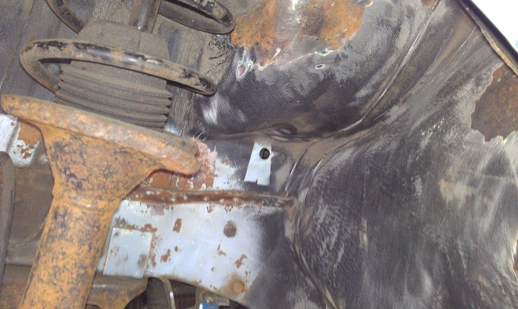

Started to rub down some rust in the passenger wheel arch this morning until called on to take my son biking.
Not too bad rust wise-did the drivers last year. Will rust kill with Vactan  when finished followed by a coat of epoxy primer and underseal.
Both rears to follow.

The strut tops have been repaired in the past-but I have a couple of proper repair panels from the Autobahnstormers club to do them properly in the near (few years) future.
Strut tops  on the Senator are really good-but will have a really good look when I take the wheels off to clean the wheel arches.
