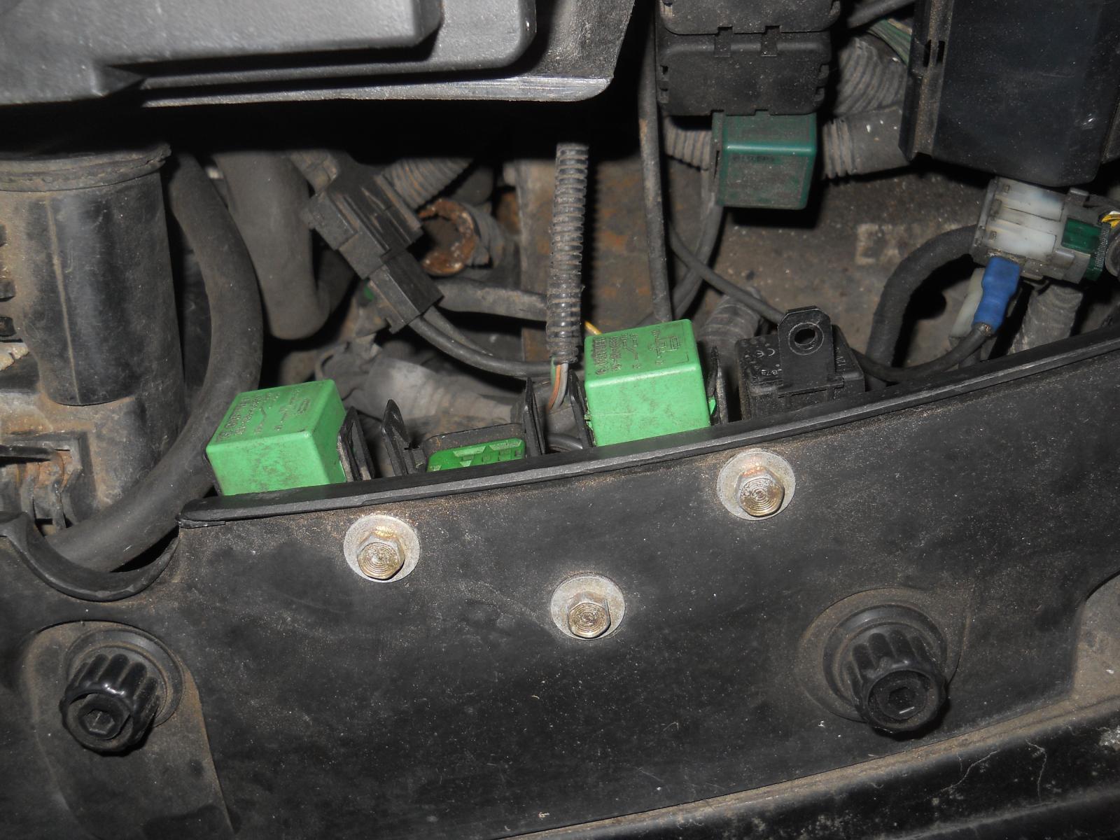

Lankytim Posted December 26, 2015 Posted December 26, 2015 The headlamps seem to work all the time now, but the dashboard (headlamp) warning light doesn't come on! Any ideas on that one? Mine was doing exactly the same, the dash warning lights on startup have packed up too, i.e airbag light e.t.c. It would occasionally work though. I think the whole lot is connected anyway. Today I had a spare 5 mins to investigate. The relay socket was full of that green electrical corrosion gunk so I took it all to bits to clean. After 0.1 seconds the main feed to the headlights earthed against the skinny relay earth and the whole lot went up in flames. FUXXXSAKE!!! always disconnect the battery :( Looks like it just needs a new earth, so not too bad. FakeConcern and andrew e 2
FakeConcern Posted December 26, 2015 Author Posted December 26, 2015 Mine was doing exactly the same, the dash warning lights on startup have packed up too, i.e airbag light e.t.c. It would occasionally work though. I think the whole lot is connected anyway. Today I had a spare 5 mins to investigate. The relay socket was full of that green electrical corrosion gunk so I took it all to bits to clean. After 0.1 seconds the main feed to the headlights earthed against the skinny relay earth and the whole lot went up in flames. FUXXXSAKE!!! always disconnect the battery :( Looks like it just needs a new earth, so not too bad.I clicked "like" but I don't really like it at all! Hope it can be an easy fix for you.I think all the othet dash warning lights still come on, but not sure & will check tomorrow. By the way which relay is the headlamp one? andrew e 1
Lankytim Posted December 26, 2015 Posted December 26, 2015 The dipped headlight relay his under the slam panel behind the drivers headlight. FakeConcern 1
FakeConcern Posted December 26, 2015 Author Posted December 26, 2015 The dipped headlight relay his under the slam panel behind the drivers headlight.Sorry to keep asking, but which one?
FakeConcern Posted December 26, 2015 Author Posted December 26, 2015 Yep!!!OK as you were. I'll have a look tomorrow when I haven't had the best part of a bottle of red. Thanks ever so much for the replies. Meanwhile here are some pics
