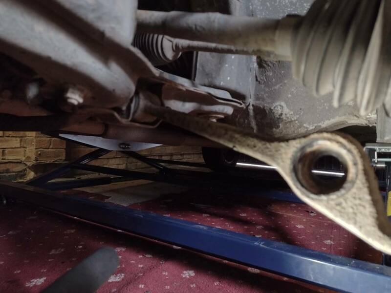

I had some more time tonight so had a go at removing the drivers side lower suspension arm. The balljoint dust covers were an advisory at the last MOT anyway and I needed to get the arms off to be able to remove the old bushes and press the new PU ones in when they pitch up.
Access isn't too bad with the wheel removed and the ARB detached
I had undone the 17mm nut on the threaded section of the balljoint end - as you can see, the dust cover is split at least halfway around here. I used a crowbar and hammer to lever the arm off the bottom of the hub
On the left you can see the cylindrical bit that the bush goes into, this is held onto the subframe with a stout 17mm bolt which was easy to remove with no tension on the arm
This is the arm itself which came out without too much struggle. the balljoint dust cover was wrecked by being removed so that will get replaced with one from the bag that are on their way back from @Lankytim. The arm itself has some surface rust but is otherwise fine. The next task was getting the bush on the left end of this arm out. JFW what a pig of a job.
In the end I used a pillar drill to drill holes through the rubber until it was weakened enough that I could hammer the bush out with a drift, but not before I'd lost three drill bits to snapping, tried 2 g-clamps with sockets in to try and push the bush out, a hole saw and a LOT of hammering. Safe to say they are a 'snug fit' in the void!
This is it with the bush removed
I cleaned up the void with a wire brush attachment in the pillar drill, and also cleaned up the other hole that the ARB mounts through while I was at it. Its not super-clear in this pic but I have managed to do a bit of damage to the inner edge of the void that the new bush will go into with the drill. I hope this doesn't matter too much, as the bushes don't rotate at all in the arm - they are pushed in and grip like limpets - with the PU bush, there is a chromed metal tube that the bolt goes through which is what moves, when the bushes arrive I will slide the tube out, silicone grease the inside and outside and slide it back into the PU bit.

Just watched a guide that you can use a hub puller to push the bush out of the arm - I'll give this a shot tomorrow on the other one as it looks like you can apply quite a bit of force and gently push it out without needing to drill the rubber out, b0rk all your drill bits and damage the inner face of the void like a ham fisted moron by doing it this way.
Two thoughts:
For tightening up bushes, always do this with the vehicle weight on it's wheels.  That means the bushes are under mimimum stress for the vast majority of their life.
To get particularly troublesome bushes out, especially old ones where the rubber has gone hard and is stuck solid in the arm:  Burn them out.  Very effective.  Very quick.
Some more progress. As I now know what I'm doing* the other side came out in 20 minutes, I had a go with the hub puller I got in a jumble sale for £2 two years ago to press the bush out
Which was an amazing success - the only fiddly bit was lining the three legs of the puller up on the rim of the void that the bush locates into, then just pushed it out by tightening the spindle of the puller up. The job took all of 2 minutes to do and I managed to not damage the inner face of the void at all.

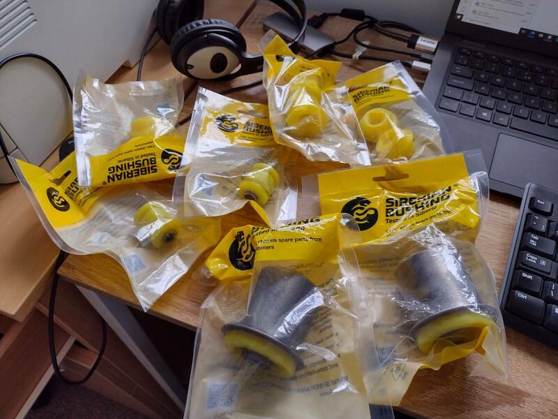

DHL have just messaged me to say the new bushes will be here on Monday, hopefully along with the new suspension arms as well and I can rebuild the front suspension on Monday evening. I R XCITE
From Russia, with love DHL
Check out my new bush(es)
VRY XITE
I hope the new suspension arms pitch up shortly too, then I'll go and get my local garage to press out the old ones and press in the new ones I think - saves me hamming the job right up and wrecking the lovely new parts.
Front end completely rebuilt, the arms arrived about 25 minutes after the PU bushes, I called my pet garage about pressing in the new bushes and they said they were stacked and it'd be 2 weeks time at the earliest so I had a stab at doing them myself with the hub puller. I was purple with rage due to a dire morning of work issues so didn't get any pics, but was able to press the rubber bushes out of the lower arms with the press, lubed up the voids (fnarr) with silicone grease and pressed the new PU bushes in with minimal fuss. I then loosely bolted the arms into the subframe, tapped the locating rod bit of the balljoint into the bottoms of the hubs and did up the castellated nuts to tighten them into position, then fitted the split pins to keep them in place.
Then I fitted the ARB bushes, put the ARB ends through the new lower arms and did the nuts up a bit to keep it in place. Then I sliced the u-clamp bushes, wrapped them around the leading edge of the freshly painted ARB, and clamped them down with the metal clamps.
I then went and did the nuts on the ends of the ARB up tight to pull the ARB > lower arm top hat bushes into position properly.
It all went together fine which was a big relief. So thats the front end refurbed with all new bushes and arms which should help a lot.

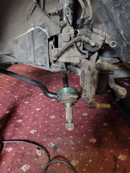

I stripped it all down to this
Then rather than fight with the greasy cone of perversity to stretch the new boot over the CV joint, I opted to take the CV joint off the end of the driveshaft, making access loads easier. The new boot went on fine, the clips were done up and pinched and I then reassembled everything. CV joint splined end into wheel hub, track rod end fitted to hub, lower suspension arm refitted, disc back on, brake caliper fitted to hub, hub nut done up and wheel back on. I took it for a test drive and got to the heady heights of 20mph before a horrible scraping noise (which turned out to be the disc backing plate rubbing the disc as it turned) and an even worse grumbing vibration caused me to turn round and head for home. Total distance covered <500m.
having stripped it all back down again there are a few issues.
1. I've b0rked the end of the threaded section of the CV joint that the hub nut does up into, either from whacking it with a hammer to get it to sit on the splined section of driveshaft, or from something else. I tried cleaning it up with a thread file which has made it better, but I think I've also buggered the thread on the hub nut too and I can't fit the thread file in there.
2. After removing the CV joint for the second time, I have broken the c-clip that holds the CV joint onto the driveshaft. Its now in 2 pieces
3. The hub nut is totally b0rked, its all chewed up from careless handling so thats game over'd
4. The brake caliper is very rough, the rubber seal seems to have got trapped in the pad at some point in the past and its allowed the piston to corrode by the looks of it. The sliders were a bit grim but have come up OK with lots of silicone grease and working back & forth lots.
probably other things as well. Anyway, I think I've mangled it sufficiently comprehensively to warrant a new CV joint kit and just start over. Sadly I can't seem to find anywhere that sells entire driveshafts, as that would be a lot easier I suspect, but there.
The CV joint is off the driveshaft and near the scrap metals pile. The boot has been removed but can probably be reused (i have one spare from the J&R kit anyway, and the new CV joint kit comes with another) with new clips. I'll order the new joint kit shortly for arrival some time next week. I'm not sure what I did wrong, probably mis-seated the clip somehow and didn't hammer the new CV joint onto the driveshaft far enough as a result.
I'll also probably take both front calipers off and send them to Bigg Red for refurbishment. They quoted £135.00 all in for the work, I have quotes I'm waiting for from two other companies, BCR and BCS so we'll see. Bigg Red are the ones I have heard most about so are likely to get my business. Assuming I do this, whats the best way to stop all the brake fluid leaking out with the calipers away for work for probably 10 days? Clamp the flexi section with a g-clamp each side? Is that likely to damage the flexi section much? Is there a better way? The ends where the flexi joins the caliper is a banjo bolt so I can't easily seal that up I don't think? Unless I made some sort of rubber washer+ nut&bolt arrangement?
All in all, not my finest work.
