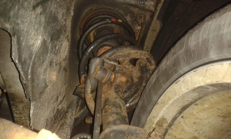

I noticed it was clonking from the front again this morning, so I put it on the ramp reasonably confident that it was going to be the shitty quality droplinks again.

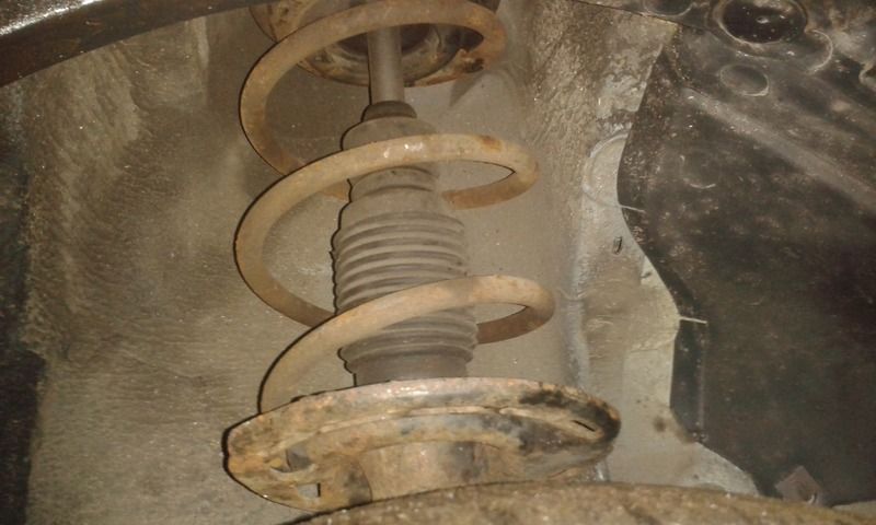

Or it could have randomly snapped a spring while parked, or something. FFS. At least it didn't cost me a tyre, and it took less than a minute to locate this

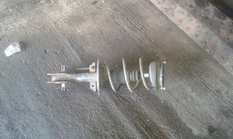

the other one of the pair of struts that was in the boot when I got the car.
here it is half an hour later.

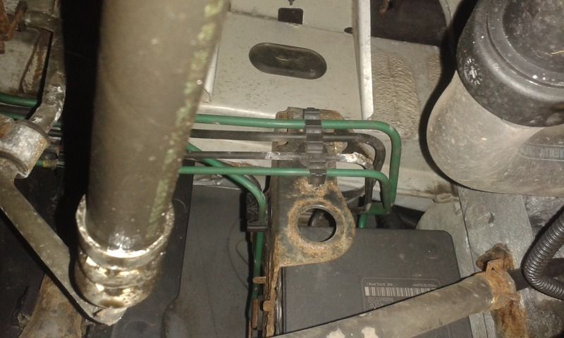

I did spot this moody brake pipe on the ABS pump though. I've added it to the mental list of stuff to keep an eye on.
