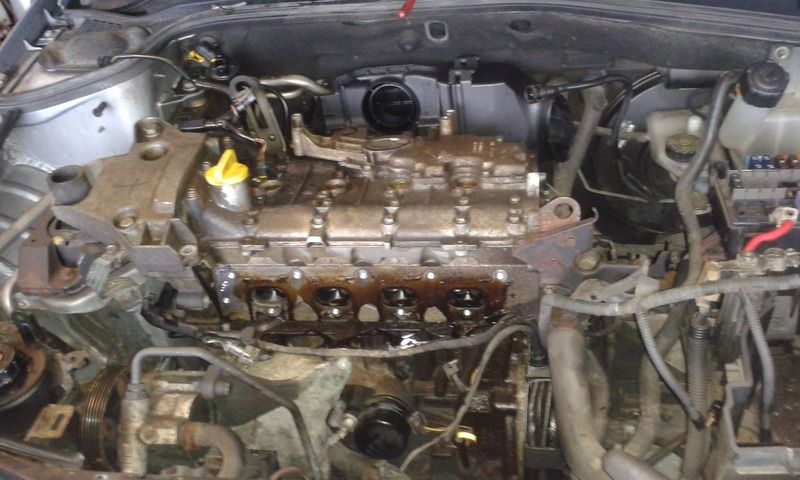

12:15 - everything arranged ready to start work.
12:29 - assorted plastics and battery removed, started to remove loom plugs and pipes.

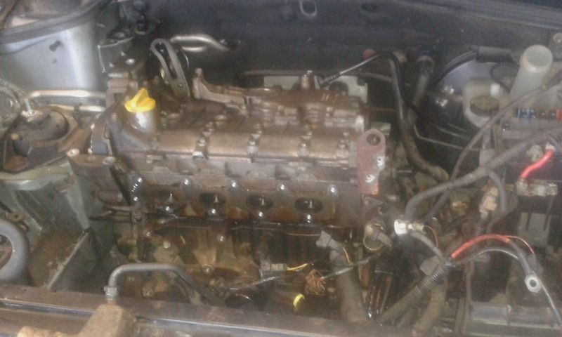

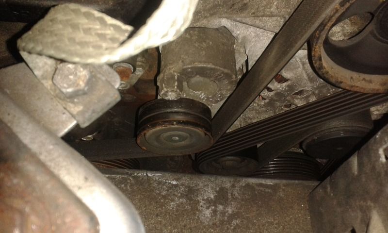

12:39 - pic of belt run so I don't have to remember how it goes back. Take belt off. Look at huge lump of alloy with PAS, alt and Aircon bolted to it.
13:06 - inlet manifold off. Ten bolts at the front, four at the back including two hidden ones underneath. Air intake assembly is trapped behind the engine.
13:32 - PAS and alt removed. Aircon pump off next, then six bolts to remove the bracket from the engine.
14:01 - Coolant drained, radiator pipes removed. Air intake still stuck, as is the wiring from top left around the front of the engine. It's clipped to the underside of the top engine mount (which I don't want to remove yet)
14:15 - Remove mount to free wiring and other bits, then put it back temporarily because I've got to go underneath to deal with the exhaust, starter and bellhousing bolts.

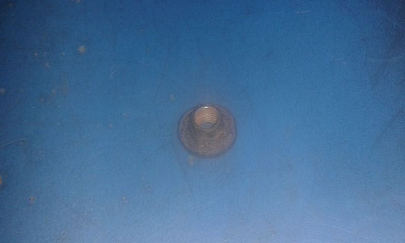

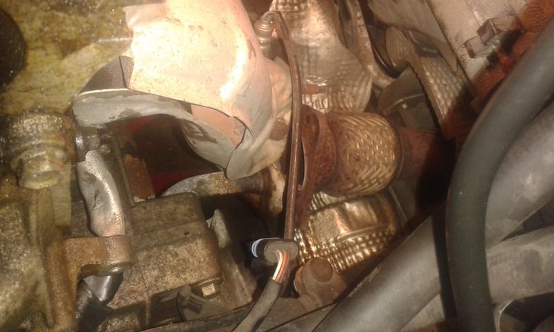

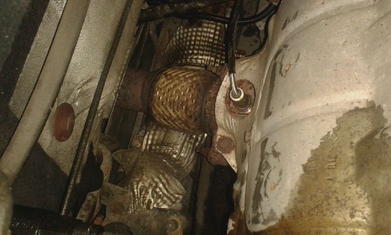

14.25 - exhaust downpipe to manifold nuts. Some genius has specified a M8 bolt with a 10mm head, and then 3 of them have spent a decade living just behind the bottom of the engine so they all came off easily with no trouble. Except they didn't.
14:38 - OK, that's one of them off. This one still had a head because it's the top one and also it is the one you can get a socket onto, so some oxy to loosen it up and away it goes. No such luck with the other two.
15:05 - using a combination attack comprising lots and lots of heat, some mole grips and an angle grinder the other two are now off without damaging the studs.

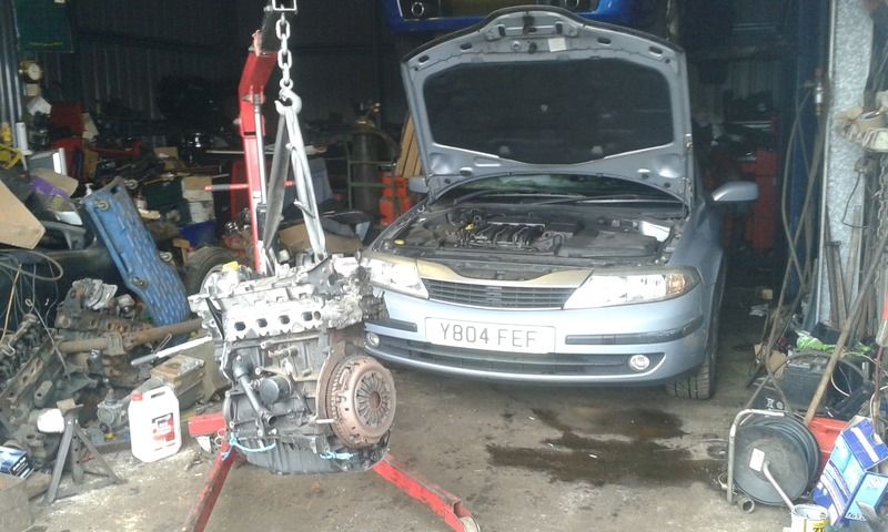

Making a fairly reasonable 3½ hours to remove the engine. As well as the bellhousing bolts there are two long studs which need removing (a t30 torx fits the end making it easy. Don't remove them and you haven't got space to separate. You need both gearbox mounts off as well so it can swing forward before it comes out, but there is plenty of space and you don't have to faff about removing the linkages or driveshafts. Box is supported with a jack waiting for the new engine incoming.
So... I swapped the engines over on the hoist and transferred the exhaust manifold to the new one, then hoisted it into the hole. It went straight in and onto the input shaft, engine and box slid together nicely. YAY :)

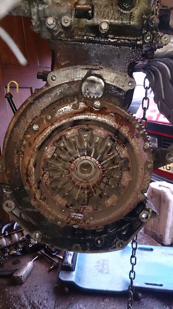

BUT none of the bellhousing bolts lined up. WTAF? Not even close!

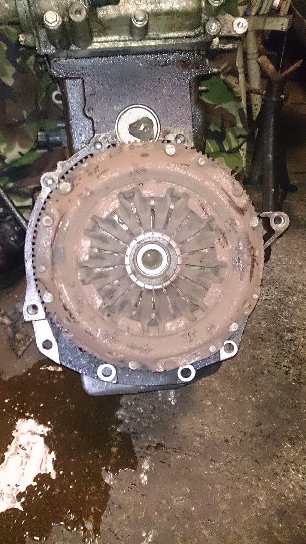

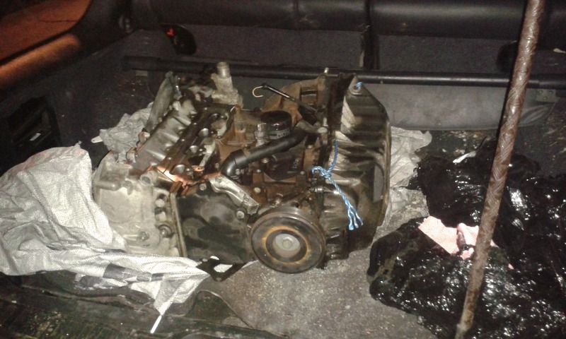

So engine back out to confirm worst suspicions...
Old
New
Yeah. Flipping wonderful. That's totally different then. AAAAAAAAAAAAAGH.
New engine says "02 Laguna 1.8 16v f4p" on the top in white pen, and the eBay listing said 2001-2005 for fitment so either there are two gearbox types or this engine isn't out of a laguna. I'm guessing it's from a scenic and the breakers yard managed to muddle them up on the floor. Apart from the bellhousing it appears to be completely identical.
