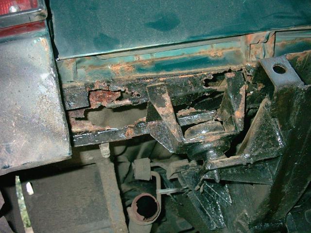

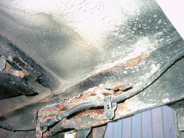

Reason(s) for failure
Indicator tell tale missing (1.4.A.2a)
Windscreen washer provides insufficient washer liquid (8.2.3)
Rear registration plate deteriorated (6.3.1d)
Offside Rear brake drum contaminated by brake fluid (3.5.1h)
Offside Front Brake hose excessively deteriorated (3.6.B.4d)
Centre Vehicle structure has excessive corrosion, seriously affecting its strength within 30cm of the body mountings (6.1.B.2)
Nearside Front Shock absorber has an excessively worn bush (2.7.4)
Nearside Rear Vehicle structure has an unsatisfactory modification, seriously affecting its strength within 30cm of the body mountings (6.1.B.2)
Offside Rear Vehicle structure has excessive corrosion, seriously affecting its strength within 30cm of the body mountings (6.1.B.2)
Nearside Rear Suspension spring mounting prescribed area is excessively corroded (2.4.A.3)
Offside Rear Suspension spring mounting prescribed area is excessively corroded (2.4.A.3)
Advisory notice item(s)
Service brake: service brake efficiency only just met. It would appear that the braking system requires adjustment or repair. (3.7.C.1a)
Parking brake: parking brake efficiency only just met. It would appear that the braking system requires adjustment or repair. (3.7.C.1b)
Steering system slightly tight (2.2.D.1)
Steering system slightly rough (2.2.D.1)
all brake pipes have corrsoion
underside of vehicle has corrosion
shcok absorbers and leaf springs have corrosion
Oil leak

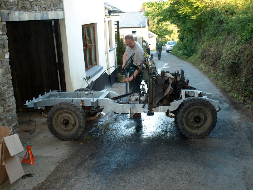

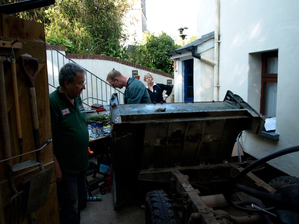

Formulated a plan for three blokes to do the chassis change in 48hours. Me to plan and lead, dad for basic spannering and uncle Ian to shear heads off nuts and bolts
This is what we did, notice subtle difference between the two pics. Fatha Thestag appears in both pics
MoT pass took another two months because uncle Ian took the damn thing apart again to get the panels painted. It passed with a clean sheet, first one of those for many decades
The bits in between those two pics looked a bit like this;
notice mutha thestag doing her Medusa
rolling chassis still carried some weight - mainly rust and the road is steeper than it looks :D
All of that ^^^ was day 1
Anyway the rolling chassis was taken down the lane, shackles cut from the old chassis, new shackles and pins to attach the axles to the new chassis then built back up with milestones for beer consumption

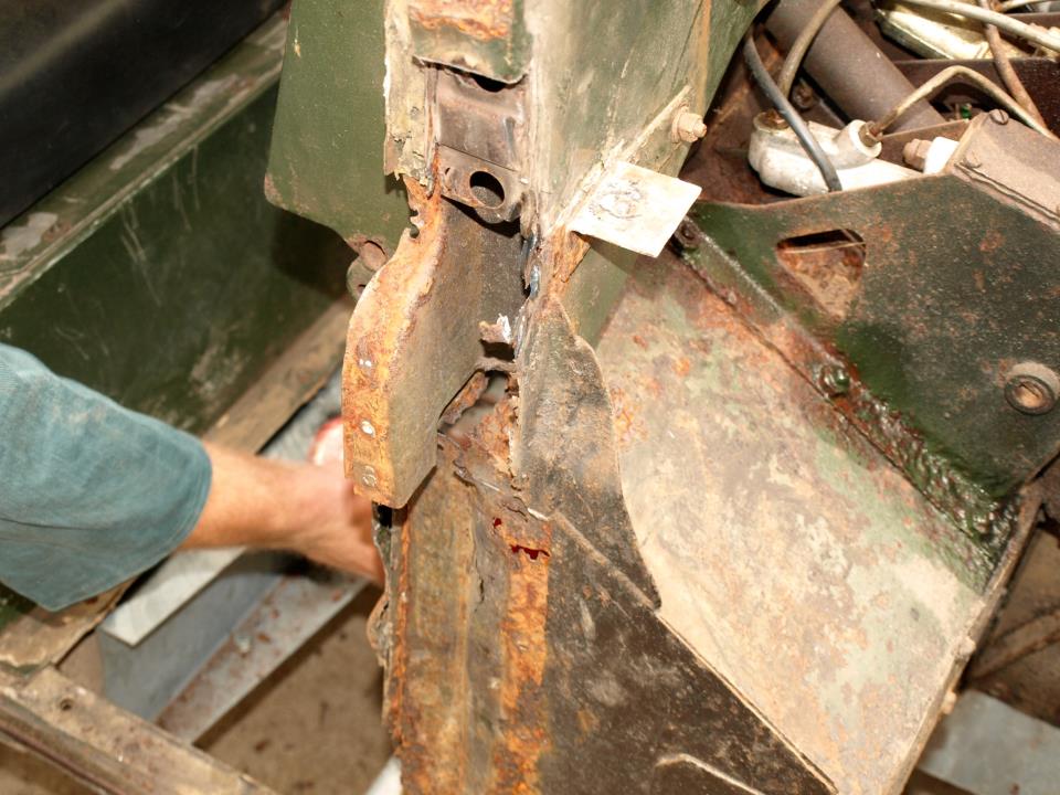

A-Posts looking pretty ropy

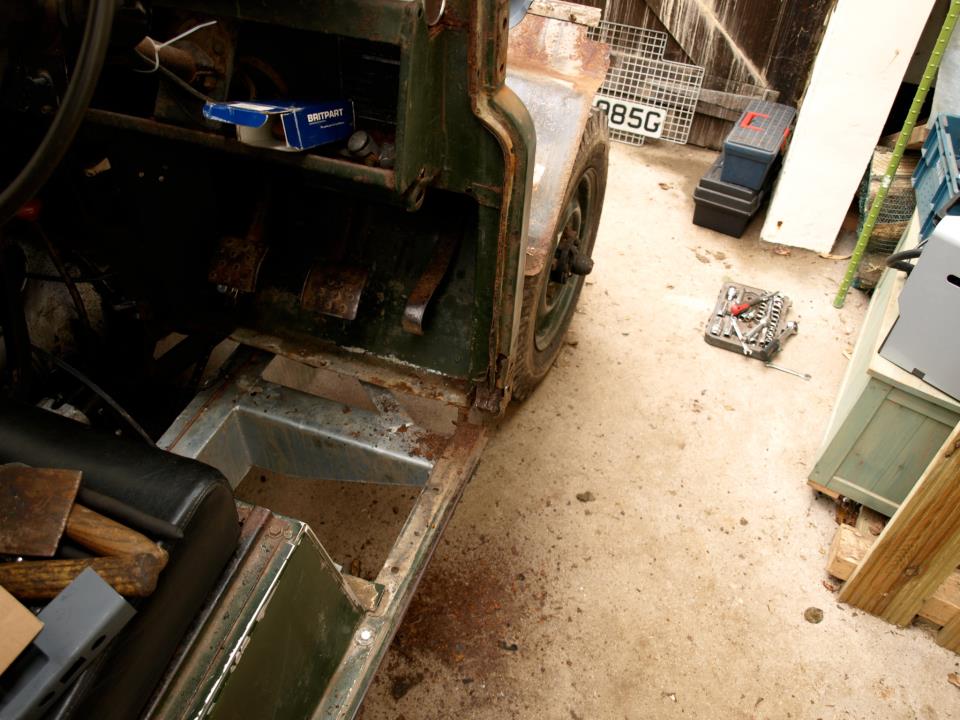

next step was to fix a-posts which led to floor pan replacement, luckily all bits are dirt cheap and easy to weld in, except I had run out of gaz hence the pigeon shit welding.
good enough for mr MoT

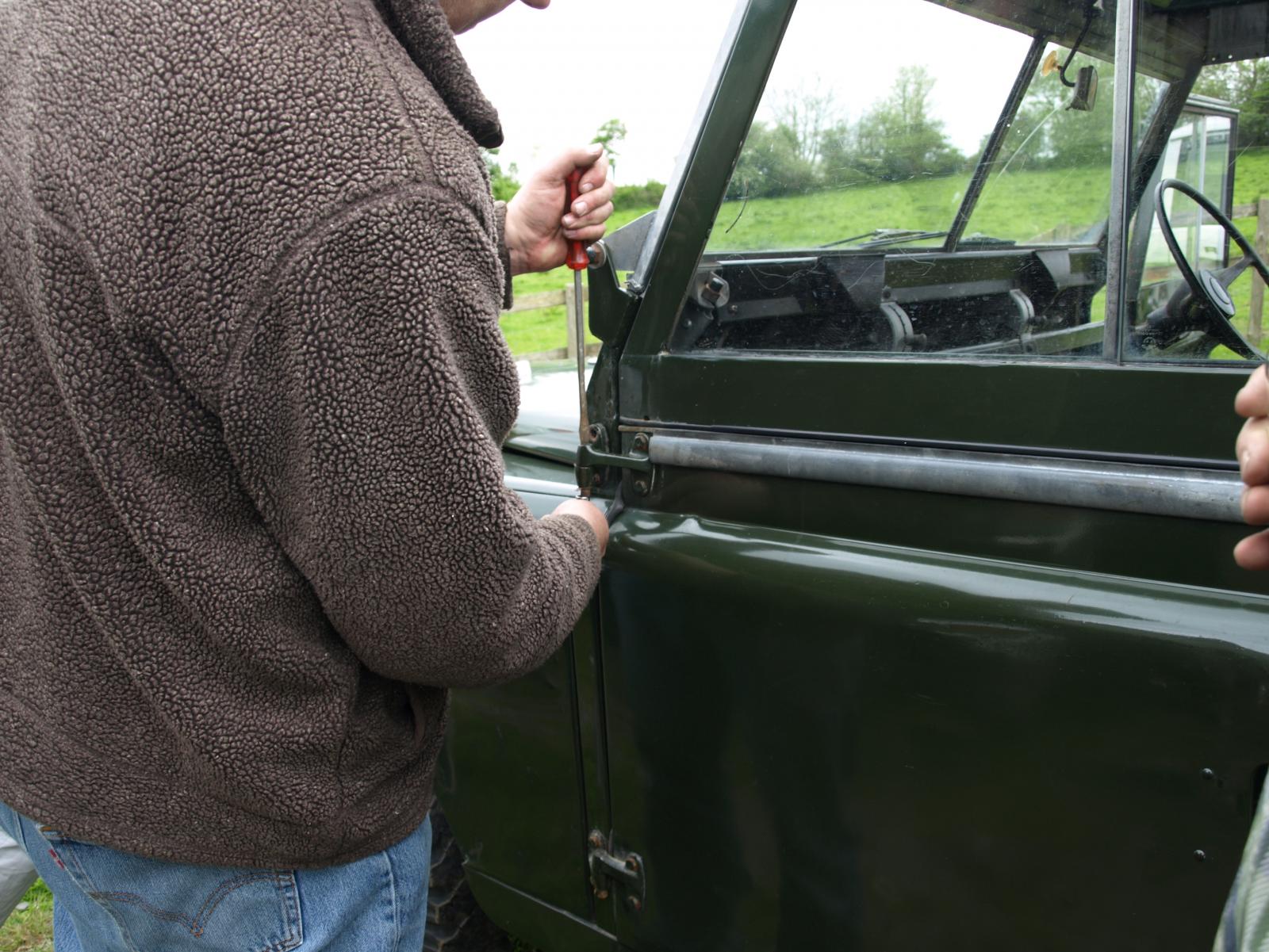

My nephews were washing the car ready for the South Molton Vintage Rally when the passenger door was "accidently" dragged from its top hinge. They both denied any misdemeanour. Quickly was able to identify not only very rotten door tops but also upper a-posts. The interim fix involved a lump hammer and lump of firewood.
This aint going to close
Going to need a bigger hammer
Sorted

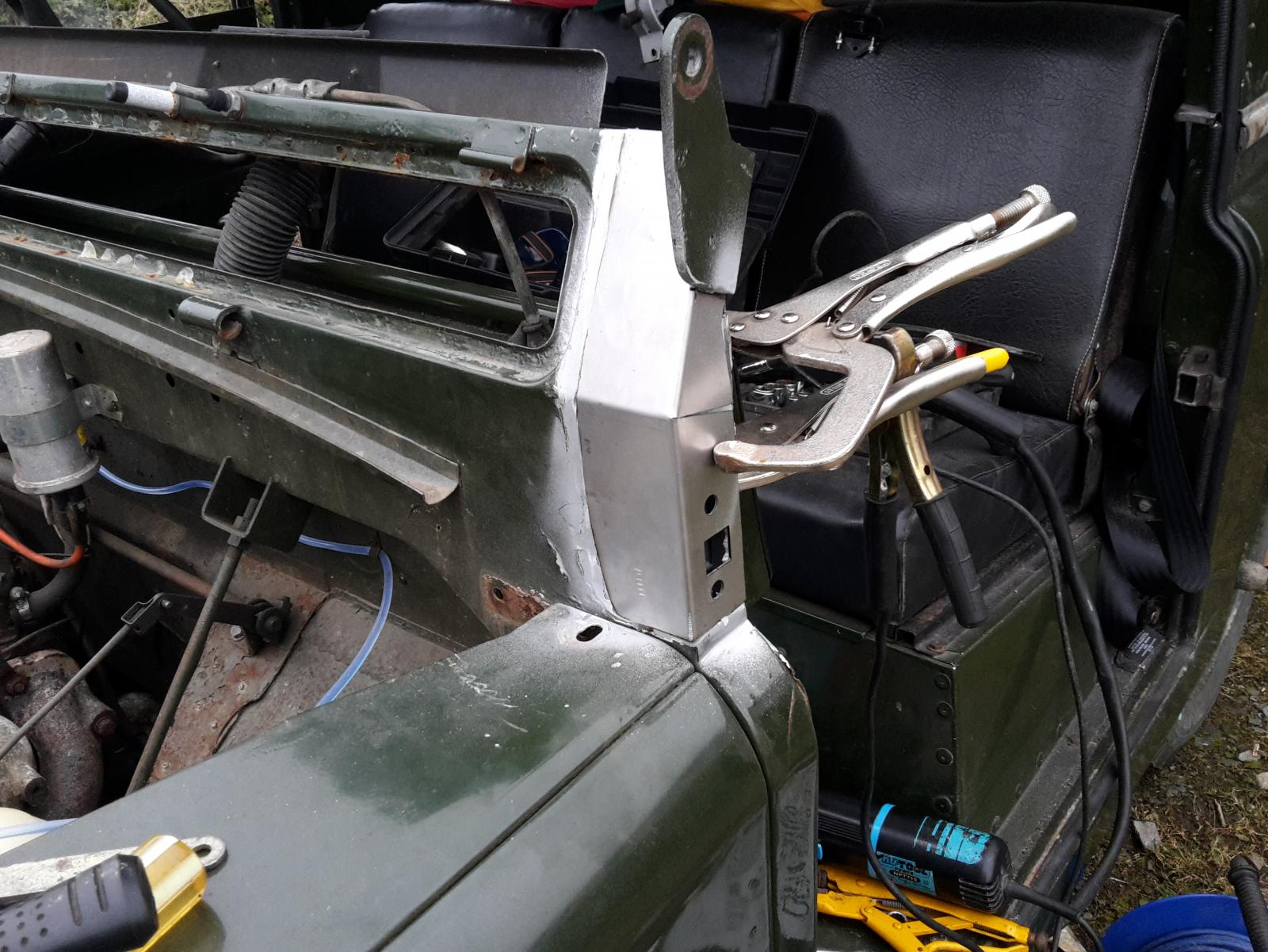

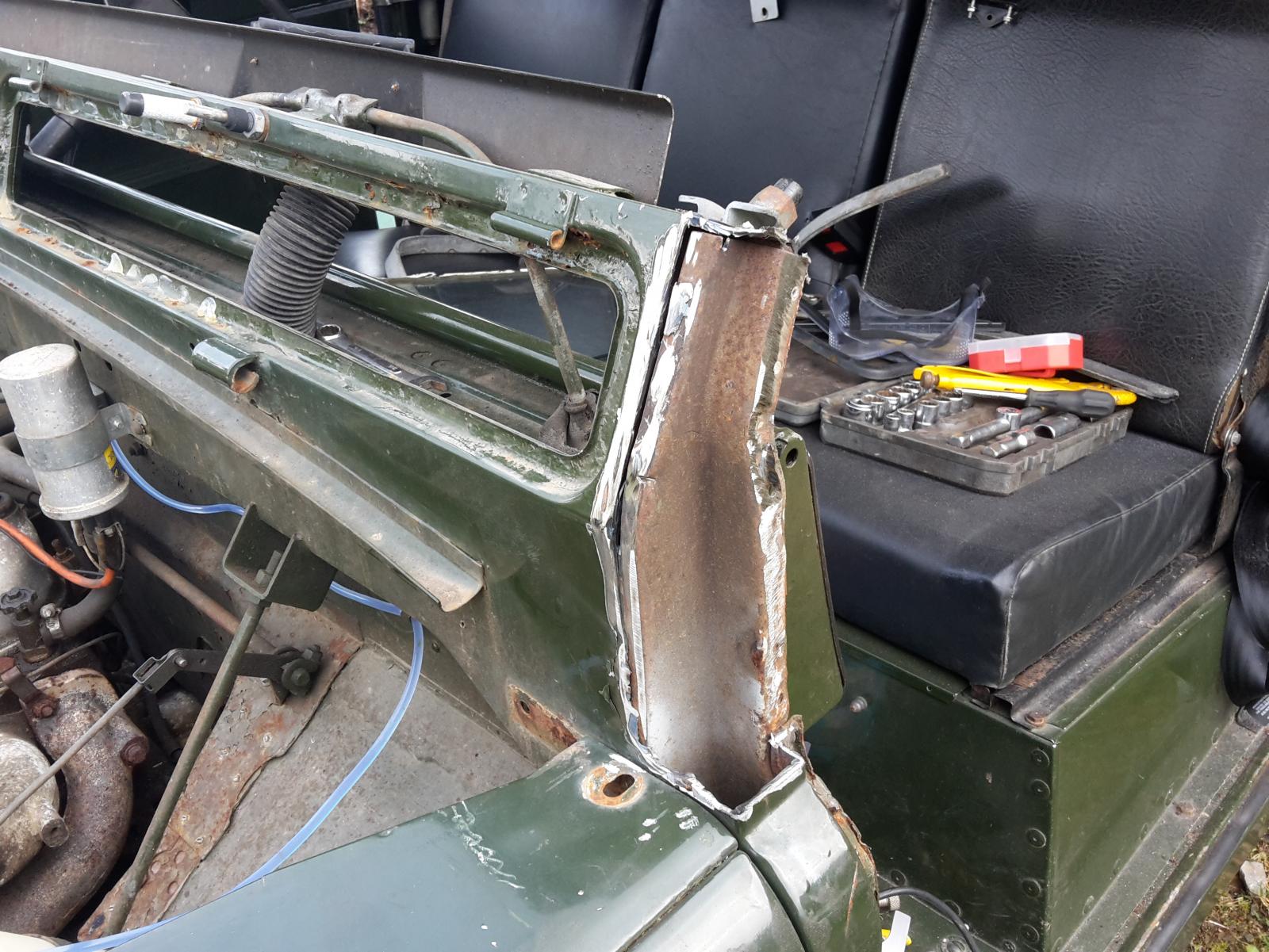

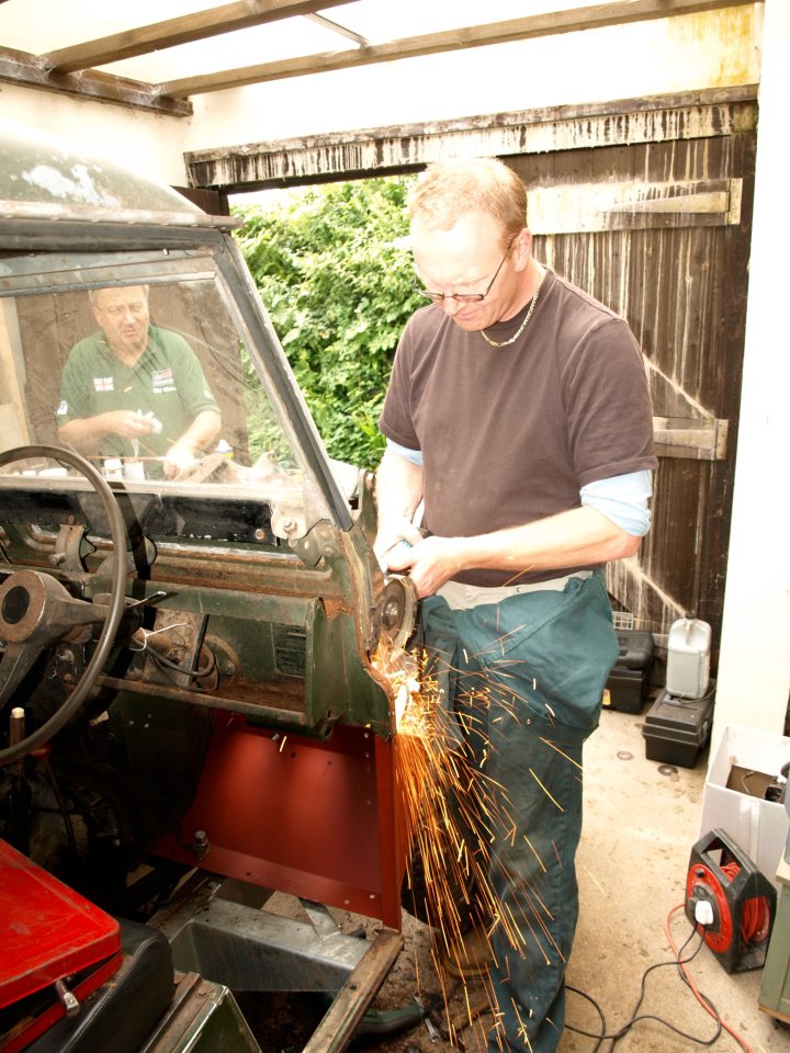

fast wind to last week for the series. cut out and replaced the upper a post. needed screen out but else pretty easy. fitted new doors and screen tops. Paint match wasnt the best, think Ray Charles did that bit eh Fatha Thestag?
Doors shut like a 1950s Bentley now

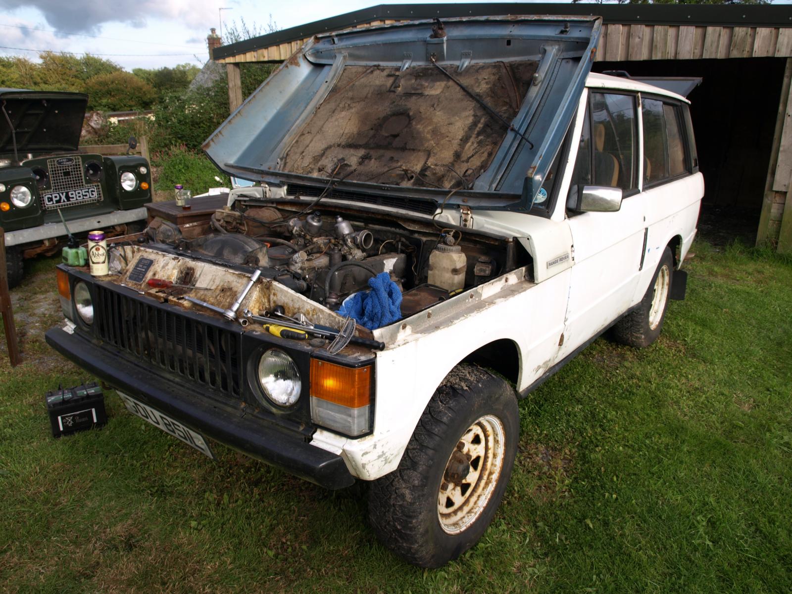

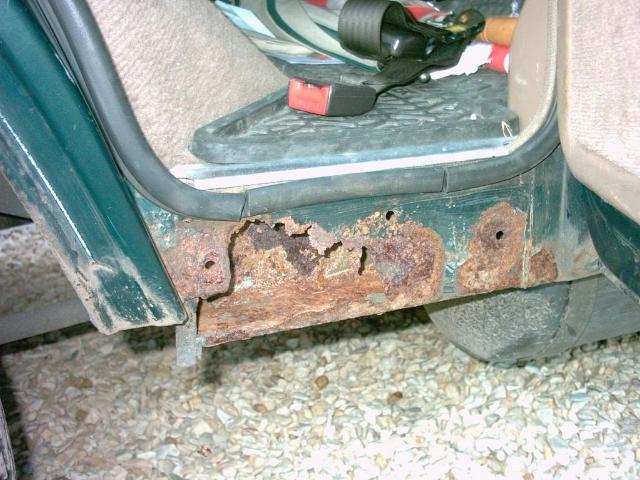

next post will be my first and now ex Range Rover Vogue. proper shite and learned a lot from my experiences with it
my first Range Rover has a hasty purchase, looked shiny and the seller was the publican from my old local where I met Mrs Thestag. I should have walk no run away but I ended up parting hard cash for a money pit.
This was it at the end of our relationship
I let me down more times than all my other cars combined. I was on first name terms with the call centre lady at the RAC. But it was a blast.
Problems in a nutshell were rust and mechanical issues. Oh and the lacquer was lifting making each panel a different colour. and the rear top tailgate liked to open all by itself. the viscous diff was seized, the CV joints were dead, the transfer box went bang very loudly. the engine regularly shat coolant from the expansion tank due to dropped liner in the block and the rust! did I mention the rust.
At the very end it popped the rad and lost all coolant on the M40, by the time I got to the hard shoulder the engine has seized solid. It did restart again but sounded nasty. I threw in the towel
Interestingly I found it was a Land Rover owned car, it was painted BRG and was the first Range Rover to be painted BRG. I probably shouldn't have scrapped it but economics didn't make sense at the time. Don't make any more sense now tbh
I bought my next Range Rover for less than it would have cost me to put this one right. There is a tinge of guilt that it is no more. newish bits were recovered and went on my shelves in the garage and still keep current car on the road. The rest went on ebay. one dustbin of stuff went to the tip. I returned a tidy profit out of it I think

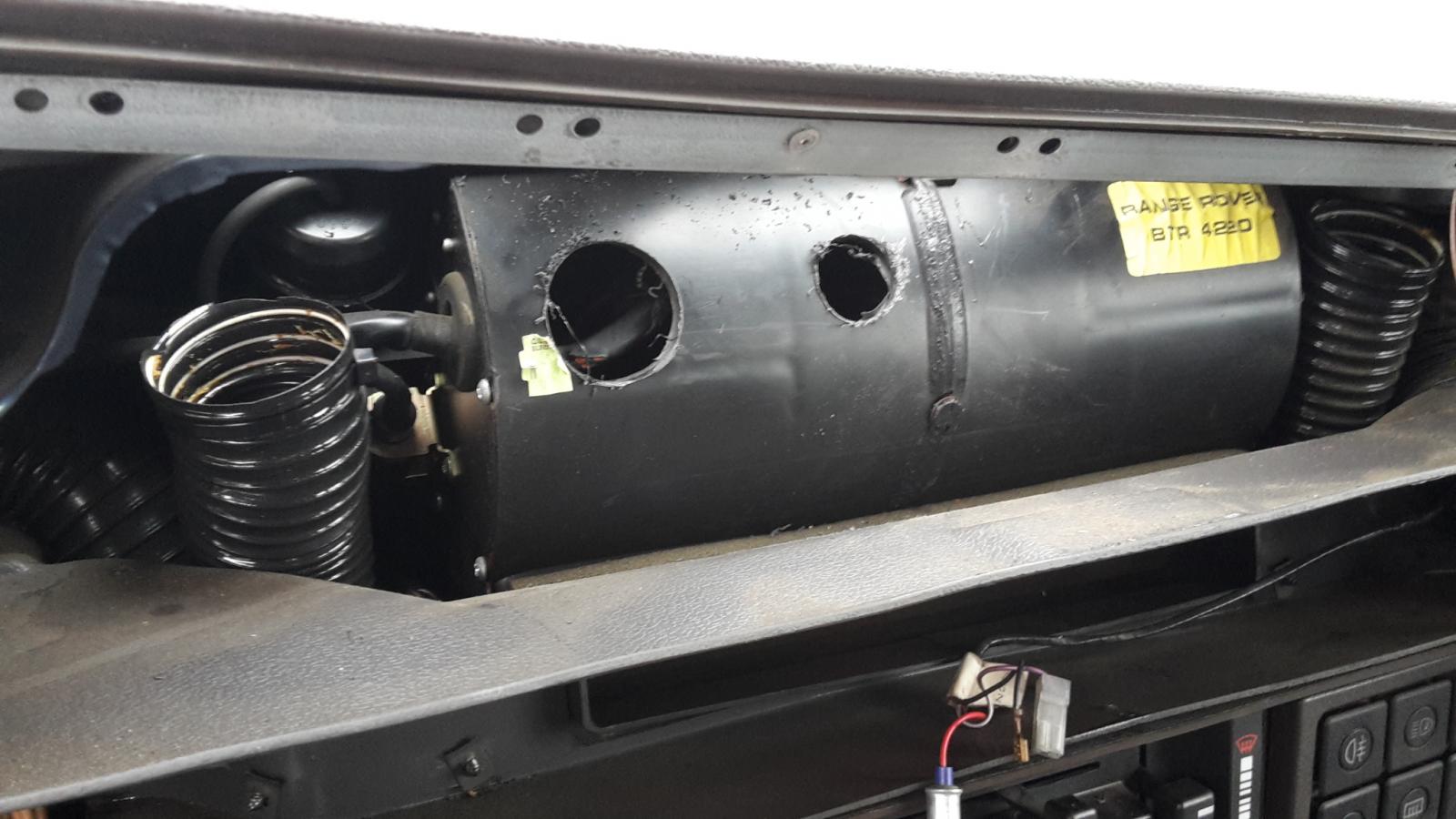

Unsuspecting owner "Hello Mr Land Rover Dealer my car heater blower squeaks and squeals quite alot, can you fix it please"
LR Dealer "certainly sir £11ty thousands groats please"
Unsuspecting owner "fucking hell why so steep?"
LR Dealer "because the first thing installed into the interior is the heater unit, to get at it we need to remove the world first"
ah but no you dont.
:D
remove top dash maybe an hour if you need a fag break every 15 mins
with dash top out of the way you can see the top of the heater unit.
Use hole cutter to drill two holes where i did
being careful of the motor loom that runs inside
Bollocks
then using a silicon lubricant with the straw you can reach the two bearings on on the end of the motor
and the other through the right hand hole
While you are there get rid of the field mouse that has been doing all the squeeking

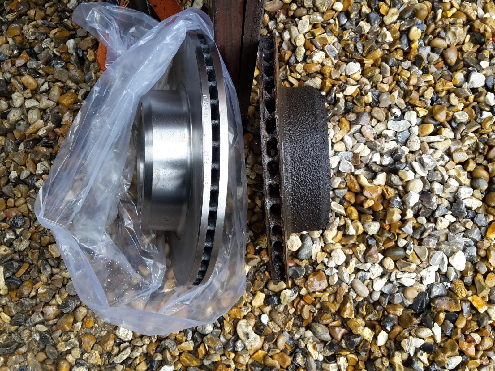

front brake discs next
MoT 2014 had an advisory that the discs were getting thin but not weakened. Never done the front discs, pretty good chance they were factory items so that will be 150k on them then. so when the pads were getting low I thought I would change the discs at the same time. In Aug 2015
^^ thats a bit scary on a 2.3tonne car that I use on the motorway quite a lot.
Piece of piss to do though, and a standard 1/2 inch drive socket set does most of it except for the 1/4" af bolt that secures the rigid pipe from calliper to flexies on the top of the hub. rusted solid. used my dremel to grind it off.
with calliper out of the way the only special tool (probably the only special tool on the Range Rover) is one of these to undo the hub nuts
they can be had for less than an Ayrton so it beggers belief why folk use a chisel and hammer!!
Hub - Disc bolts are undone easier if you lay the road wheel face down, insert the hub and disc onto the road wheel so it is held in place by the wheel studs, then you can attack the hub-disc bolts. you end up with this
then it started pissing down!!
3x3 gazebo to the rescue
removed bearings from hub, cleaned in petrol, refitted with new hub seal and locking tab then bolted it all back together
Just the other side to do now :D
New discs and pads on the front, took it for a drive and all working. next day driving to work and at anything over 20mph but below 40 I could hear a click click noise like a stone stuck in the tyre. but no stones. put up with it until end of the week and it was now click click clicking at all speeds upto about 40mph but after a 5 mile drive.

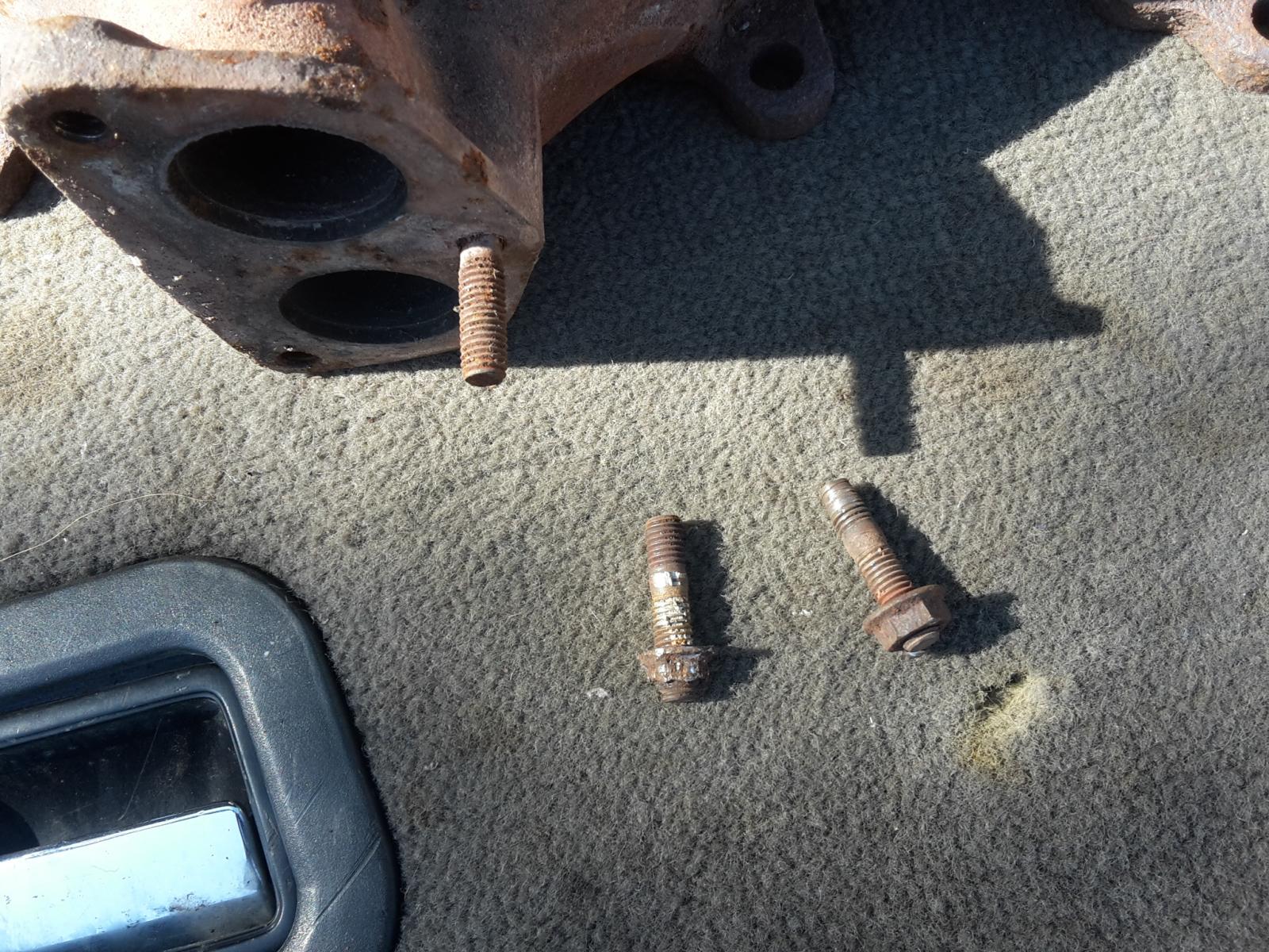

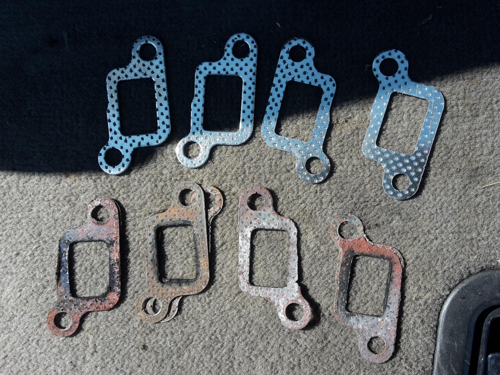

I had a problem with the drivers side manifold blowing gaskets all the time. I went on fixing it for ages. then the cat started rattling. I suspect some of the downpipe gasket found its was in and cats dont like bits rattling around against them.
These are the gaskets that sit between the manifold and the head
against new items
I didnt plan to remove the manifold but though I saw a crack in it. so did, and the manifold to down pipe gasket looked like this
and the manifold crack, it wasnt a problem but I had another manifold in the shed from the green car I broke so that went on
But I had to mess about with thuds and stuff
new gaskets fitted up and it blew again within 100 miles
fuckedy fuck
In the end I came to the conclusion that the cat was bunged up on the drivers side. I tried to find a second hand used old stock downpipe and cat y section but they have all gone! then I looked at the mild steel offerings but mindful that my mild steel mid and back boxed rusted out in 18 months it was going to be expensive. I ended up going for a full stainless system from manifold back. pricey but not planning to sell this car any time soon.
Manifold no longer blows and the car sounds awesome

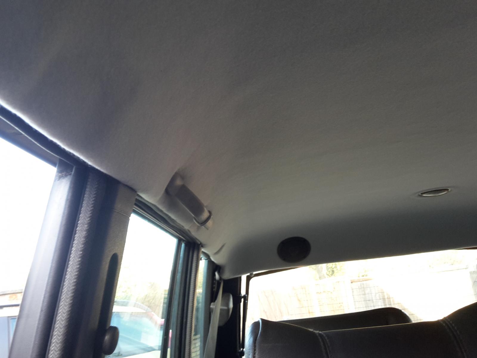

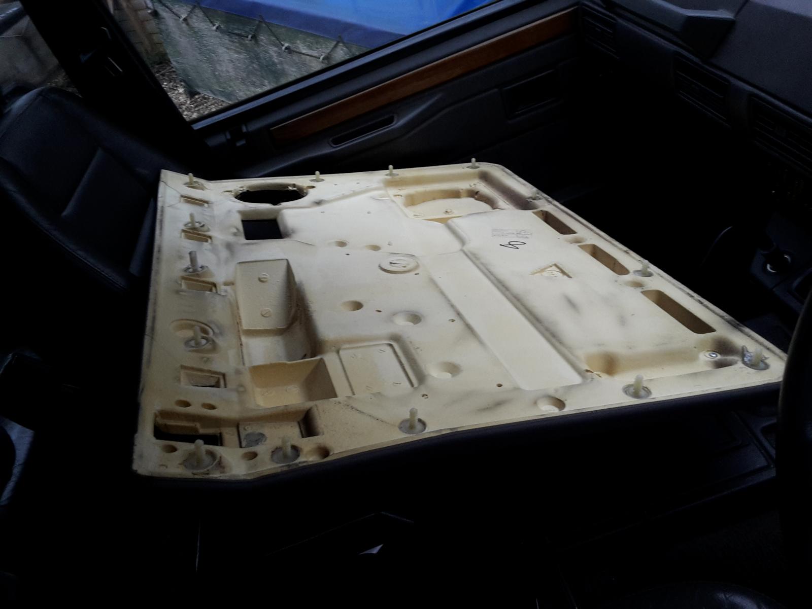

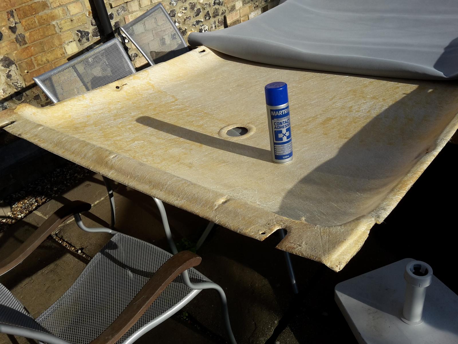

Range Rover headlining look like the inside of a Bedouin tent?
Easy fix. 2h work max
I had done this already but made the mistake of using normal fabric adhesive and not the stuff that could survive on the surface of the sun. so somewhat annoyingly the job had to be redone a few years later again.. arghhh

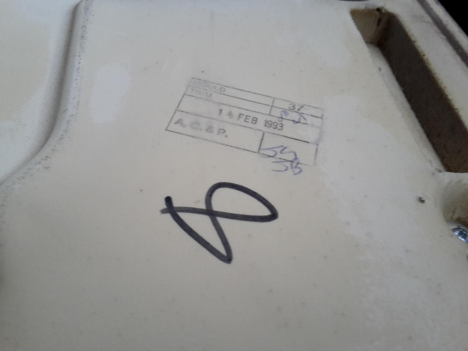

So in a nutshell headlining on the range rover is on a fibreglass backing which is held in place by rear speakers, sun visors, roof lights and fuck handles. It comes out in as long as it takes you to undo 32 cross head screws, 4 inside the overhead lights, 6 on the sunvisors, 8 on the speakers and the rest on the fuck handles.
The rear seats have to fold flat, head rests out of the front seats and boot side trim needs to come out. I have a toroidal LPG tank where the spare wheel sits and the head lining comes out at an angle through the rear tailgate. you should end up like this
the old fabric comes off quite easily and the backing is tough but I was careful not to shred it.
New fabric supplied as a complete kit by Martrim was laid roughly in place then folded back halfway
Then this glue was sprayed generously on the backing in one direction and the back of the fabric in the other.
It was sunny on the day I did this so I started working the two together from the mid point outwards. once it sticks it is a bugger to lift off again. When the mid - back section was done folded the loose fabric from the front and repeated
the fabric has enough give that you can mold it into quite complex corners.
Should look like this
With the fabric glued and in place, trimmed roughly around the edges so there was a 2-3" overlap and then glued that in place. this stuff sticks on contact. very pleasing to use
holes, lots of them I cut out carefully leaving a 2-3mm overlap. I used a bradle to make holes for the screws
then it was read to refit. needs two people to line it up. to keep the new fabric off the floor. but basically got the head lining into the car so it was resting on the rear view mirror. then tucked the rear most bit under a metal flap that side along the top edge of the tailgate. then fitted the two interior lights. that gets it into the right place so then it is just a case of fiddling the other screws in to finish the job.
Finished

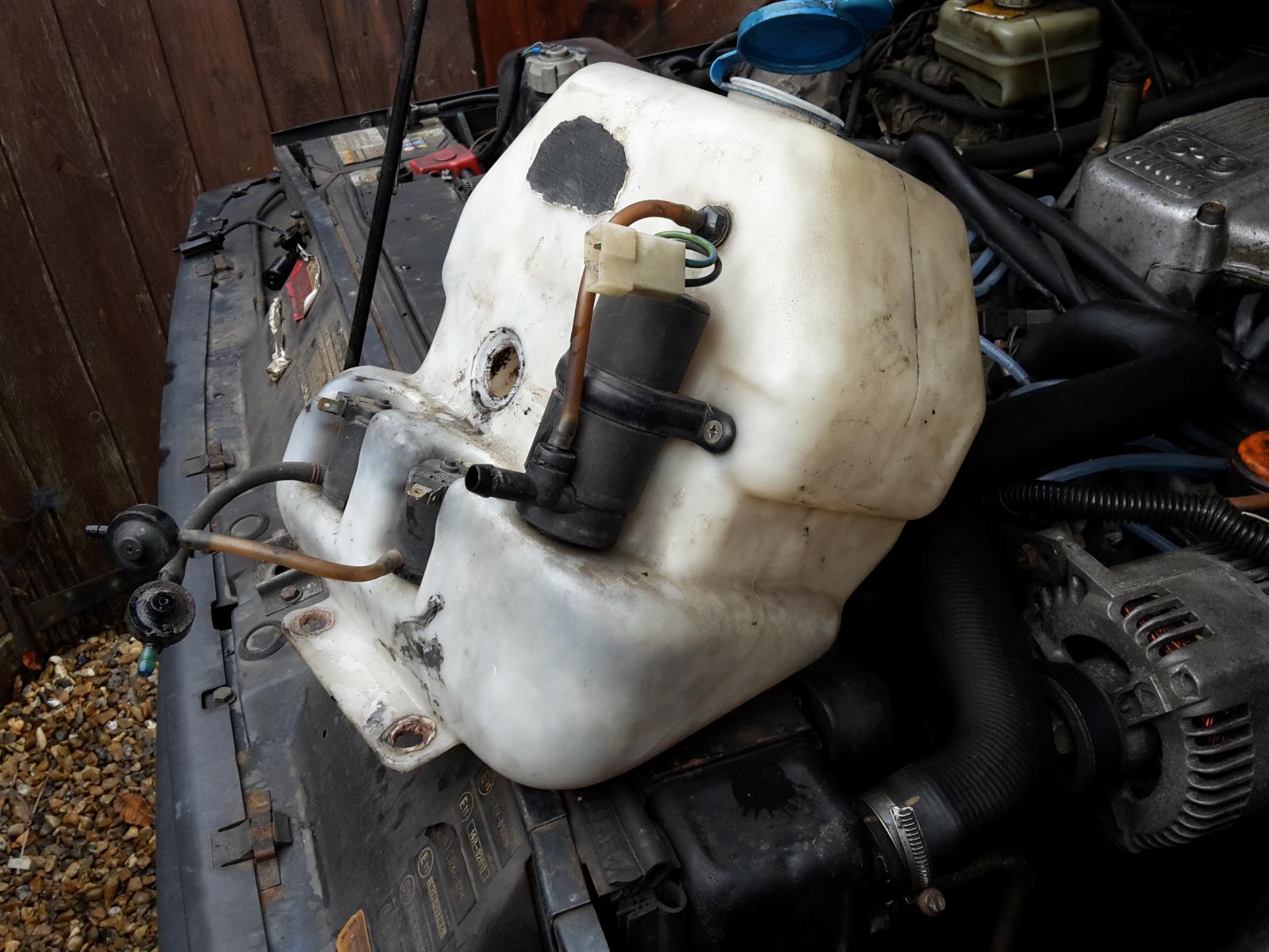

Today was a busy day for the 93 Vogue

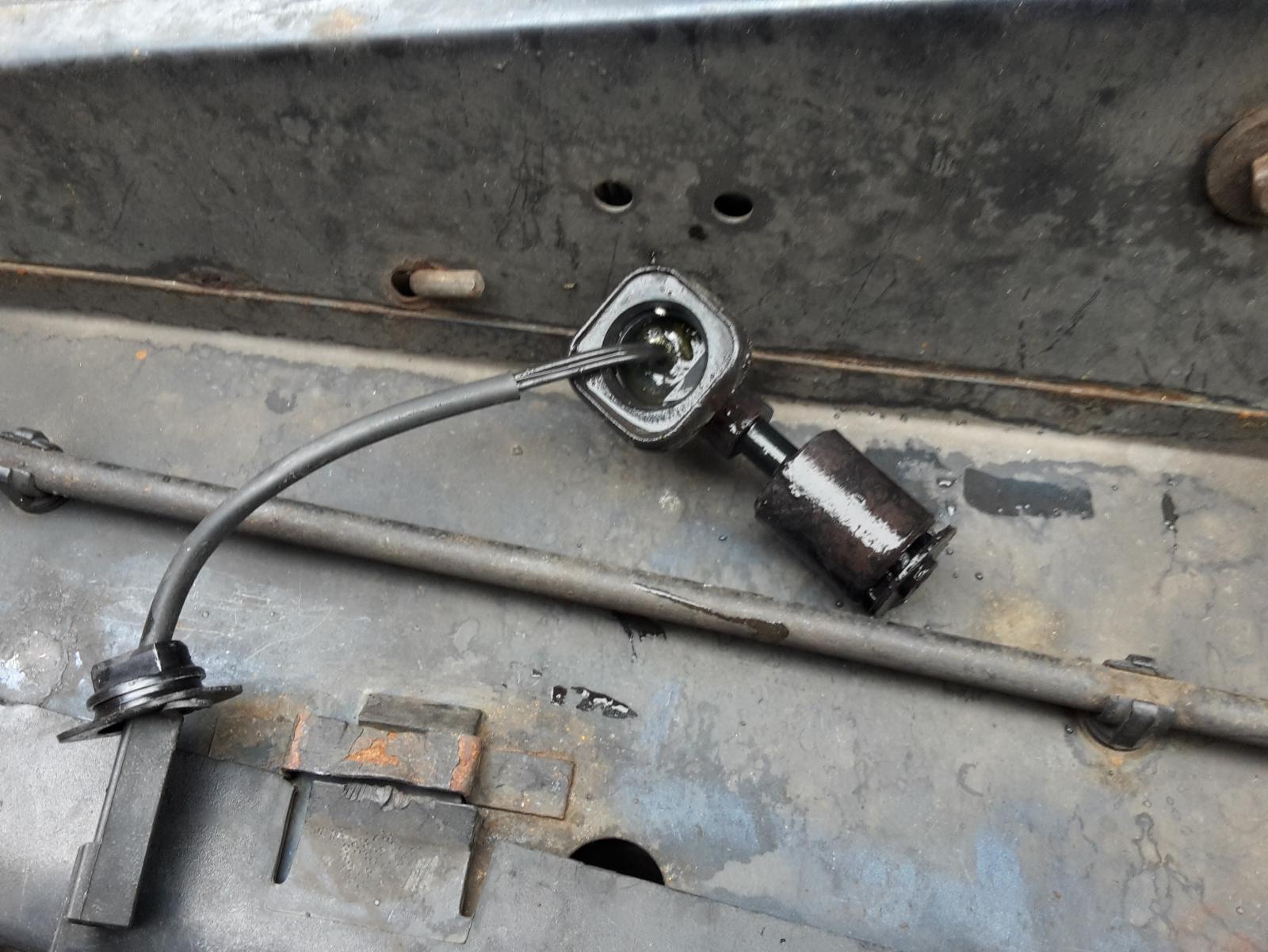

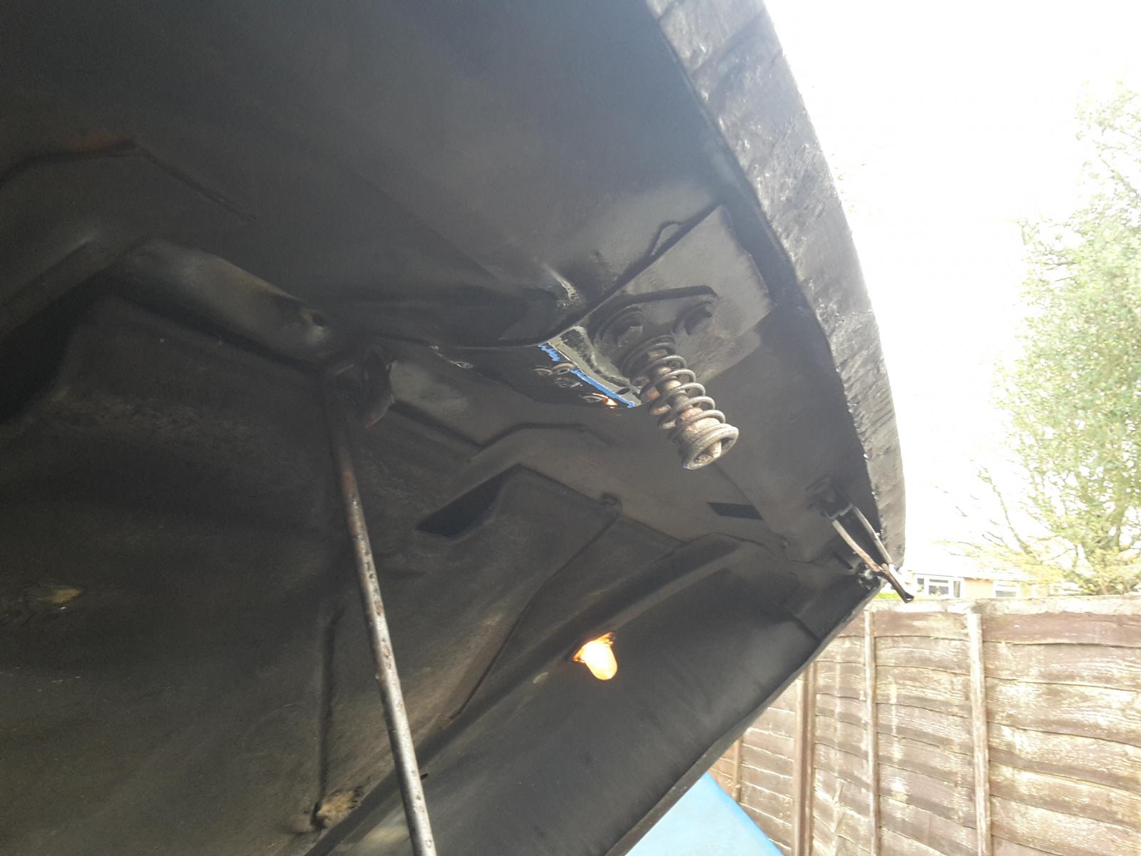

The screen washer bottle empties too damn fast and the bonnet was wobbling more than normal on a trip to Bromsgrove last week.
Washa Bott 1st
8 litre capacity on this baby sadly not a Cricklewood Bentley though, couple of bolts hold it in place but LPG gubbins get in the way to remove so I have to give it a wiggle.
Once out found that the water was leaking past the float level warning
Smeared bathroom sealer on the seal and refitted
Left it 1 hour to dry and refilled the tank and all is well again
3 pumps and one float level sensor that didnt work until today. works again so I fixed two things at the same time

Washer jets block up with the mould crap that is in the washer bottle so I tried to remove as much as I could with bleach and other nasties. Didnt use Cilit Bang because I want to keep this. Blast of 120psi air through the water feed to the washer jets on the bonnet cleared those in about a millionth of a second
wobbly bonnet!
Had this before and tried too subtle a fix!
Needs the crap welding out of it but for that I need less rain and the bonnet off the car.
So short term fix was call for.

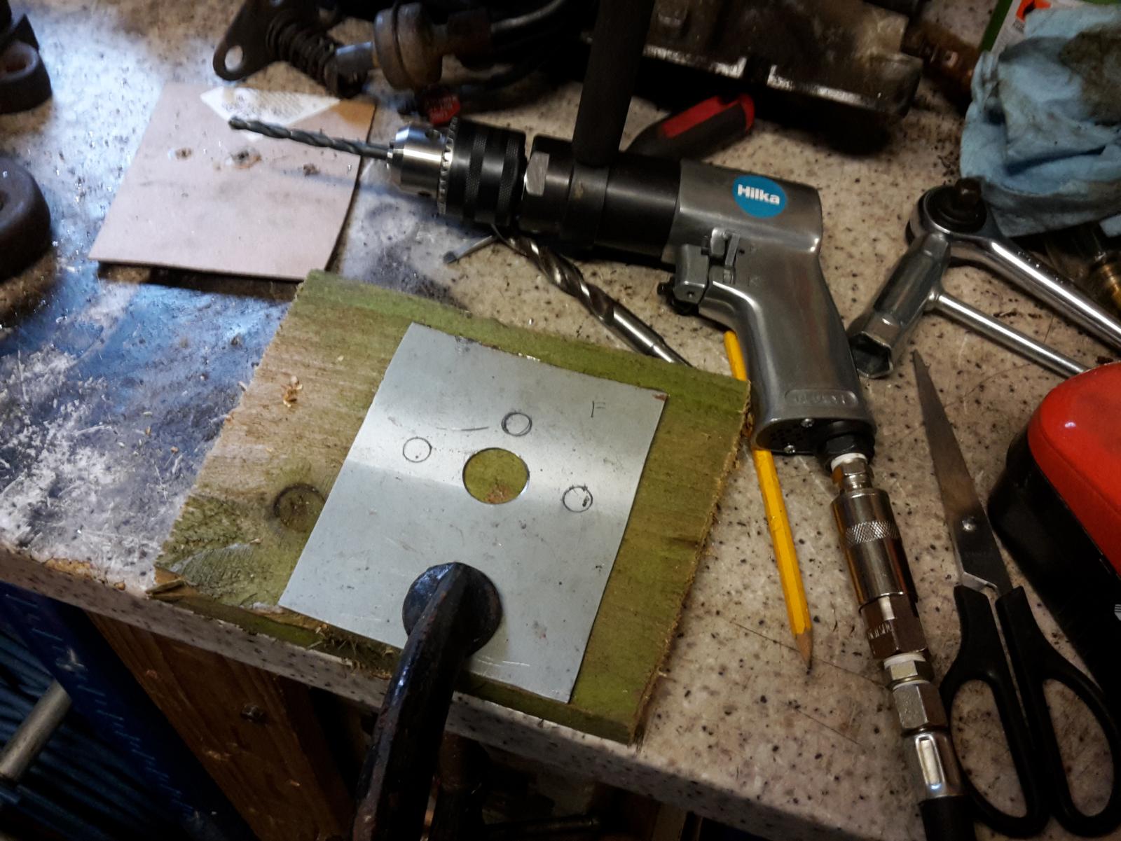

Here is the problem and judging by the number of bonnet pins and external rubber locks on Range Rovers this is a common problem.
The centre pin catch is secured to the inside of the bonnet by three nice bolts. the weak point is the metal on the bonnet. As you can see here it fractures, note this is after I had remove the previous too suble fix and the bonnet catch itself
This is the failed fix but broken
The revised fix is to use a single lump of steel welded to the bonnet. in the short term it is bolted and riveted in place.
Air drills have enormous torque. and using the hole enlarger I got this easily
With the centre hole drilled out for the reverse side of the plunger and its huge square captive nut, I marked out for the 3 bolts that secure it to the bonnet
which were drilled while clamped to the work bench with a g clamp and scrap / sacrificial wood
Fitted back to the car with pop rivets all is wobble free again

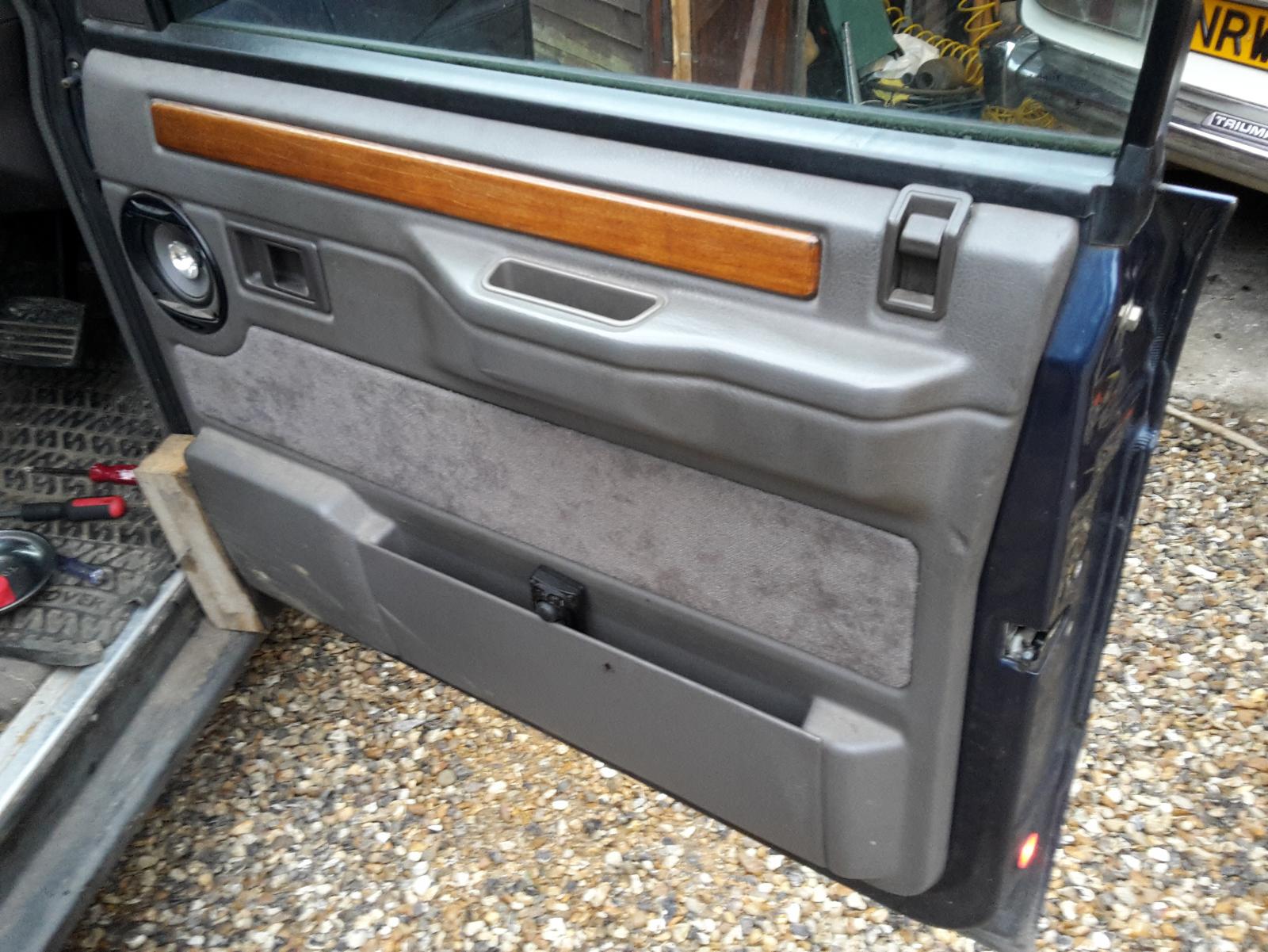

93 Vogue central locking has been playing me up. Up until today it often locks all the doors, then unlocks them all but arms the alarm. Cue loads of HONK! HONK! HONK! fun when doors are opened. Found it was the drivers door plunger that was causing this. using the key to lock the car via the drivers door lock made me very nervous because despite it locking and arming it was also very tight. I had visions of completing the exercise on a dark and damp night but withdrawing just half of the key.
Other problem is that the n/s/r door locks just fine but doesnt unlock on the central locking. Just typical niggles on a 22 year old car. Imagine how fucked off Tarquin was with his brand new very expensive conveyance outside his Kensington pad and in front of his Polo chums? I mean like ffs and panel gaps that you could get a ham into  :)
Today however the situation when up a level. Car alarm was arming itself without me doing owt. then HONK! HONK! HONK! without me going near the doors! After the forth time on the Shell forecourt and while being watched on by sympathetic Nissan Fuckarsed Juke owners I used the drivers key to lock the car arm it and stop all the HONK! HONK! HONK! shit.
So windiest day of the year. time to fix, this is at the start
Never been apart before But I know how they go together. loads of stupid clips and stuff that mean it is a bugger to do if you dont know.
This is the pull handle, plastic trim covers the screwheads.
Plastic covers that are made from bone china
Using my latest ebay purchase, with a bit of duck tape wrapped around it to protect the painted surfaces I teased each plastic clip from its home without breaking one of them!!!!
Nice factory stamp on the back of the panel. Thanks guys but I think JG may have been a scab in 1763 etc
